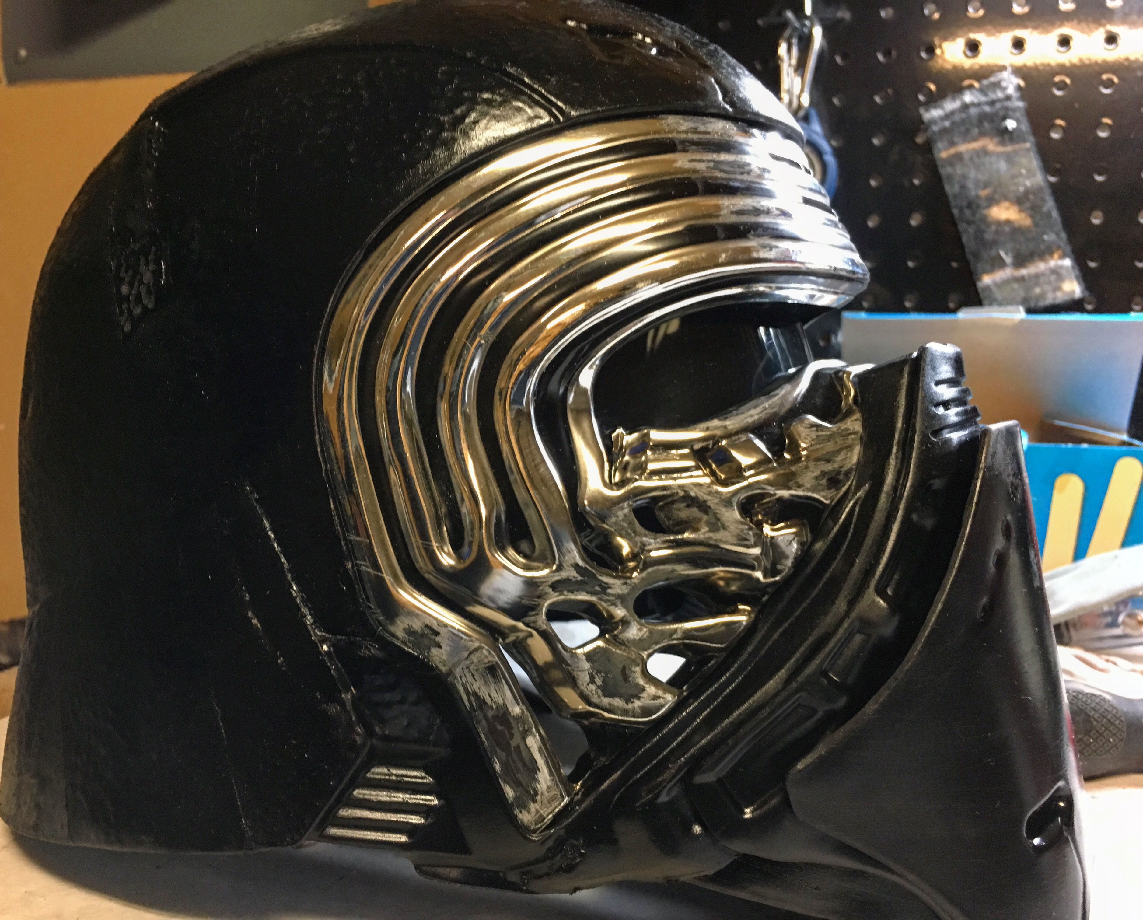

Hey guys been following along on this post, just finished repainting my Kylo Black Series bucket. I also decided to cut out and replace the front nose piece (which sucks considering the price of the thing) and replacing it with the disney mask (which is $26). why they gave that one a better front piece vs. the $70 one is beyond me?
Dang it! I've been working on something similar for the past couple days. Thought I might be the first to gut the disney mask, but you beat me to it. Haha.
I love that you plastic welded that whole nose area, it gives a lot of profile dimension. I just installed the disney nose over the molded one. It came out good, but I like your approach even better. Either route is a major improvement to how they come.

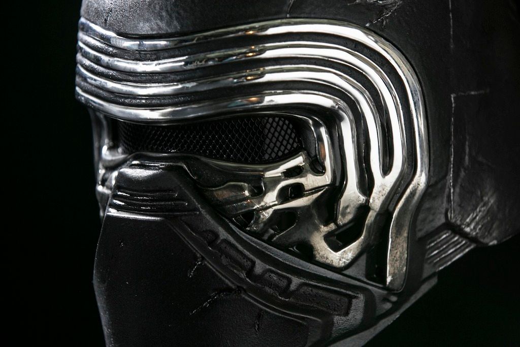

OK, just finished up my helmet. Hopefully this info is helpful to someone out there.
TIPS & LESSONS LEARNED:
I'm treating this lid as a display piece. I might have handled things a little different if I planned on wearing it constantly. Just an FYI.
  • The helmet is definitely a little flimsy once gutted. I ended up leaving in a lot of the interior parts just for the sake of weight and stability. I also used some body filler to reinforce the seams on the inside. If I had it to do over again, I would recommend fiberglassing the entire inside.
  • I used a soldering iron to melt the seams together, as mentioned earlier in this thread. It worked well, but I drove myself nuts trying to get the seams perfect. They came out pretty good, but not a smooth as it would have been with body filler. Still pretty happy with the results though.
  • I cut the nose off of the Disney voice changer mask and mounted it over the original nose. The separation of having a second physical layer there makes a huge difference in person. If I make another, I'll definitely cut off the whole nose area and plastic weld the complete 2-layer Disney mask nose in (Kudos to Sharkguy). This creates even more depth and realism.
  • The black liner behind the chrome faceplate was cut apart to let most of the holes show through. I did not cut in the two small holes near the nose. I thought they looked fine as-is. If you want to be totally accurate, cut them out.
  • To weather the chrome faceplate, I airbrushed on some flat black acrylic and let it dry partially. I then took a rough rag and rubbed away some of the paint. It leaves a smokey but scratched look that is very realistic.
  • I used a metal mesh in the visor area from a small, dollar-store pencil holder cup. It looks good, though the mesh is larger than the screen used helmet references I've seen.
  • The speaker holes were filled in and painted over. I mixed sand into some acrylic and repainted all those black ribs between the chrome.
  • PAINT - On the nose, I used several layers of splattered plastidip, then cleat-coated it. The disney mask's nose is perfectly smooth, and needed texture.
  • For the rest of the helmet, I cut in some details with the soldering iron, but needed to match all the texture better. I used a spray-on truck bed liner to create a fine texture and a tough outer surface. I looks pretty cool in person, and a little less like plain old paint.
  • The small vertical pegs in the helmet stand will hold Kylo's lightsaber hilt. I'm hoping to start on that project soon.
If I get a second, I'll shoot some photos under flat light. For now, here are the nicely lit shots:
