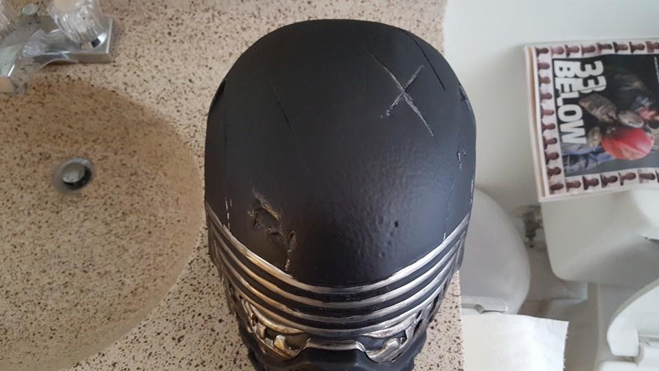

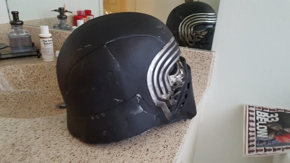

I've got to give credit where credit is due... @Jamestan I took your advice and welded the helmet together. It worked fantastically!
I can't recommend welding it enough. I've seen failed attempts with epoxies and CA Glue... Don't bother with that stuff.... I bought a cheap $17 wood burning tool with interchanging bits and it took 5 minutes to get it done solidly!
Little bondo work on the seams, and attaching the battery cover and buttons are all I have left to do!
That's great to hear. That was actually the first thing that popped in my head to do but was the last thing I tried. I used epoxy, then ABS cement, ABS slurry, plumbers epoxy, then I finally thought what the heck get out the soldering iron. Maybe I should have bought one of those wood burning tools, as doing the seams and the front layers and everything else with a single tip took a lot of work.
