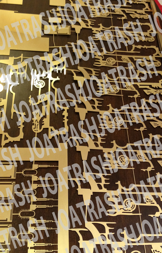

After finally sending away the blueprint master to an etching firm and waiting... this came back in the mail:
attachment.php
I was AMAZED at the fine detail that had been etched. Next up... my first experiments putting this together... soldering brass and whatnot.... stay tuned!
