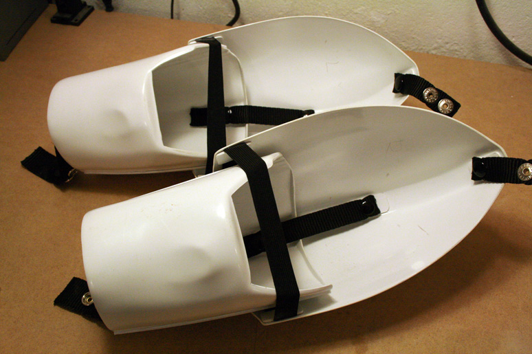

Also, most trooper armor has the shoulder bells attached separately, could I get away with attaching those to the biceps to simplify the suit and to simplify dressing? This way I just need a strap across the back of the shoulders/neck to hold the arm pieces.

As for the shoulder bells, here is what stormtroopers do. See above. (Note: Not my photo but borrowed from...I think Stukatrooper)

I had seen the shoulders with the elastic, but I had not seen that picture, which helps seeing the interior view. It helps with scale too.
Even though with some movements, it looks like the shoulder bell would pivot some...it doesn't seem like having a glued connection point versus the elastic straps (added work/complexity) would make an appreciable difference??
The elastic is long but glued only in the middle of the bell which allows for the lateral movement. It is glued near the top of the bicep. Also- make sure the straps that connect the two bells is glued forward of the center. This helps to keep the bells "closed" and against the chest plate
