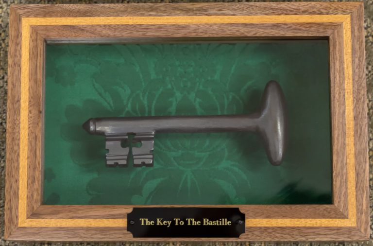

Hi, let me first start out I am a complete noob to model making, I am an industrial design student so I do however know some things, for years Ive had a sick obsession with the Key Of Bastille that Lafayette gave to George Washington I have hundreds of pictures and have even contacted Mount Vernon for the exact dimensions of the key, my question is, how do i make my own? I have no soft modeling experience but it doesnt look hard to sculpt, I was thinking of using Super Sculptey but that was as far as i got, the original key is made of iron, so if you guys had any idea what process i could go through to go from Sculptey to Iron, it would be greatly appreciated. Thank you in advance.
I Contacted the Curator at mount Vernon who gave me the dimensions its about 10 inches long and weighs 4 lbs out of wrought iron, she also sent me a picture of it with a dollar bill for size reference, anyways, heres a pretty good picture of it
http://emuseum.mountvernon.org/media/full/CT-6615 W-14 A&B.jpg
http://cache4.asset-cache.net/xc/72...3459118DE602188171D599C200D1EB01E70F2B3269972
any ideas on how to make it?
what i really need is, what material you guys think it needs to be sculpted from, then if that material can be cast directly into iron, or what process i need to go through to get it to iron. thanks guys.
I'm pretty sure, per my re-measurement request, the Mount Vernon Bastille Key is 7 3/8 inches long and weights 1.18 pound. I also believe that while molds have been made of the key, it is very difficult to cast satisfactory iron replicas from them. Hence you get the styled, cast iron replicas such as the ones recently made for Trump and Macron. More in the book "George Washington's Liberty Key" and at www.LibertyKey.US and its embedded links. TrumpMacronMansionWalnutPecanOutsideTreeSteelACUSSGeorgeWashingtonBastille-Key-Box-2018-Shenk-2-.jpg
