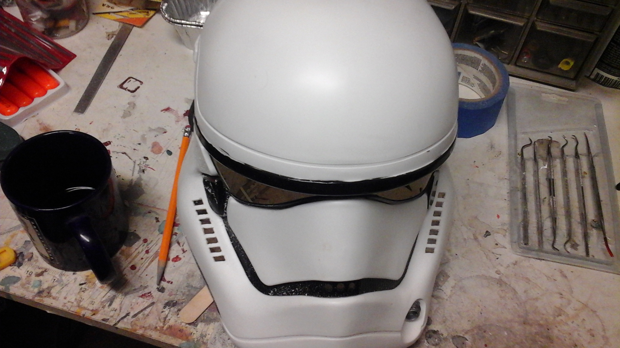

This is as far as I can go for now with this helmet. Waiting on the frown mesh and looking into something to replace the lenses with. The seams are filled and the vents have been cut out.
Doesn't look like I will be doing any painting or priming this week because of the hurricane getting ready to make its mess. Too humid and unpredictable weather right now. Looks like I will be doing alot of hand and assembly work if I can that is. We will see.

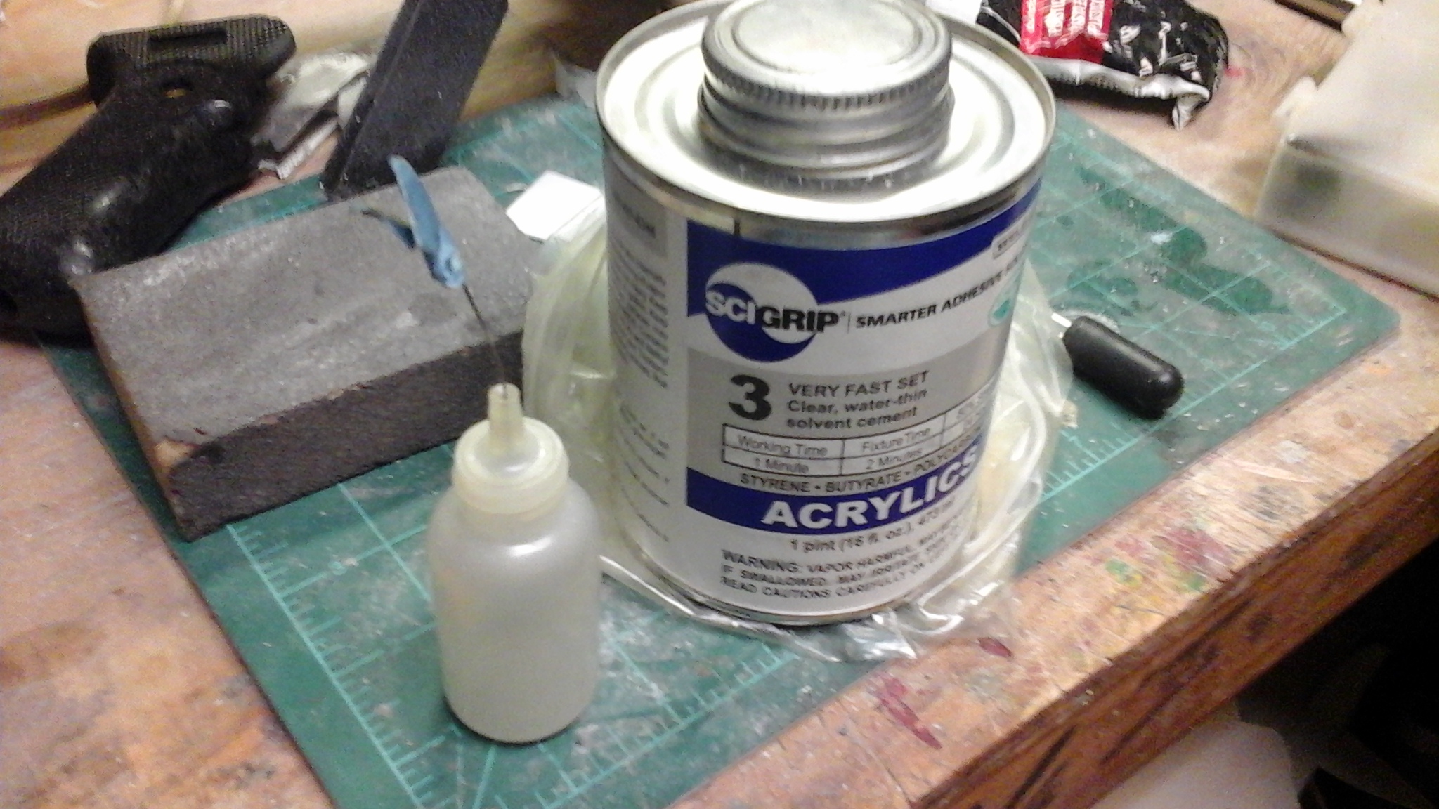

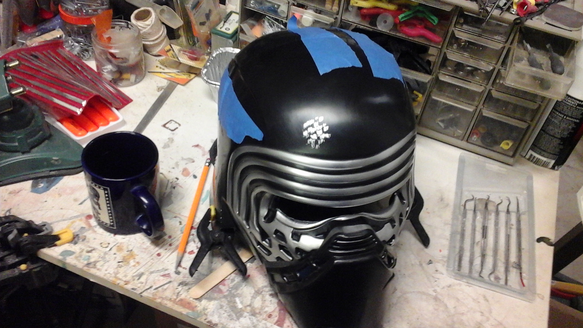

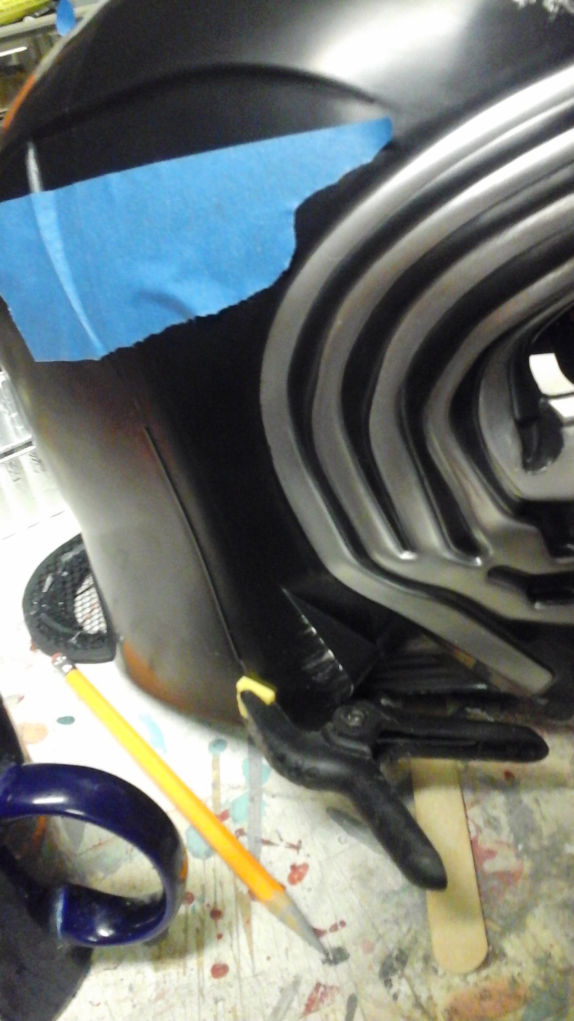

I am working on putting the two halves together for Kylo and what a pain in the backside! I found by removing the velcro, I got a tighter more accurate seam, but trying to hold them together to weld wasn't as fun. I decided to use some tape and clamps to give me a start. I used some weldon and a syringe and now it has to dry. The trooper helmet is way stronger than I originally thought it would be so I don't believe I need to glass the inside however Kylo and Boba will need to be glassed. If I dont, any movement can break my paint job.

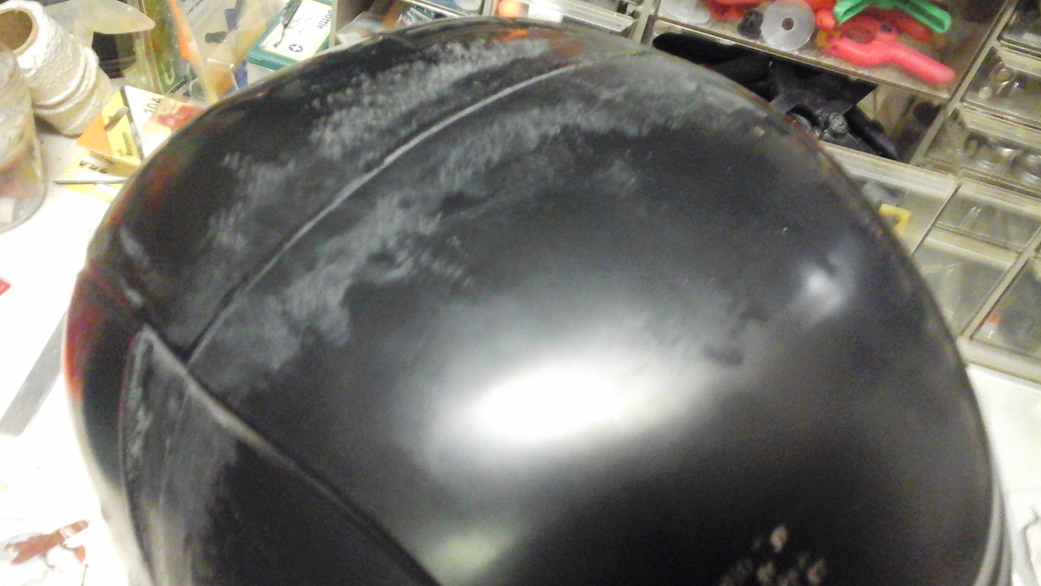

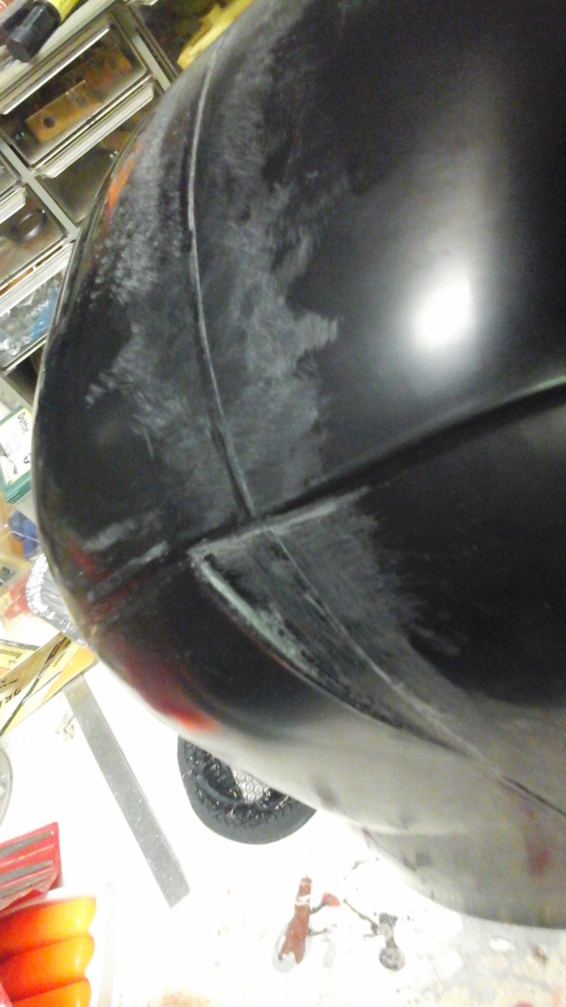

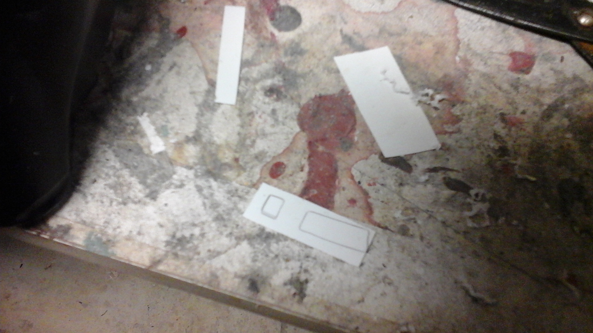

My weld has dried so I took my file to it and smoothed it all out and now it's even. Ready for some bondo. I also filled the sound holes with some 1/2 mill layered ABS.

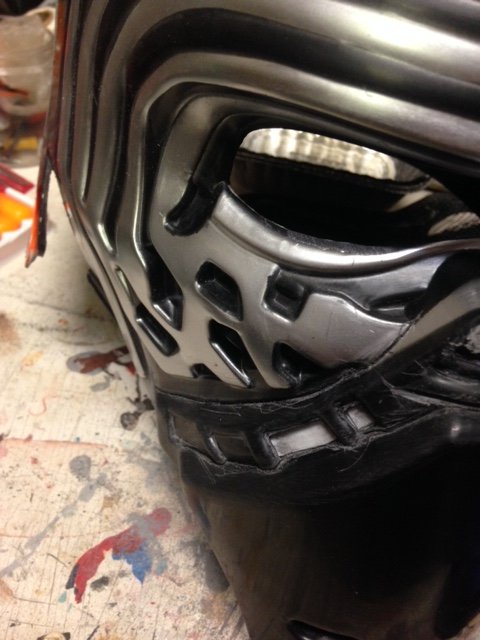

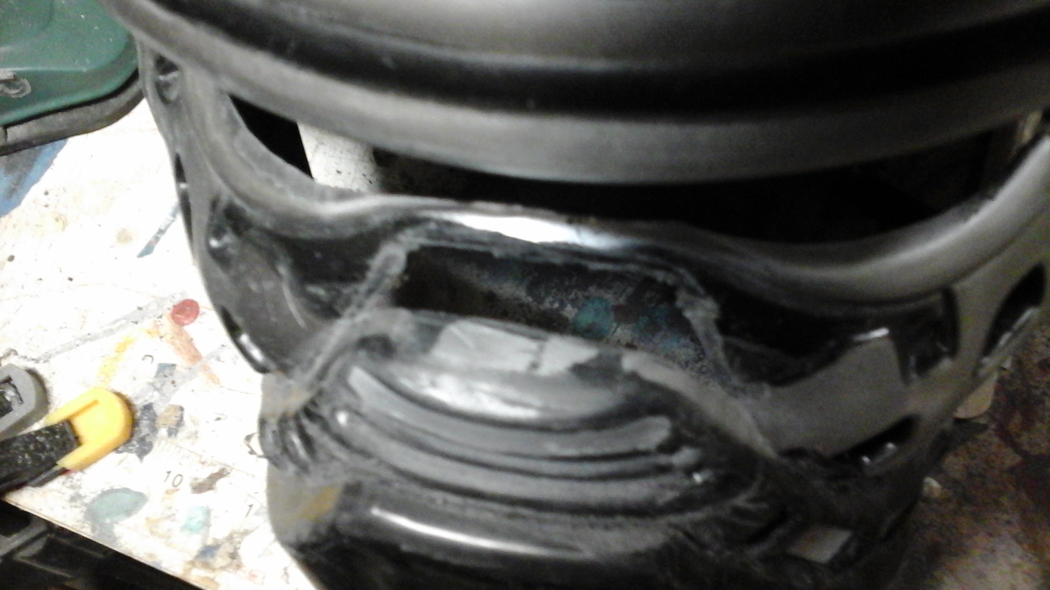

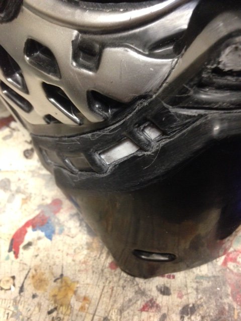

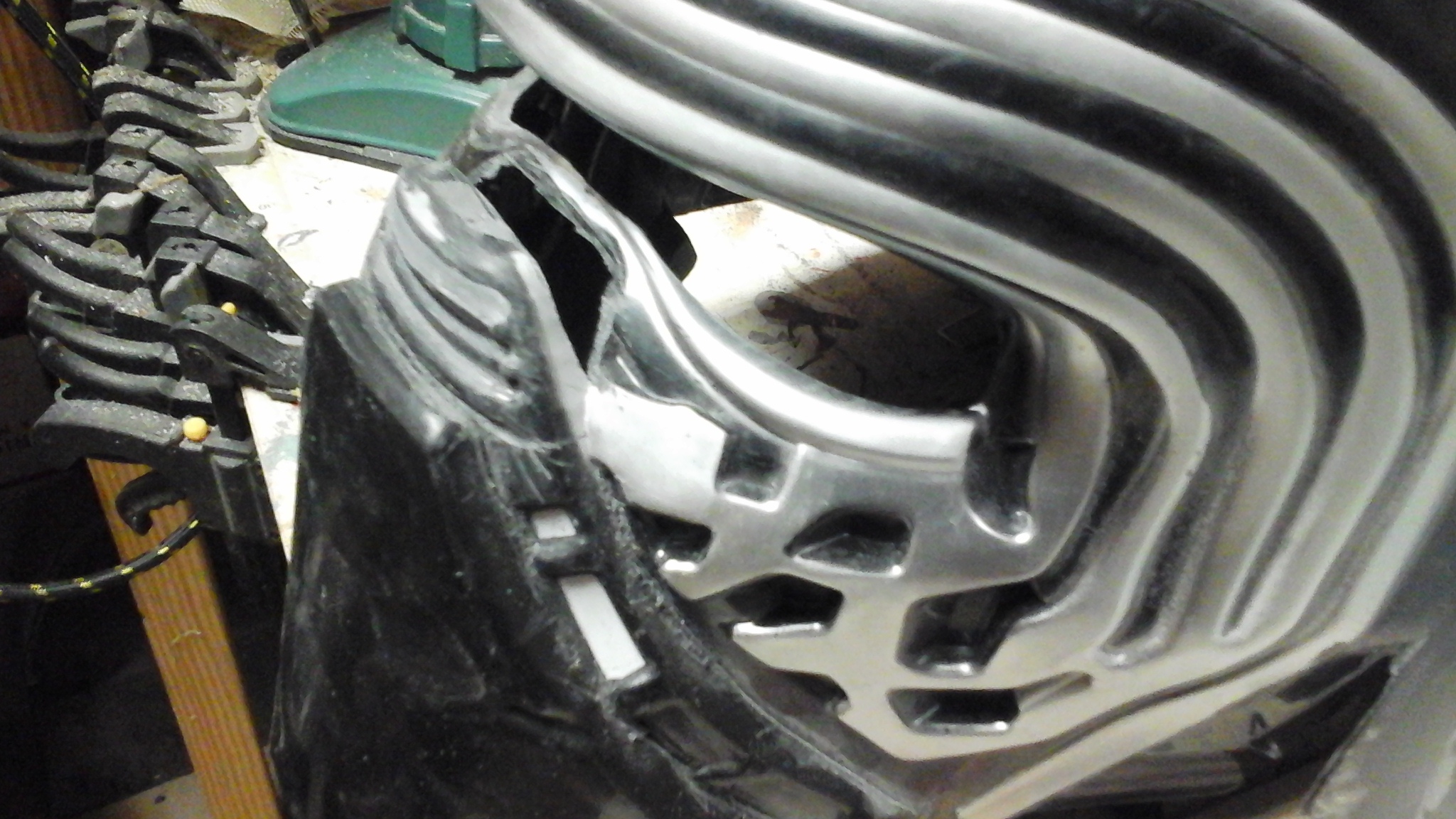

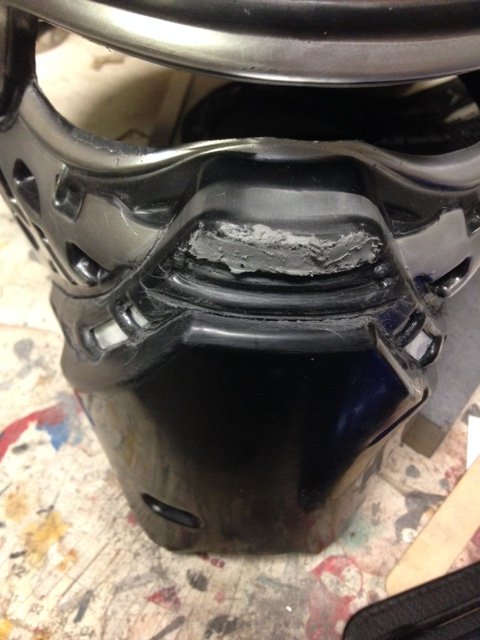

The kylo mouth piece was just driving me crazy, no depth at all, just a chunk of plastic. So I took out my scratch tools and dug out the lines to add some detail and depth. I have been studying both anovos and prop shop photos and the mouth guard really has alot of detail. Also the anovos photos are lighter and if you look closely on the bottom of the helmet, the bottom runner looks to be rubber and runs up on the inside of the helmet. I cut this piece out and I will use a piece of rubber after I glass the inside. I also cut a groove right above the mouth guard and filled in the top groove. Also those angels in the back of the helmet aren't on any of the other helmets so I cut them out. Surprisingly, the flaps closed by themselves.
Here are some photos however the detail doesn't show up as well being dark. They may show up better once I prime it.
Warning, not for the squeamish! Lol

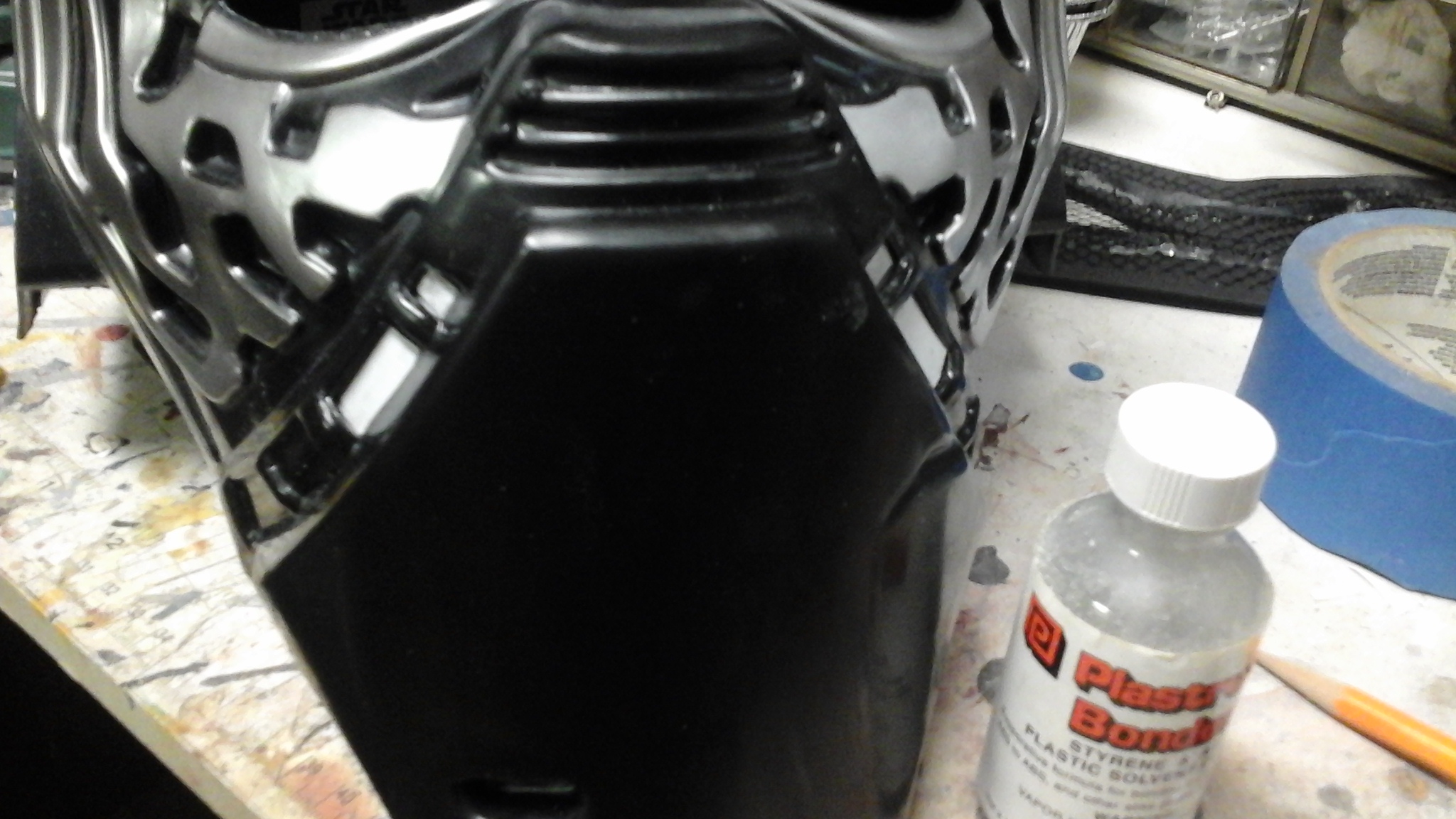

To finish up with the mouth gaurd, I cut the top angel out in a V. If you look closely at your target mold, you can actually see the shape. It's just covered up with paint to look like the grill. In the prop shop and anovos photos, you can see the mouth gaurd is off in front and the mask holds its own contour to the face.
I will work on reshaping this tomorrow. This appears to be the last of the cuts before I glass the inside. Not too bad for only 30 dollars.
