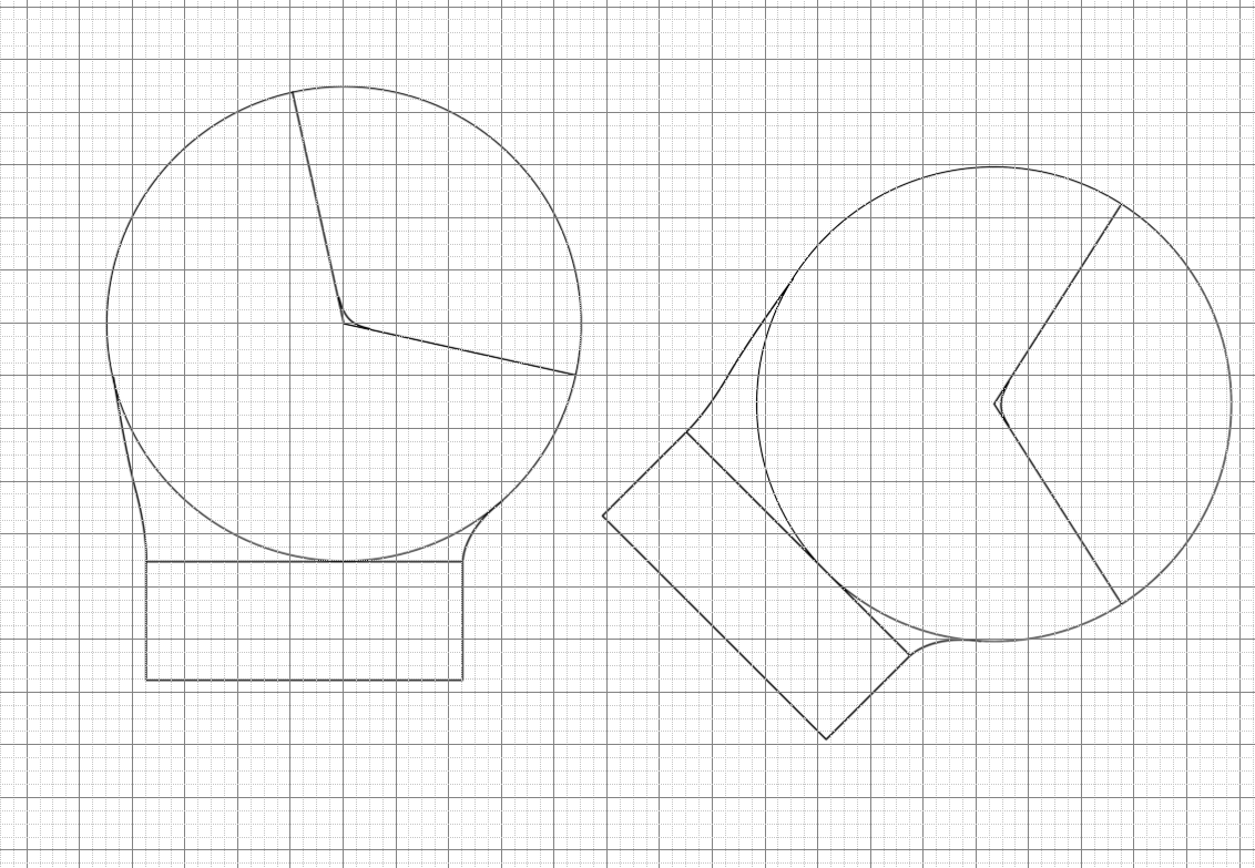

The geometry of the head pattern is simpler than I originally guessed. The following advice doesn't include allowances for selvage. With very small ladder stitches, you'll only need a few millimeters anyway. Ignore the Master Replicas photo except in terms of basic proportions. The puppet head pattern is different.
Draw a 9 inch circle. Add a right-facing 115 degree pie wedge (think Pac Man). Round off the inner corner fairly generously. Rotate the entire drawing 45 degrees counter-clockwise. Draw a 6 x 2.25 inch rectangle tangent to the outside bottom of the circle. Offset it left of center by 3.75 inches. Blend the vertical edges of the rectangle upward into the circle. These curves should blend gracefully with high tension. This is an improvement over my dummy head above. This pattern will produce a higher "skull" and looser neck under the chin. The shape includes the 1/4 inch or so of overlap with the mouth plate.

Here's what I understood for the head. The shapes are NOT accurate, just eyballed. Use exact measurements and degrees.
the question is, is it 9" diameter or radius? cause offsetting it by 3.75 inches on a 9 " diameter willresult in this:
each big square is 1 inch obv
sorry I wrote that wrong in my diagram. When I hear a 9" circle I think 9" circumference.
not sure.
what is the radius on a 9" Circumference circle. split that in have and see if it it makes sense with the length of your finger to your thumb web.
I thought diameter, because that would be a 4.5" radius which is approx. the right length for fingers to fit in.
If it is Diameter, maybe he means this? That doesn't look right to me though. I'm on a conference call at the moment so I can't break it down right now.
maybe he means offset by ,75 inches, as its 6 inches long, and 3,75 is half +.75
only thing that makes sense to me
thats what that looks like:
i hope its understandable what i mean.
you know, offset the middle by 3.75 from the corner, would mean offset the middle by .75.
hope that makes more sense than what i wrote above :D
