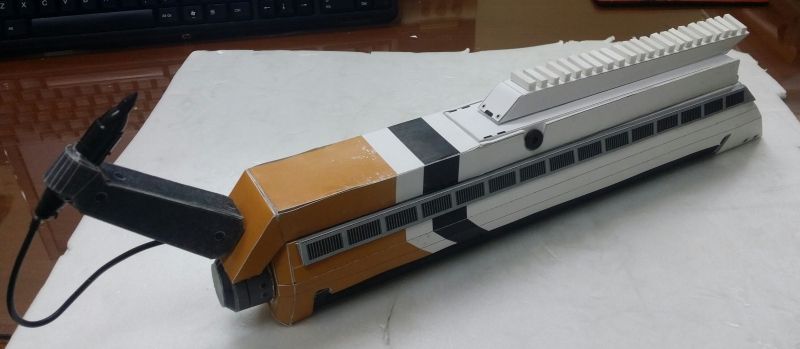

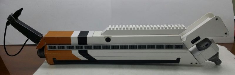

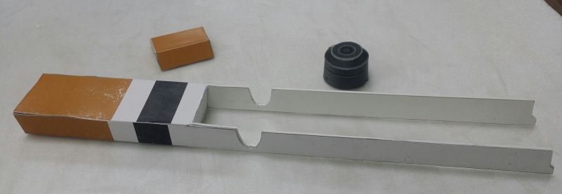

An example of how I used styrene to reinforce the cardstock. Oh, and I ended up not using the nozzle thing. I replaced it with a bottlecap.

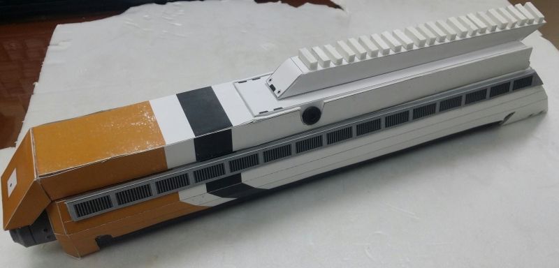

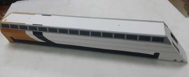

I couldn't be bothered cutting and folding the rows of teeth so I just ended up cutting styrene pieces and gluing them onto the build.
Those vents are printed on. I decided at that time that I would make my own vents to glue onto that, as seen in the later pics.
Yes, that is a (shortened) Sharpie.

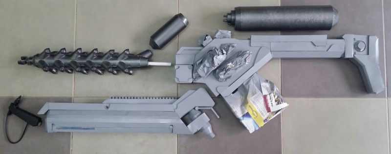

Coming together.
That middle section is quite solid as I reinforced it quite a bit.
The side and top greeblies are made from styrene pieces and found items like bottlecaps and coin batteries.
I made the grip from layered styrene pieces as I felt I needed something more solid that paper.

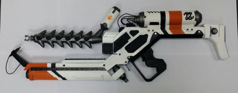

The most difficult part of the build has got to be the radiator-looking extension. Made from cardstock and the tips of each part are actually brass eyelets.

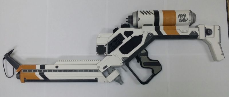

At this stage, I decided to give the whole model a paintjob. After sealing it with PVA glue, I primed the parts. The inner canisters (without their sleeves) and the radiator-looking generator were painted with metallic ash grey which is darker than gun metal.

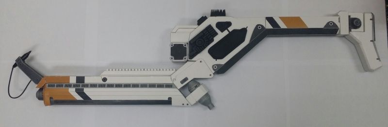

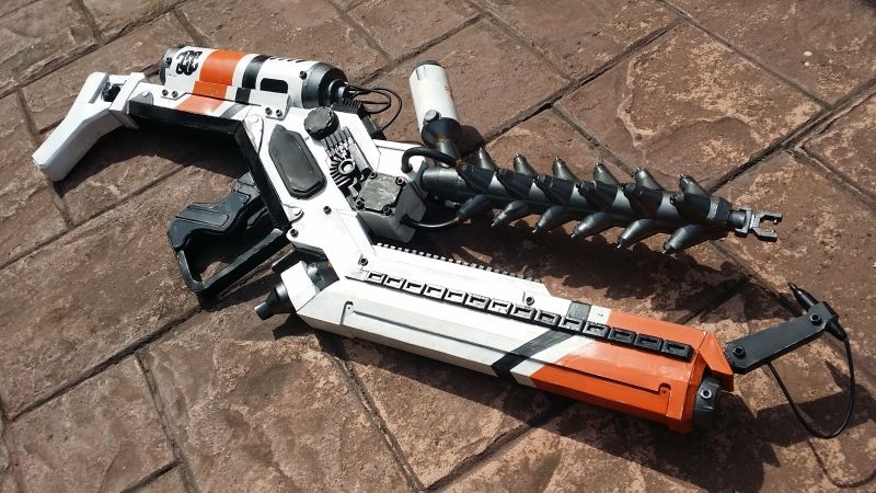

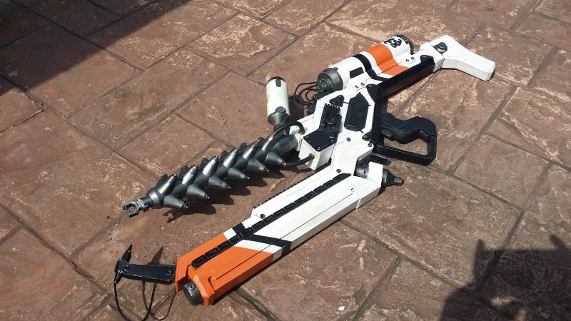

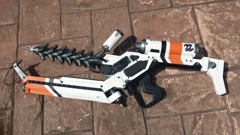

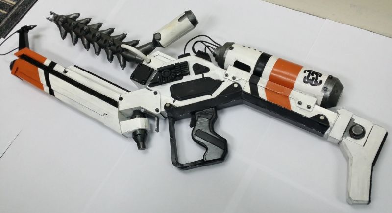

Base colors painted on. Not the greatest paintjob since I used rattle spray cans. I also added the vents, some nuts and screws and wires to complete the look.

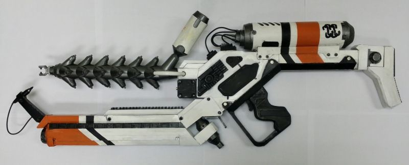

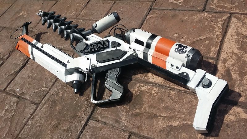

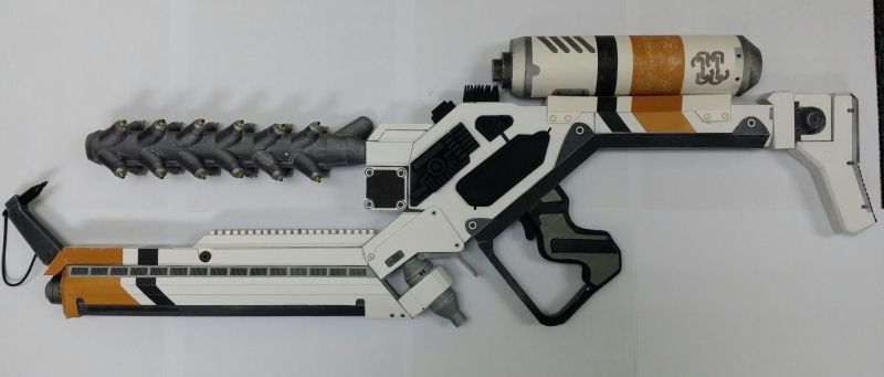

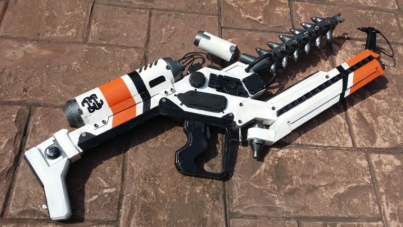

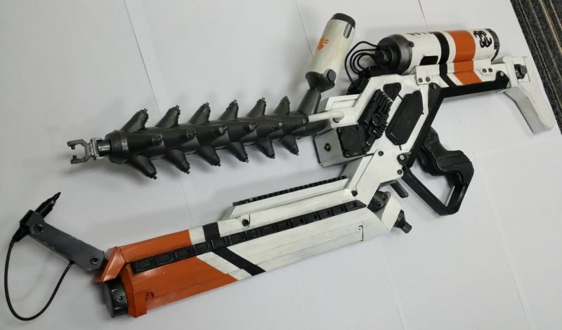

After some blackwash and dry brushing, this is what I ended up with.

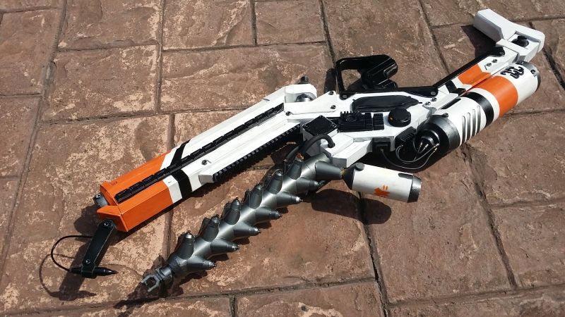

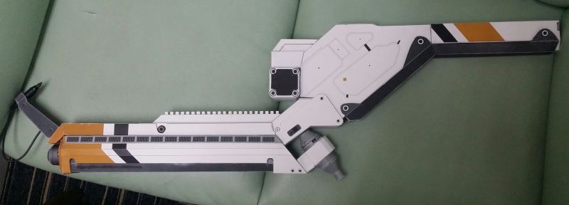

I just need to paint the hoses black and paint the goo on the wires and hoses, after that I'd say the build is complete.

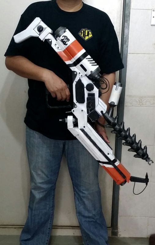

Took me a whole month to build.
Materials used: 250gsm cardstock, styrene sheets of varying thickness, tons of glue, spray paint and various found items lying around the house. Tools used were a steel ruler and a box cutter. Rudimentary build.
Thanks for reading.
