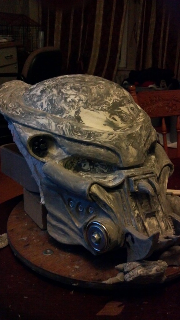

Update....this time with pics! :D

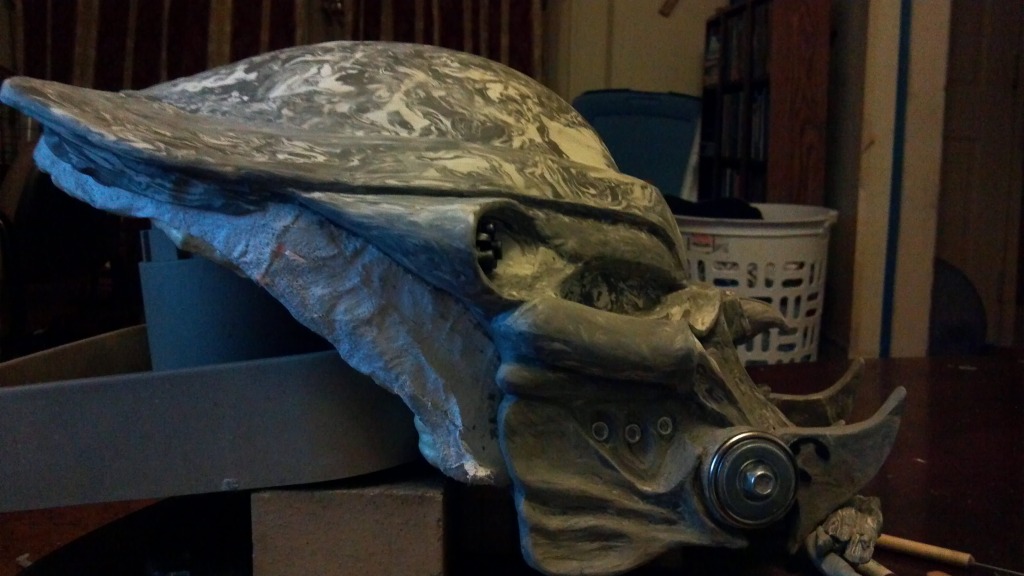

I think I'm to the point where I can call the sculpt 95% complete. The only things that I really have to do yet is to tighten up the lines, smooth the overall bio, and make sure everything is correct. I had a lot of fun sculpting the bio and really want to thank Rob for permitting me to do it, as well as using the concept in a suit built. It was a blast and it made me realize how much I miss sculpting bios. I believe it's my best sculpt to date as well.
I'm going to mold/cast the blades up separetely from the bio sculpt itself. I'm thinking of doing a peg/hole concept in order to attach the blades to the bio and then enforcing it with super glue [comments are more then welcome].
Now onto the pics

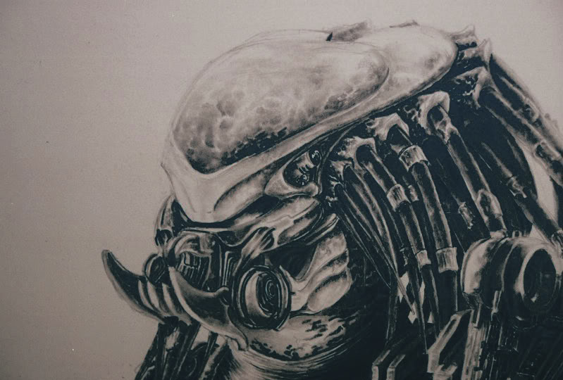

Concept Art by Rob:

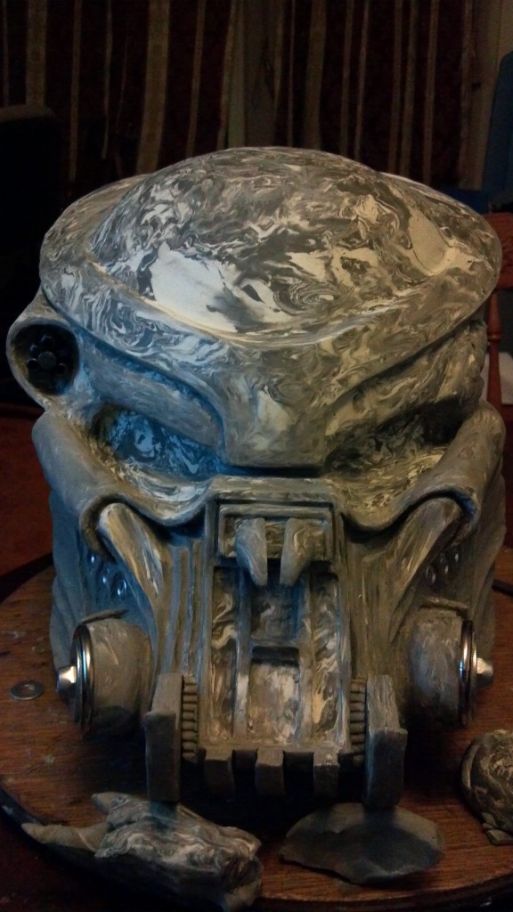

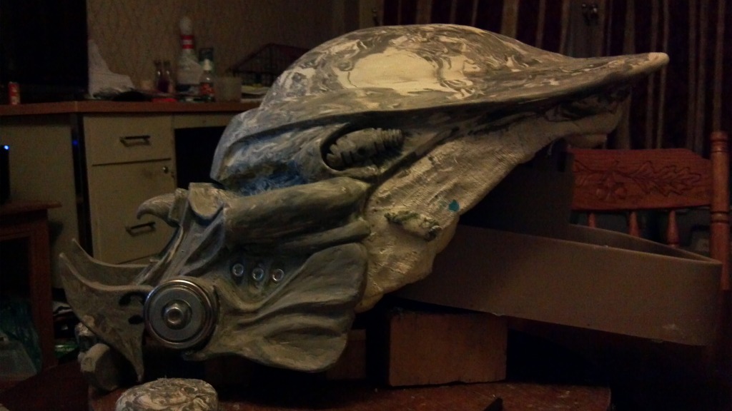

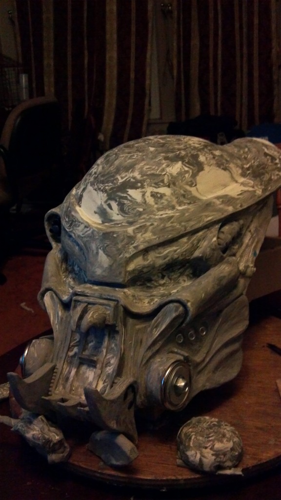

Sculpt:

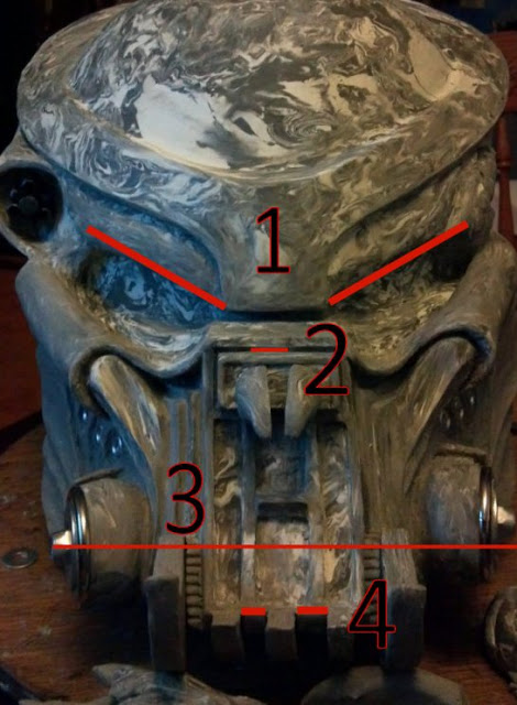

Man that's looking fanfreakingtastic! Looking at the pic, there are a couple things I saw that I wanted to share with you:
1 - are they eyes the same length? Maybe its the angle but the one on the right looks a tad longer.
2 - the red line is covering an area where I can see a bit of clay. All the other areas inside that part look good. Again, may be the lighting
3 - I don't know if this is just the angle, but the two round parts on the mouth look off...the right one looks higher
4 - The gap on the left is smaller than the one on the right by a smidge
Again, I may be off due to angles/lighting so please take with a grain of salt. I know that having a second set of eyes with my stuff can reveal things I missed along the way just due to staring at it for too long at close range.
I'm honored that would choose two of my drawings to sculpt...I can't put into words how cool that is. Thank you and I can't wait to see you kick ass on them!
I see the left wheel on the cheek lower than the one in the right, thats just what i saw :). Its almost there, can wait for the first one to be painted
Thanks guys.
Yea, working in marble clay is a pain. In number 2, it's actually white clay in-between two darker pieces and it gives that look. I'll take a look at the other areas. I've had trouble with the round things staying up, I fixed them before the pic but have to do a better job at it. I still have 3-4 3-4 weeks untill I mold/cast one, so I have plenty of time.
