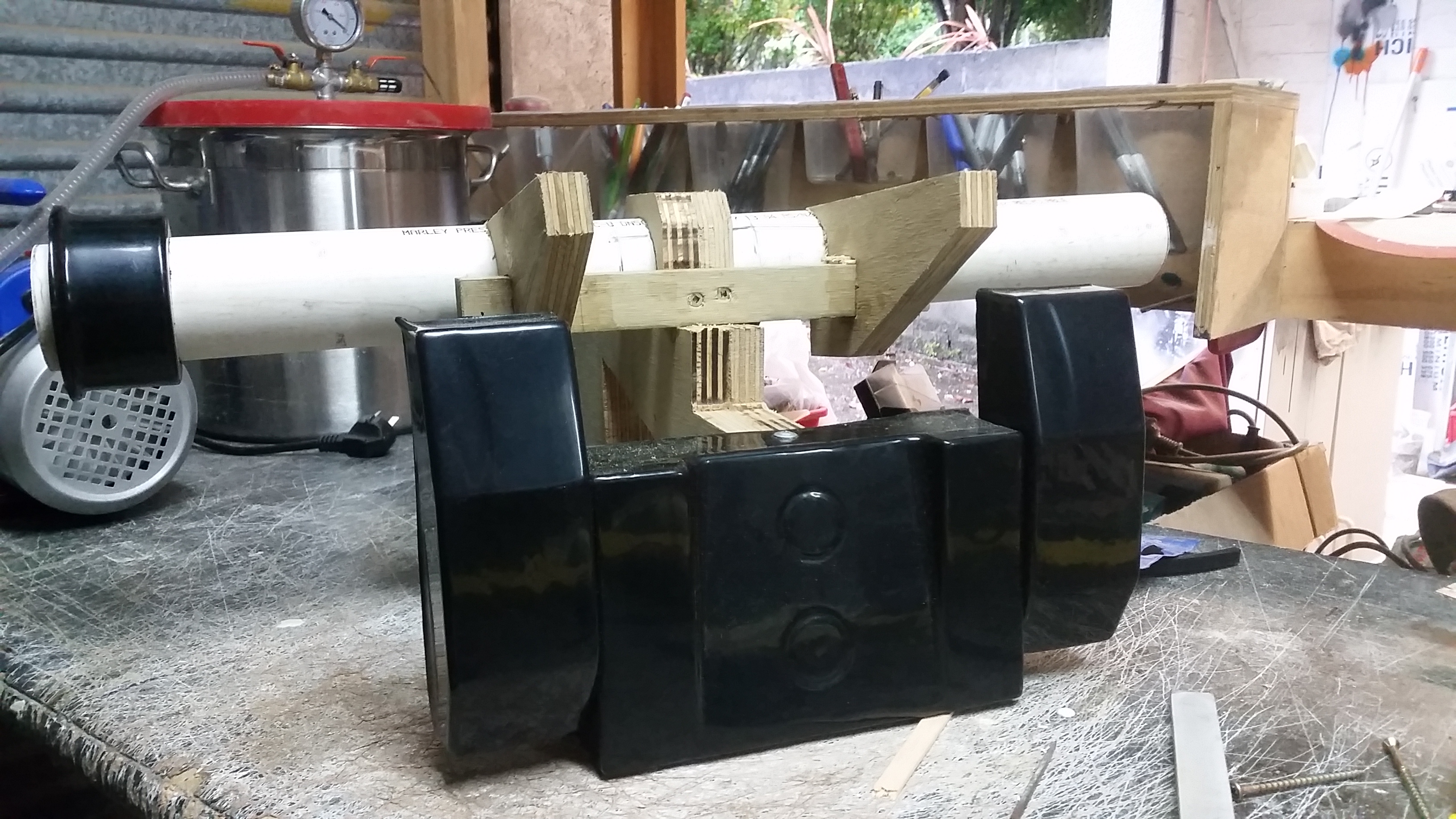

here's couple of groin pics. The plan is make a 20mm ply frame and fabricate some PVC dressing for the frame and the 'hip' pipe. This will change the overall look of this part but it should be covered in pipes and stuff anyway and it will be strong enough to support the torso but also allow the robot to stand up and sit down and the ply frame not attached to the hip pipe. Make sense? Hope it works.
I've got the groin slightly too high I have to lower it a bit otherwise I think it looks pretty close.
Next step is to try and attach the legs to the hips and then I reckon I might have made some progress!

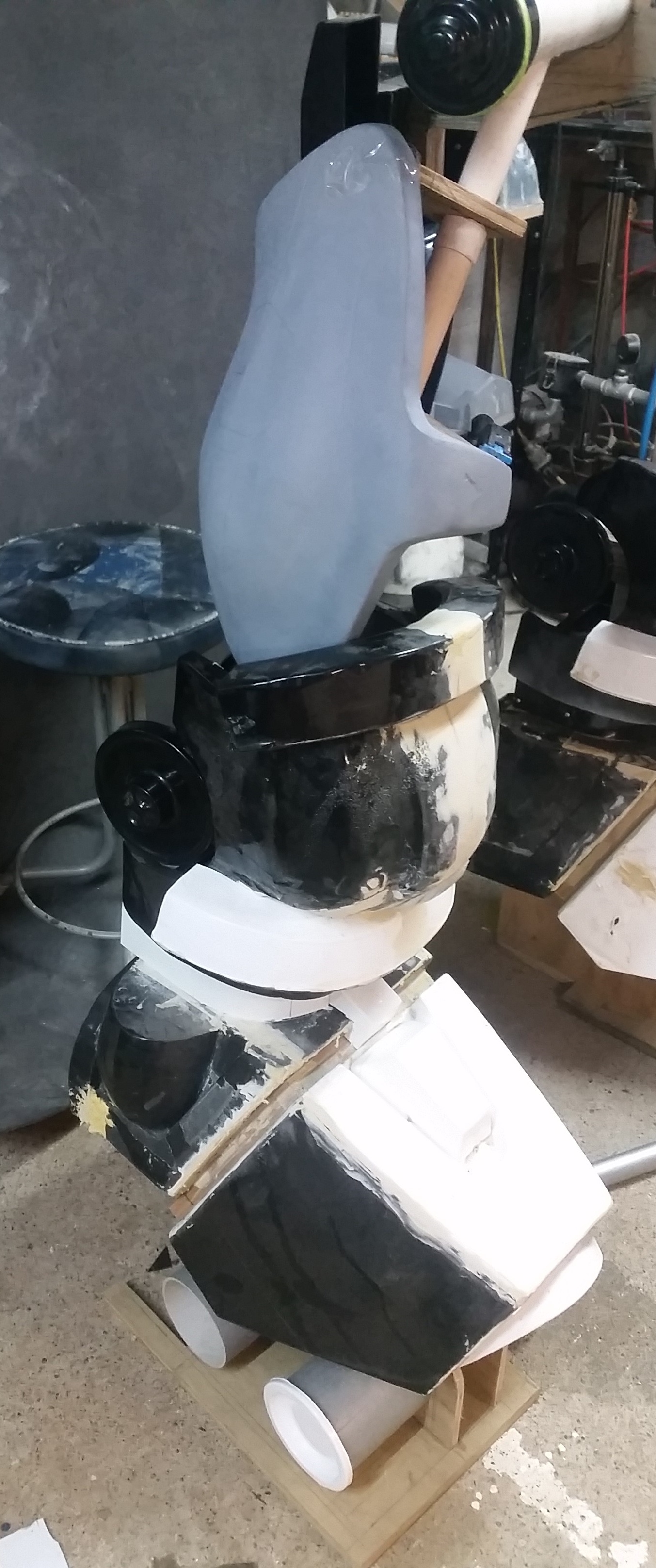

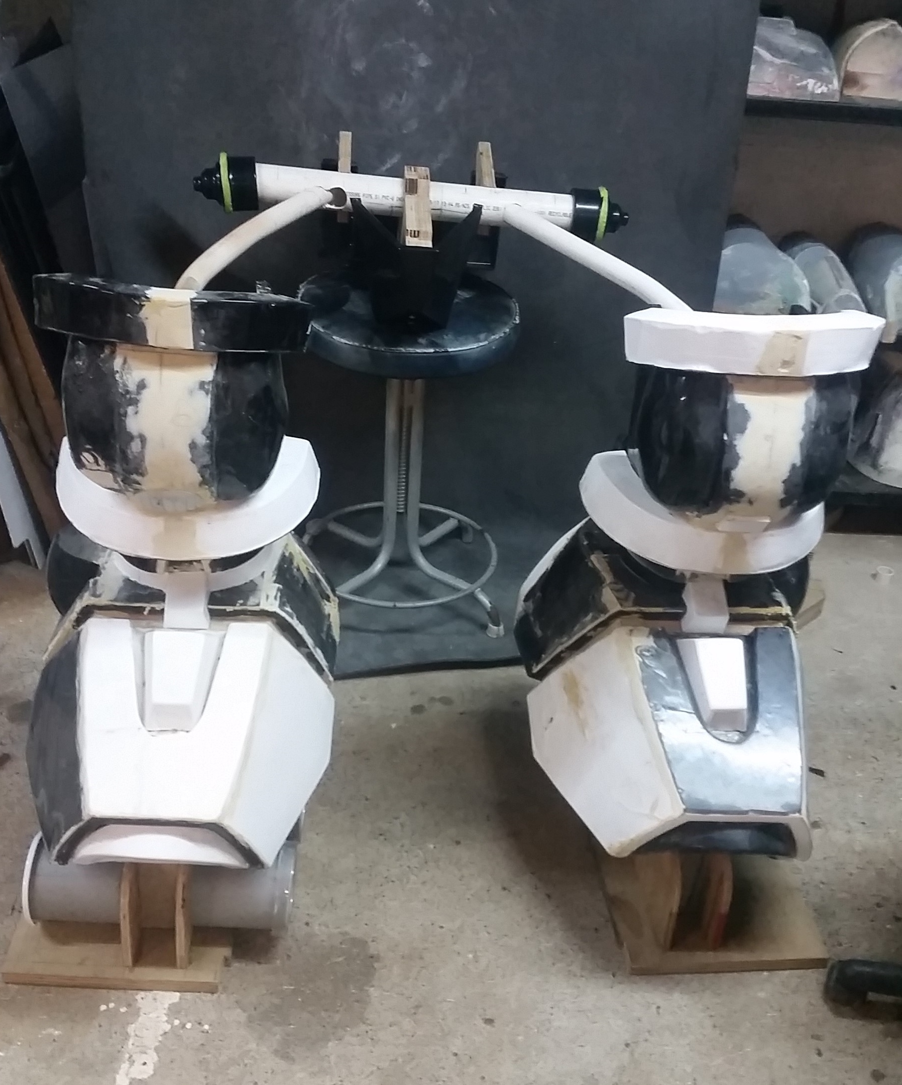

Hey all small update. I've been mucking around with PVC pipe for the thighs and after a bit of heat bending have a basic armature sorted out. It will allow the robot to stand up and sit down. I might look at changing the thigh armature to aluminium (you were right Blax :)) as the PVC might be a bit soft and those thigh pipes have to hold up the weight of most of the robot. But I'll fix everything together before I make up my mind.
I've tested fitted the one thigh piece I have to get a feel for how it will look. Overall it's looking about right. There's not a hell of a lot of room in the thigh area for pipes and hoses which is fine by me :)
ha ha it was quite funny sticking together the damned legs and hip pipe kept moving around all over the place so nothing's terribly square in the pics. Mind you I'll be making sure the robot isn't too straight when I do the final fixing I want to avoid it looking too wooden
