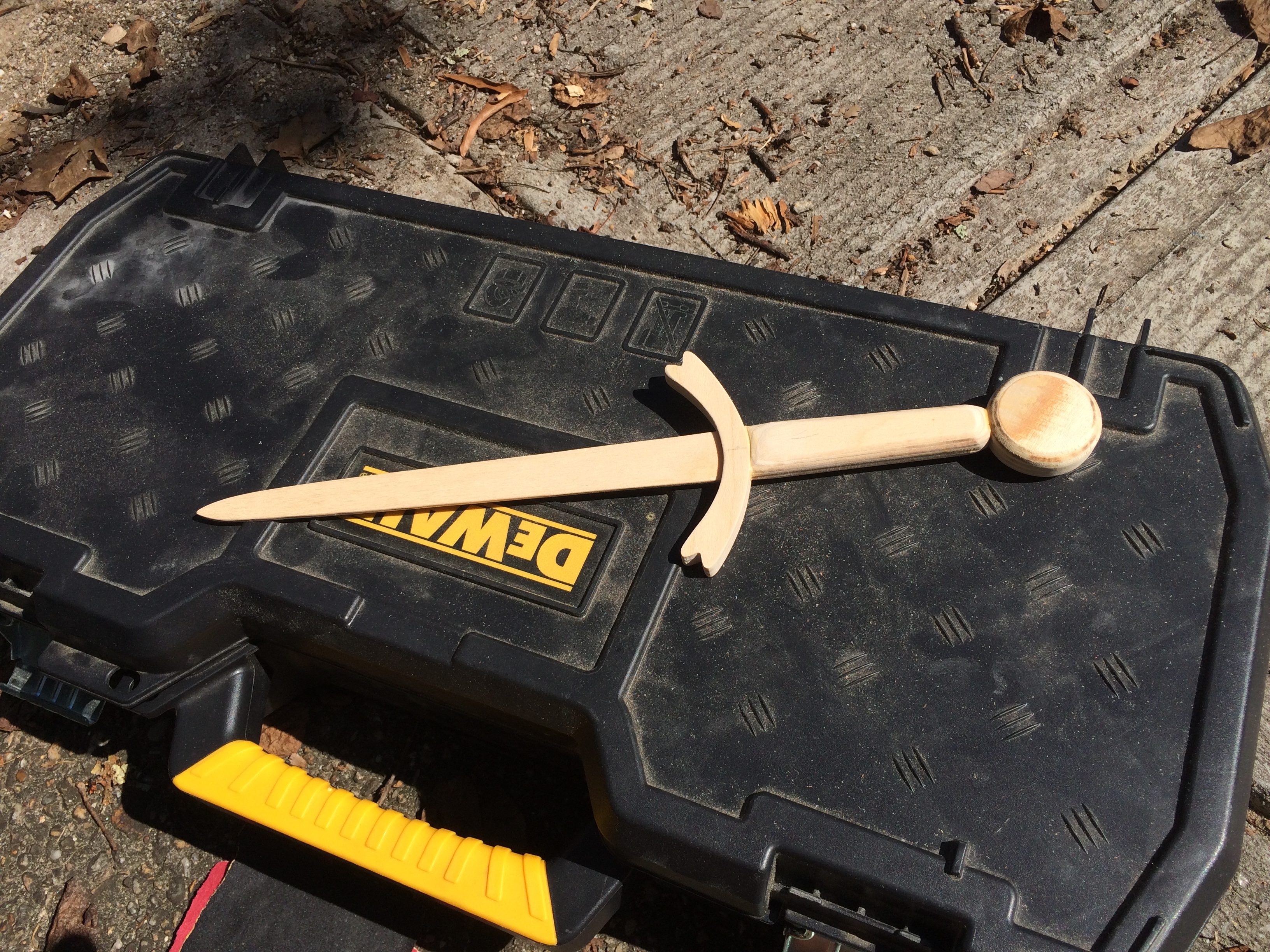

Here's the blade and the tang cut out. Two pieces of plywood are being glued to the tang which will be the handle.
The pommel, crossguard, and scabbard are all cut. I used a roundover bit to contour the edges of the pommel and I'll do the same on the scabbard. The scabbard is two layers of plywood sandwiching a third that has been cut out to the form of the dagger. That way the blade will slide right in with a little sanding since it's the same width wood. The crossguard is also 3 layers of plywood with a gap left in the center for the blade to slide through.

And everything has been sanded and glued up. Fit's nicely into the scabbard too.

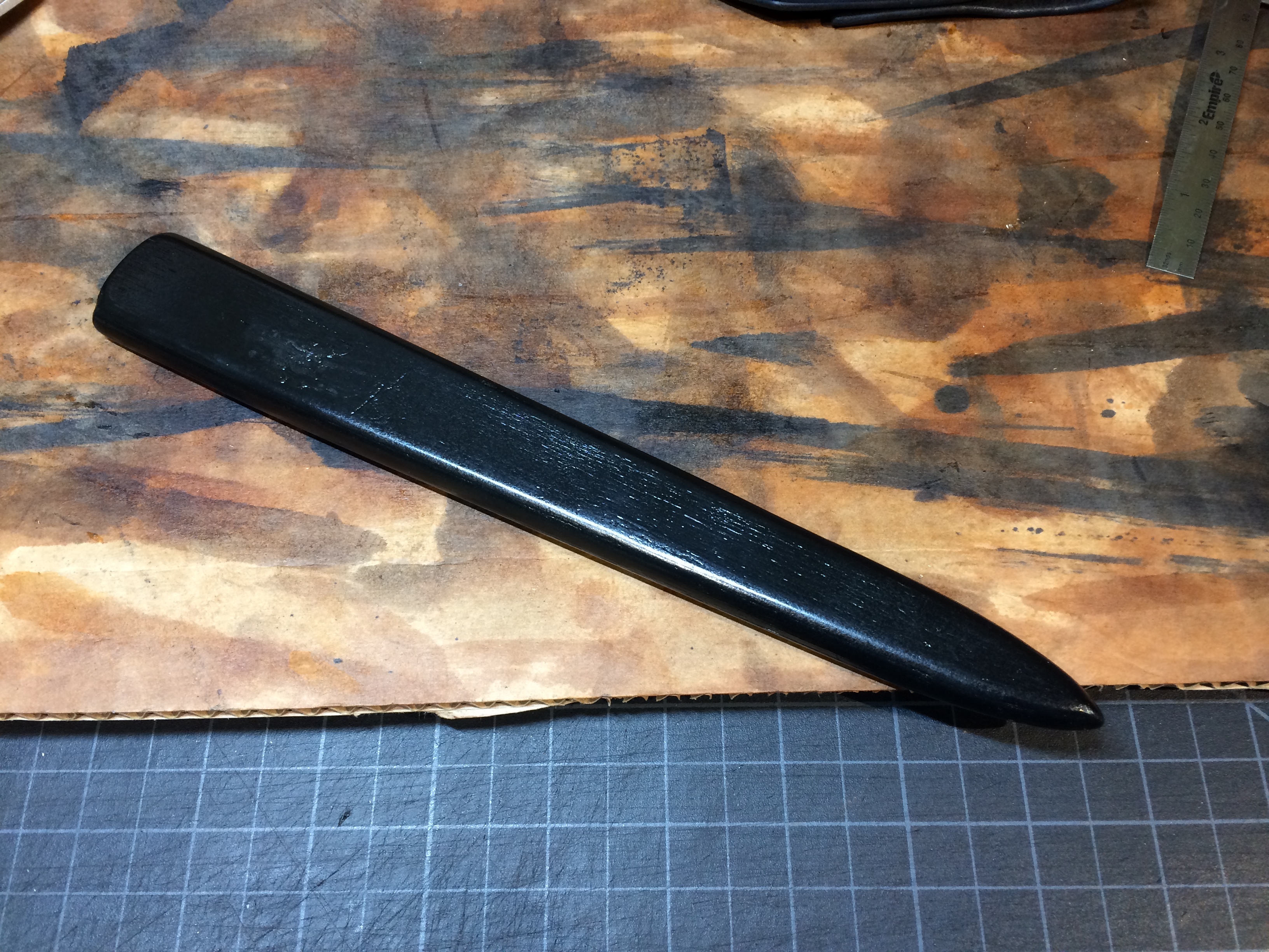

Here are the scabbard and dagger all painted up. Finished with a few coats of spray lacquer to try to protect the paint a bit. I've got the dagger handle and a strip of leather coated in contact cement so I can install the grip. I'm gonna leave the blade unpainted for now since it won't really be coming out of the sheath and it fits pretty nicely in there as it is.

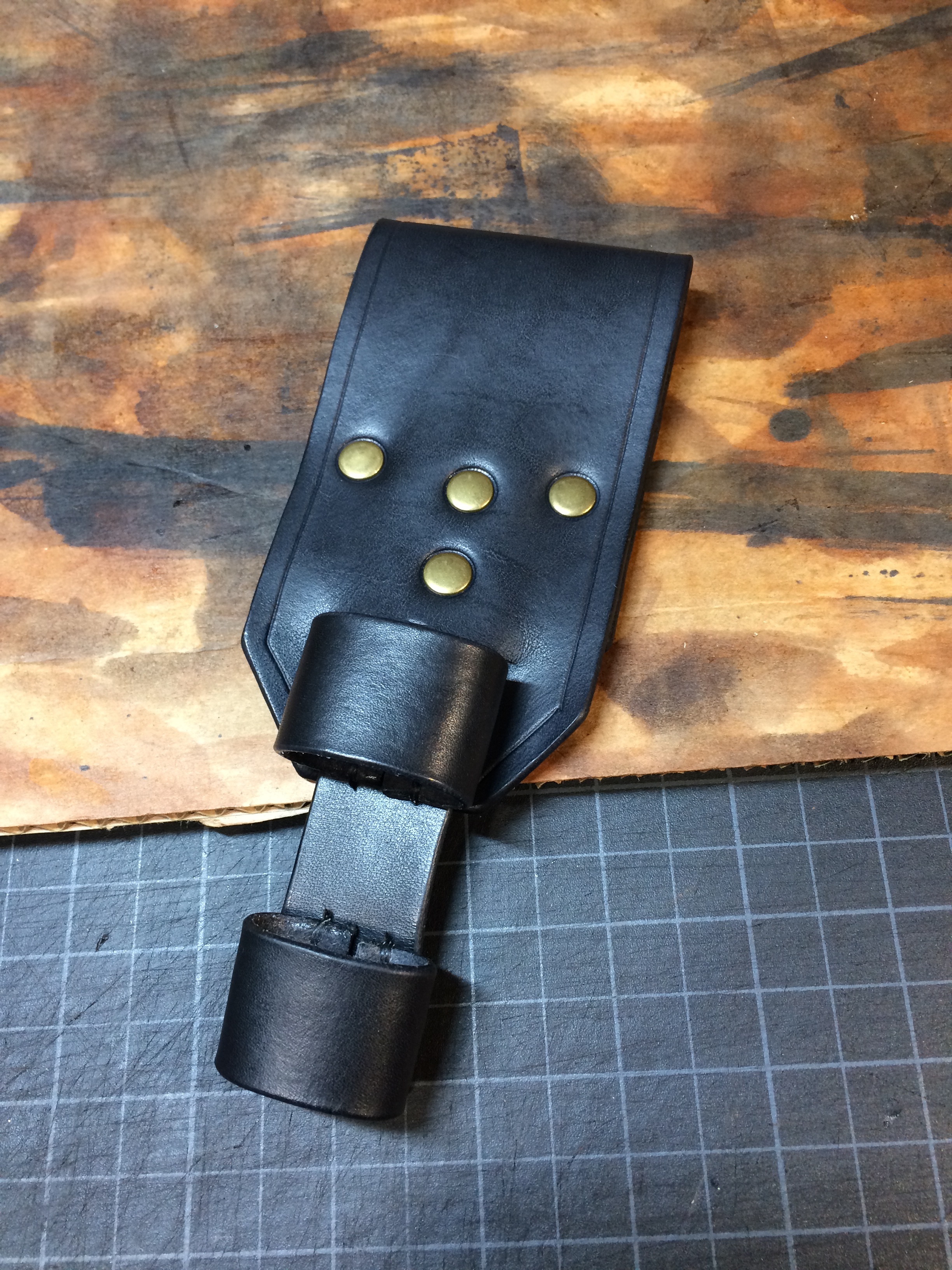

I made this leather piece to hold the scabbard in place as it appears in the picture. It fits snuggly through the leather loops and the big loop goes over the belt. I also made up this little leather wrist guard that Jorah wears in a couple scenes.

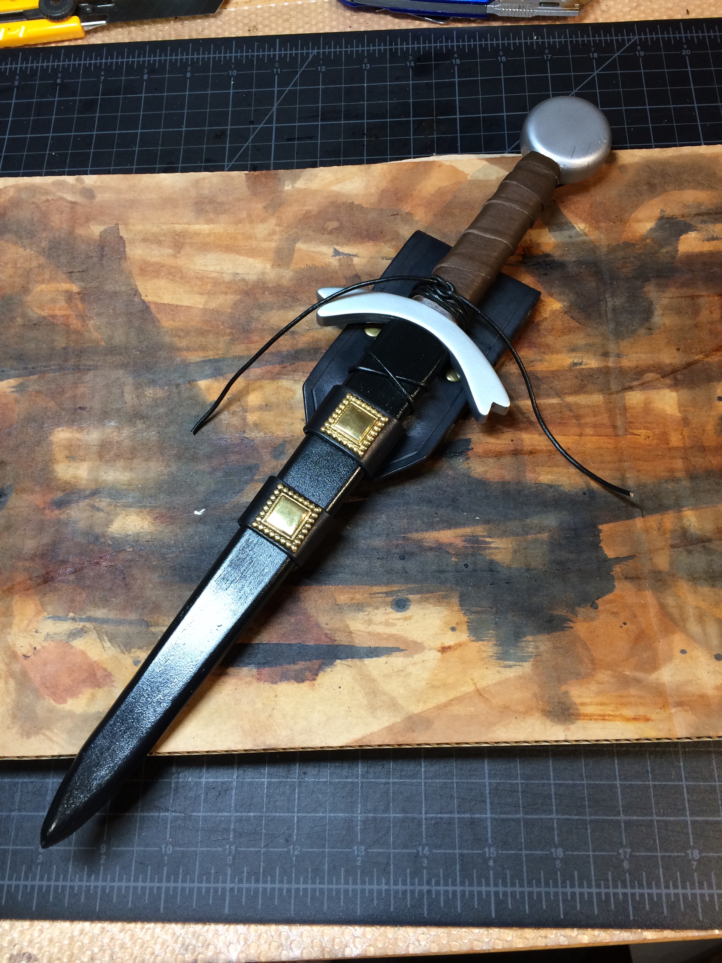

Pretty much done. Got the ornaments on and rigged up some lacing to secure the scabbard and dagger. Matches the sword belt nicely. Still need to do some weathering but I'll leave that for another time. I'm racing to finish all this and the season 1 skirt up in time for the Pennsylvania Ren Fest this coming weekend.
