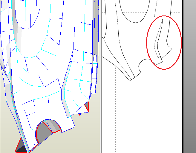

2: i was looking on the files and spotted a little thing on the thigh, thigh problem.png i don't know what i'm supposed to do here?

2: i was looking on the files and spotted a little thing on the thigh,View attachment 302344 i don't know what i'm supposed to do here?

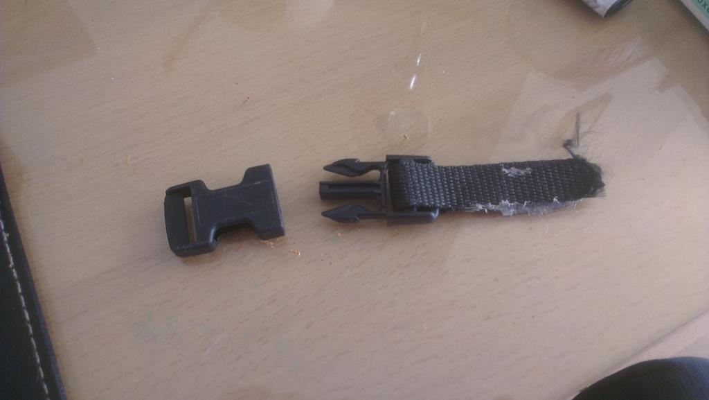

best way to connect all parts is by using elastic straps and things like these:

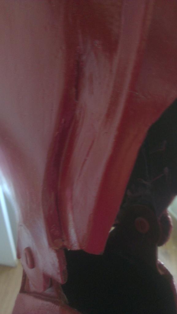

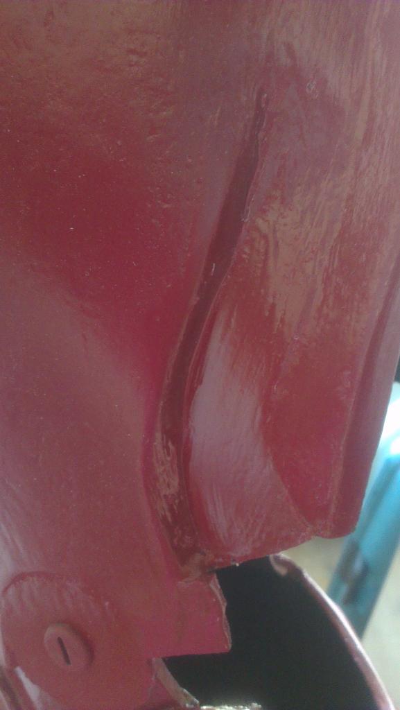

and that thigh problem you have: cut the solid line and make a valley cut on the dotted line onto the foam so that it becomes like this (somehwat damaged armor but you get the idea:
