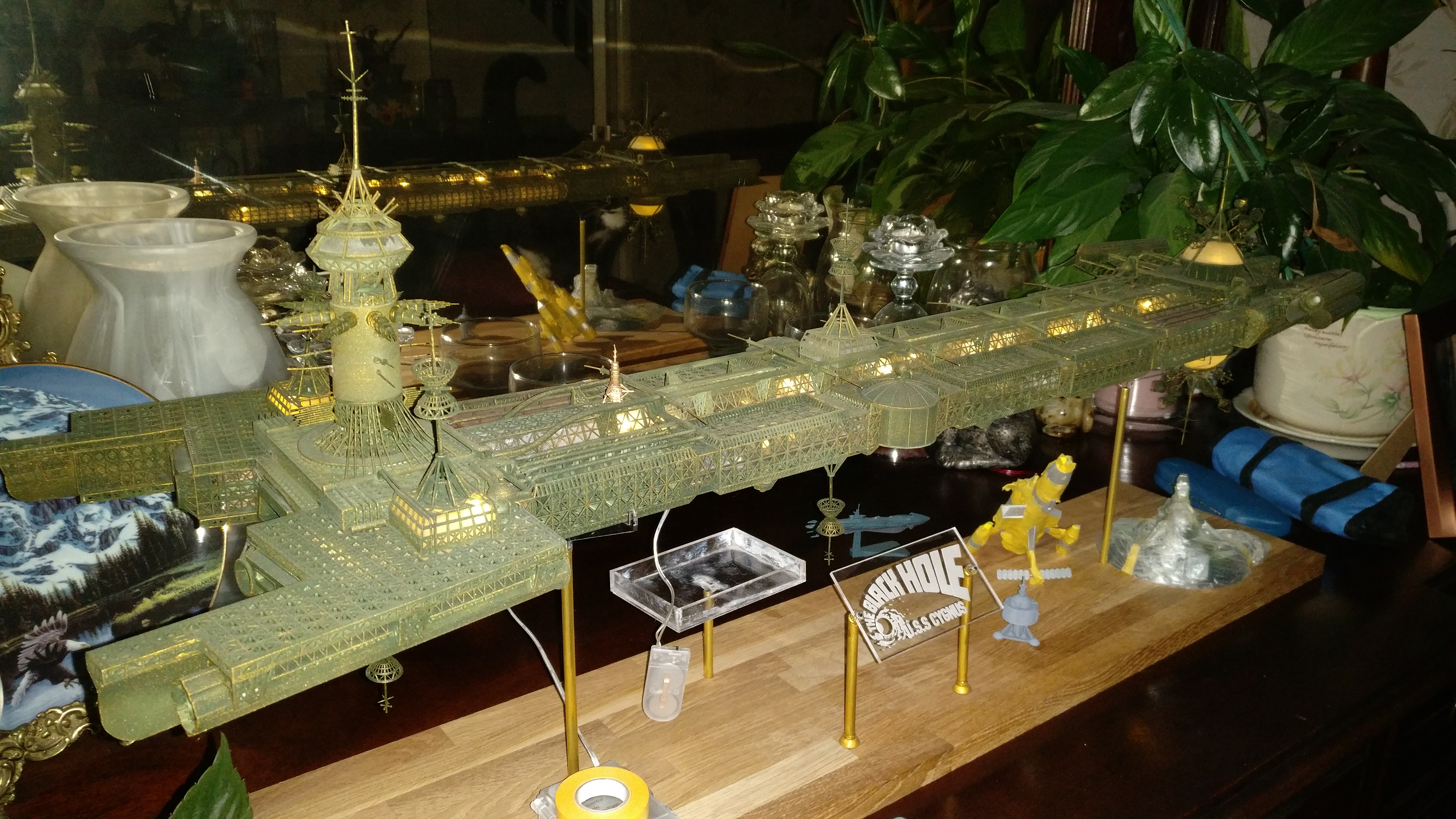

Agreed. The setup I use cost £45 on ebay, around ten years back(Christmas sales).I replaced the actual brush a week ago!
Current prices will net you one for around £65,including a brush.
My current project?
