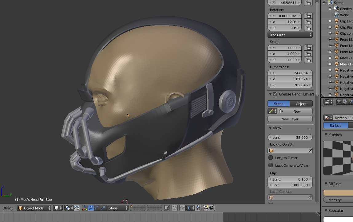

I'll tell you my story. I have bought 2 helmets from them. One was captain America and the other was Bane from the dark knight rises. The shape of the head they modeled is different than my own which made the helmet look a little goofy on me (large gaps where there shouldn't be).
Here is their model sized to hit my head front to back and side to side:
It just doesn't fit perfect and there is nothing to change that once it is a .stl file. Also, Do3D models are so super high definition that my computer was having a tough time working with it.
In the end, I made my own 3D bane mask (albeit not as detailed) and was much happier with the fit and look as I was able to hug the shape of my head:
The ultimate answer is, it's impossible to make one file fit all.
