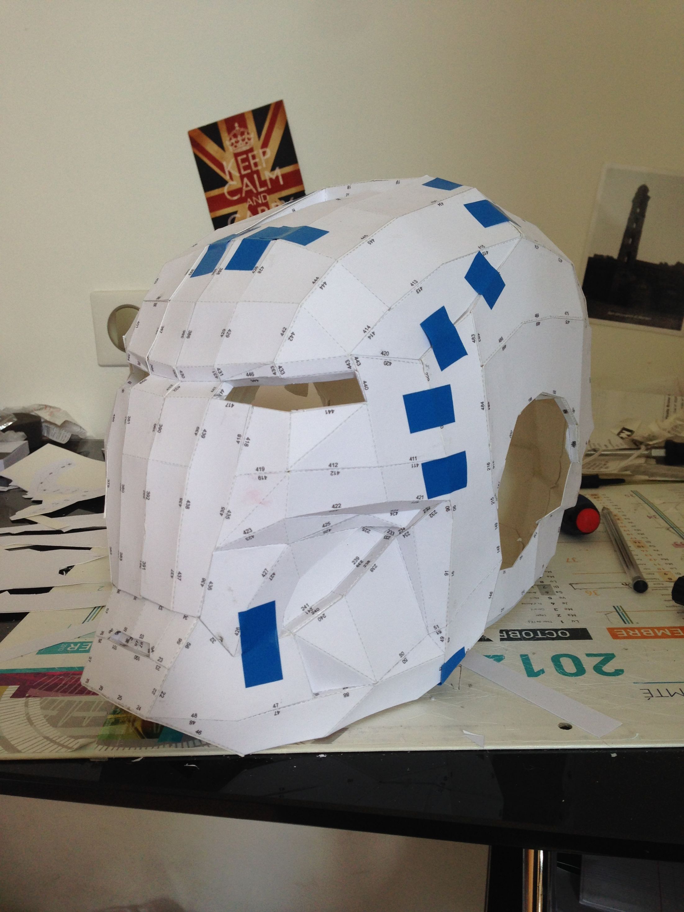

I choosed to do a pepakura helmet, so I started like everyone with a paper helmet :

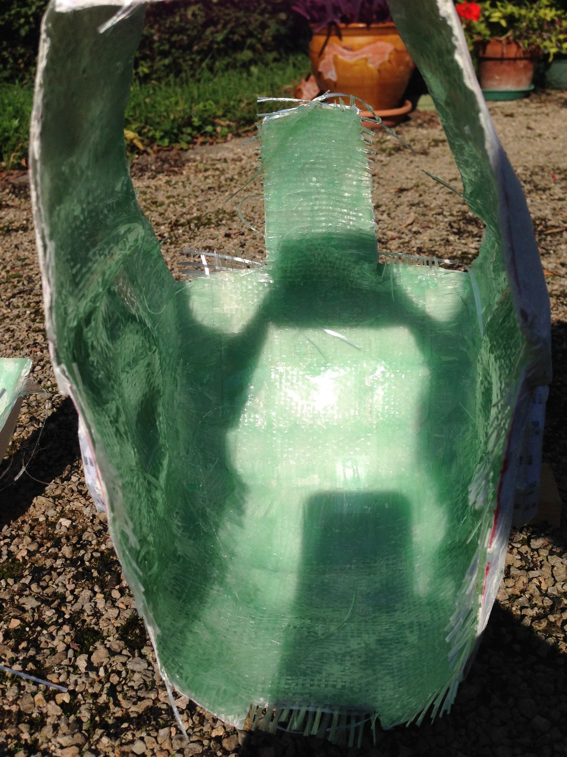

Then, some polyester resin outside, and the first coat of fiber glass + resin inside :
(It was the first time I did something with fiberglass, and I have to say it has been a pretty nice mess. Fiber sticking to the glove and everywhere..)

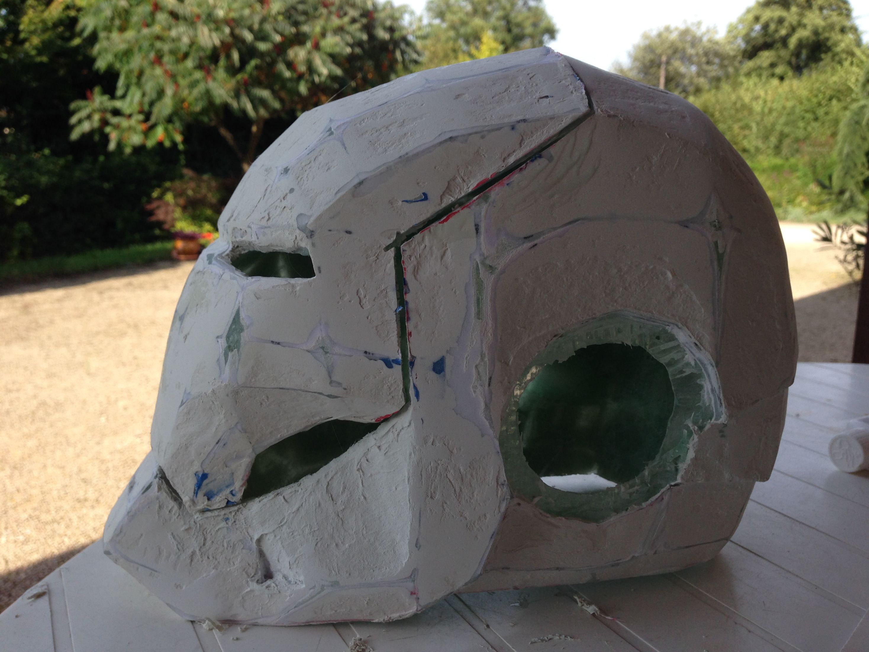

Since the paper helmet's shape was not very accurate, I had to apply a pre-coat of bondo to roughly smooth out the shape (if any viewer is french and is wondering what body filler is equivalent in France, the best is the Mastic Polyester, by Sintofer).
I choosed a fibered bondo (with some fiberglass in it, to had a little bit of resistance, and since I will have to use thick coat at some points).

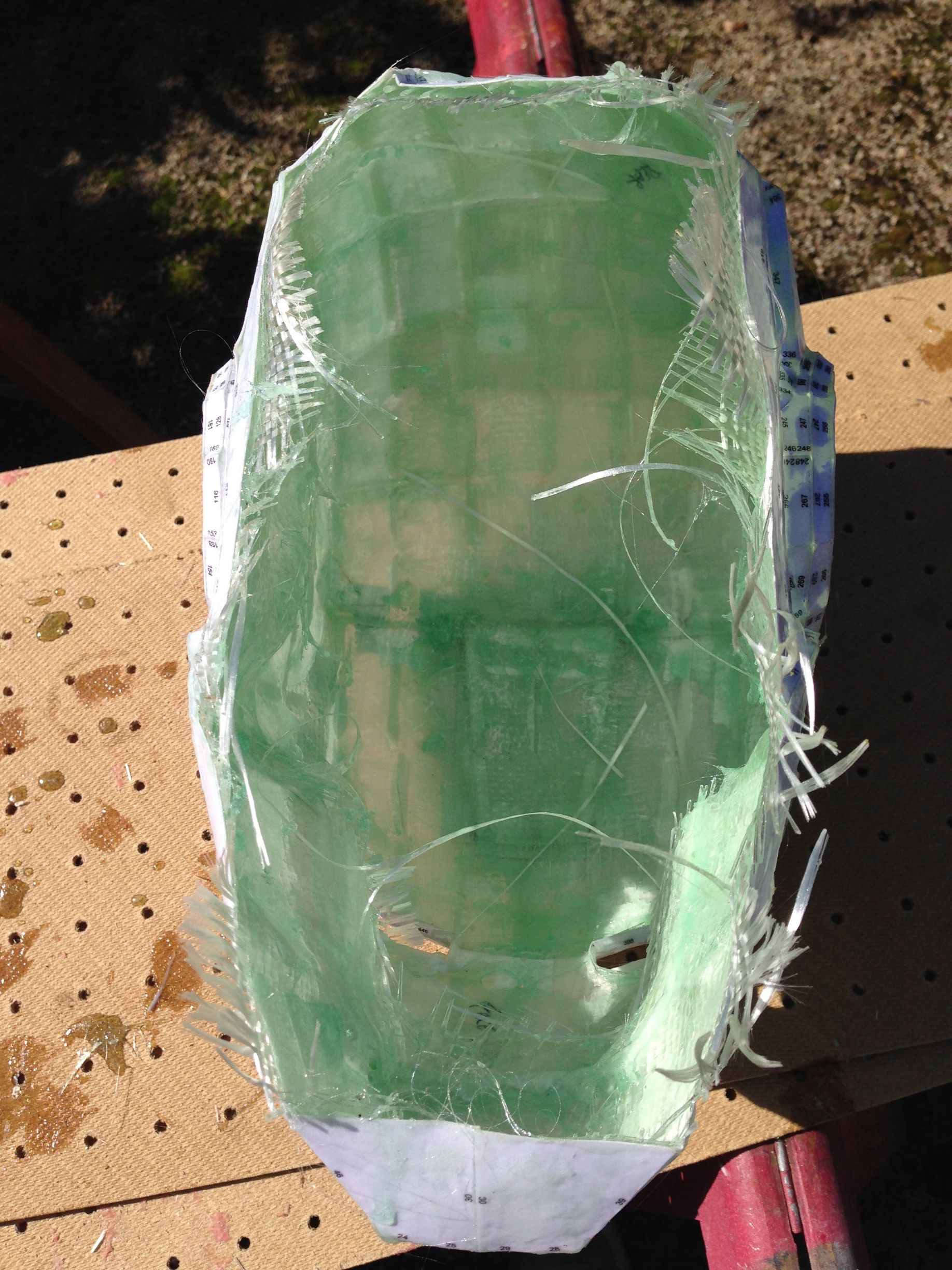

I had to sand it down to the resin inside at some point, and since it was my first time using such a resin, I decided to had an other layer of fiberglass + resin inside : to had a little more thickness and strength. After that, the inside was also a lot more smooth than before :

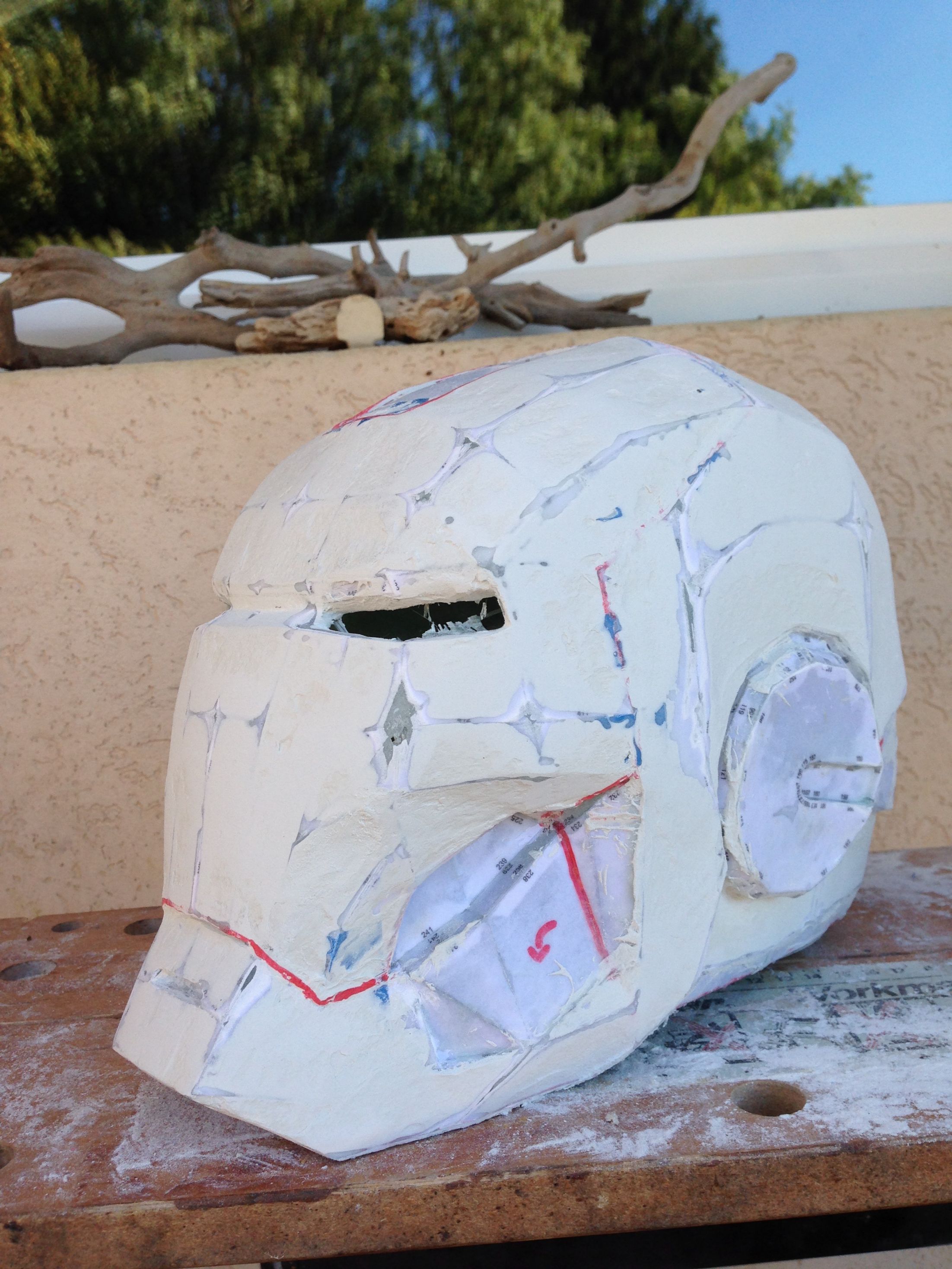

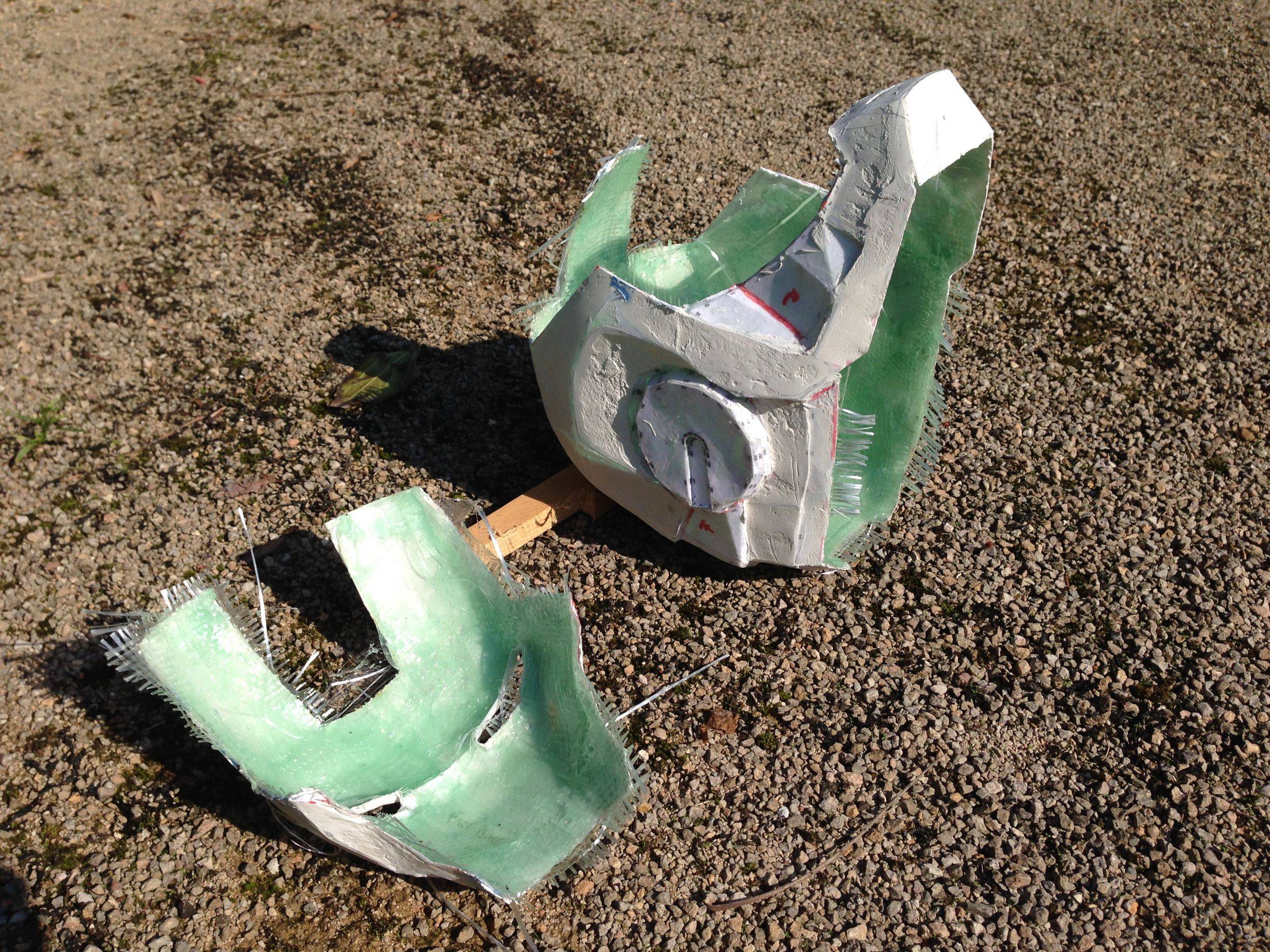

And the second coat of bondo, which I'm still sanding. I also cut out the ears, the paper work I did was horrible, and I thought it'd be easier to do with two rings of thin wood or something like that :
