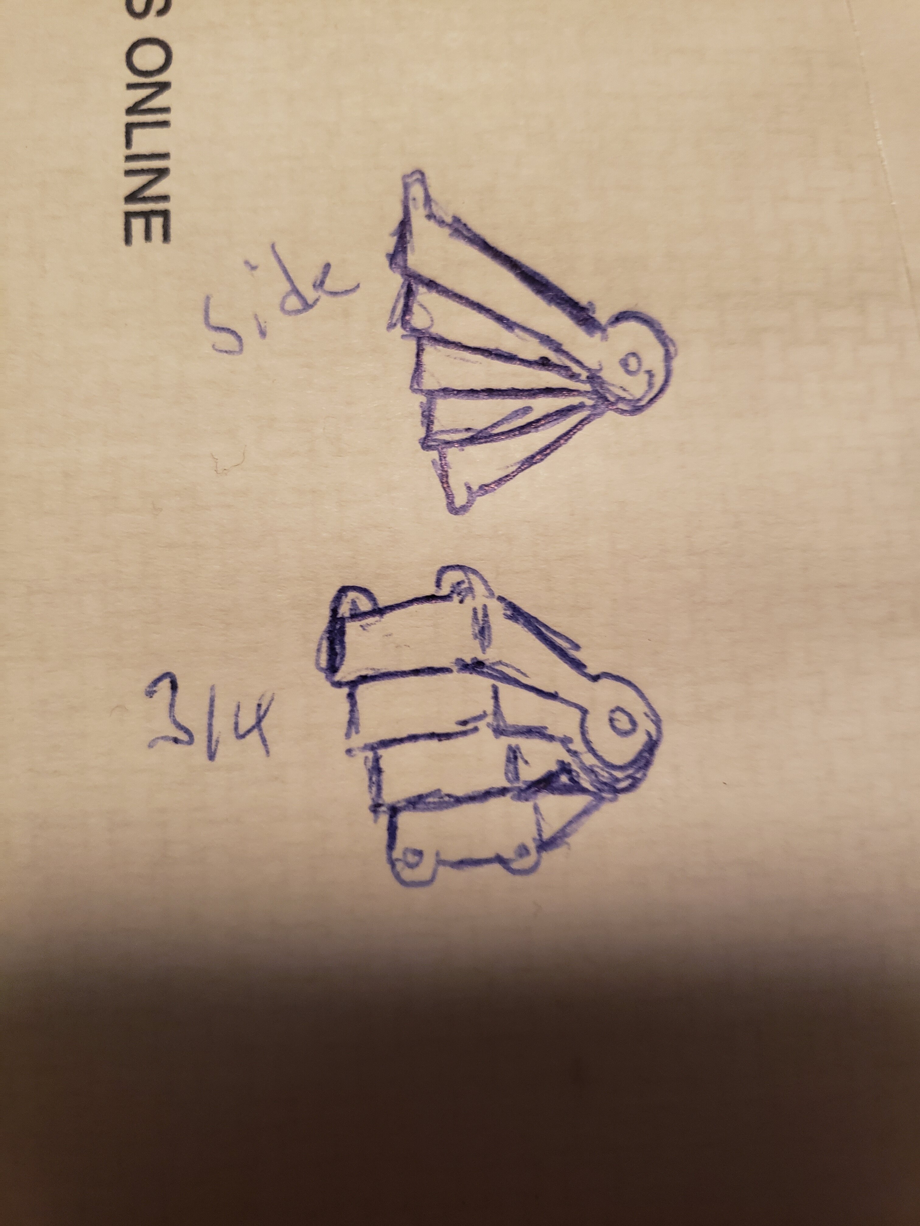

Making them out of pieces of foam would be my best guess as well. I would consider attaching them to the undersuit instead of the armor.
i think this is the effect they were going for. Layered. Anchor to top and bottom. Place lips on inner pieces to pull open.
