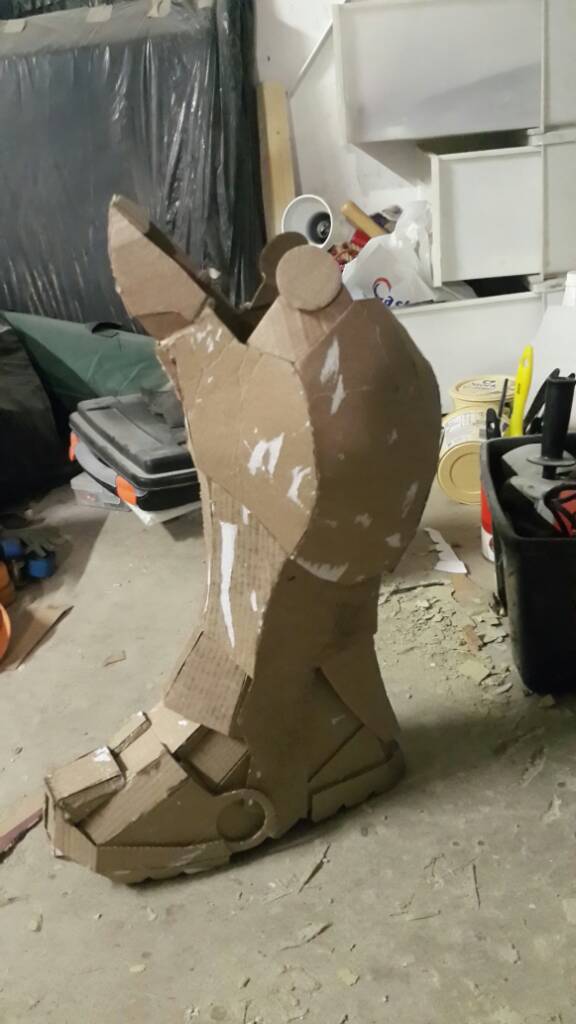

Still making very slow progress on the chest and back... I'm trying to get things done that I can do inside the house, where it's warmer. So, I found a more suitable cardboard and used it for the shin and boot. BIG difference... the build is a lot "smoother" than that of the chest and back.
Sent from my GT-I9500 using Tapatalk

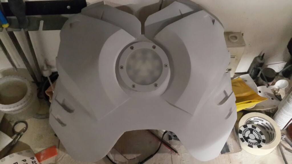

I've been playing around with the unibeam section, not movie accurate, I know... but ultimately this suit will be standing in my sons room, so I'm just wanting it to be cool for him.... back light has been put in place, I just need to move the switch to a more accessible area once the suit is assembled.
Excuse the messy workbench.
Just need to clean up the " rib vents " thingymagigs, goodymagafters, what ever their called, and some fine tuning, then this puppy's done. Finally.

The chest and back have been a pain because I used a single corrugated cardboard that was 5mm thick, which caused some headaches. The boots and shins are built with cardboard that is about 2.5mm thick.
Much better, resin sets in well and less bodyfiller.

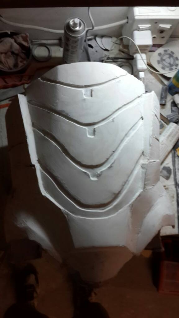

So the back has become a pain in the ... to the point that I've sidelined it for now. The abs / cod piece has been a bit more forgiving. Some progress pics attached :
( sorry about the poor quality )
First round of bodyfiller almost done...
