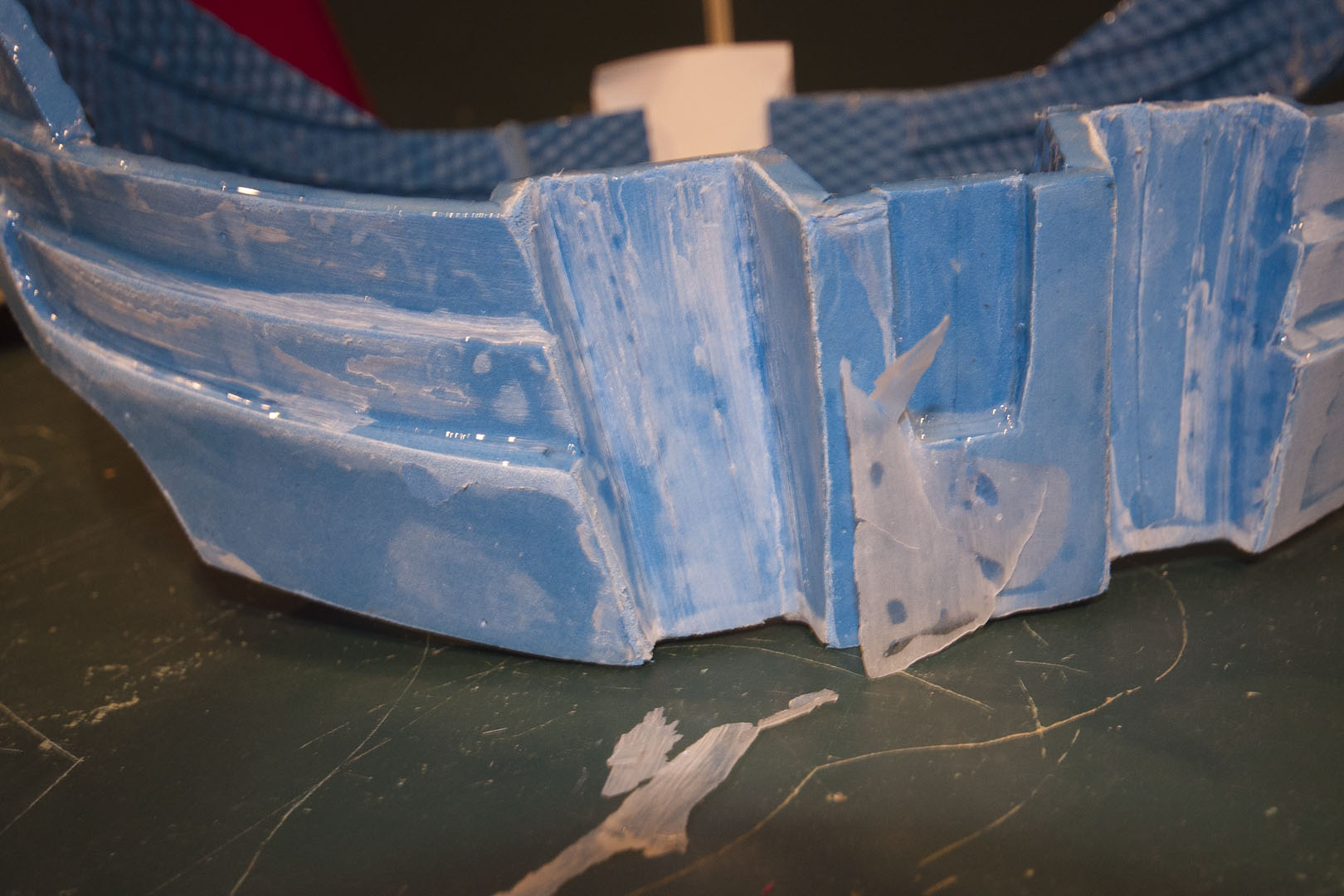

I've been lurking here for quite a while, first joined to get information when making my first Iron Man suit at Halloween last fall. I've since moved on to my second suit, and having done the fiberglass method, (more or less, only the top half of that suit got finished in time) I realized that the hard shell was very difficult to move around in in and decided to make a semi-rigid foam suit.

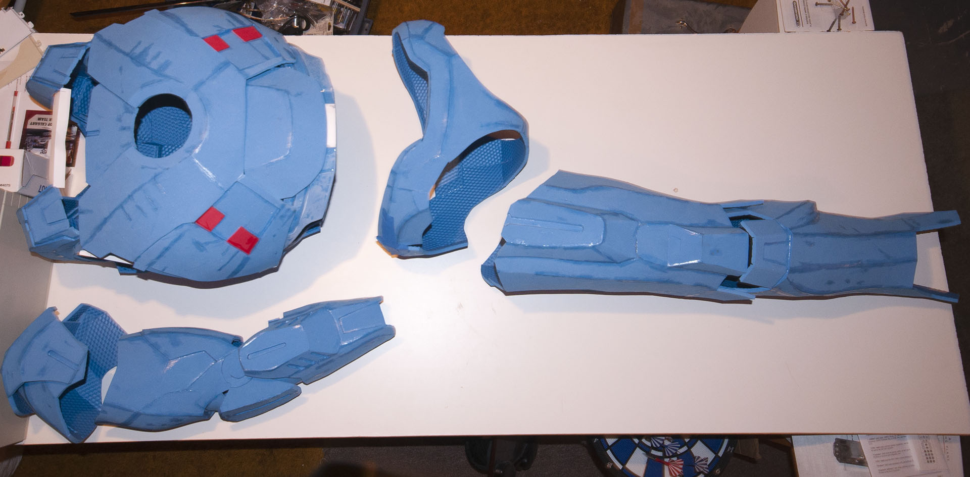

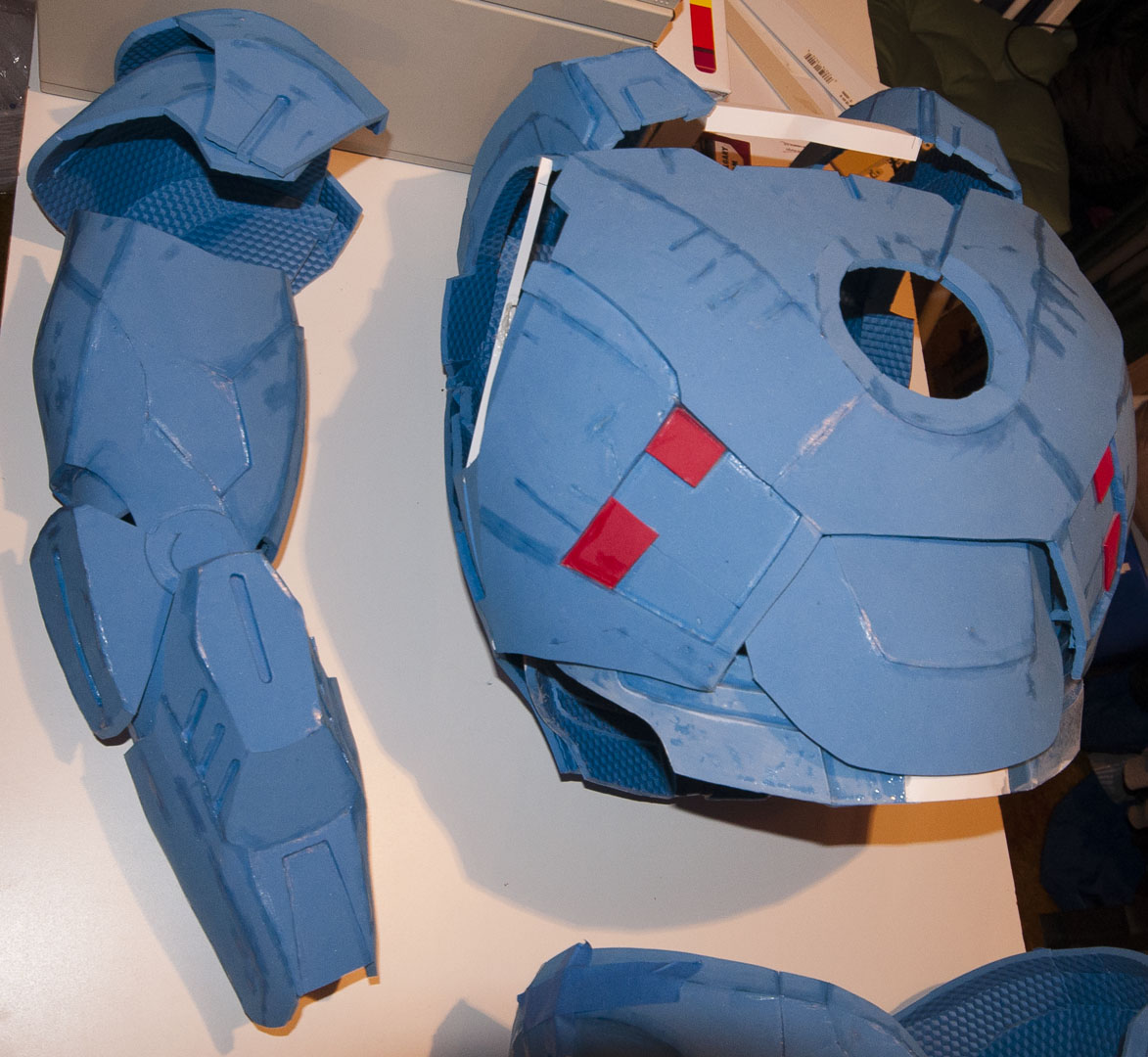

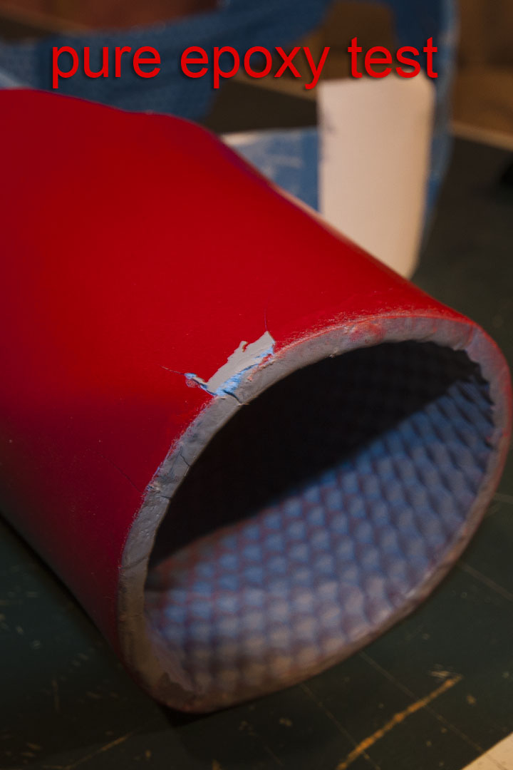

I've seen great results from the plastic coated foam method and I've especially liked the results that Shelfside was getting. Anyway, I've got a large portion of the foam work done on the suit, as shown in the picture below. I'd done a few tests of the plastic coating a couple months back, before I got fully into the suit. On those tests, I didn't see any delamination. One test piece was PVA sealed foam with 2 coats of epoxy resin over top, similar to XRobots' method). The other is 2 coats of epoxy applied directly to the foam. Having sanded and painted both pieces (not to perfection, but at least with enough vigor to test them) I was satisfied with the results of both and they seemed quite durable.

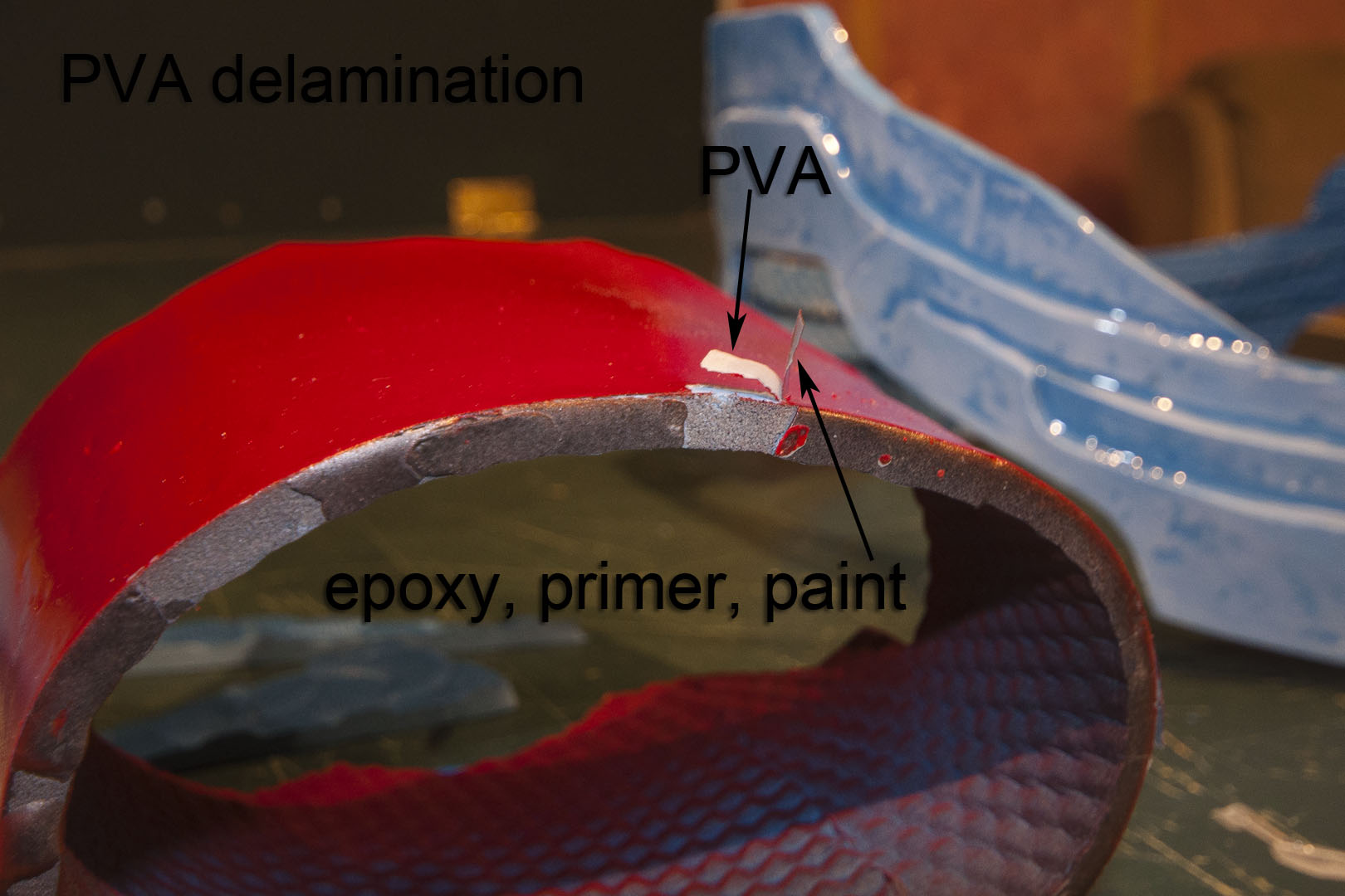

Now, to the present problem at hand; I've started coating and sanding some of my pieces using PVA to seal them, and the delamination is catastrophic to say the least. The epoxy is peeling off the PVA as if it's barely bonded to it. I thought, "well this didn't happen with the test pieces!" but upon going back to my test pieces and beating them up a bunch, I found that the PVA sealed part was actually prone to delamination as well.
My question now for the community is whether or not anyone else has seen this using this method? This was 3 coats of 1:1 diluted PVA and one coat of pure PVA, followed by 2 coats of epoxy resin 24hours apart.
I've attached pictures of the test pieces: the PVA piece clearly shows the PVA layer delaminating, and the epoxy layer peeling off of that. The Pure epoxy test shows where I could peel the paint off, but this was due to the fact that the bottom of this piece had the foam exposed during sanding, so the primer didn't take to the exposed foam. My assumption was that this would have made this location a prime spot for peeling if it were to happen, but I could not separate the epoxy from the foam on this piece. Finally, I've posted a picture showing the most recent peeling on the spine area, as you can see it's quite extensive. At the moment my plan is to just coat the rest with epoxy, no PVA, but I'm confused why my delamination is so extensive, while others on this site have had such great results when still using PVA.

could it have something to do with the type of epoxy resin?
xrobots uses a resin that forms a plastic coating, not just a standard epoxy resin.
Did you primer before pva....or pva before primer?...picture looks like pva first. You using the same glue as in the test? Doesnt sound like a plastic coating problem. Sounds like pva is not bonding to foam. I would try switching glue and making sure the surface of the foam is clean.

Samcrow: I realized shortly after posting this that that was the difference. The smooth-on is a polyurethane, not an epoxy. Somehow I totally missed that little tidbit. Did some research, PVA is actually used as a mould release agent for epoxy... go figure!
Texxxan: Primer is after PVA and after body filler and sanding, glue was the same and the foam was quite clean.

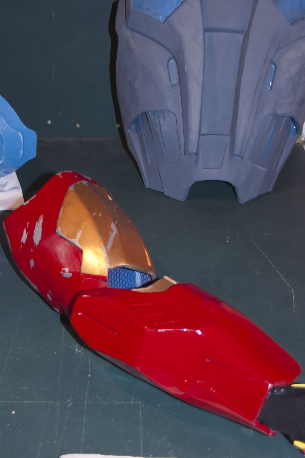

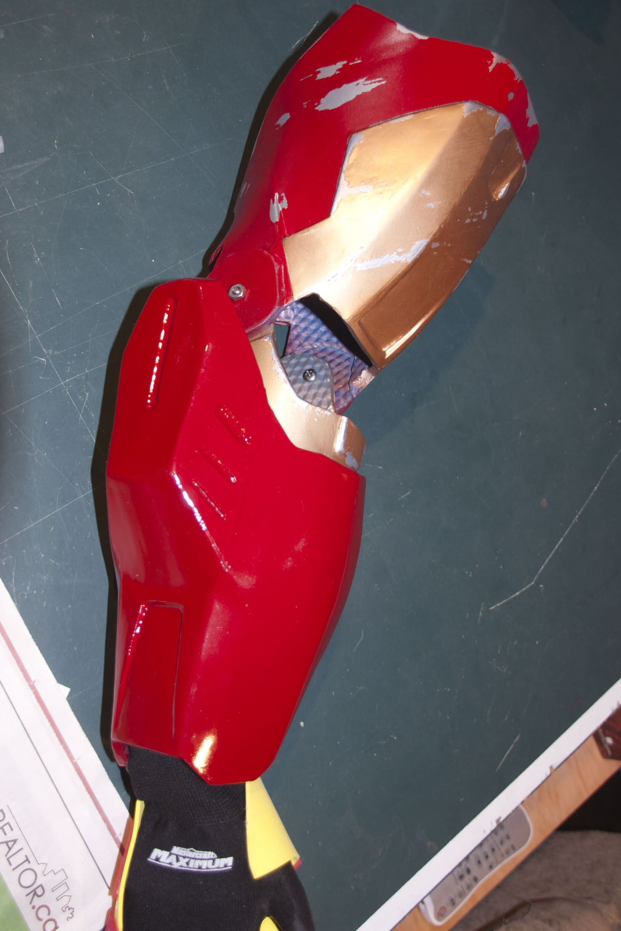

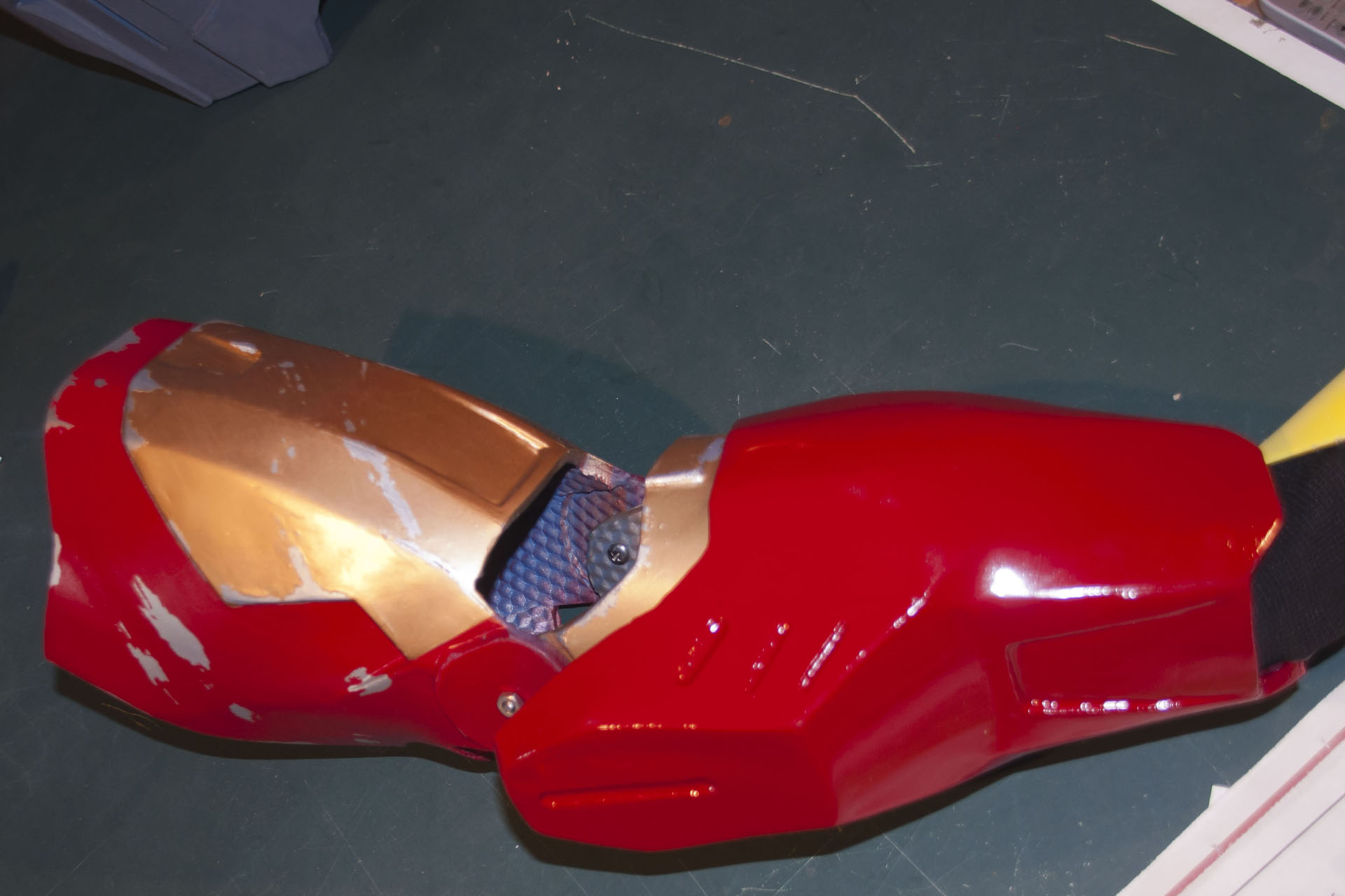

I've been coating the foam in straight epoxy, then finishing with body filler and putty and the results have been great. I've included a few pictures. Been away on business and quite busy lately so I haven't had much time to get many parts finished.
