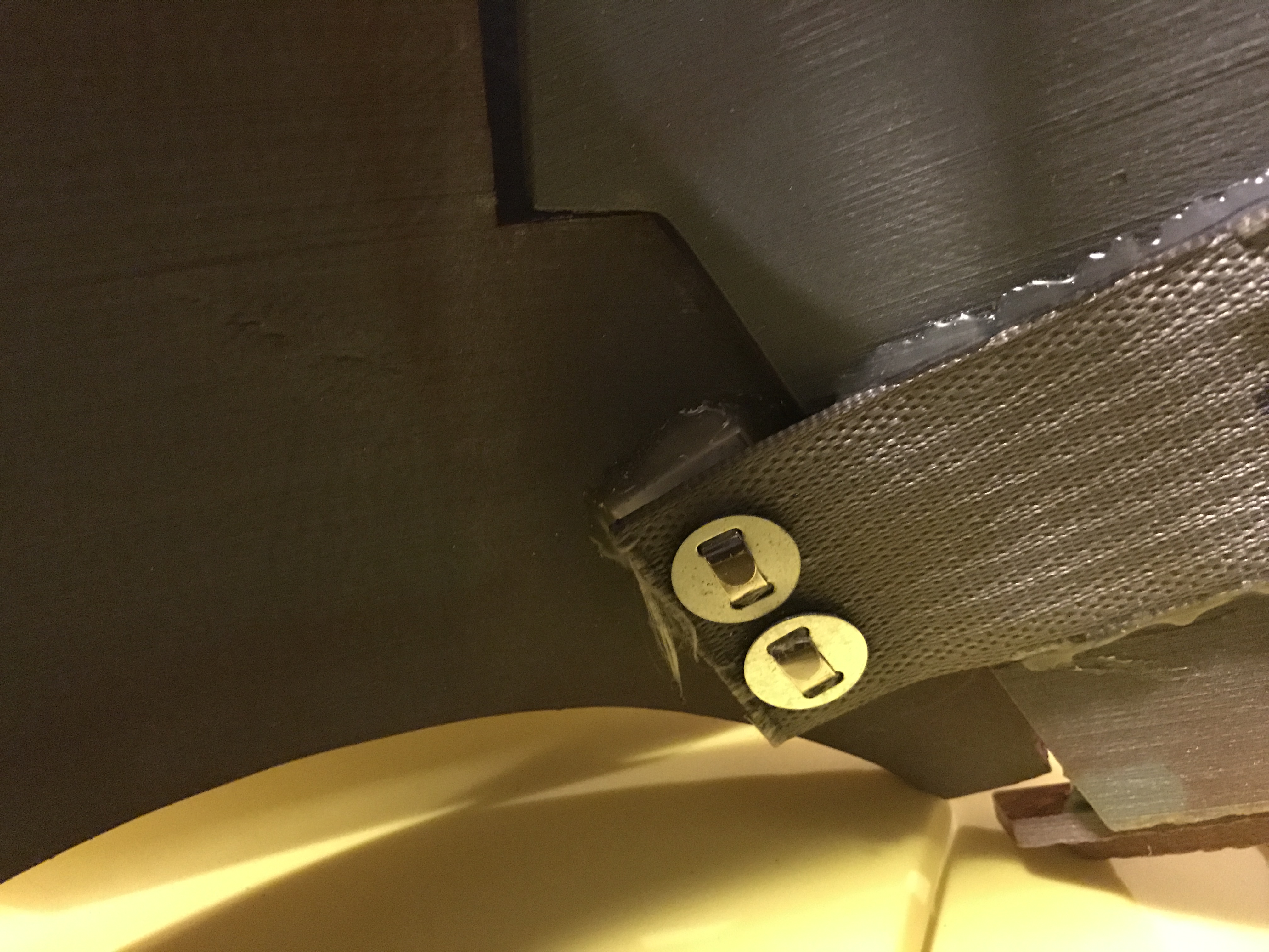

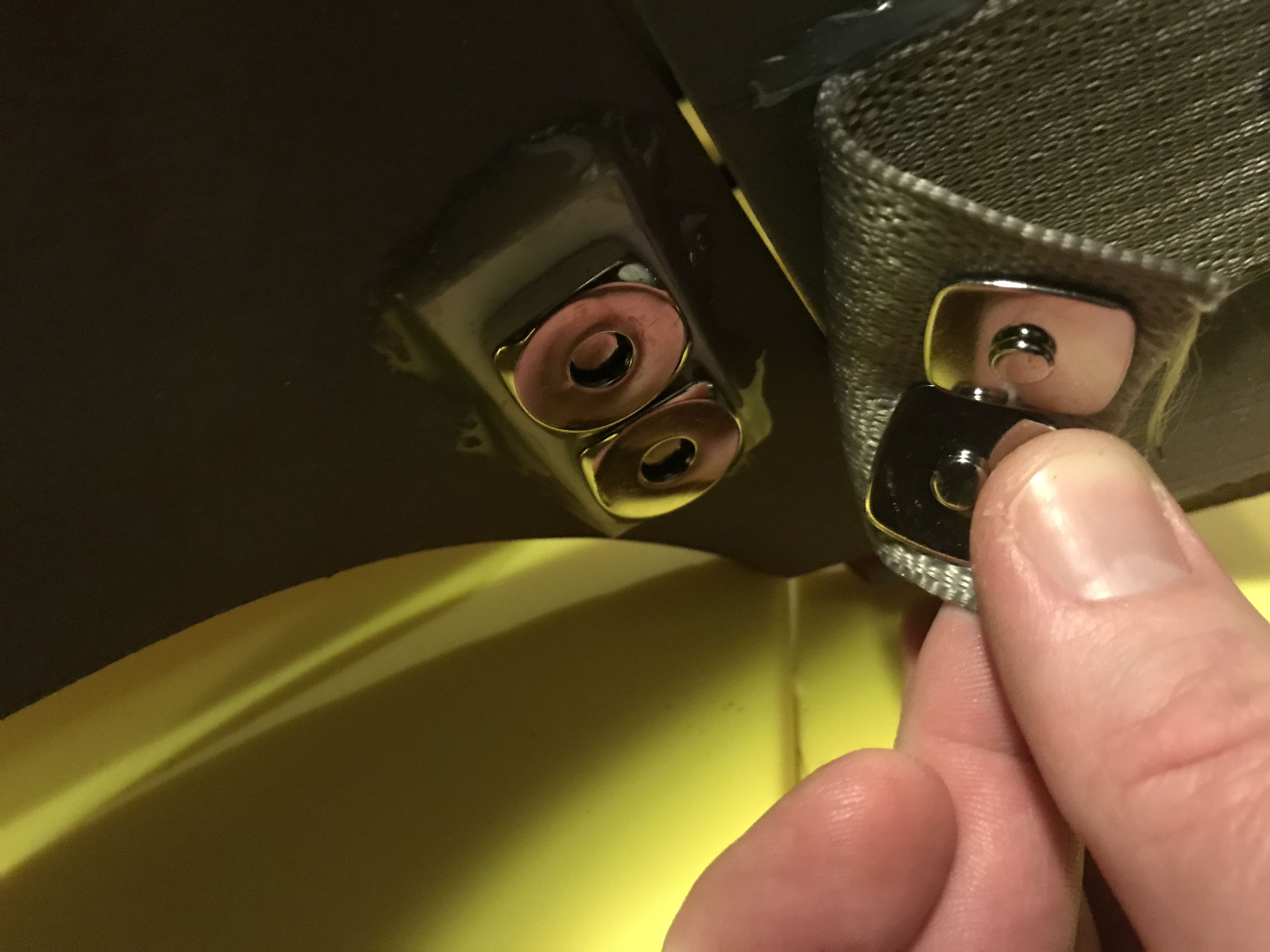

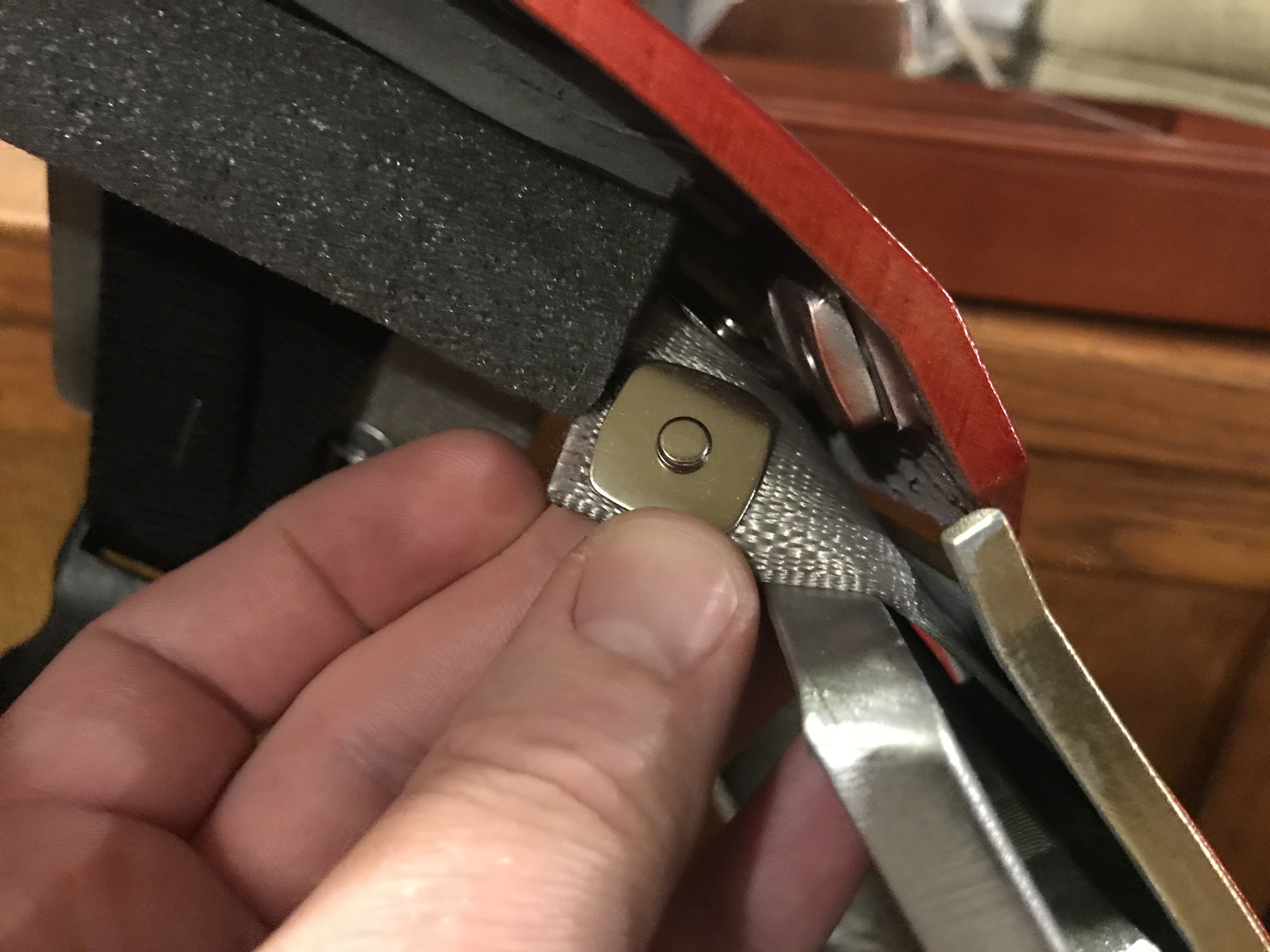

I use the square magnetic purse snaps. I attach two to a plastic plate and glue that to the armor. The other two are attached to the nylon strap. Having two seems to keep them centered and stop any twisting. They self center and the magnets have a decent shear strength. I have not had any cut loose during a troop. You can get them on the cheap from Dritz at WalMart.
