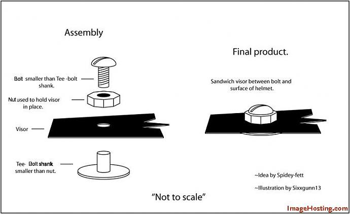

M Matthew Gresham Well-Known Member Dec 28, 2019 #1 I have a 3d file for a Mandalorian helmet that I'm gonna print as a gift to a friend but I'm not sure of the best way to install the visor. Suggestions?
zsherman Sr Member RPF PREMIUM MEMBER Dec 28, 2019 #2 This is how they do it for Boba. Maybe worth watching. Some people use this way too.

Halliwax Legendary Member RPF PREMIUM MEMBER Dec 28, 2019 #5 zsherman said: This is how they do it for Boba. Maybe worth watching. Some people use this way too. View attachment 1096321 Click to expand... gonna check this out, haven’t seen this version yet
