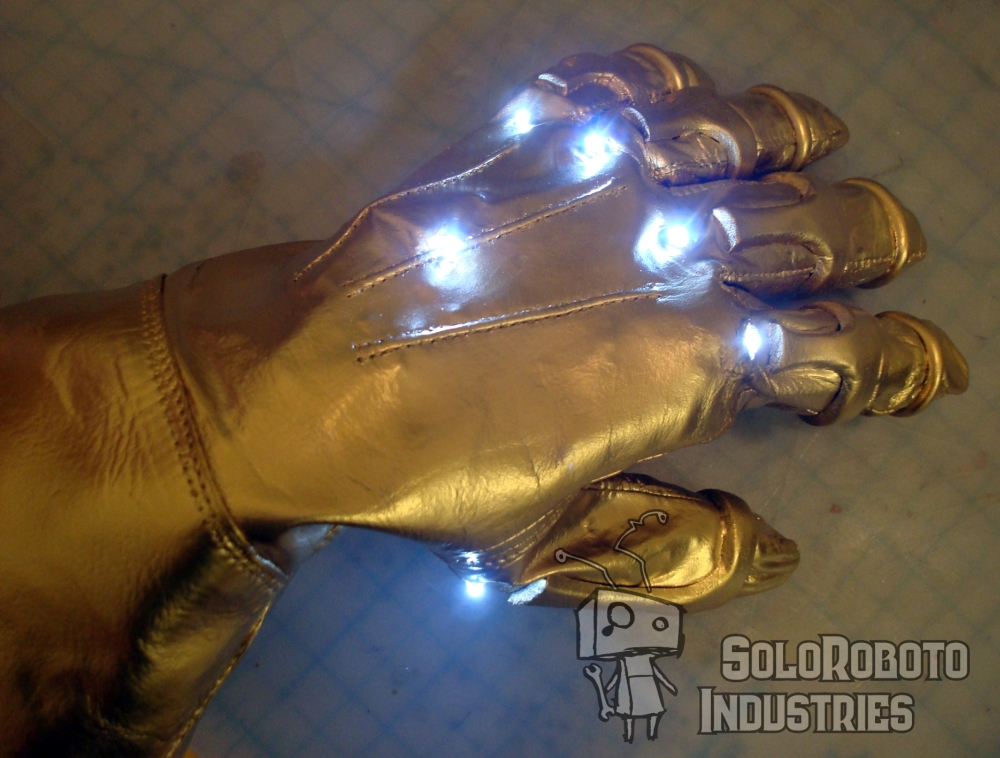

If you end up needing a more flexible paint, try Meltonian Nu Life - their gold looks great. Many times you can find it at shoe-repair places, but if not, eBay always has some: http://www.ebay.com/itm/Meltonian-N...t=LH_DefaultDomain_0&var=&hash=item43b41ce2b6
Here's what it looks like in photos. I don't mean to threadjack, but this is one of the few photos I have of what the gold looks like (and proof it'll hold up on a glove - mine was leather and foam as well, though I did the comic book version):
Plasti Dip also comes in a gloss clear, called "glossifier." I put that down first to seal everything and make it shiny smooth, then used the nu life over that.
