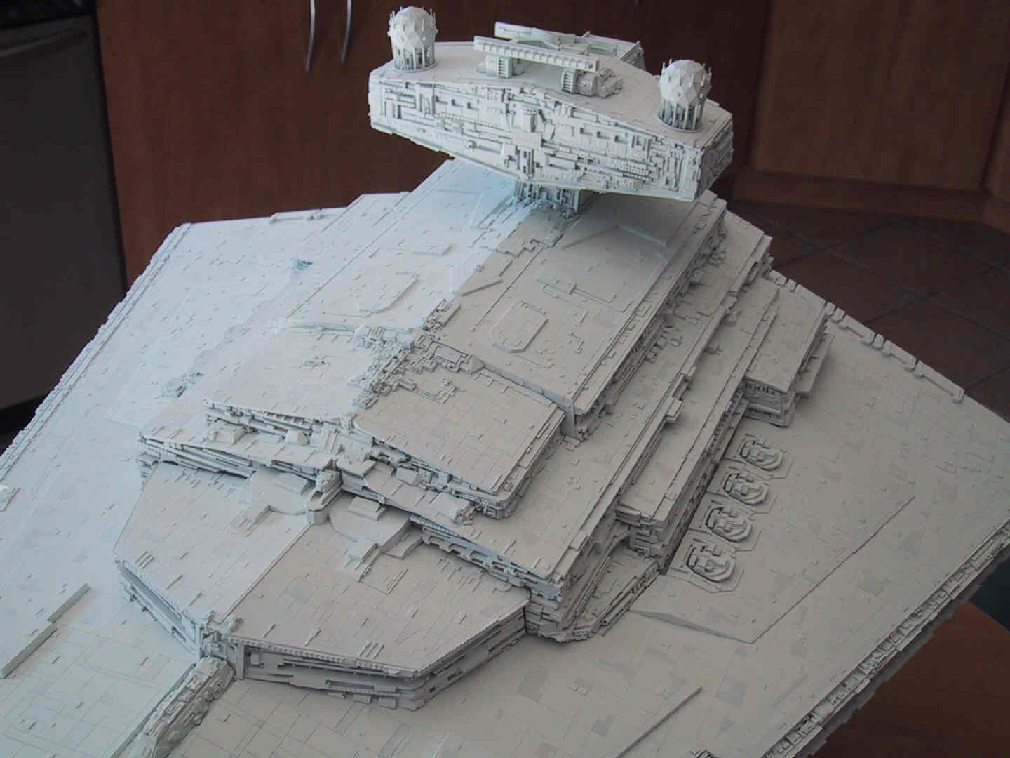

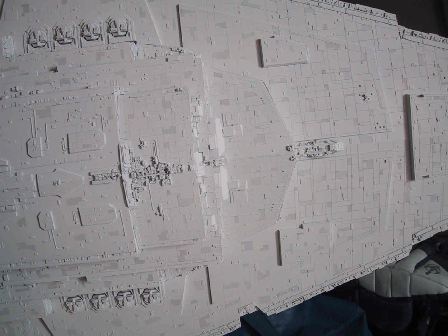

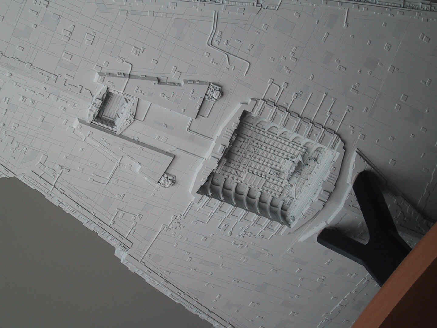

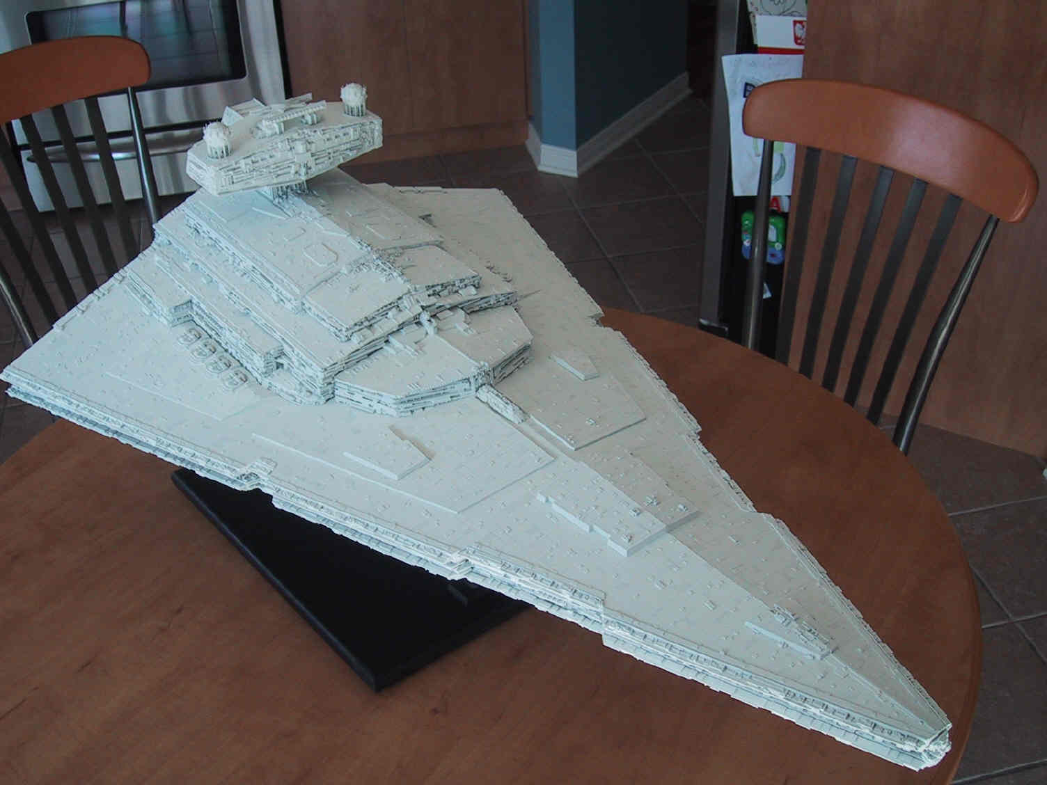

heres mine painted using krylon flat white primer straight out of a can, I then added many shades of grey panelling using a airbrush then misted the whole model using flat white using a airbrush to tone down all the grey panelling, you will notice that the third photo the panelling show a bit more since it was taken before I decided to further tone down the panellings.
GF, to me that looks very close to what the studio model looks like, though I would say the original is overall whiter. At least in my memory -- which, according to my wife, isn't what it used to be. ;-)

It looks like the studio model. Very well done!
I used straight flat white primer, again photo exposure can come into play, seeing a model in person and in photos colors will vary a bit.
