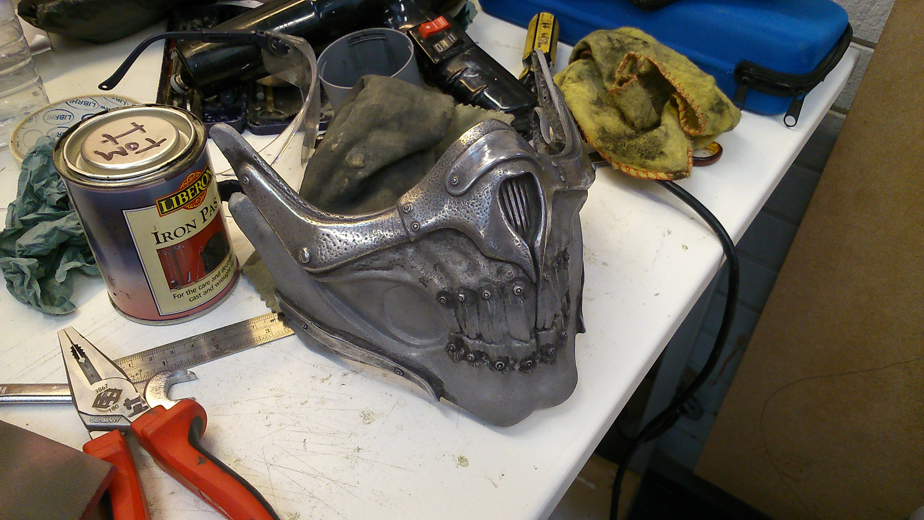

This photo shows the trimmed mask with the metal parts polished up. I start out sanding with a fine or superfine sanding pad before painting on a wash of iron paste thinned down with white spirit to give some depth to the recessed areas. Once that has dried I give it another light sanding, then a good polish.
