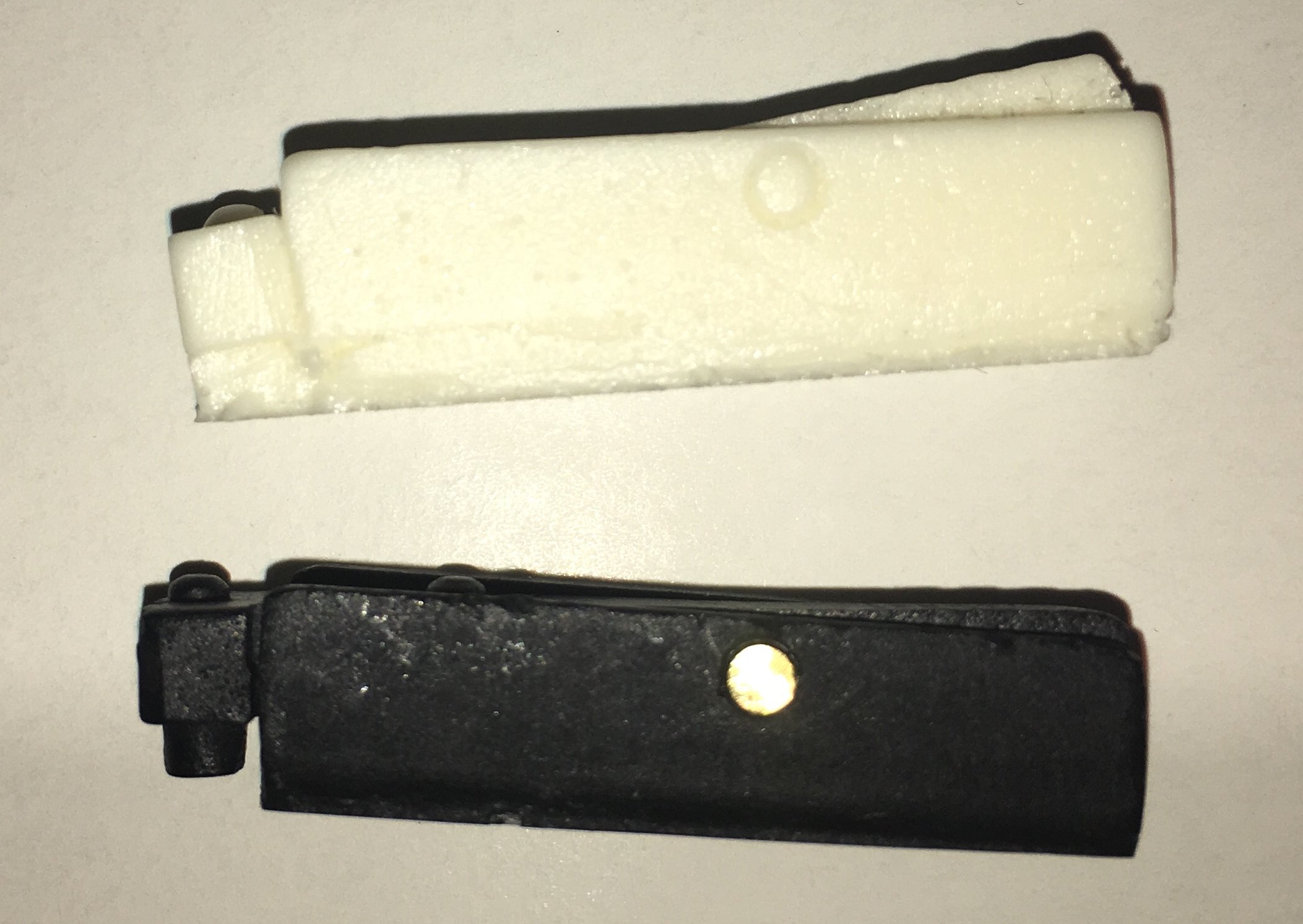

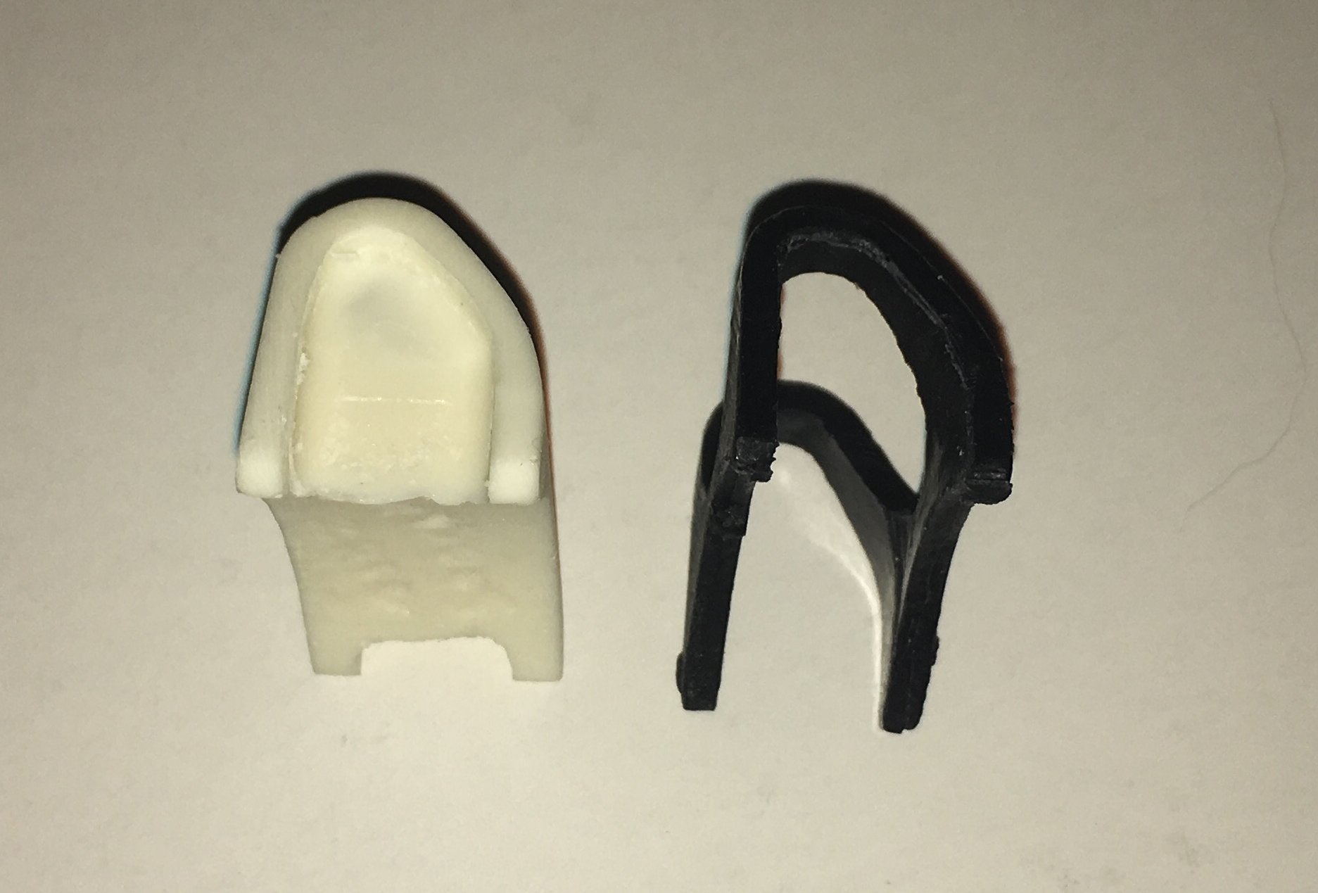

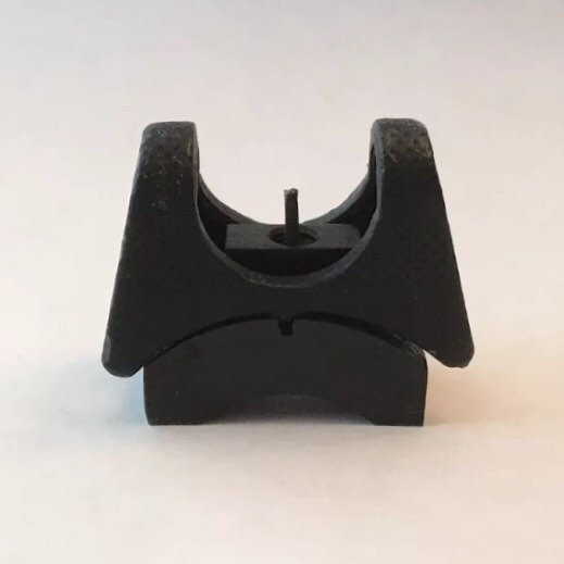

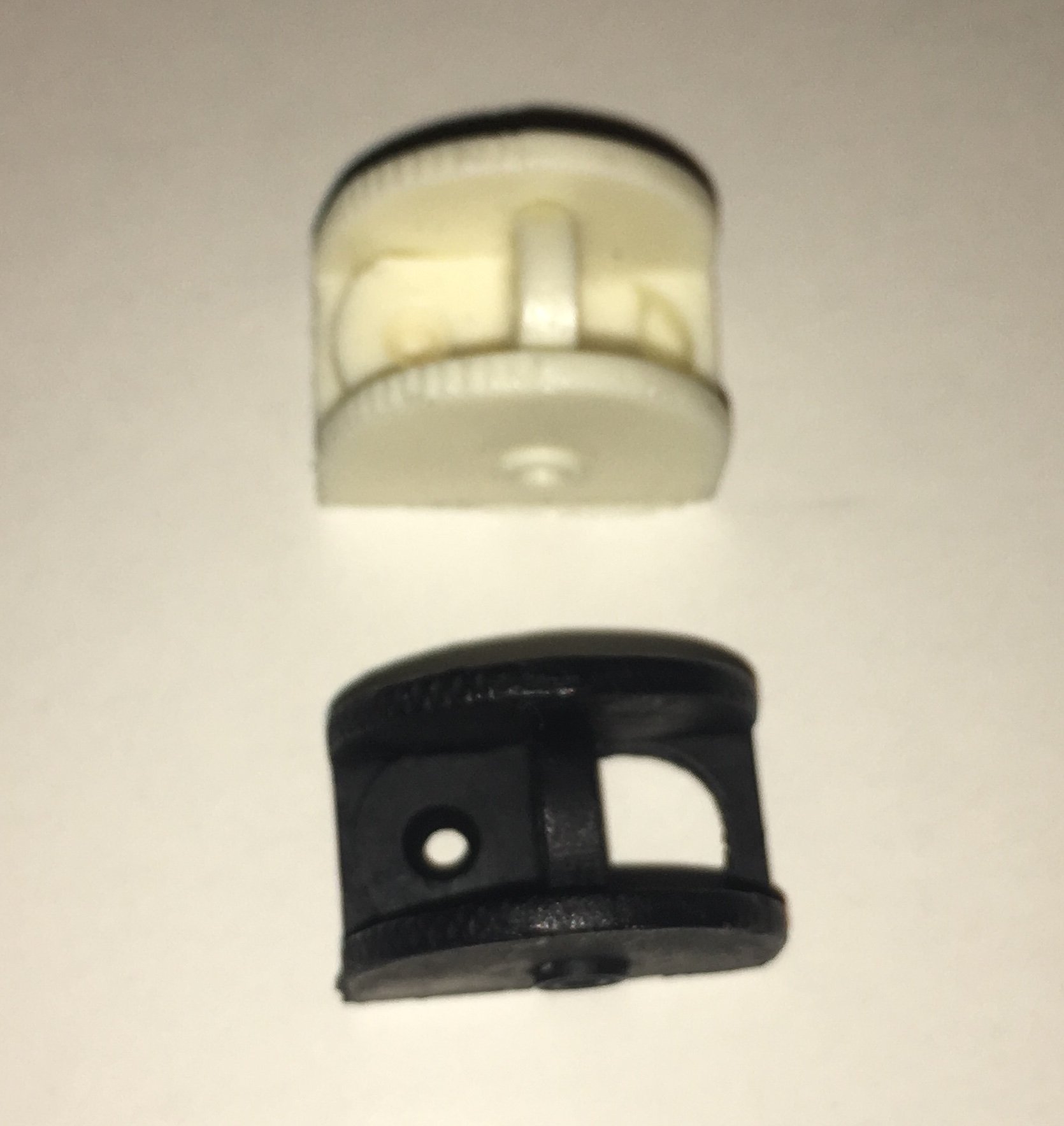

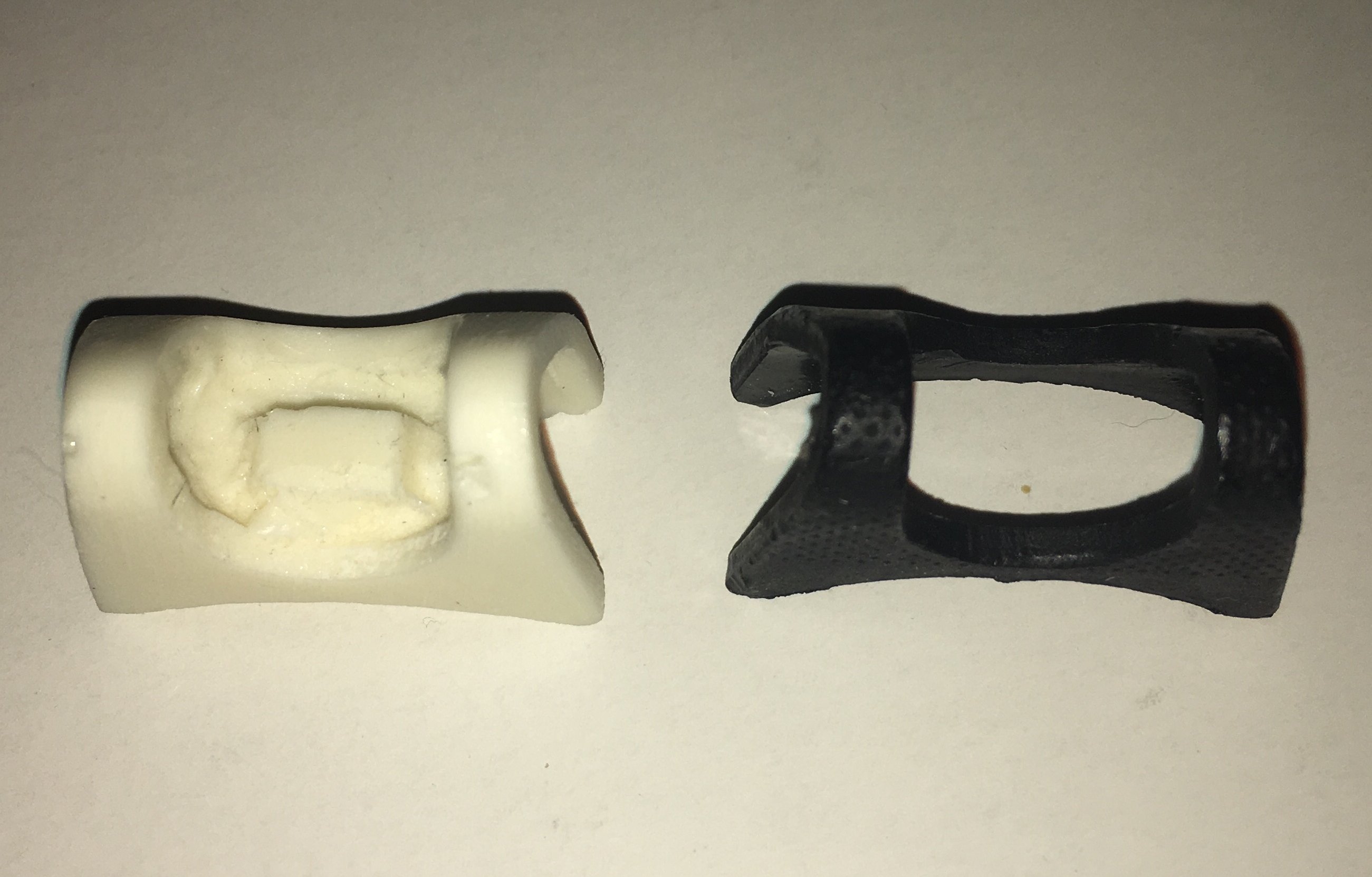

    I'm building the Doopydoo's E-11 too, but have replaced the Hengstler Counter, Scope and Power Cell Assembly with 3D printed parts
    from Shapways and also have replaced the foresight, the rear sight and back cap catch assembly (plastic) from swpropman.
    Richard. IMG_3871.jpg IMG_3870.jpg IMG_3872.jpg IMG_3873.jpg il_fullxfull.987840140_pogt.jpg
