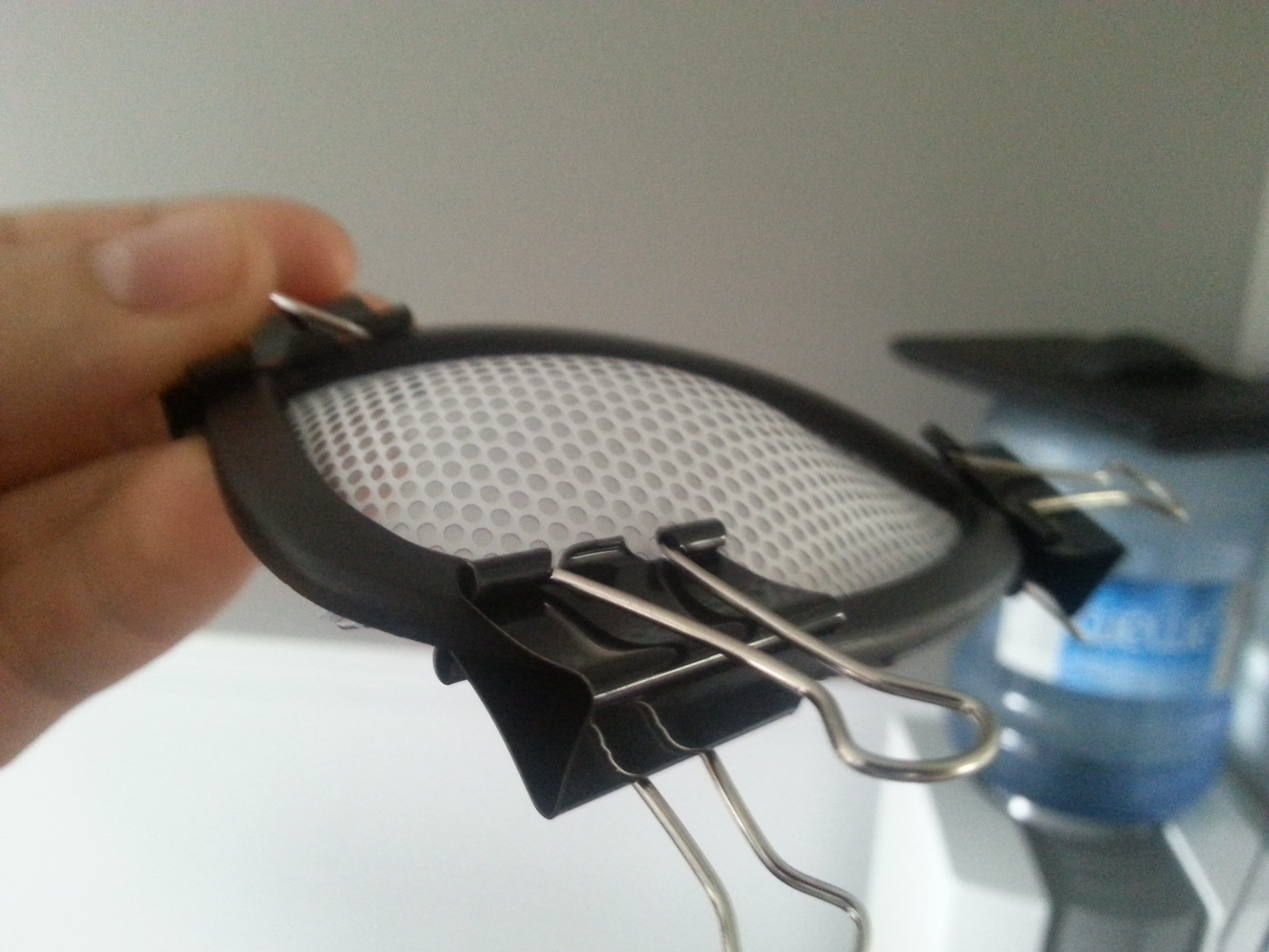

Alright guys! i did a quick try on these budget ones!! And i'm pretty happy with the result.
1- I took a plastic bottle at the grocery store that have a nice curve to give this "dome" effect to the lense.
2- I went to see the local company that makes advertising in shop windows if they can sell me a sheet or two of those plastic adhesive mesh and they gave me a roll of scrap. About 1 m²... free!!
3- I put the dome, cut it to fit my frames, put the vinyl mesh on it...then I brought them over heat of the oven to avoid any fold or bubble. Which works pretty gr8 at first try!!
4-Then i still have 1 or 2 fold spots... to fix it i took a knife, heat it over the oven and push it against those small fold areas and it stretch to the surface as a charm!!
I still need to glue the lenses to the frames, add magnets to them and to my faceshell and i'll be done with those!!
Hope it helps! And thanks for the concept Jeck13500

View attachment 339514View attachment 339515View attachment 339516
ahah ! ****ing perfect work!! Nice Job !
I think place screen guard too for the reflection !
Im very happy with your result !!
Glad to help, someone else??

If it could help... i did use my spiral parts of the oven to do it perfectly and its works superb on every shots from thw first time i did.
Just place the mesh over the hot spiral..not too long ull see it becomes soooooo soft. Then simply apply on plastic u choose. Be careful to dont stretch it too much because ull change the shape of honeycomb.
ET VOILA.! Good luck!
