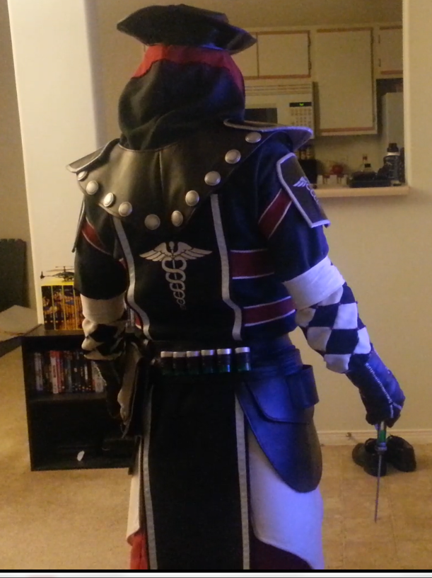

Hey guys,
I just finished my first costume and now I want to distress the fabric before the con on saturday but I don't really know how. I've done some research and it seems the main ways are to wash the outfit a few times, use some sand paper to rough it up in certain spots and to add some stains where appropriate. I am okay on the sand paper and stains, what I'm a bit worried about is washing the costume.
I didn't prewash the fabric since I didn't realize I should with this being my first costume, and it's a lot of blacks so ink running is absolutely an issue. Since there is a mix of hand sewn bits, and lights colors sew into the darks I can't just go about washing it like I would my normal cloths. Any tips on ways I can distress this would be awesome!

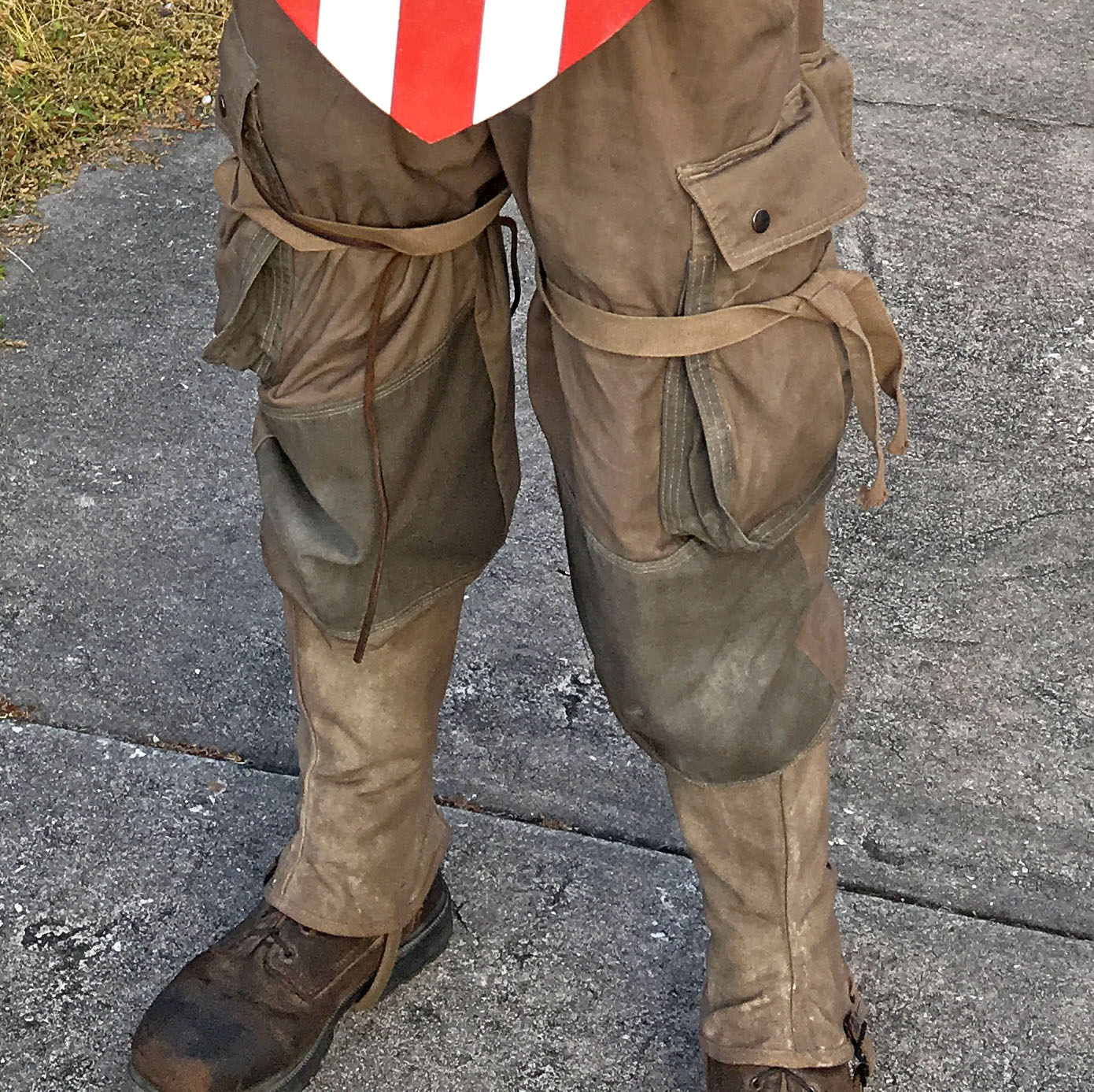

For a warm-colored 'dust / dirt,' I purchased a bag of Fullers Earth from Amazon. It's a fine, clay-like powder. In my case, that particular product was intended for some cosmetic use, I think. I applied it liberally all over the costume (while wearing it), and lightly brushed it off. I later reapplied it, for a stronger, dustier look. That, combined with a little fine sand paper / steel wool on the knees (while wearing the pants) is about all I have attempted.
I think light passes is the key. It's easy to add a little more wear & tear & dirt, but it will be hard to take it back if you go too far.
