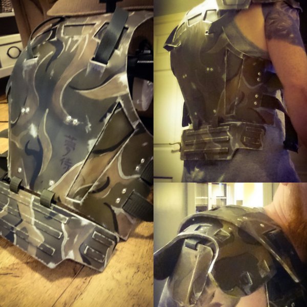

Here's my (unfinished) Aliens armour if you're interested;
