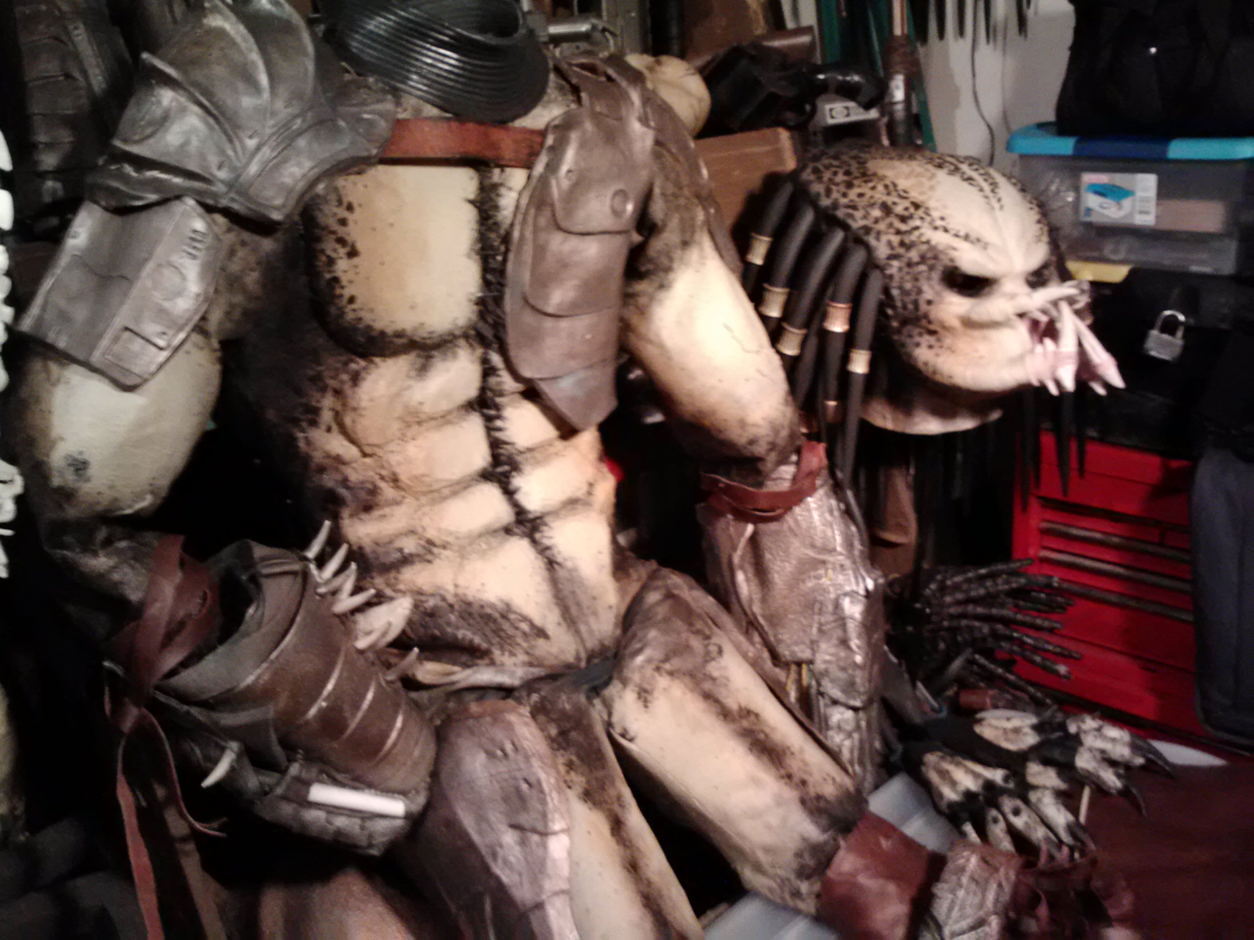

I am finally finishing my suit of Predator skin. Before the netting goes on, I wanna make sure of something. I have painted 1 coat of Permawet on already. Do I need to put more than 1 coat for an EXTRA shiny look to the skin? Also, apparently Permawet darkens the paint job a little. Would further coats make it even darker? Any help is appreciated, Thanks!
On my mask I used 3, and yes the first coat does darken it a tad. I haven't noticed any more darkening with subsequent coats. I used an airbrush for mine, and thinned it down with water, about 70% Permawet to 30% water. I'm told that the more water you add (within reason) the shiner the final outcome will be. My mask has a "semi gloss" finish, and looks okay to me, but the final finish is really a matter of preference. Hope this helps!
