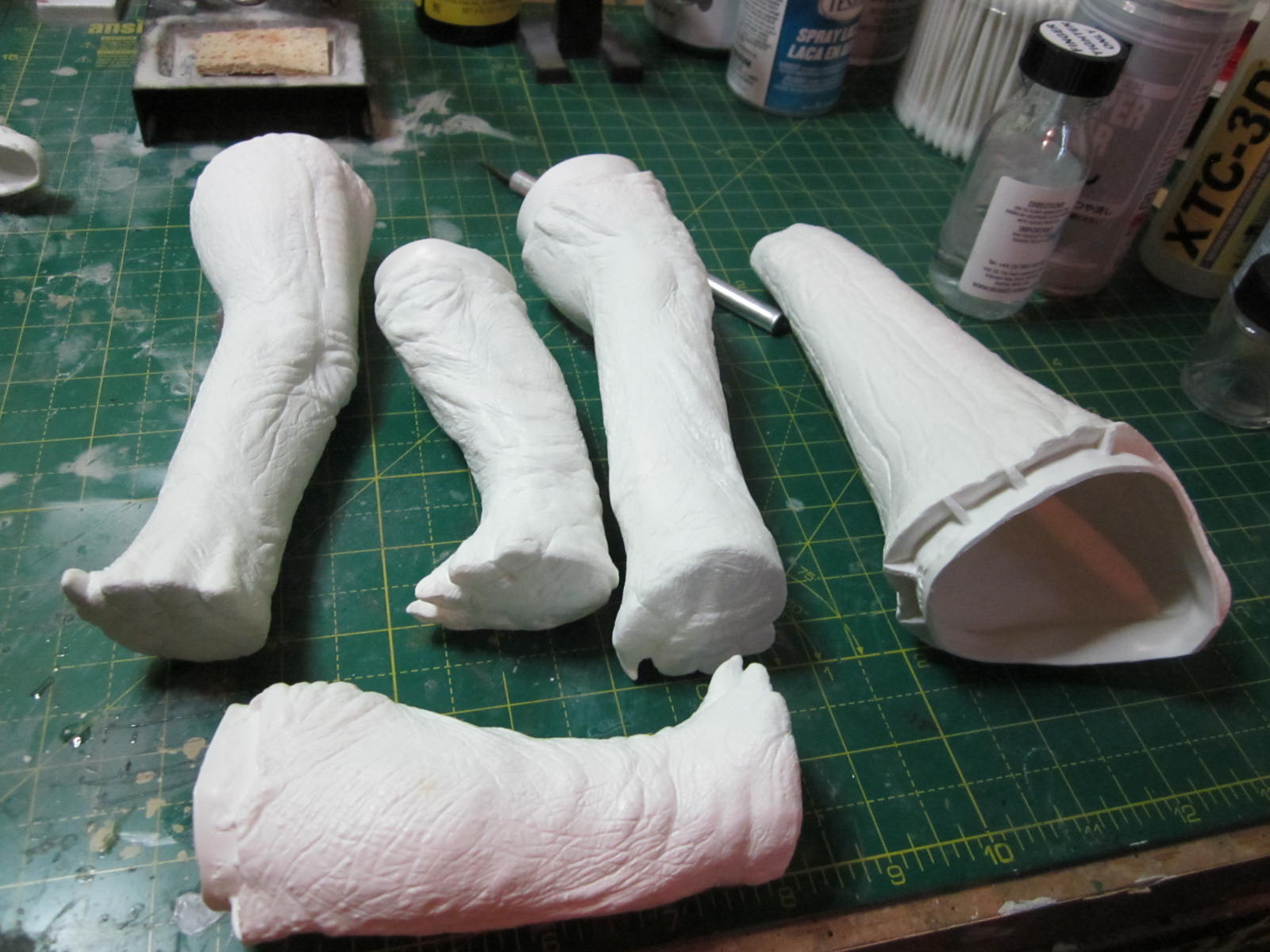

Having a look at all the pieces (not too many to be honest but each part bar her lower jaw hints at how big this kit is).

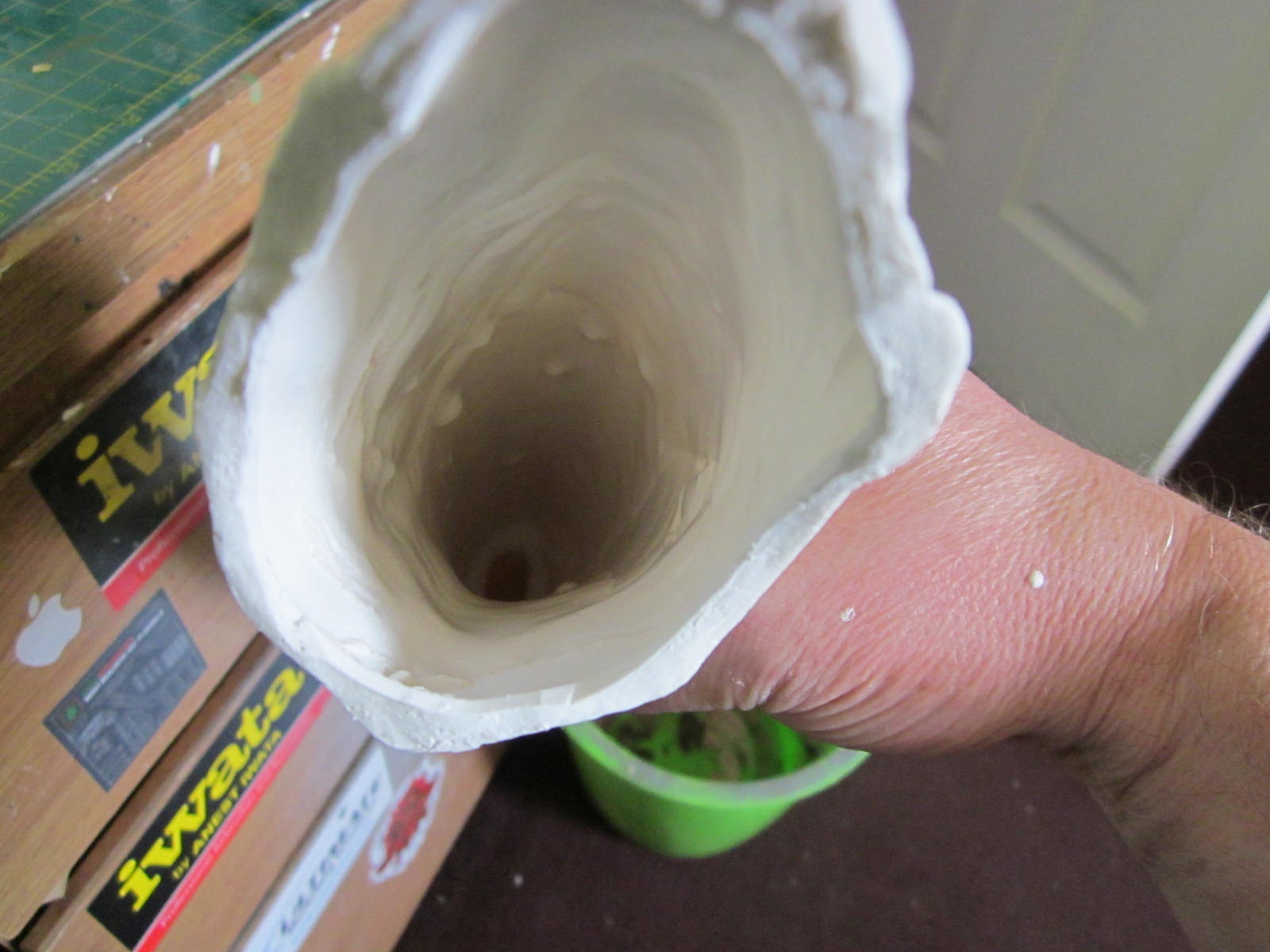

I have made a general start on her but the first item on the agenda was to trim all the part and the next after that was to fill her legs with Plaster of Paris up to about 10mm from the top so I had some vinyl that could be heated and shaped when attaching her legs. Once the legs where attached I pored more plaster into the leg holes from inside the body so all four legs were filled .
To add some rigidity to her neck and tail I pored more plaster in, swirled it around to get a good coating on the inside and let the excess drain away. Before the plaster hardened I just wiped the inside of the tail/neck where they would join to the body to depth of about 10mm to again give me some vinyl that could be heated and shaped more easily when attaching to the the body.

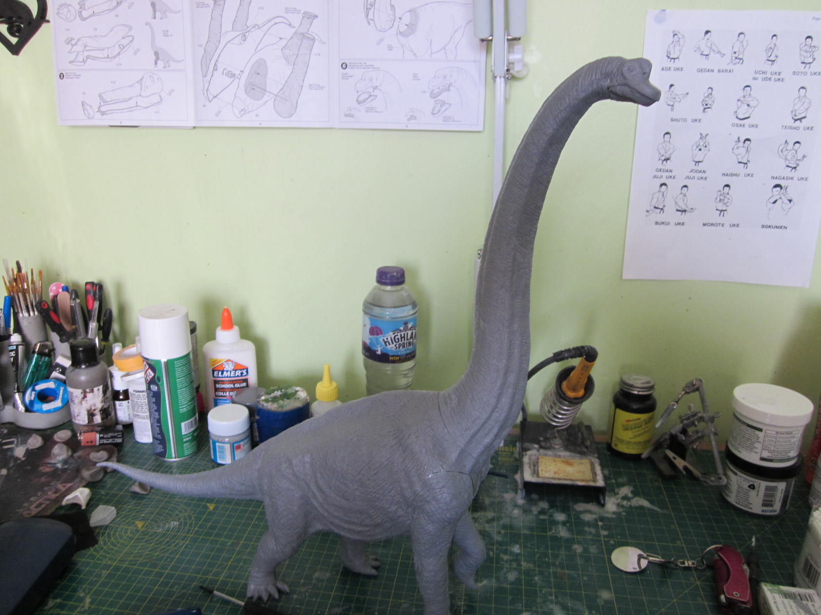

In the midst of this pandemic I actually managed to get a lot of work done on the big girl. Been a struggle though as having to self isolate sucks any degree of motivation from me.
Anyhoo! The big Horizon kit has been completed and apart from needing to tackle the seam around the middle of the body she's pretty well done with regards to actual construction. I just need to paint the inside of the mouth then attach the lower jaw.
That's an 18inch ruler next to her in the second picture above and as you can see there's easily another 10inches to go to get to the top of the head.

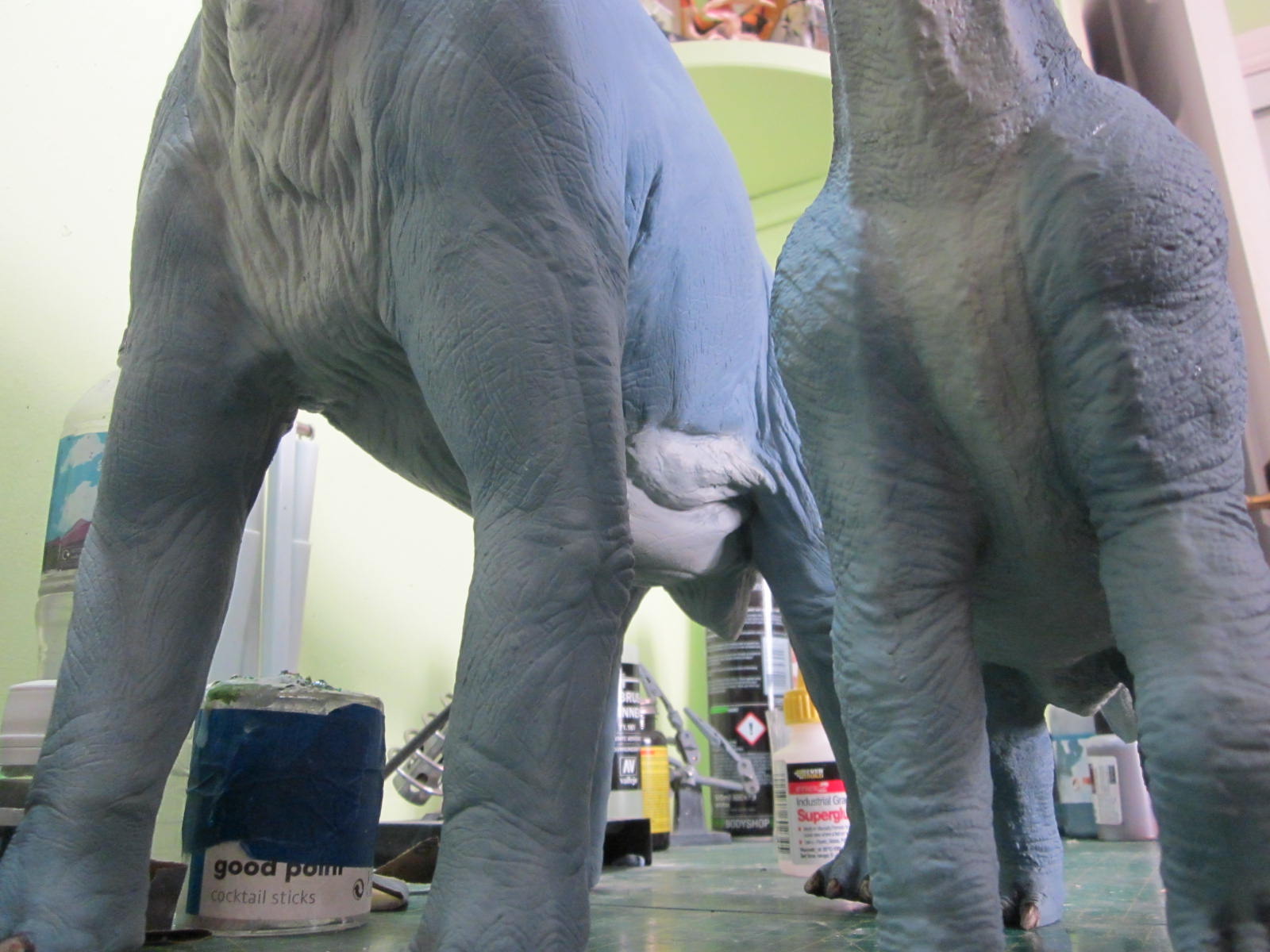

Been so caught up with family and work commitments right out the window with this Pandemic. The missus and our boy are in his house and until the restrictions are lifted (going to carry on for at least another 3wks here in the UK) they're stuck there whilst I have the house to myself with the exception of three Yorkies, two Chameleons and a cat.
Work has been slow and steady with the girls and they are pretty much finished. I took an age to decide what colour they would go in the end and eventually decided to go for an overall grey after watching the Discovery Channel and seeing some programmes on Elephants.
Still got a lot of work to do and especially with the big one around her eyes. Leaving them alone until the weekend to let all the paint cure (got some oil paint on their toes and that takes awhile to dry properly) when I'll give them a gloss coat and then a wash of some colour to bring out the details.
