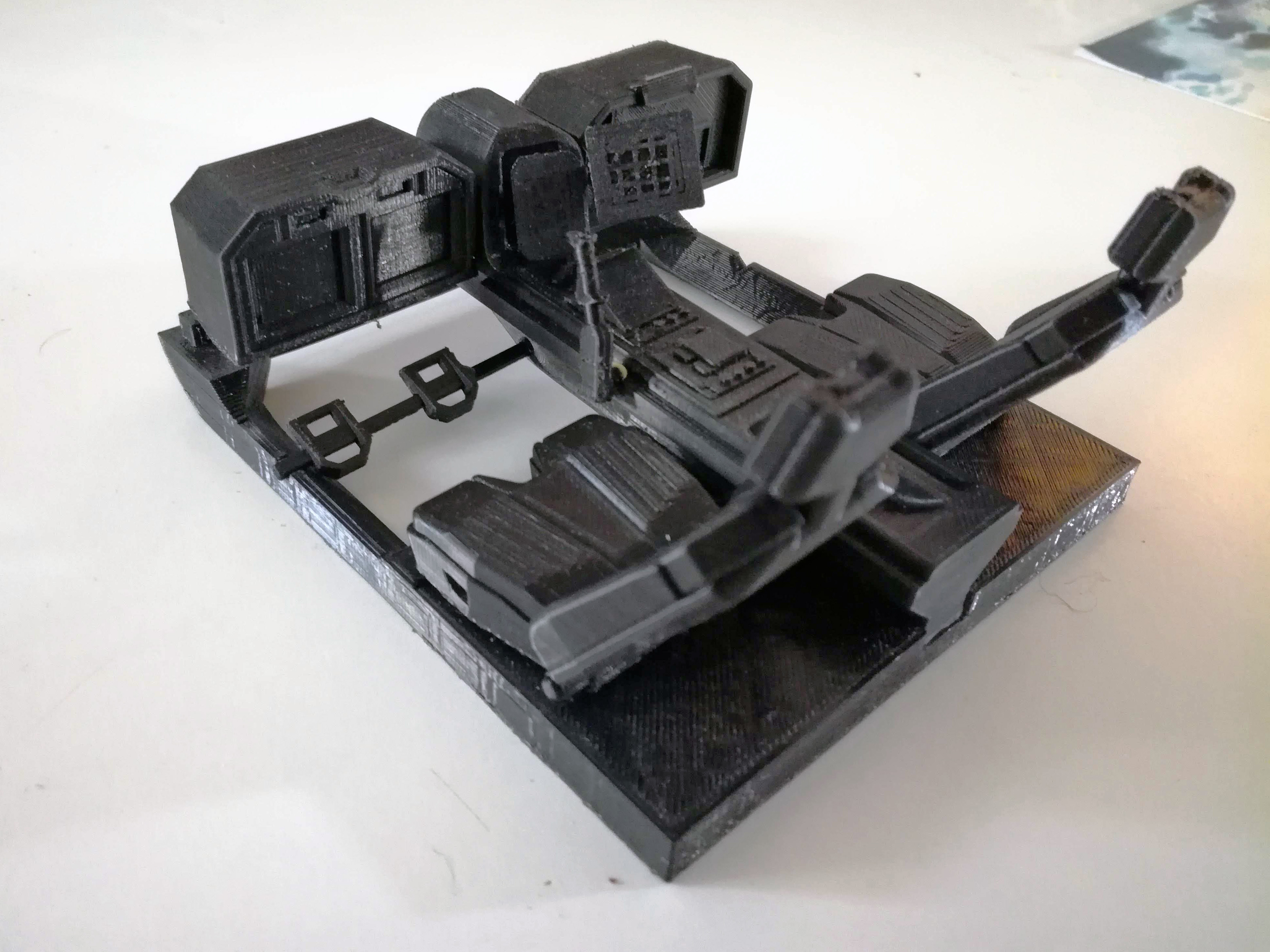

So, mine would be close to 1/18. And I'm ok with that. Cause i you want to be able to print it on most average 3d printers, that's a resonable size to work with. And trust me, it's big enought, and ...so cool !!!
I Keep working on it... ! I'm currently re-thiking the way it's cut and sliced, to be easier to print with best result...
