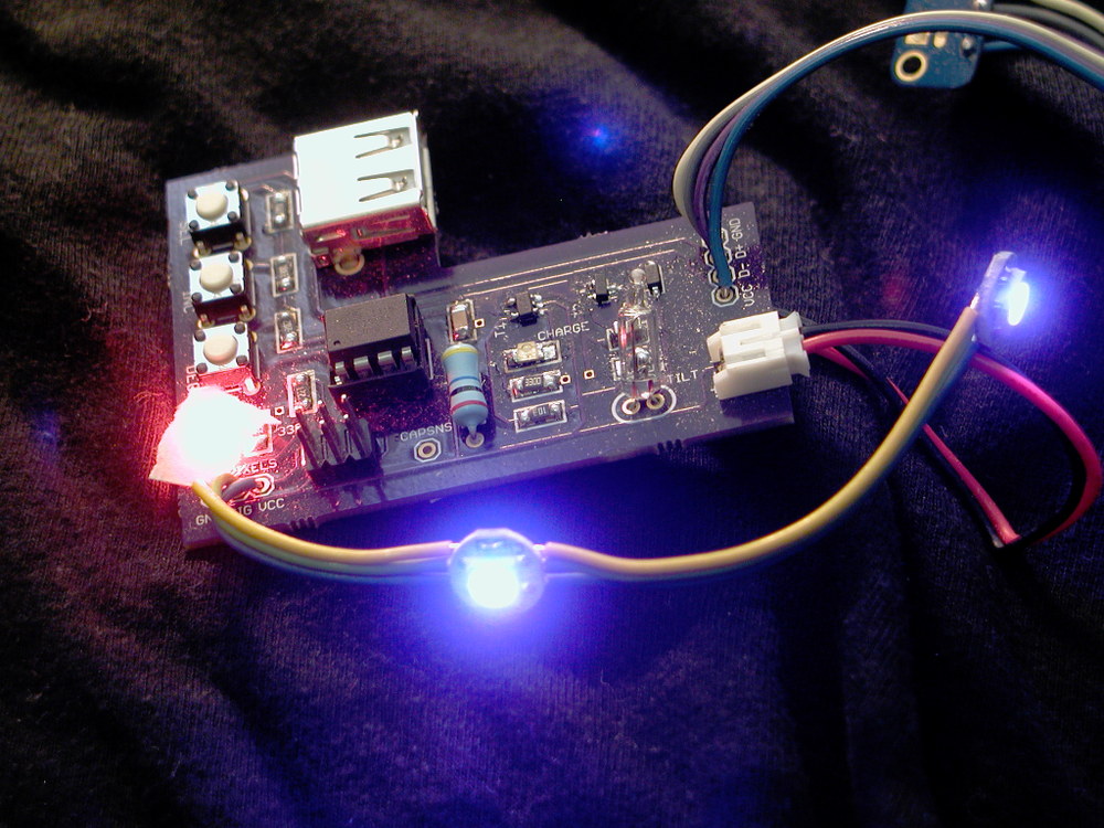

I got the board almost two weeks ago but there was a problem with the load-sharing part of the circuit. Just got the new MOSFETs in the mail this morning and it now works like a charm (testing now to confirm the charge circuit still works as designed).

Lighting circuit all works now. Slight revisions before the production run (USB jack moved to the board, switch string for through-hole neo-pixels, etc.)

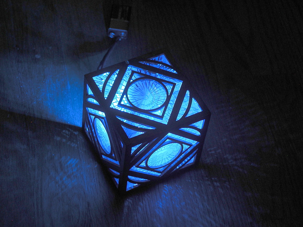

Lights up "okay"....
That's using a stand-in light source, though. My main complaint is that the "Counselor" diffusion layer (and circuitry layer) takes away too much from the look of the canon "Stolen" holocron. Very tempted to try a cube-within a cube...but it would be tough to shrink the lighting board that small.

Lighting circuit isn't working for me:
The prototype board is so big the LEDs are getting too close to the sides of the box. So it's back to Eagle to create version 2.0 of the board. Also dropped the external USB jack as it looked ugly.

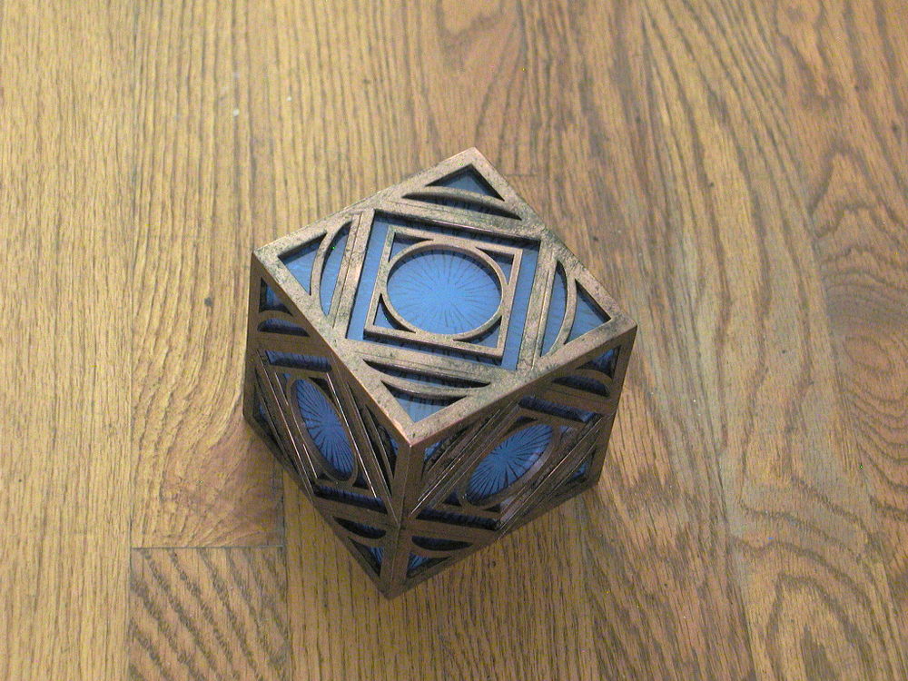

This is three layers of laser-cut acrylic, with one layer engraved with a pattern to help diffuse the internal light. Major pieces are snap-fit and there's additional guides etched in; took me a couple evenings to assemble and most of that was sanding, patching (Bondo Spot Putty) and painting (Rustoleum Hammered Finish Copper) the outer shell. Anyhow. I feel I owe it to the community so I'm offering that kit at cost; $45, plus $5 shipping. Somewhere around a year from now I'll make all the files publicly available and you can laser your own.
Before I set up the proper sales thread I'll stick some paint on two alternate shell designs I have, and show off a couple alternate diffusion laters as well. I want to be able to offer mix-and-match. Above is the "Stolen" shell design, with "Counselor" diffusion layer in light blue, and "Circuit" inner detail element.

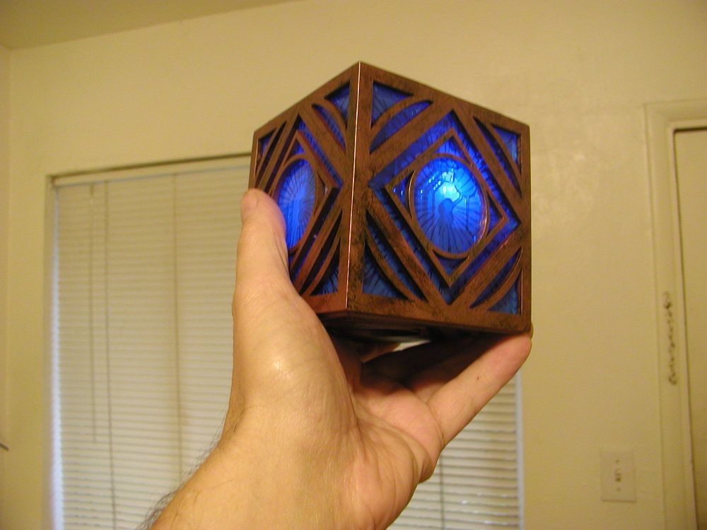

I am still interested in a fully assembled / finished option, what do you think the final weight might be?? I am thinking of displaying on a magnetic levitation floating display stand, most have a max weight of 300g
A first-order calculation (no, not THAT First Order) says it should be over 24 gm. I'll weigh when I'm near a postal scale.
