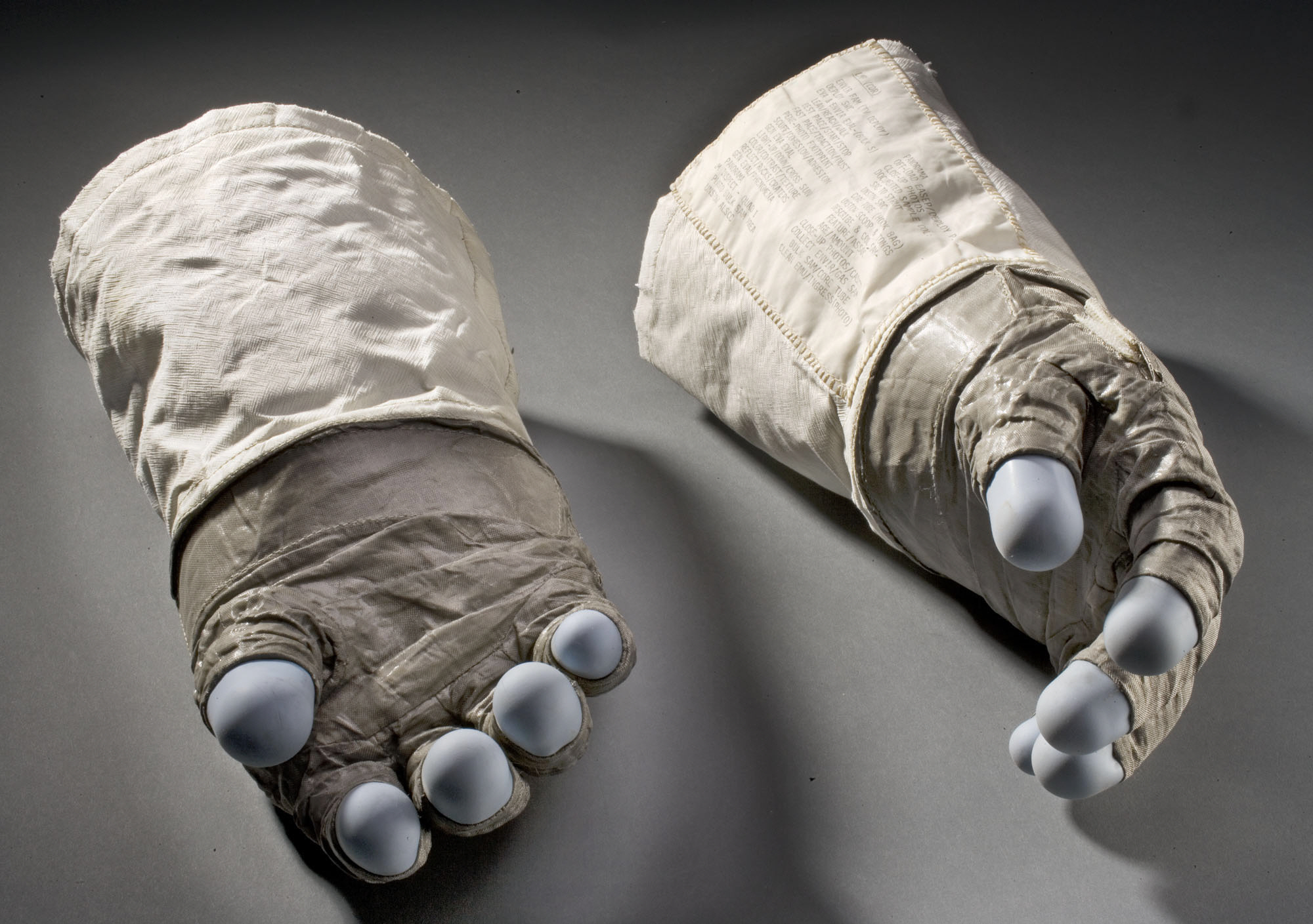

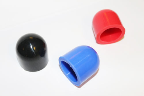

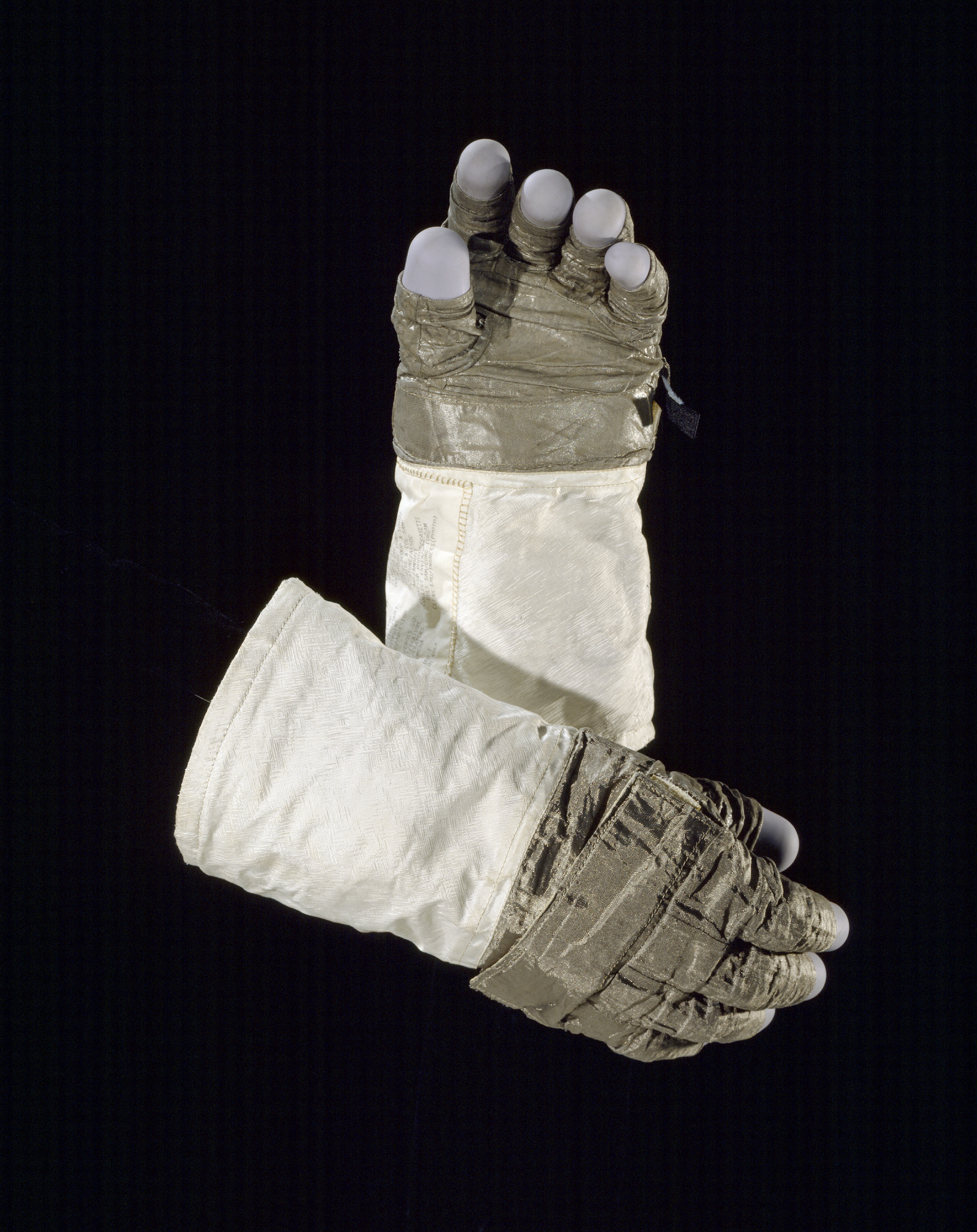

I thought I'd start with the fingertips so after a lot of research (and some great tips from other forum builds) I managed to source some rounded silicon plugs that are almost exactly the same 32mm size as the real fingertips as shown below in this museum pic with the plugs alongside (I bought the blue version). As an ex sword fencer, I also realised that the best match for the 'Chromel R' metalised covering was a sword fencing lame, which for the uninitiated is a conductive jacket worn over fencing whites.

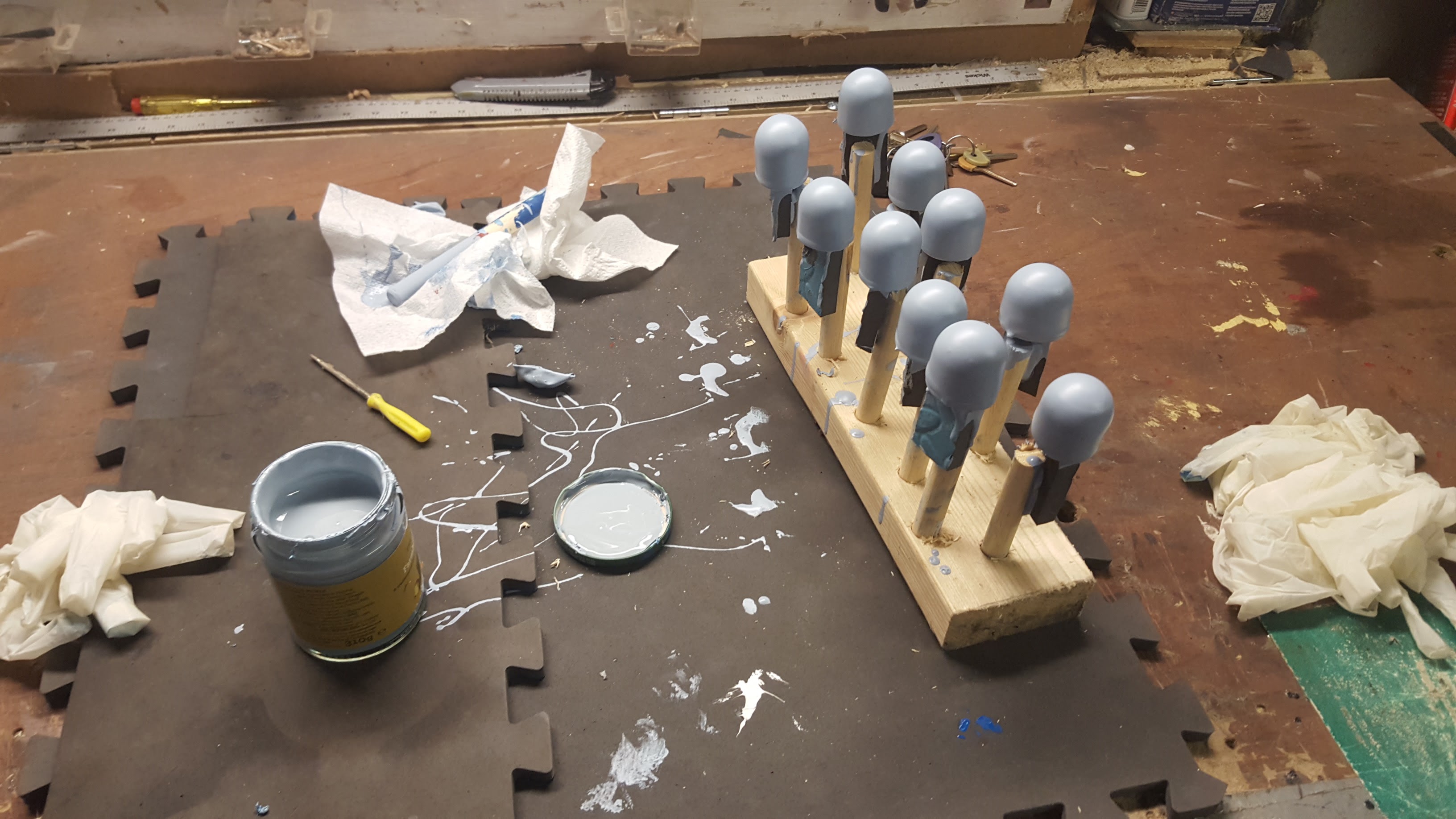

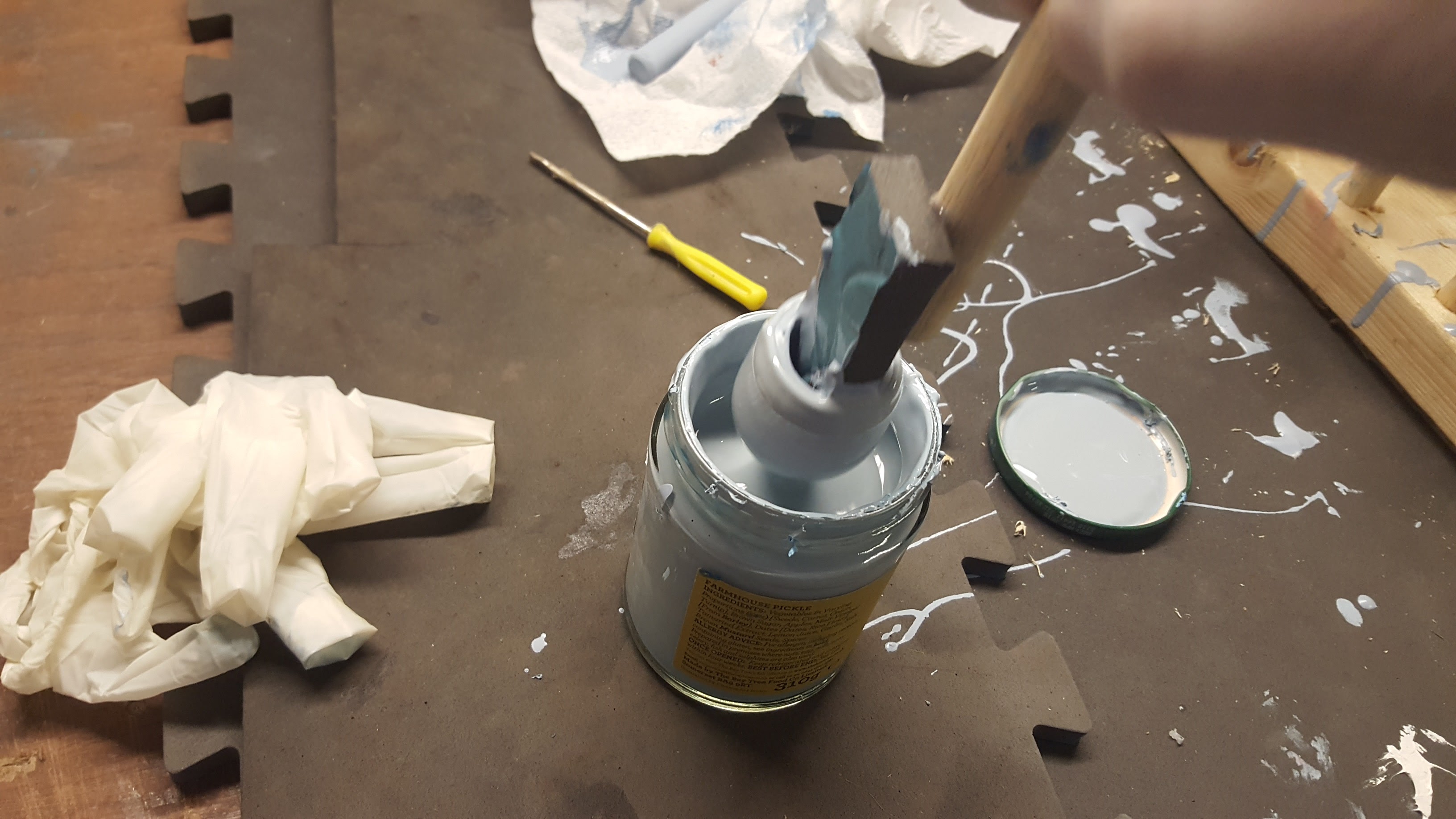

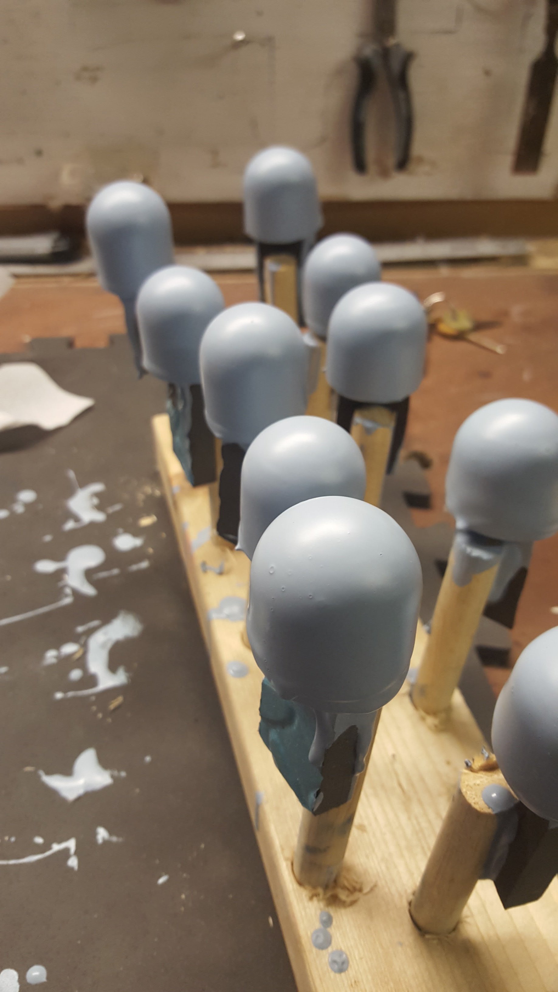

The next problem was the colour of the tips and after a little more searching I went for the plastidip method that I've seen used on a couple of previous builds. I made little sticks and a stand for the plastidip to set on and they came out ok with a pretty good colour match, using the make your own colour set which cost around £34 here in the UK.

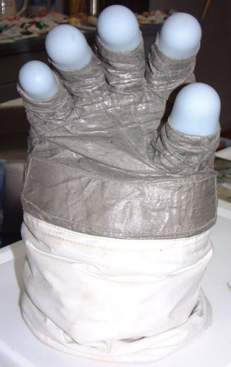

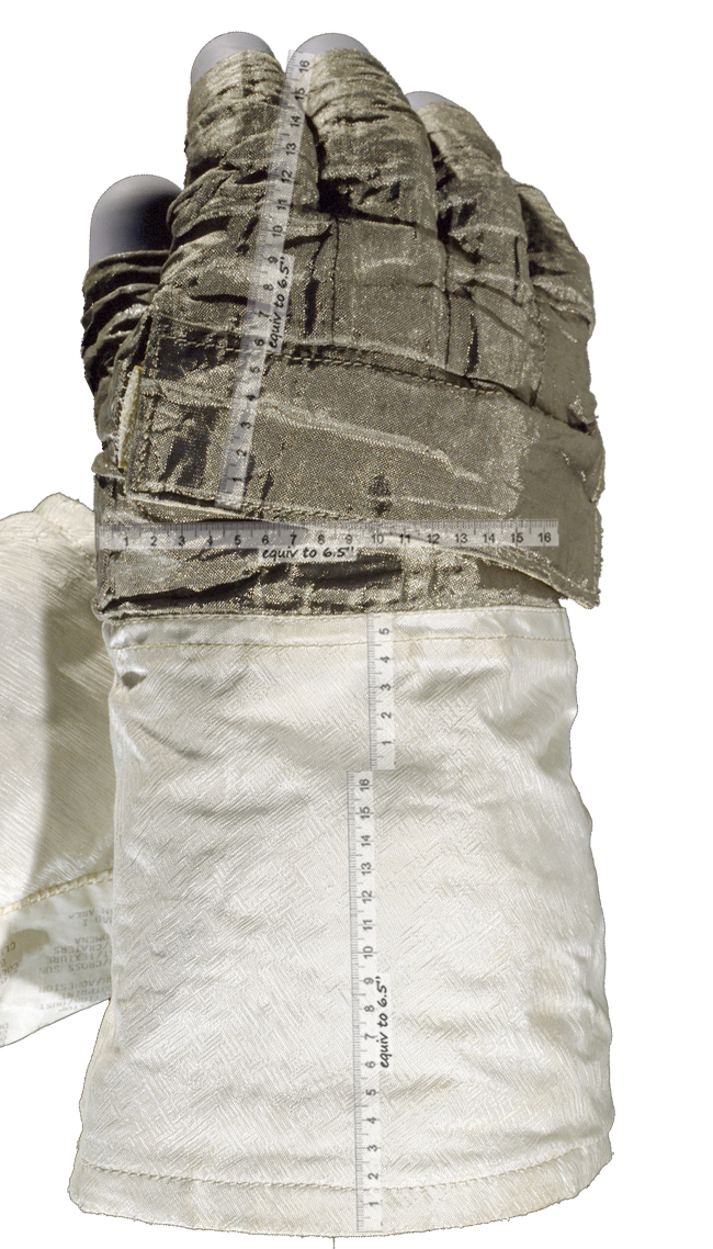

When it came to the overall glove size, this was a real problem as there doesn't seem to be a size spec available anywhere, especially for the length of the fingers etc. so using a photo that the very kind 2storyprops had uploaded showing the glove with a 6.5" ruler alongside the width I used photoshop to get some approx. sizes for final assembly. I am aware that due to perspective and bends in the ref pictures I won't get a spot on scale but at least it's a working idea of sizes for me to run with. This is an official photo with some of the rulers overlaid:

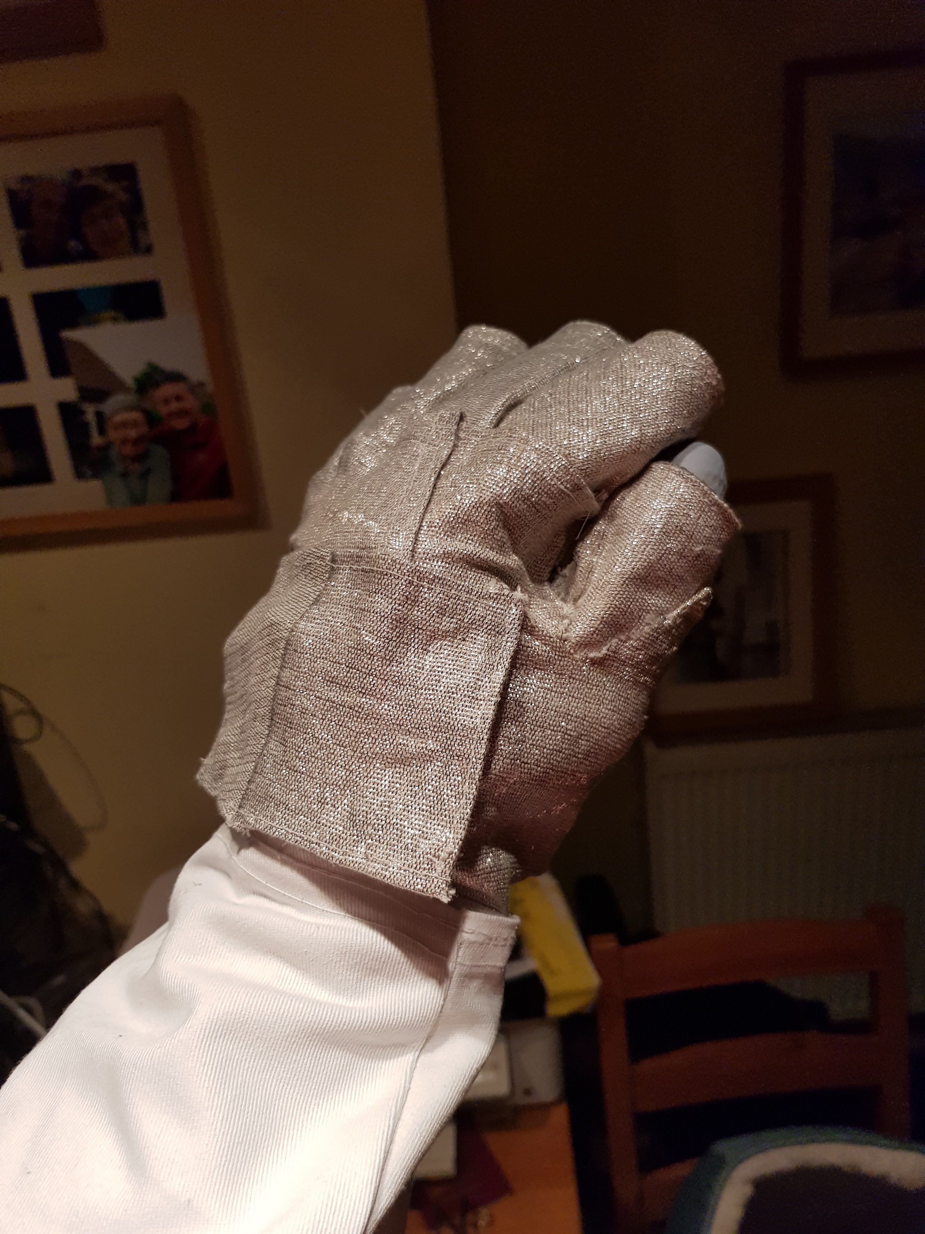

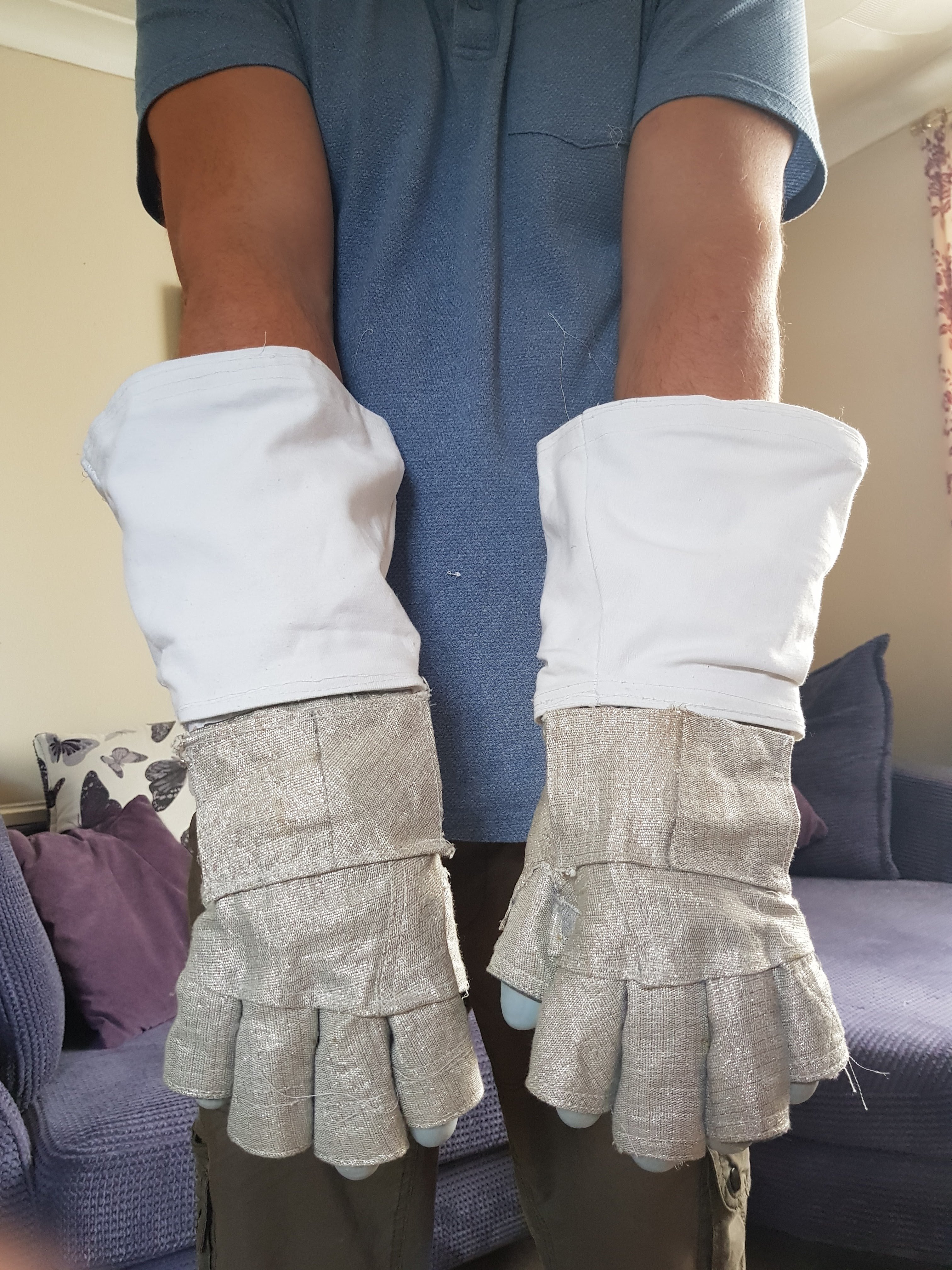

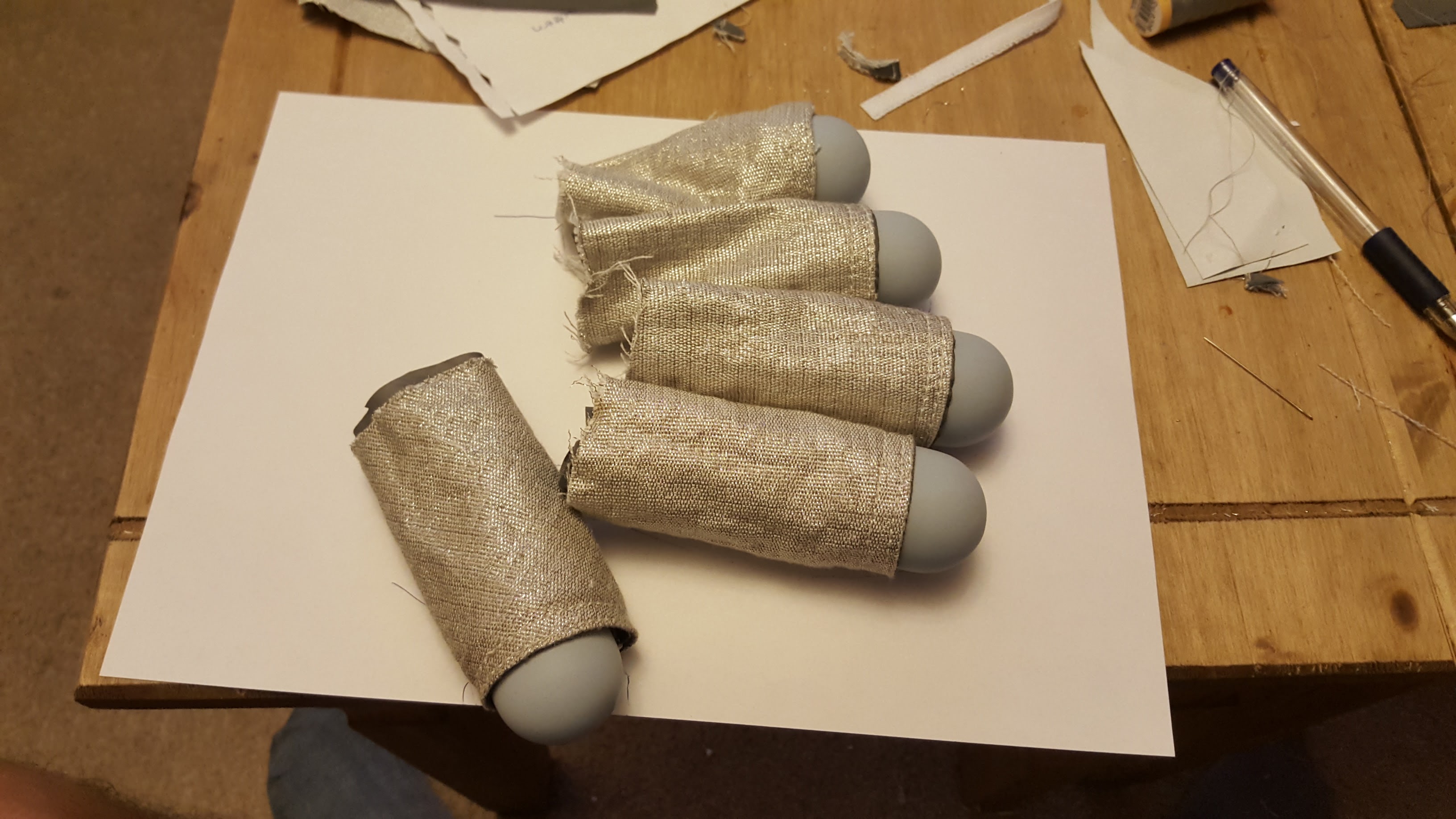

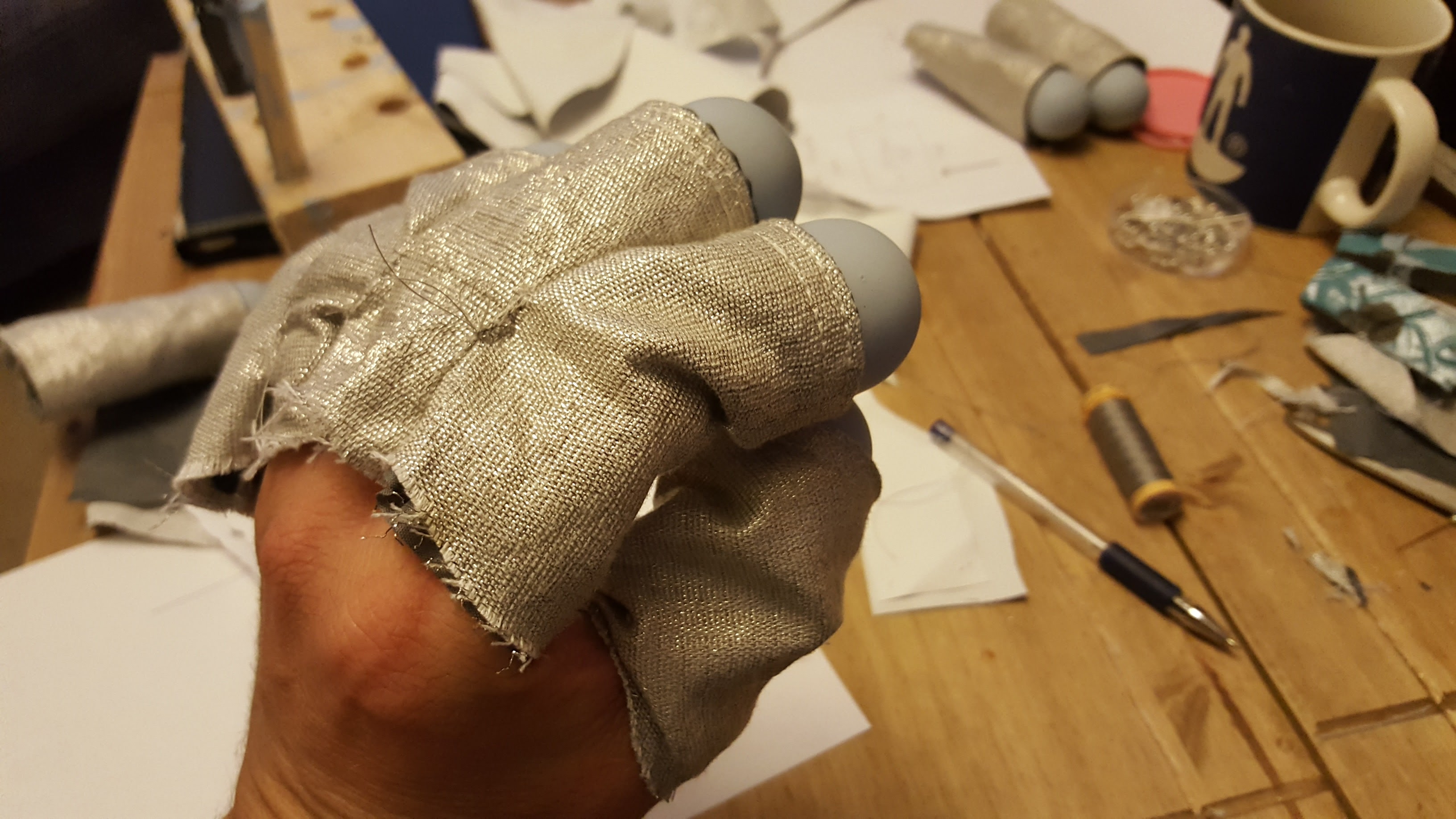

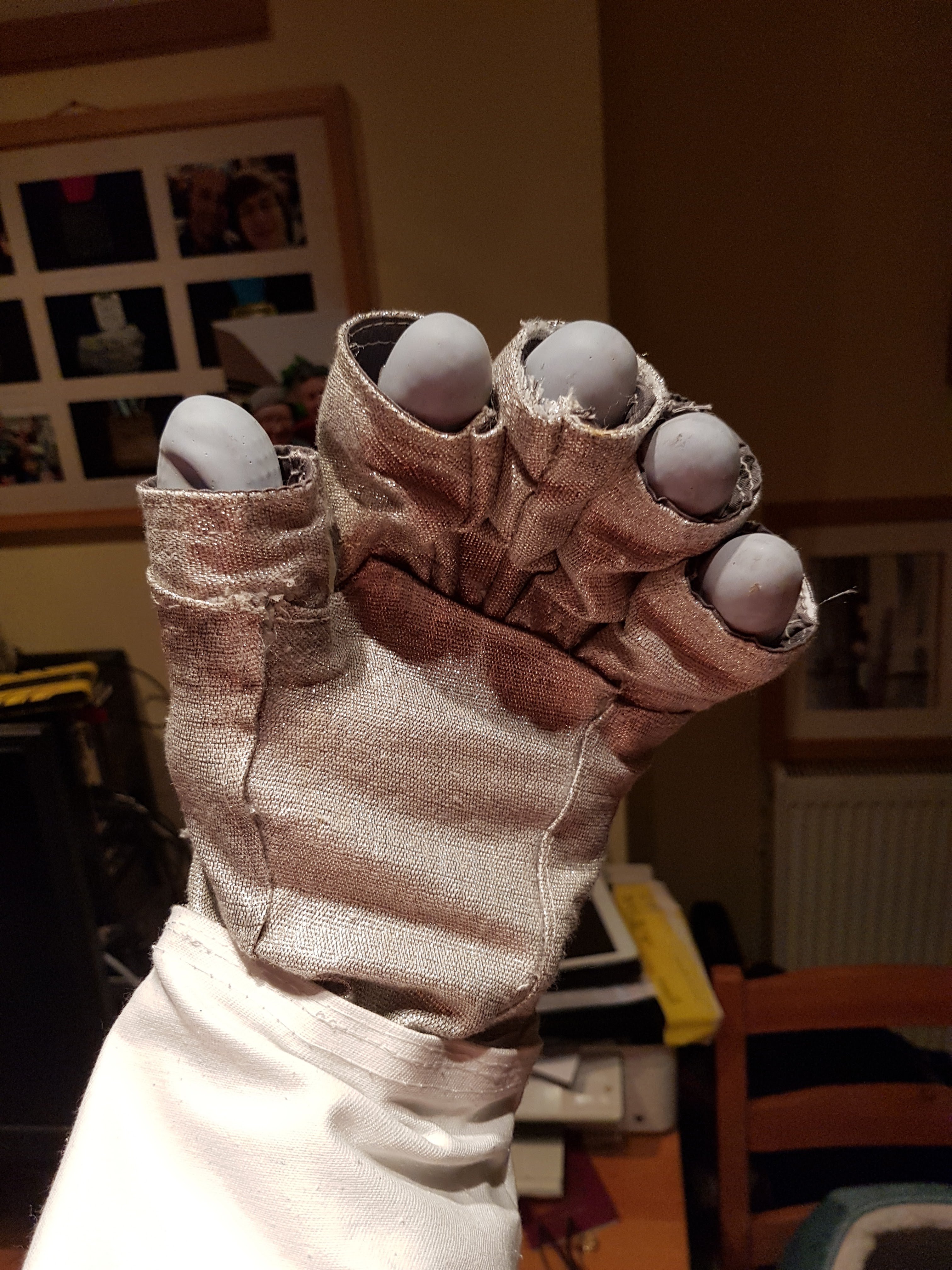

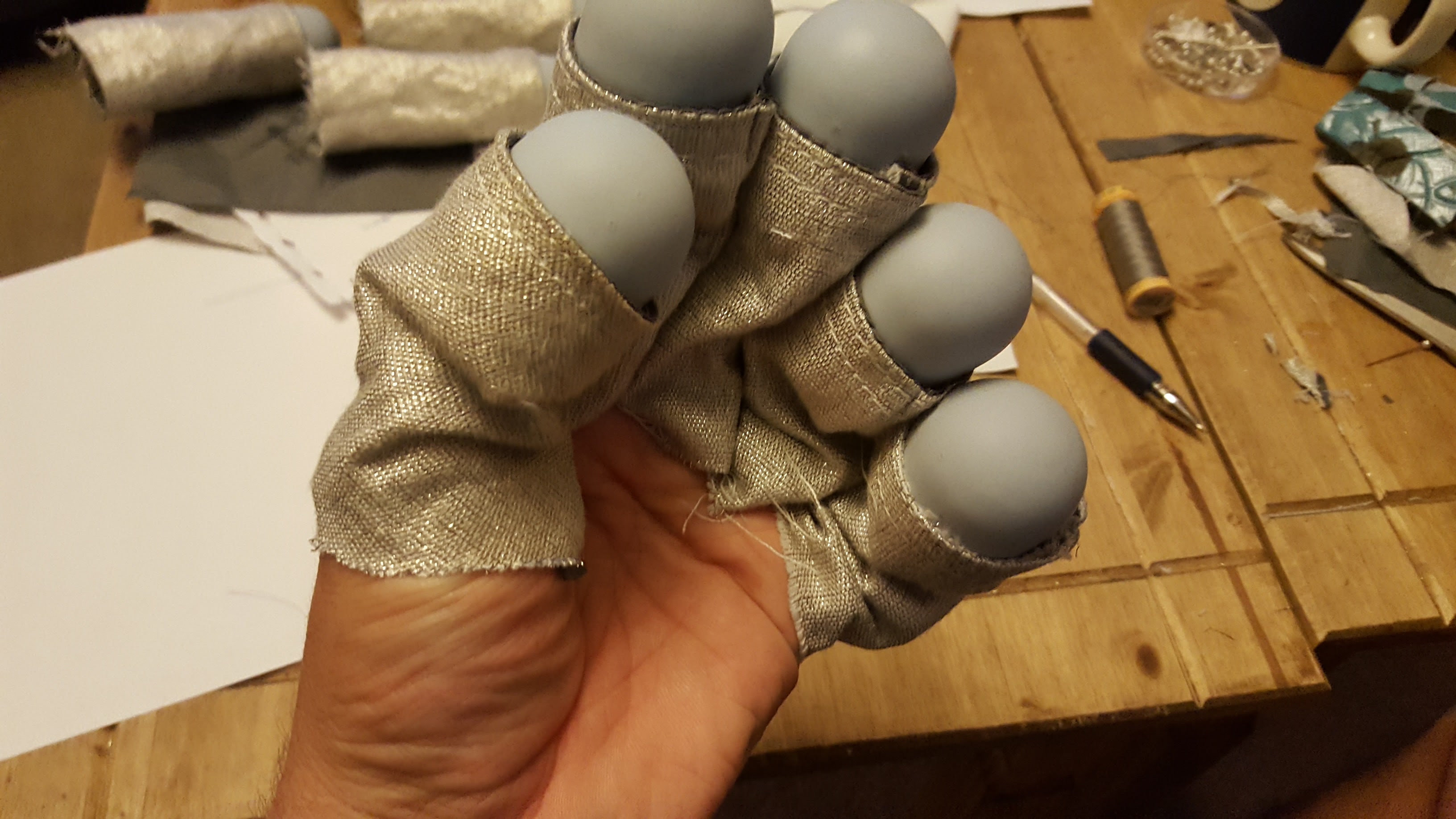

All that said, the photos show the stage I am at now, having made finger tubes ready for a wrap around cover. I'm not too bad at sewing so realised that the best way to assemble it is to sew the fingers together then put these in this cover.
