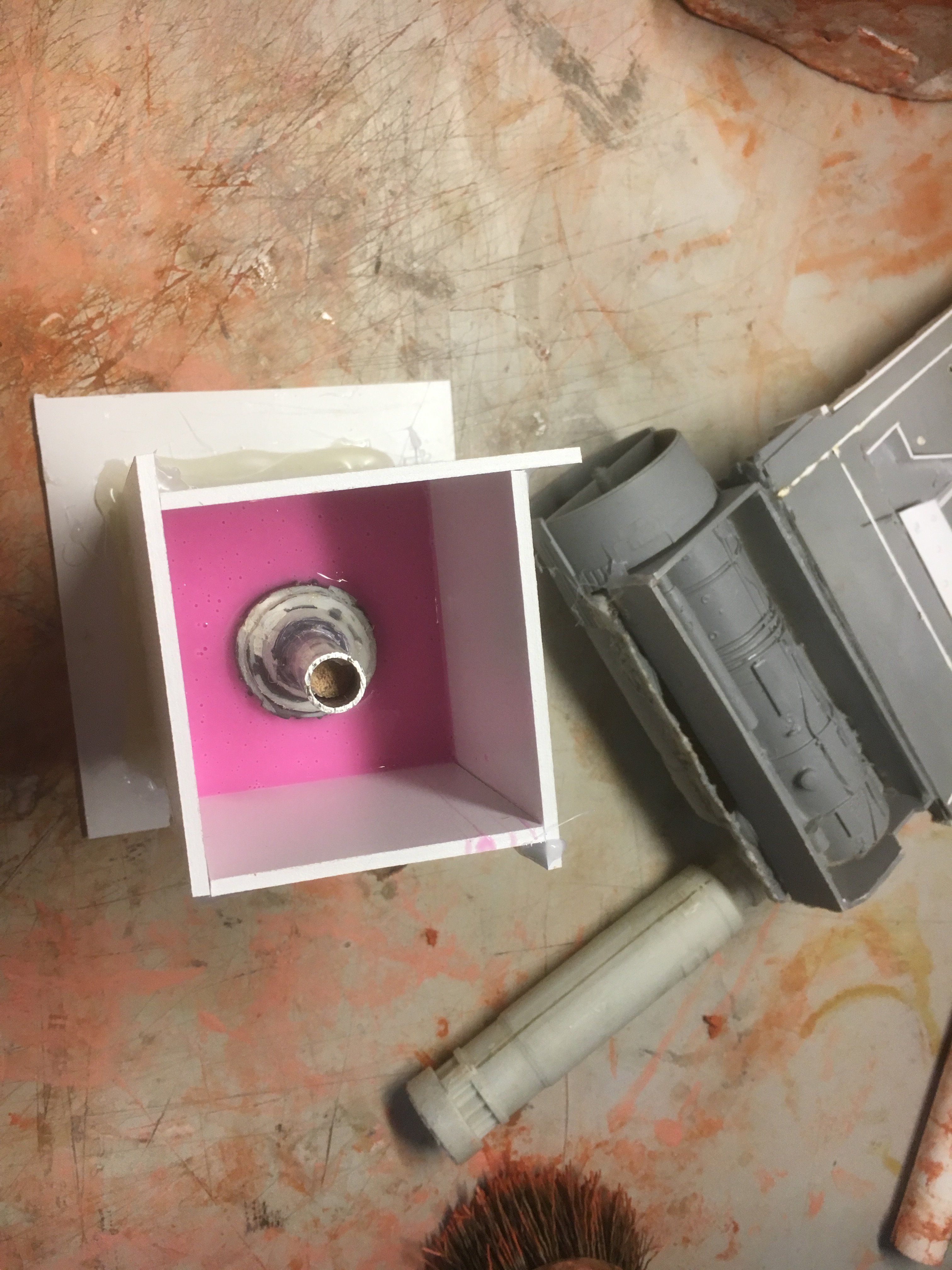

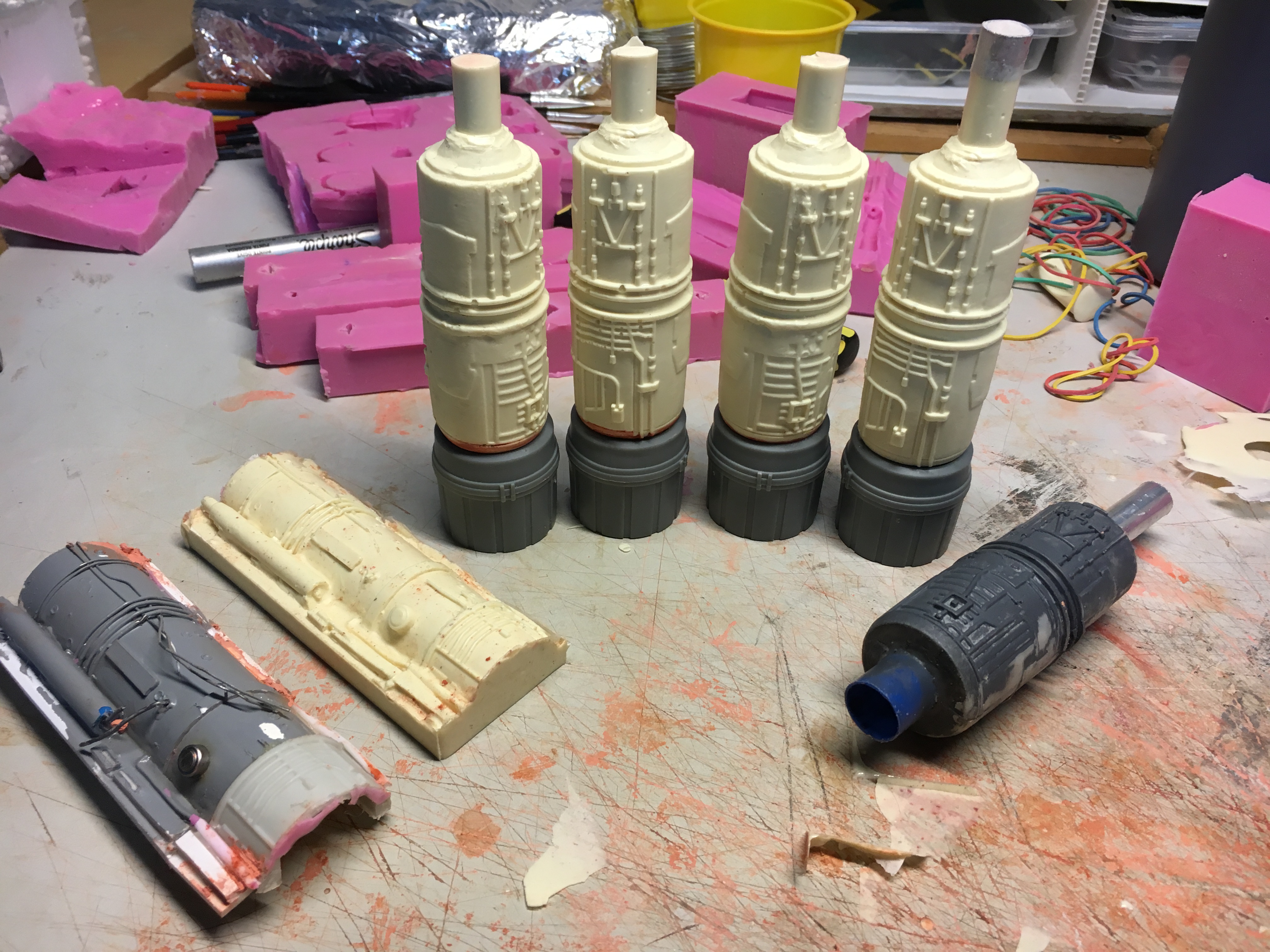

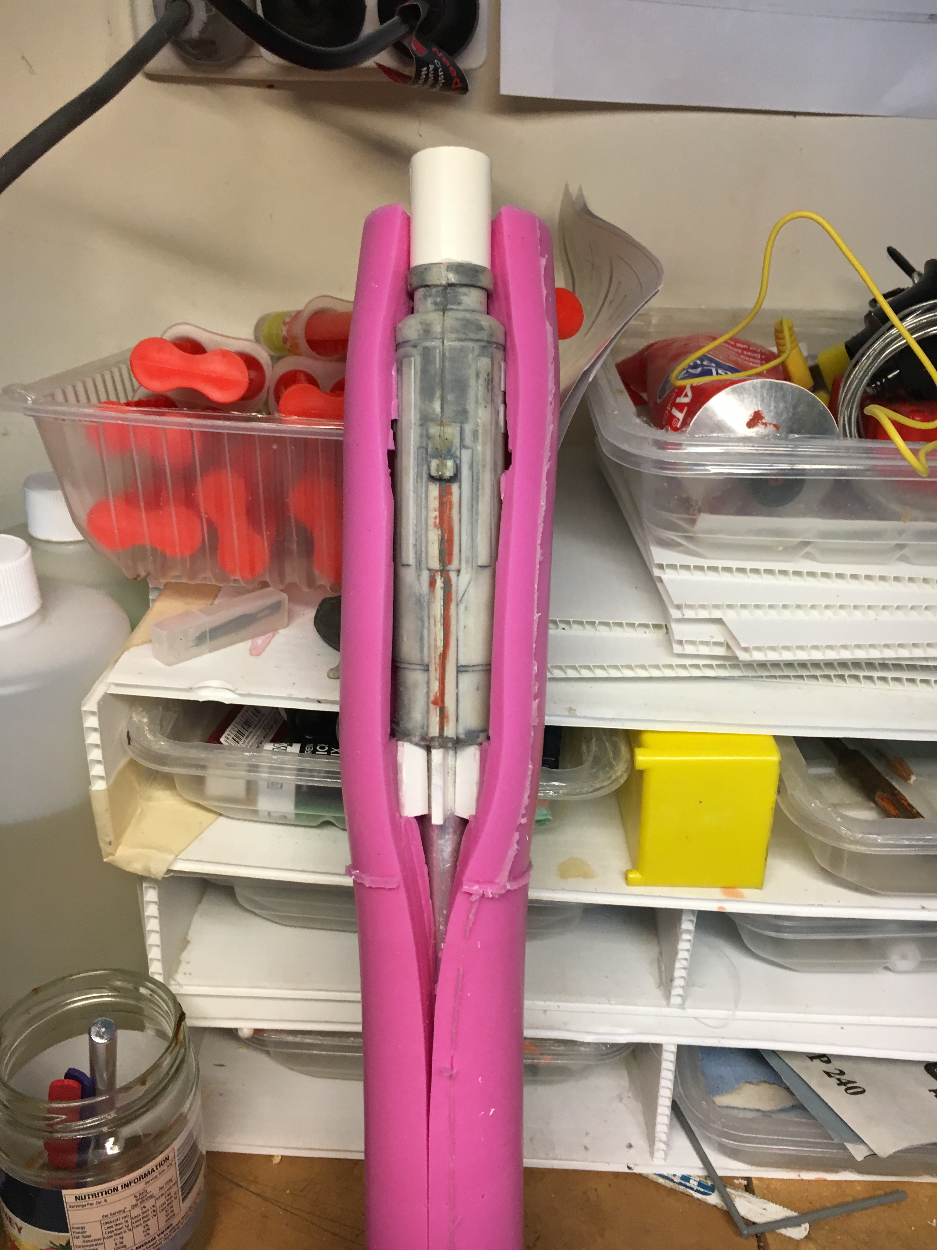

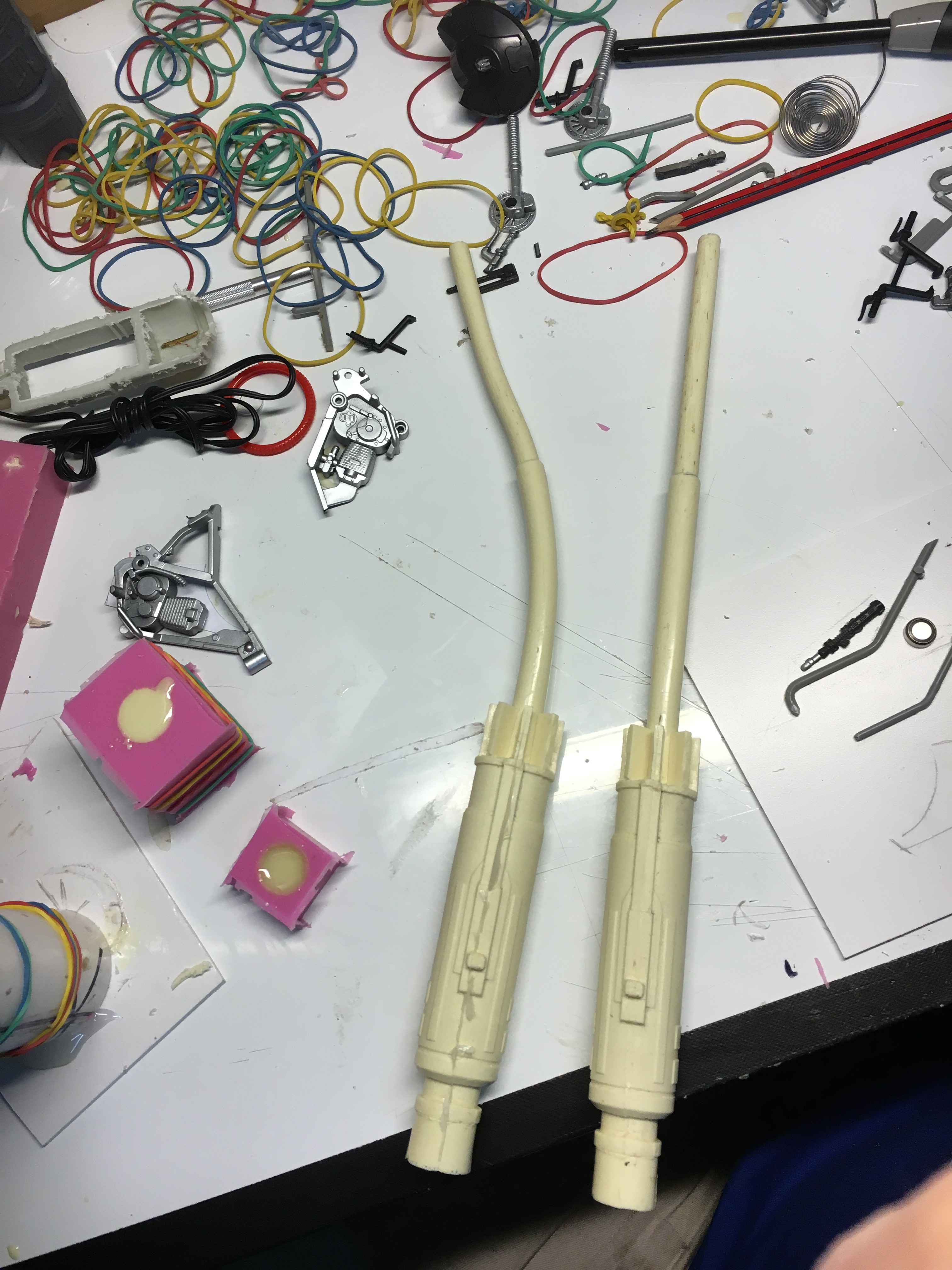

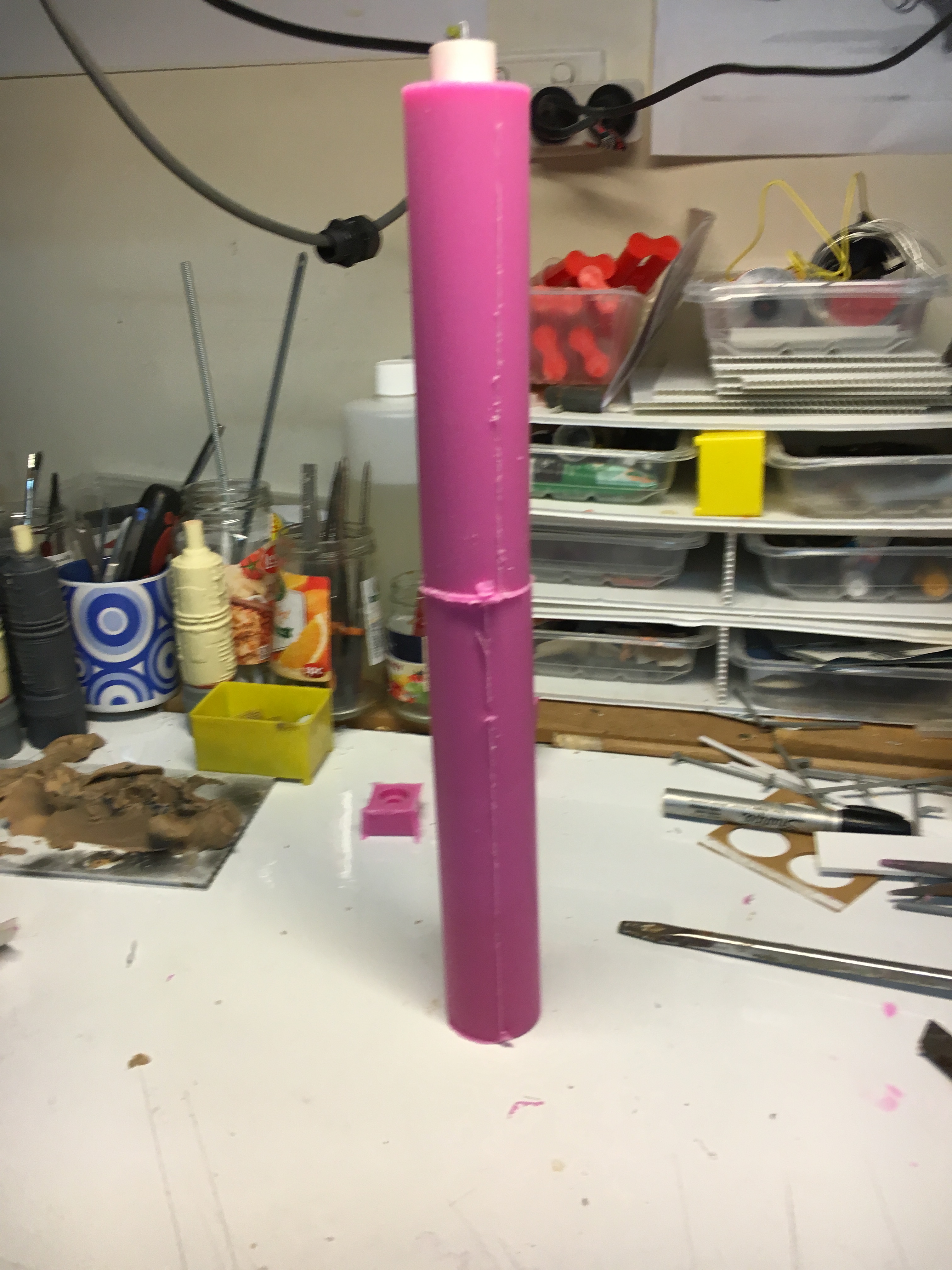

..some examples of my PinkySil adventures....
