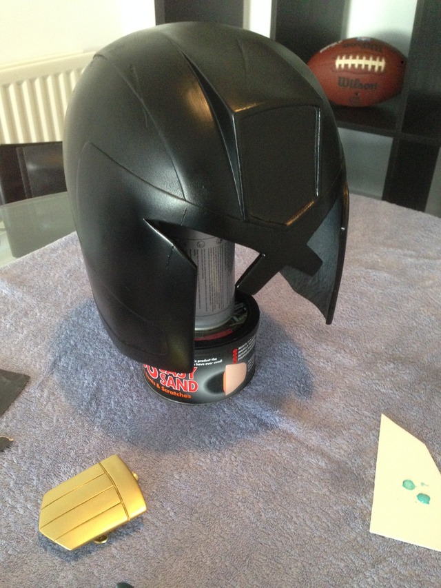

The beginning

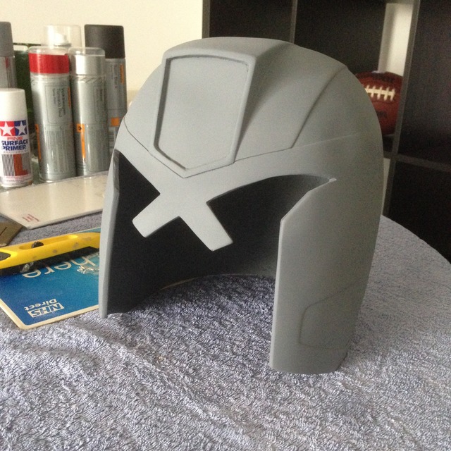

Trimmed, filled and primered

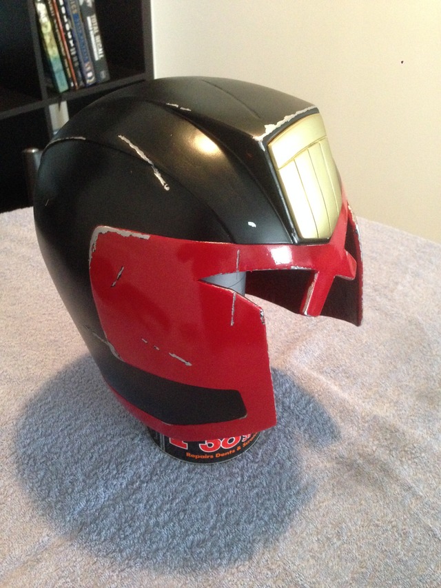

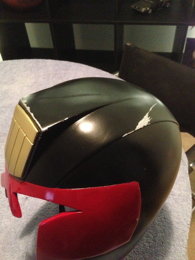

Scribing the damage

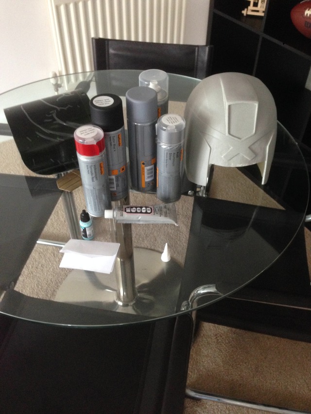

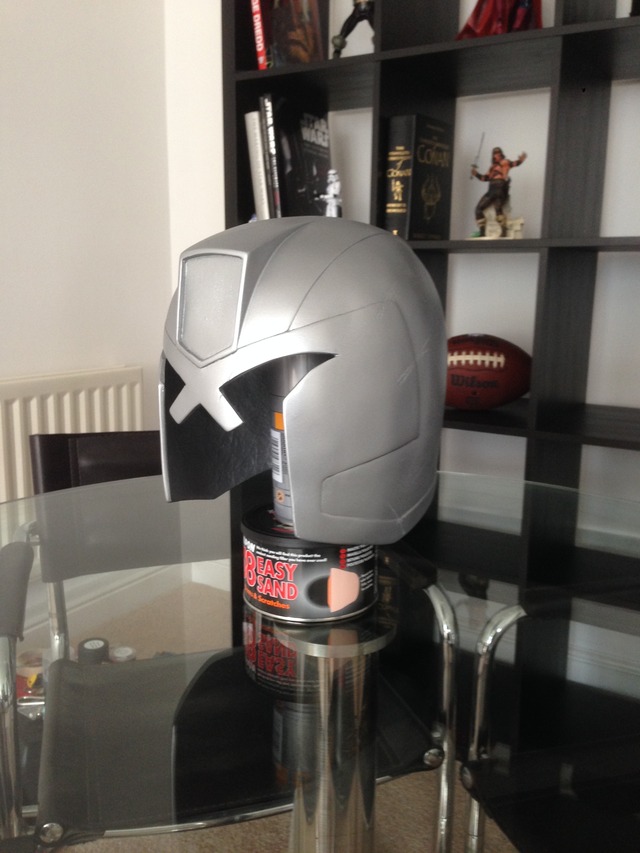

Silver laid down
Black laid down

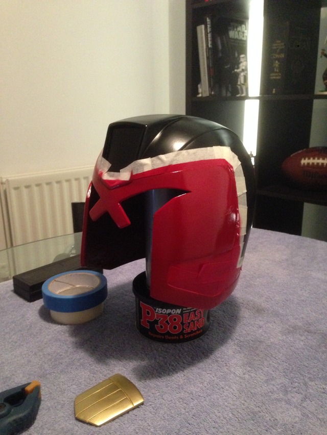

Masked up and red applied
Scraping away the liquid mask, and general attacking with x-acto to chip up the paint

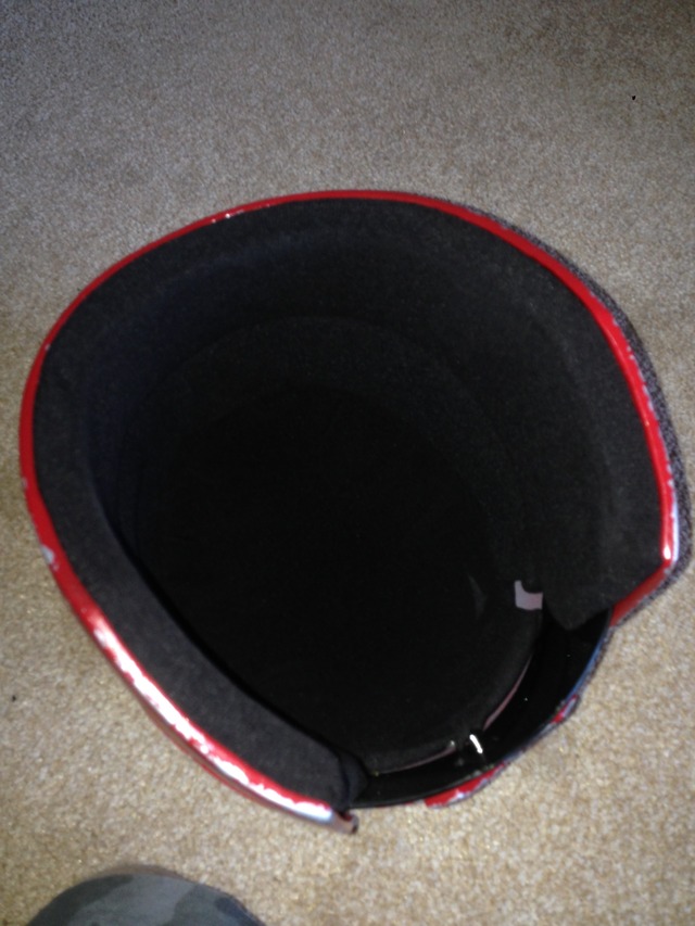

Padding cut, covered and in place

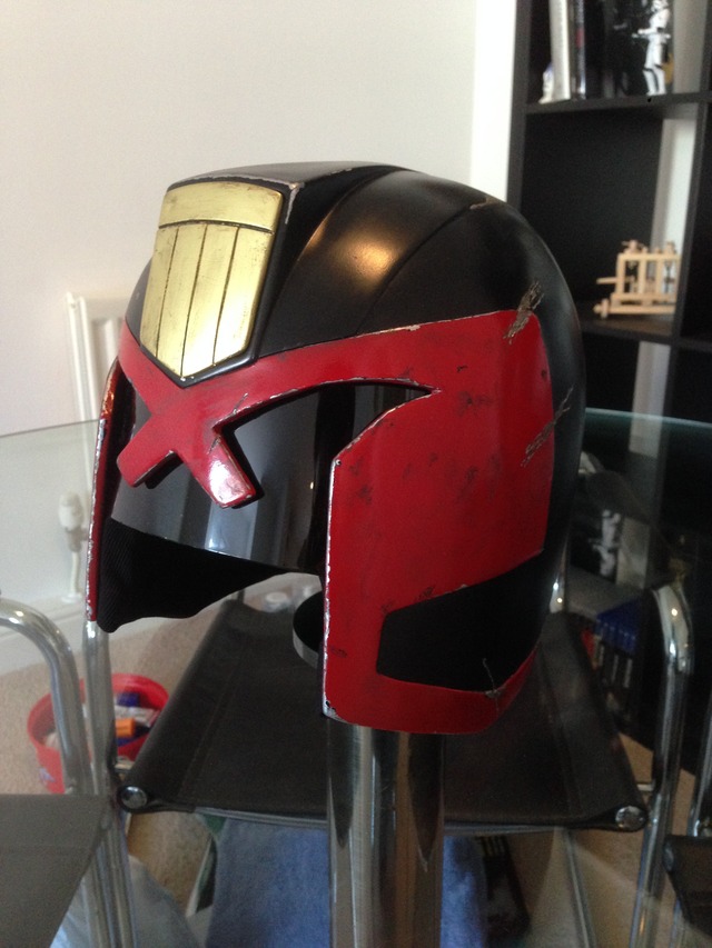

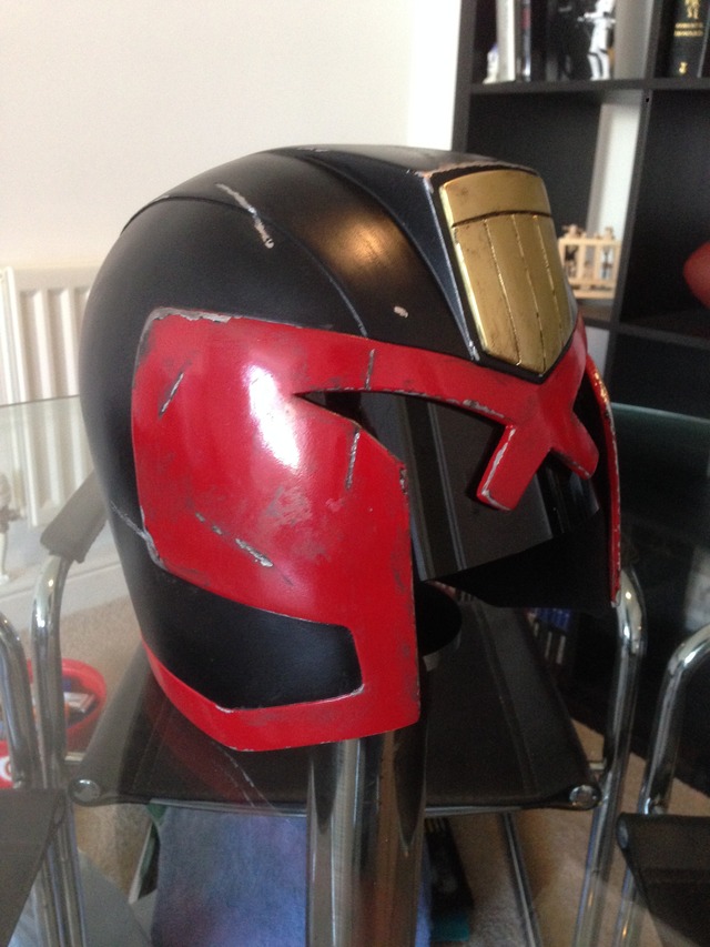

And finally, getting it dirty, with washes, matt clear mixed with charcoal, cloths, and generall over handling.
looks great, from uk too can you remember what colours halfords spray paint you used and how do you weather the red and black down
Silver base was halfords aluminium, the black is halfords satin black, prefer it to gloss as you don't have to spend time reducing the shine, and the red is VW tornado red.
All the damage was scribed in prior to priming then liquid masked off. This worked fine on the black but due to paint layers it became harder to remove on the red, for that I went at it with a squared off xacto blade to carve chunks out down to the silver base layer, some of the silver came away but it added to the look.
The dirt was simply a mix of watered down black and brown acrylic model paints. It was painted on in specific areas and immediately wiped off, then repeated on the same areas to build up the layers, some was just lightly dabbed to make it look a bit thicker. Also It was applied a little heavier over the scratches. For some of it, I burnt a full box of matches and crushed them down to powder, then this was mixed with some clear matt resin and splodged in some places, this was done sparingly though and was really only a test. The badge got a similar treatment. This had some scuffs scratched in with sandpaper prior to paint and clearcoating, then the same wash and wipe application was used.
To be honest, its not 100% done, it needs a little tidying and scuffing with sandpaper on the black where some of the washes look a bit too obvious/clearly painted on, and the badge could do with being a little duller.
have seen a video on you tube where the guy cut out doing all the dremmeling scratches and just rubbed his dredd helmet on a rough brick wall lol..........thing is he achieved the same result, a brave method
I think that was Fulvio from pannaus props, i wasn't that brave, and wanted to try and replicate Dredds helmet
