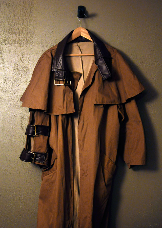

  • One thing that always seems a little bit off on the Hellboy costumes I've seen is his coat. Most people seem to use modified off-the-rack dusters, which I didn't want to do because they are usually too short, have incorrect pockets or other details that would need heavy modding. The China-made replicas available on ebay all look wrong too. So, I searched out a western duster pattern and made it myself. I was lucky to find a fabric that closely matches the color and fabric used but i still had to do give it some extra dye. A fellow RPFer is currently embossing a BPRD patch for me. I did allow myself to go "close enough" on a few details though. I decided to use pleather for the collar and straps to keep costs down but I intend on weathering it to look more natural. Also, the arm straps are a little too wide and since I honestly hate sewing I decided to leave out the lining. I'm inserting a photo of my WIP coat below. (Note: the right sleeve is shorter but the coat is hanging rather sloppily.)

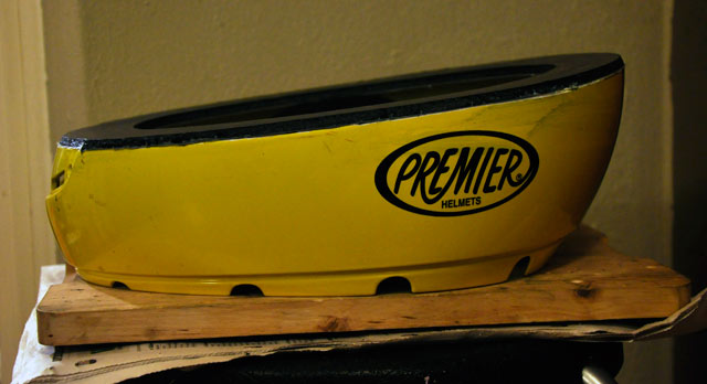

  • I have already made a start on his helmet, using an old motorcyle helmet as a base from which to build on (see the photo below). Building the details around the helmet will be fairly straightforward but the glass dome is probably the most difficult item to replicate out of all three costumes. It has a very complex shape that I mayb not be able to copy perfectly within a reasonable budget. If anyone has suggestions, they are more than welcome. My "worst case" plan is to simply buy a plexiglass dome and to try and shape it with some heat.

interesting that you're using a m/c helmet for Krauss. I'm just about to start making this suit for a friend and still collecting info on it.
Re: BPRD project: Hellboy, Krauss & Sherman
Yeah, the helmet shape is almost perfect and by using the existing padding you solve the problem of having it sit comfortable on the head. (The side/cheek foam is enough to hold it steady.) I've actually made a lot of progress since I last posted but have been busy with life issues. I'll have some kind of update soon (ish).
One thing I ended up having to do was get a custom dome ordered from a local supplier. It was expensive as hell (to the tune of 250-300 I think) but the standard oval domes available just wouldn't work. Even so, this dome will not be completely accurate and nowhere near as thick, even though it is much thicker than acrylic domes usually are.

Sounds like you have quite a bit of work cut out for ya. Even though you changed some details on the coat it looks a million times better than ones I've seen on ebay, etc. Looking forward to seeing more progress!
