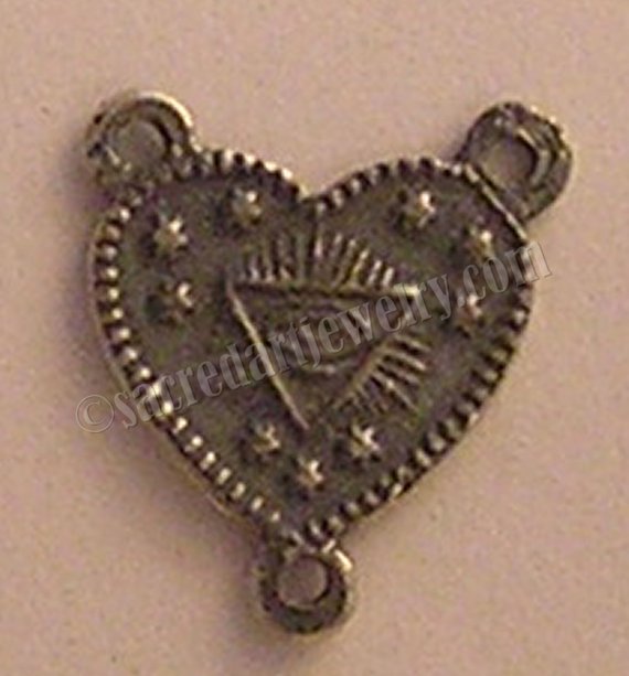

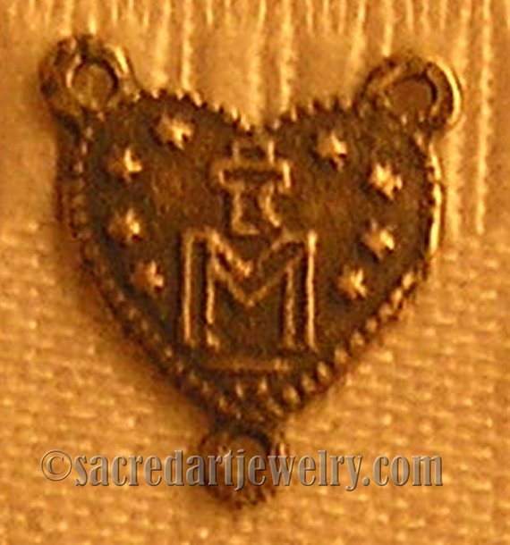

I also ordered the centerpiece and I plan on sanding off the little bumps around the edges. I'm leaving the design on the back as is but i"m going to sand the front flat. I've got a tiny plastic figure of the Virgin Mary and I'm going to mold and cast just the front side. I'll then attach it upside down like on the screen used piece. I may mold and cast the final version also. Right now my plan is to make two complete rosaries and maybe more later on.
Here's a link to the centerpiece I'm using. Minimalist Eye of God Rosary Center - Sterling Silver, or True Bronze Saint Religious Replica - Vintage Catholic Pendant #848

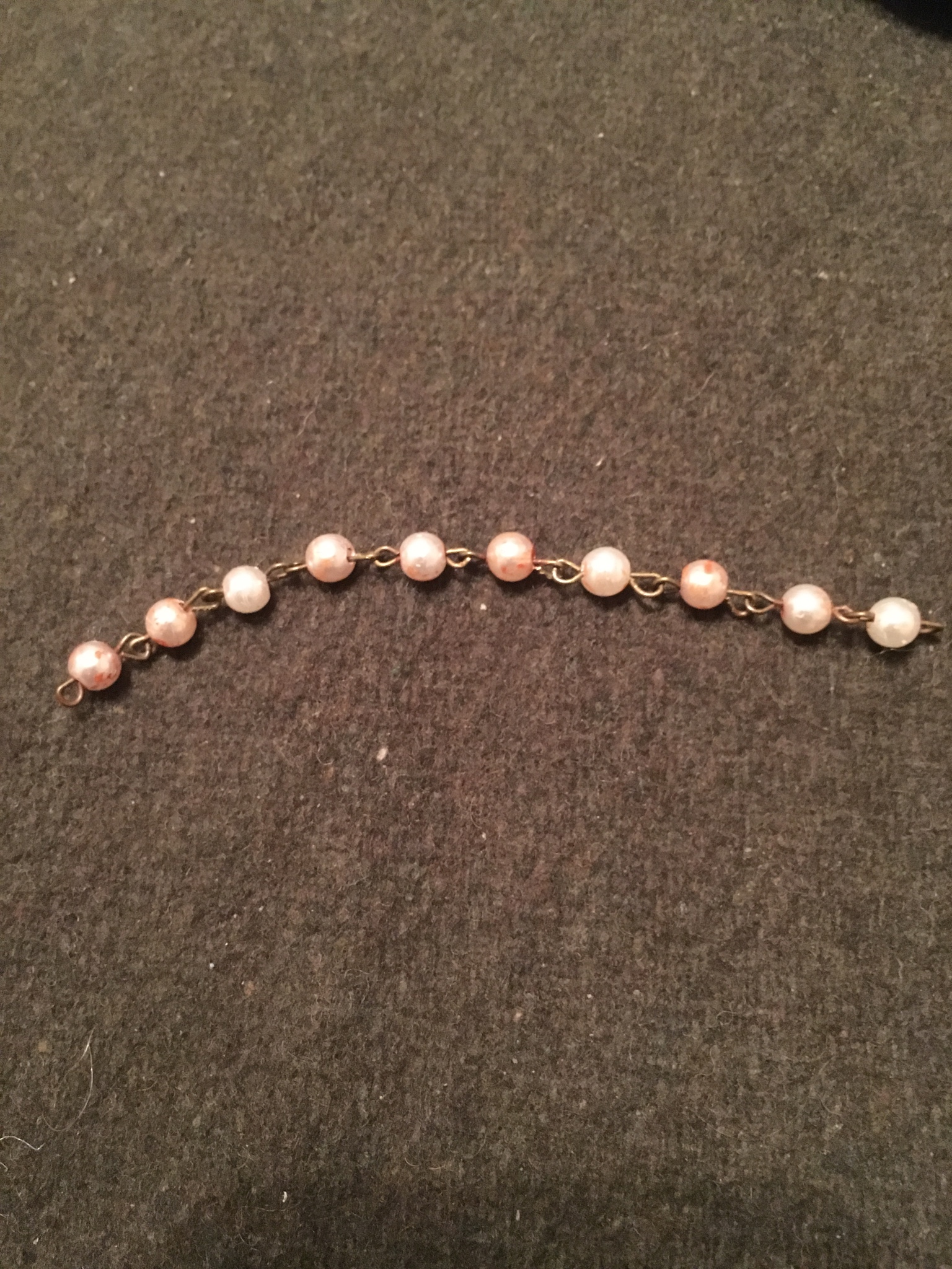

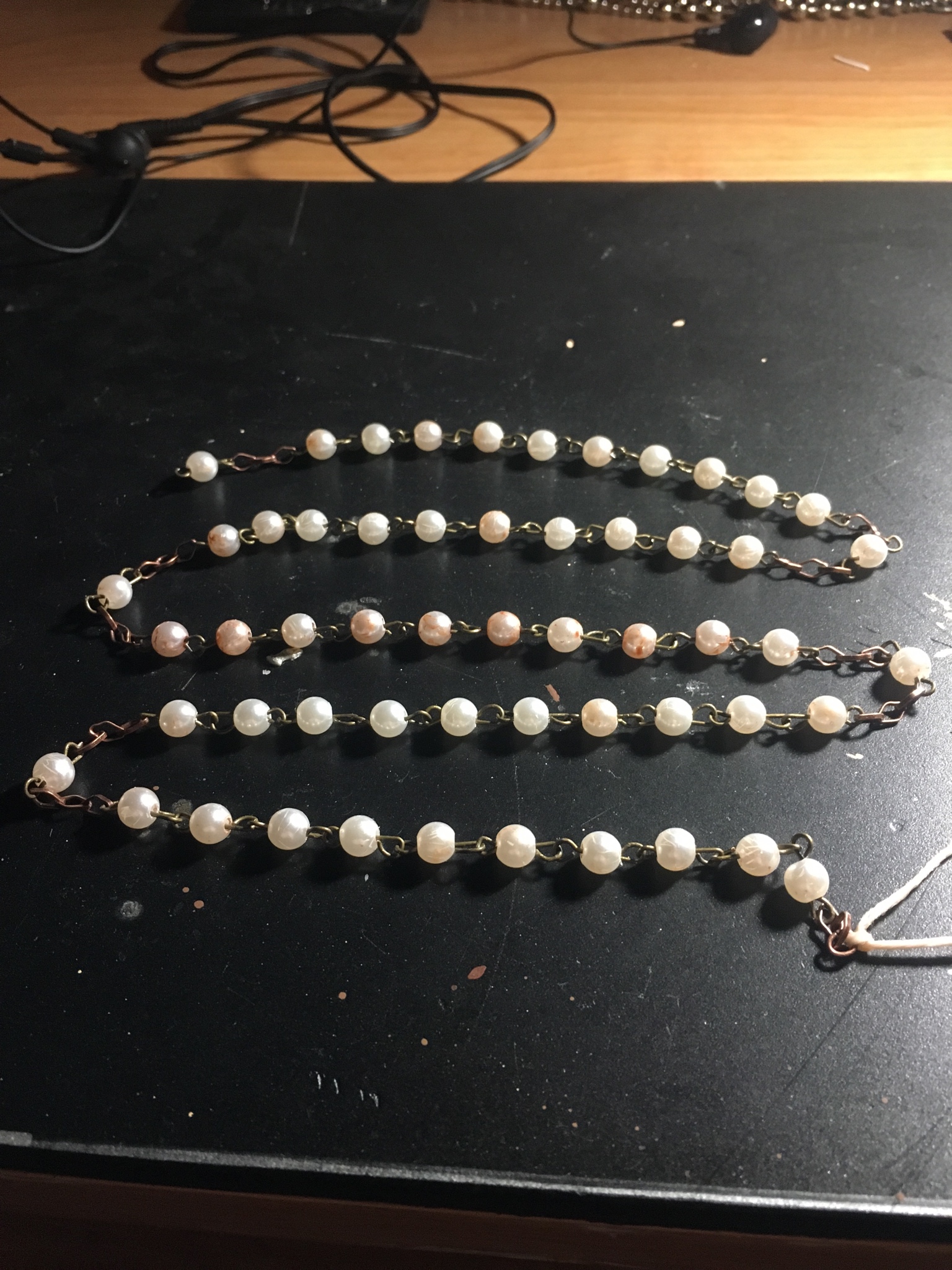

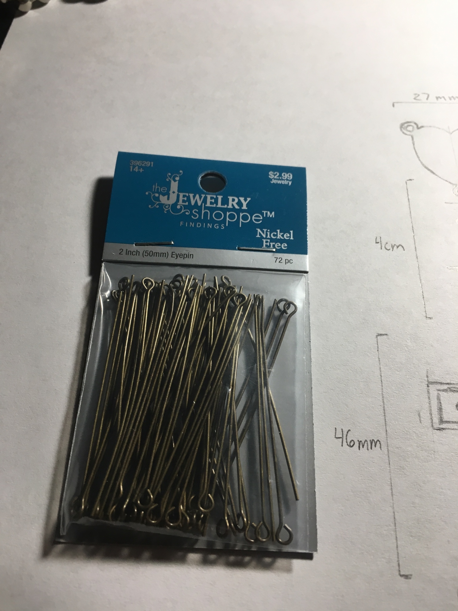

I went to Hobby Lobby Saturday and picked up some parts. I found some 6mm beads that looked pretty close. I used a craft blade and scraped them up a bit then did a couple paint and coffee washes to give them the marbled look of the orginals. They still nedded a final wash in the pictures. I also picked up some copper chain and eyepins for bead work.

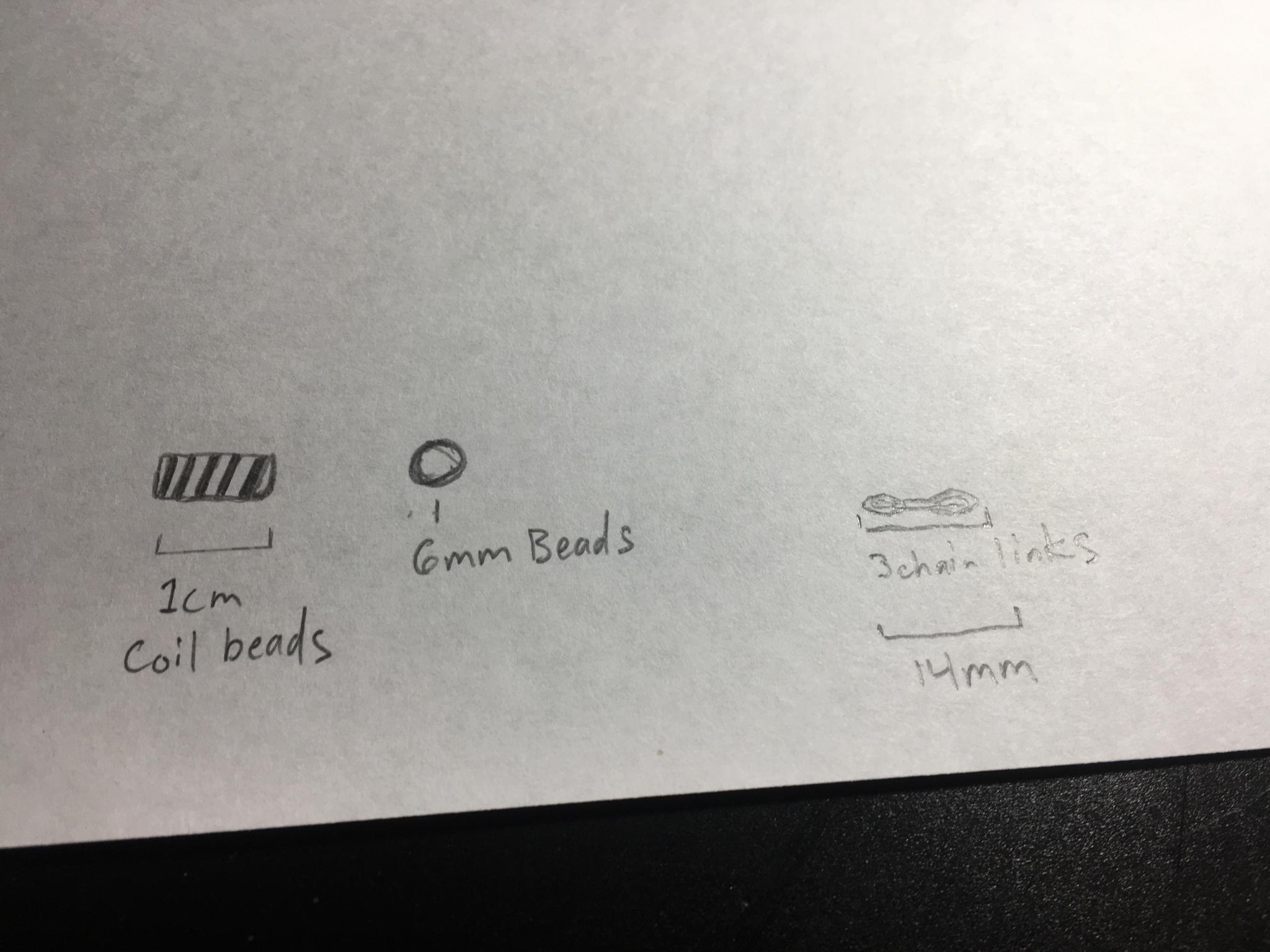

Next I did some sketches of the bead layout and scaled drawings.

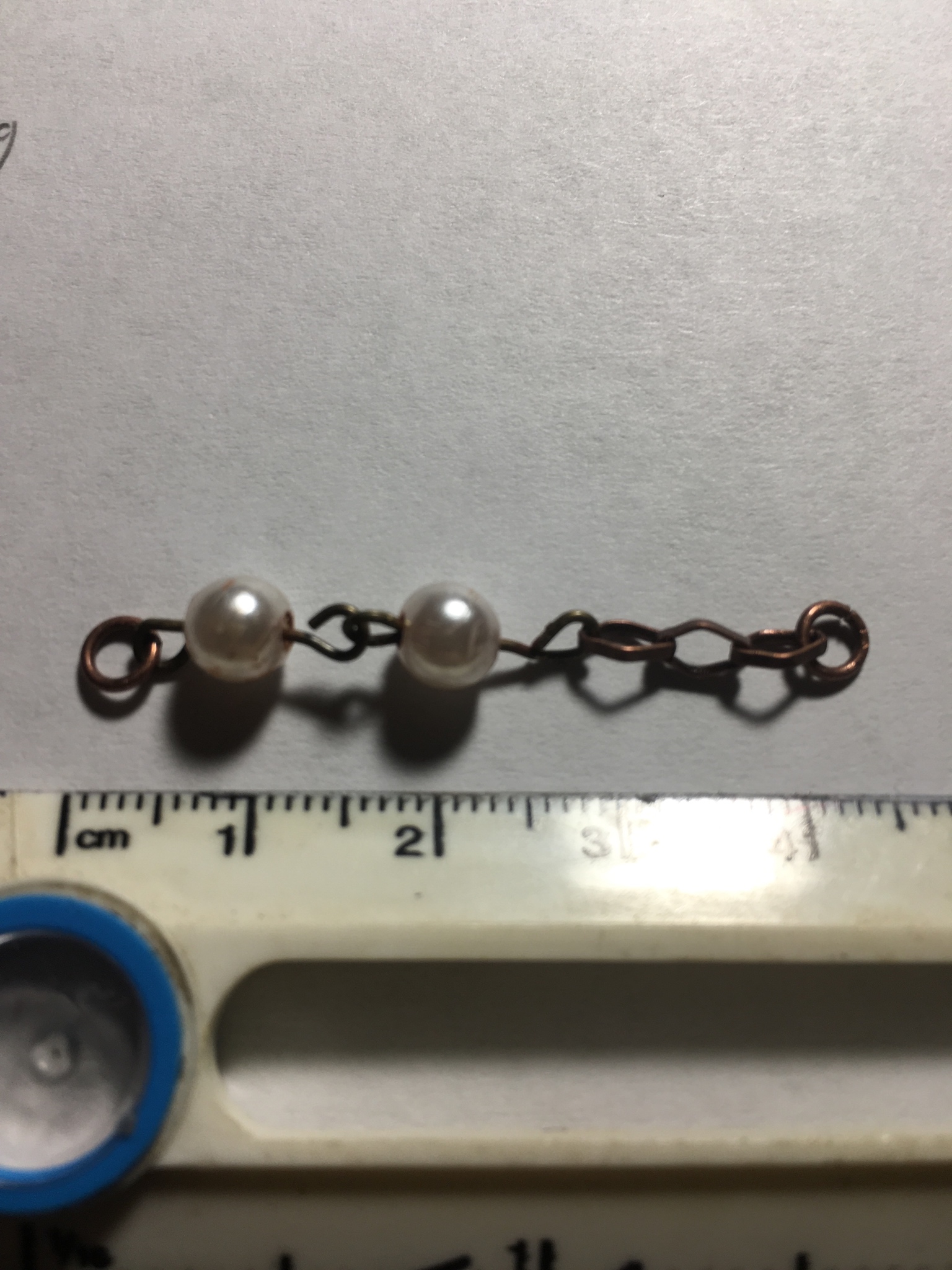

Next I put together all eight decades of beads, prepped the "our father" beads and cut several sections of the copper chain (3 links each) that go on either side of the single round beads between the long strands (decades).
Finally I attached all the sections together minus the last three decades which get the coil beads as spacers.
Close up of the single beads with chain links.

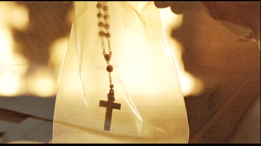

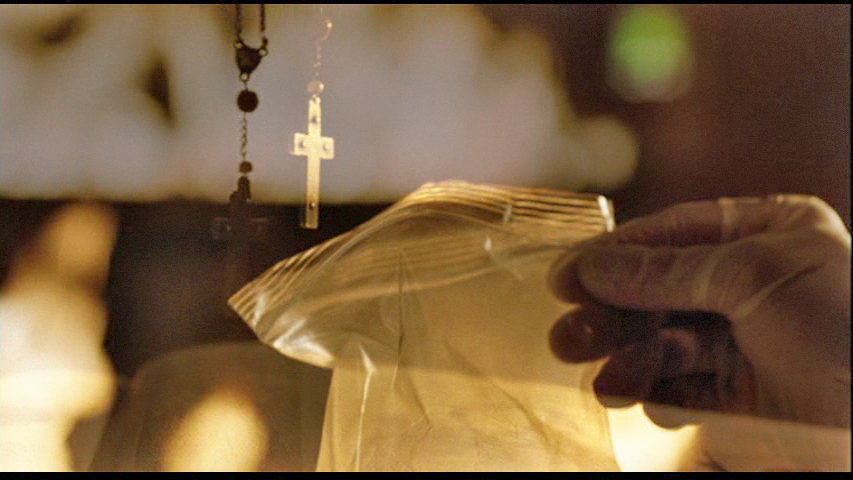

Here are a couple of promo stills I was able to find.

Thanks. The second one looks like the same rosary but the first one looks like it's made of cord with wood beads. Looks like the same crucifix though and that image gives a better view of the side detail of the scroll and overall thickness.

Attached are some retouched screencaps (sadly, not HD).

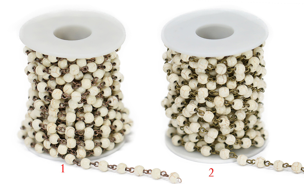

I also agree. I did wonder if it might be made from Howlite Rosary chains like you can get on Etsy but can't see the beads clearly enough to judge. The beads are definitely opaque though. Perhaps this will encourage someone to come forward with better reference?
Thanks for the images Krats. I think you're right the howlite looks extremely close. If you zoom in on the beads it looks like there are streaks of darker color running through them like on the howlite beads.

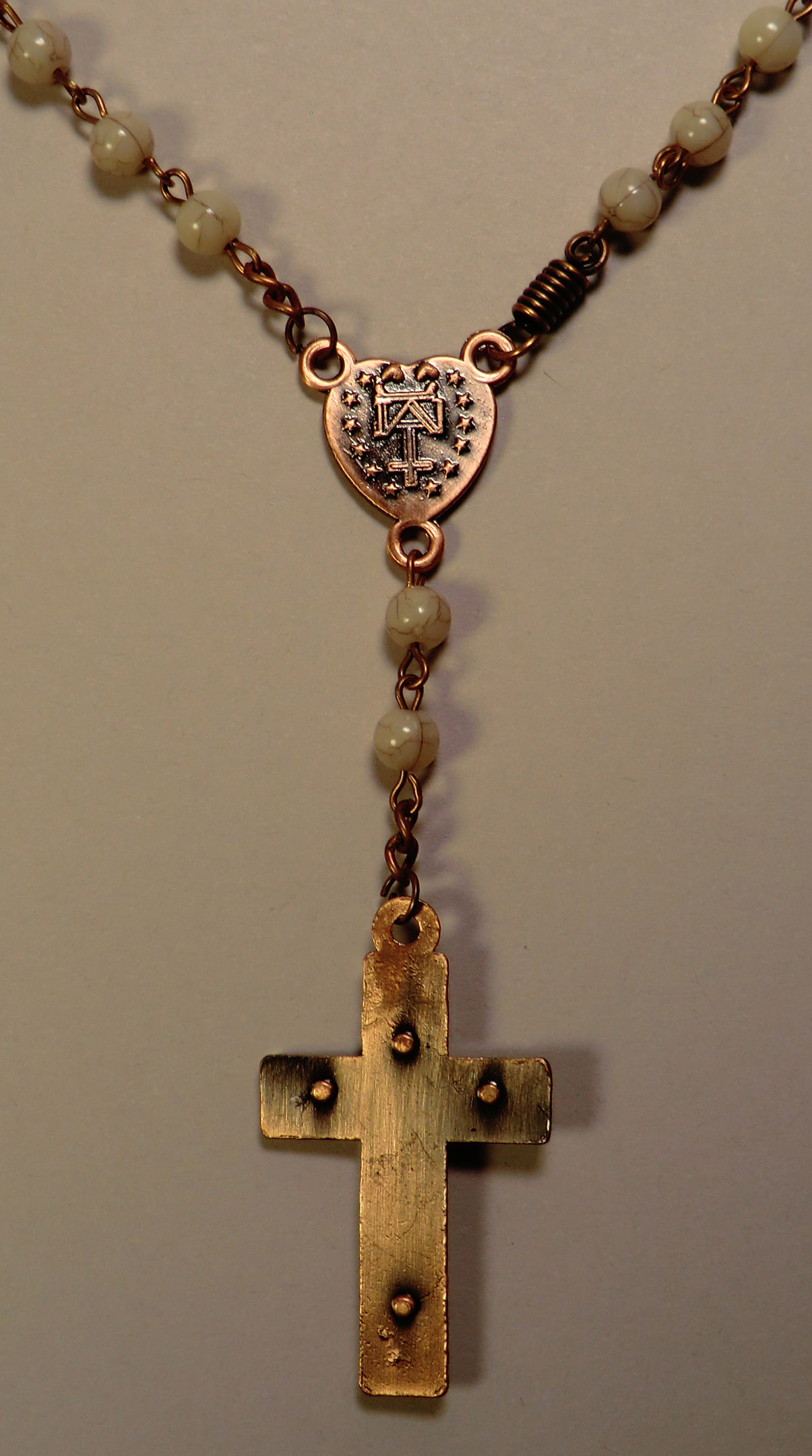

Small update. I ordered some howlite rosary chain and I picked up a small bronze chain that matches the segments used on the original. I also worked on modifying the crucifix. I used super sculpy to make the scroll and rivet heads and yes I burnt it. I then added 2mm styrene to the back and sides of the crucifix since it was too narrow and thin after all. Later (not pictured) I cut the styrene flush and filled all the seams. Tonight I'm going to mold it then cast a few in cold cast bronze. I plan on epoxying a sheet of bronze to the back of the casts for added strength and to add some weight so they feel more realistic.
