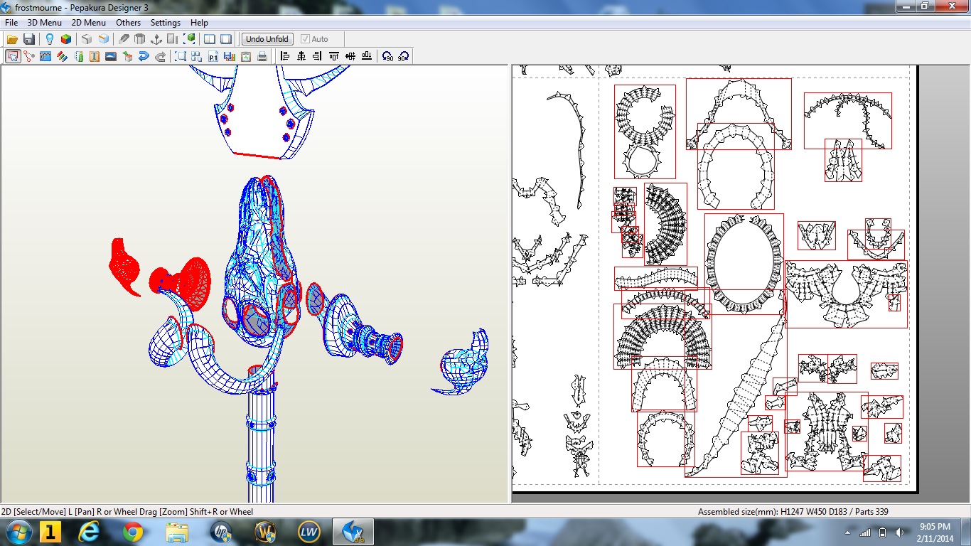

I'll see what I can do for ya, already started with fixing the sword last night

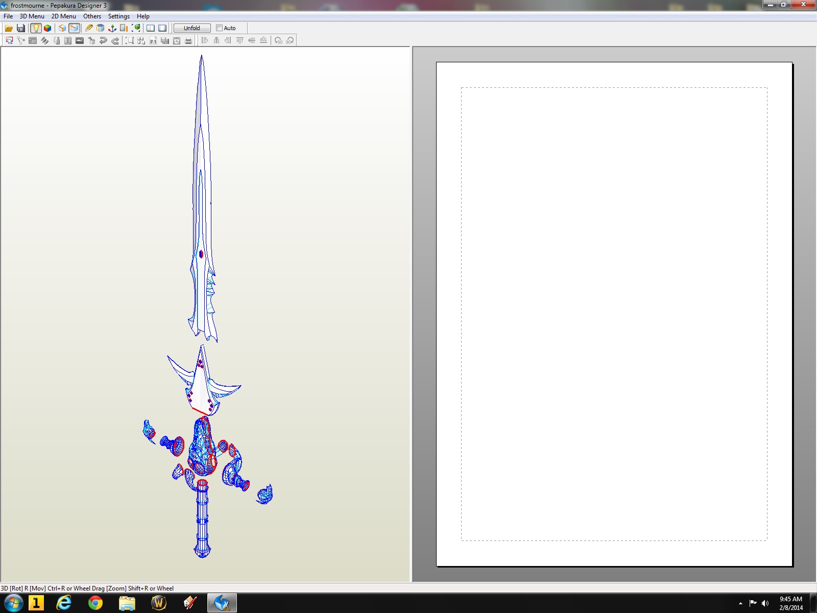

It's taking a little bit longer than expected, there was a lot of issues with the original 3D Mesh. Starting to unfold it by section now.
All but the guard is finished (large center skull)

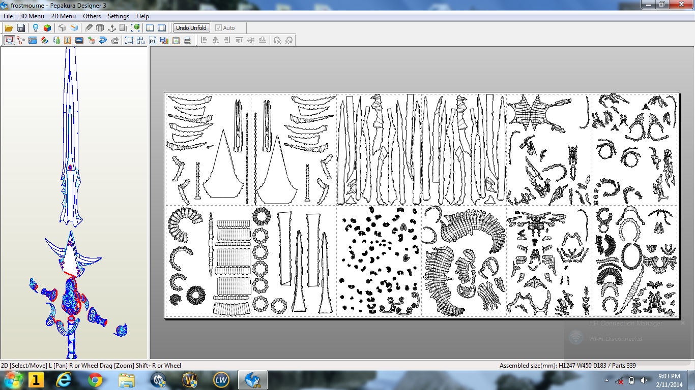

I'm still unfolding the large center skull... and who ever put all these blasted dots on it needs to be strangled...
Between my sanity and my OCD I'v almost got em all done...

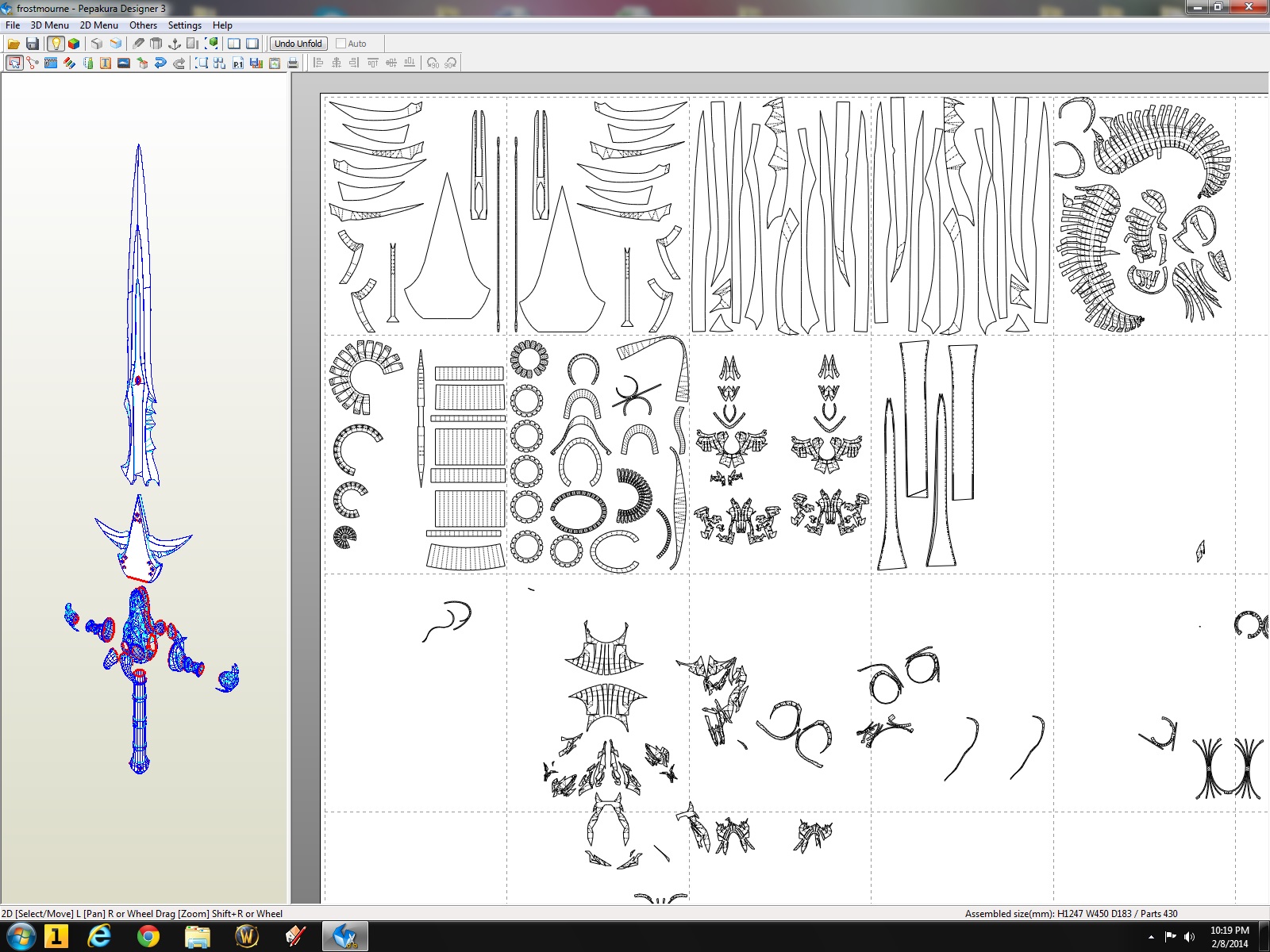

It's late, I'm on the home stretch, and I'm out of rum...
I will do my best to finish this up tomarrow
I break complex items into smaller parts and move them around so I can get a better view of them. I cant measure the total length because my method. All I can say is the measurements will be close to an average 2 handed sword.

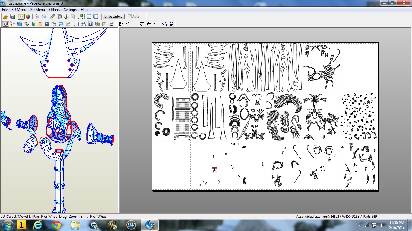

thank you. I have a question about it. if yo zoom way out, there are parts not on a page, are those imprtant? also are you doing therest of the armor, or just the sword? Thank you
thoes are the pieces to the other side of the guard I didn't unfold. Both sides are identical, that's why I mentioned to print out the last page twice.

Blah... should have known it was a trap... look at all thoes dots.. ;)
