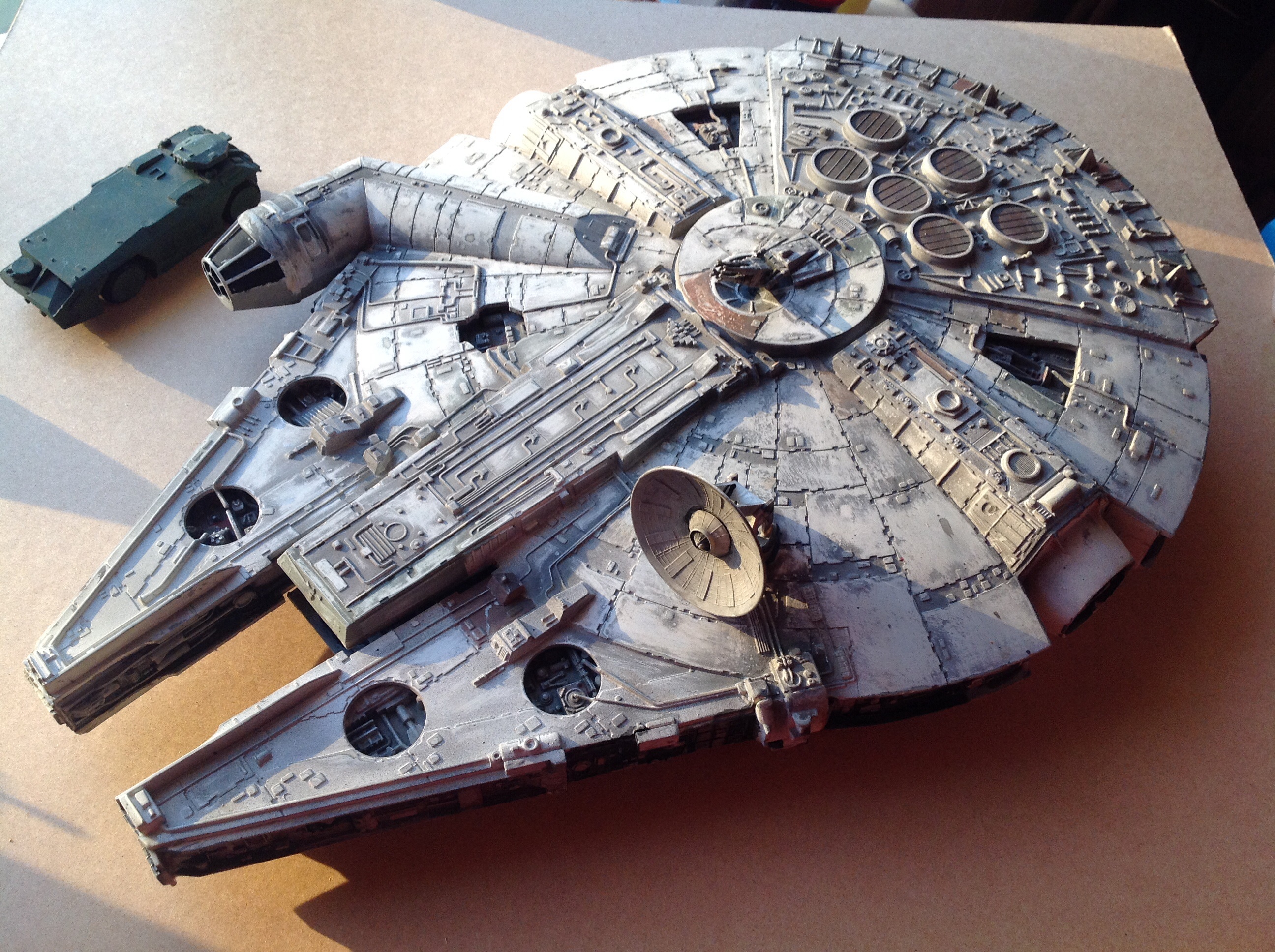

J, if you are not going to use the 8 rib vents, want to sell them as I prefer the 8 rib
Also, on the rear insert with the two sherman tanks, whats the tank in the middle?
Your rear deck is looking great. I see you have removed a lot of the fat pipe detail...I am just waiting for a micro scalpel to turn up. Its amazing what excites me sometimes..
Beautiful! Yeah, that center part in the back could use more detail.
Thanks Tek2,....dont know what I'll fill it with, might just scratch something
Yeah no problem samster,....the insert,...in between the shermans is part of a matilda....another cheap Airfix 1/72 model
Yes I removed some of the pipes,....once you get started though, you keep going,....then you've got a load of mess to tidy

Loving the pipe work just makes it so much better altogether :)
Do you use anything special like brass or is it all more random like the white pipe that you put in the cutouts?
Also I think the 6 rib is better, anything that pushes this towards the 5 footer is nice, like you said before any time you see the falcon and its not blurred its probably the 5', funny thing is I prefer the sidewalls on the 32"
What will you base your walls on J?

That part is from an Airfix 1/72 King Tiger......another wee cheap kit...£5.
http://www.airfix.com/media/catalog...525d08d6e5fb8d27136e95/a/5/a55303-website.jpg
http://i1119.photobucket.com/albums/k637/jaiteastu/Hasbro Hero Millennium Falcon/IMG_1397.jpg
It goes as the main part for here:
http://i1119.photobucket.com/albums/k637/jaiteastu/32inch Millennium Falcon/bay.jpg
John
EDIT: Yep HH, A Panther will work as well,....I just knew that the particular King Tiger's hatches could open,....maybe the Panther kits do also

Regarding these tank,/airfix pieces, could you just cut the originals out and add a little taller wall to them and then reattach? Trying to budget this build :)
Yeah Lee, thats what I did with the one on the portside,.....doing what you said to all three ( & possibly the circular ones on the mandibles) would add so much to the ship making it less moulded looking

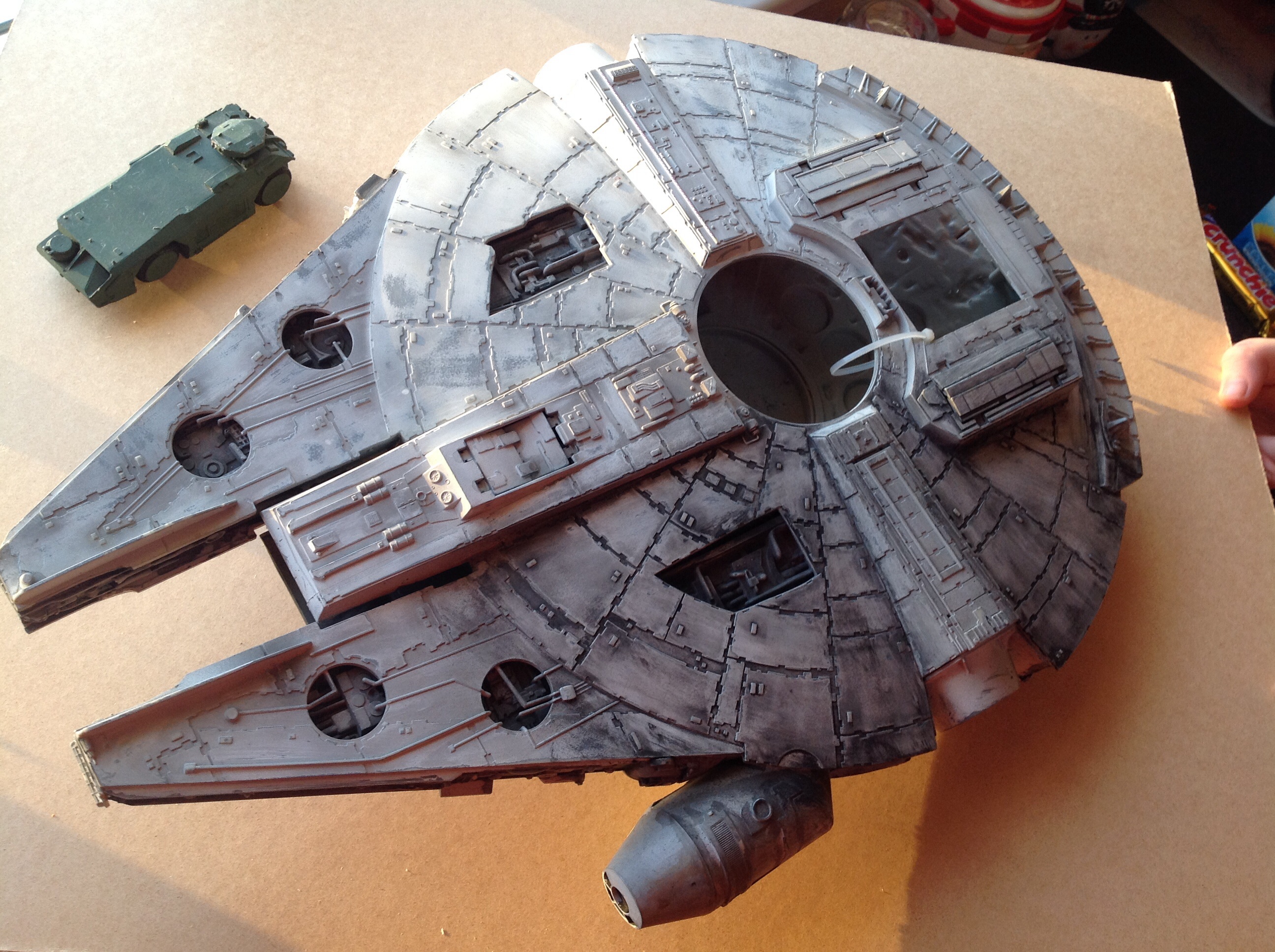

Hi jaitea ,
brilliant work on your hasbro ship , I have just received mine and started the insanity of making it better, I know there are a lot of details in some of the posts , but even with pharchivists brilliant summary I am confused on some points.
what are you using to glue styrene and kit parts to the plastic of this toy, I know ca is mentioned but is this prior to coverage with adhesion aid ( which btw is hard to get here in ireland, I am going to test plastic primer , and plastic paint) or after the model has been primed.
I want to mount this properly so am working to install alluminium box section within the model, I am considering epoxy resin to bond the aluminium to the plastic , has anyone had success with this.

I gave the ship a blast of the Adhesion Aid,.....then a spray of Bumper paint......after that CA seems to glue pretty well
