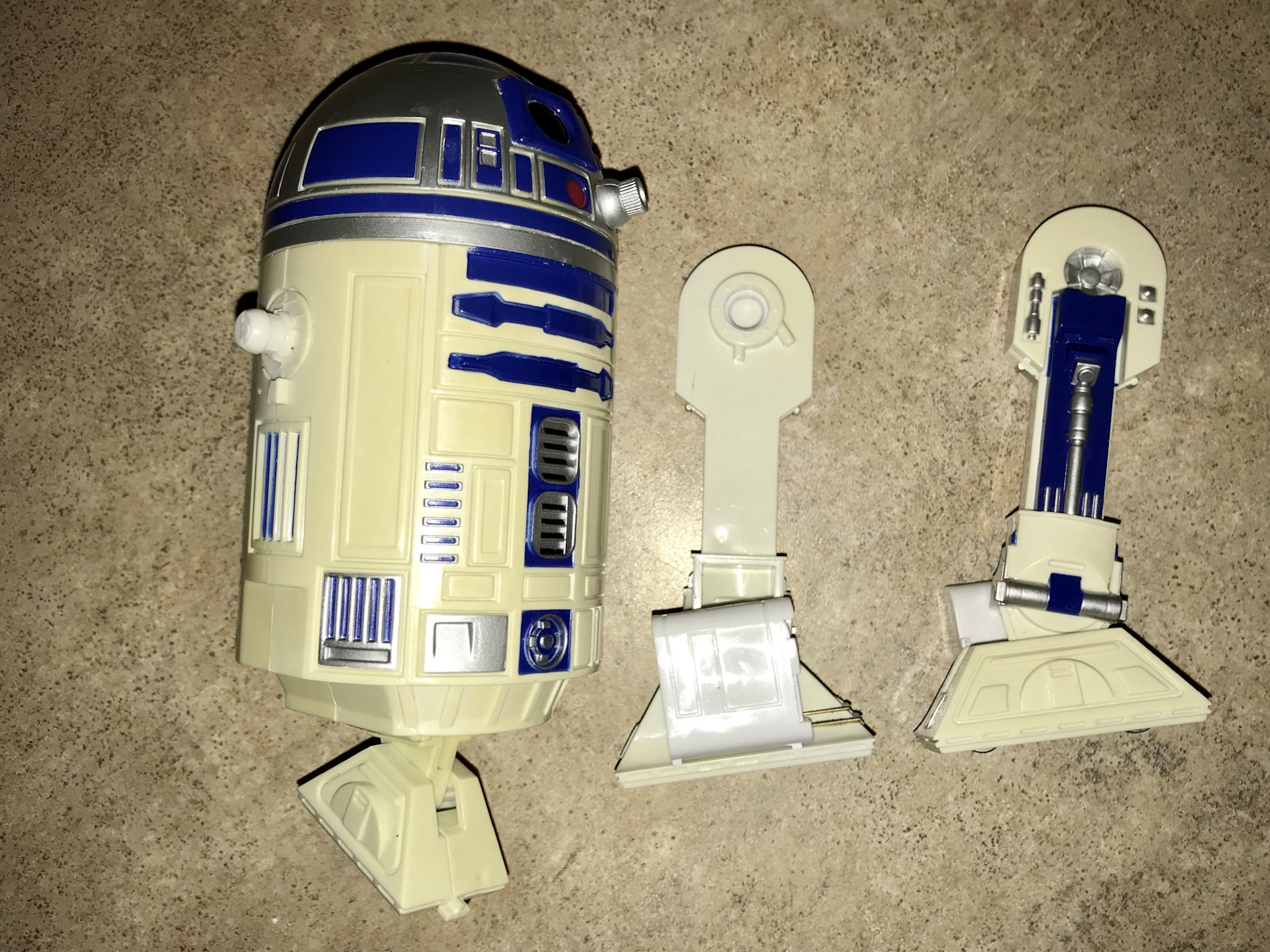

A few years back I had some success using this method except I used the gel method because it was for a large electronic R2. Ultimately it did work but it took many applications.

Like I said, I have had some success in the past with an electronic R2:
I had done this:
Day 1: 50 ml 3% peroxide, 1/4 tbs Oxiclean, 1.5 tsb cornstarch - 4 hours
Day 2: 50 ml #10 developer cream (3% peroxide), 1/4 tps Oxiclean - 4 hours
Day 3: 50 ml #40 developer cream (12% peroxide), 1/4 tps Oxiclean - 4 hours
Day 4: 50 ml #40 developer cream (12% peroxide), 1/4 tps Oxiclean - 4 hours
I think I would have had better result if I left it out in the sun longer but I was thinking that once it dried, it stoped working, but that might be untrue.
The other thing is that the mix I used was very easy to do but not sure if it was as effective as the previous listed method.
