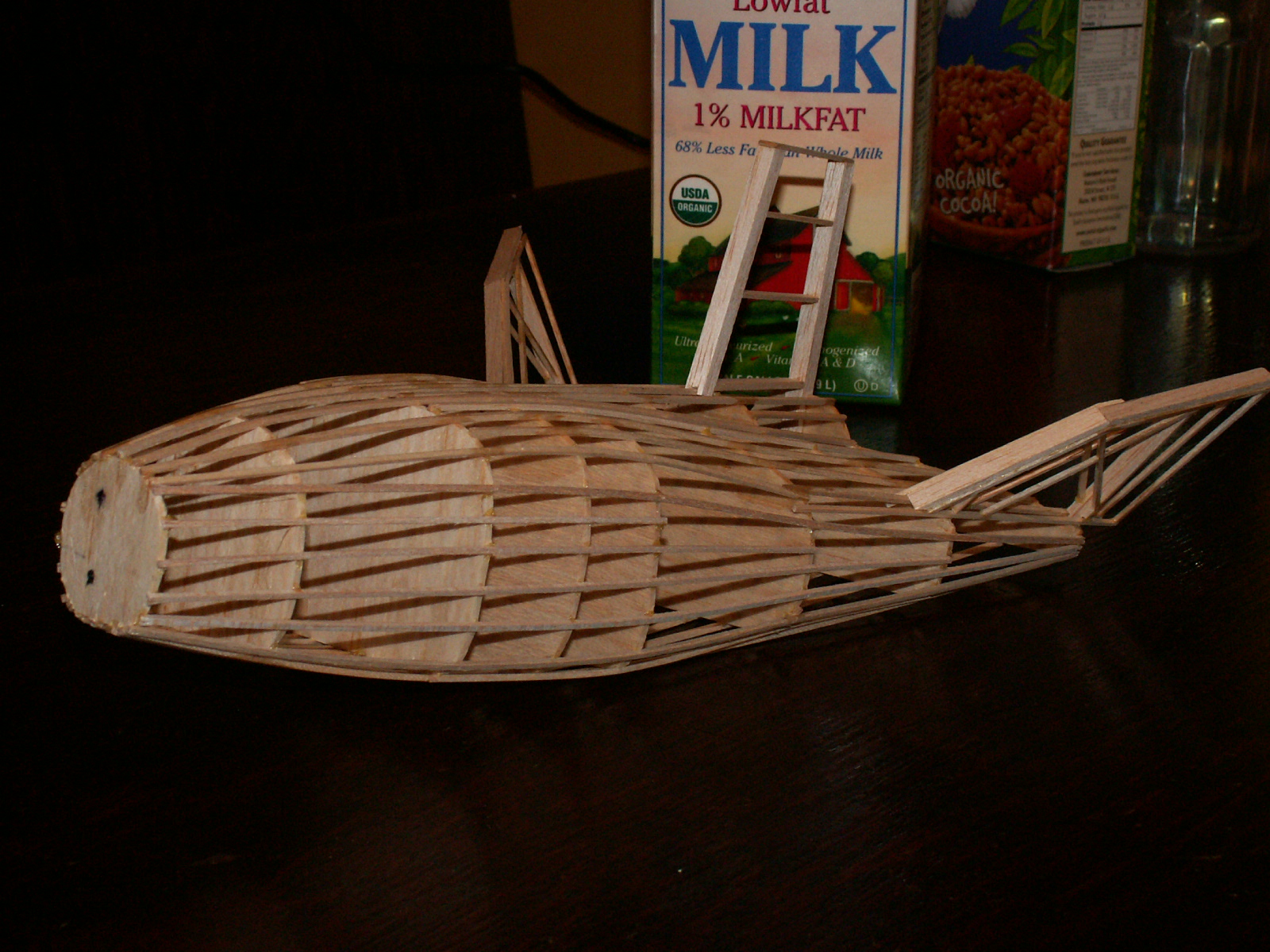

Curious —*I saw how you stacked cross-sections on a dowel and then the next image you suddenly had something volumetric.
What is that stuff? Bondo or something similar? I'm trying to learn how to do this.
Sorry for my ignorance.
You're probably not directing that to me, but my HL-10 build thread shows intermediate steps.
Thanks, Andy. I saw yours. It looks like you went with balsa sheeting (sheathing?).
I'm curious about this technique because you have a lot more leeway to sand/shape.

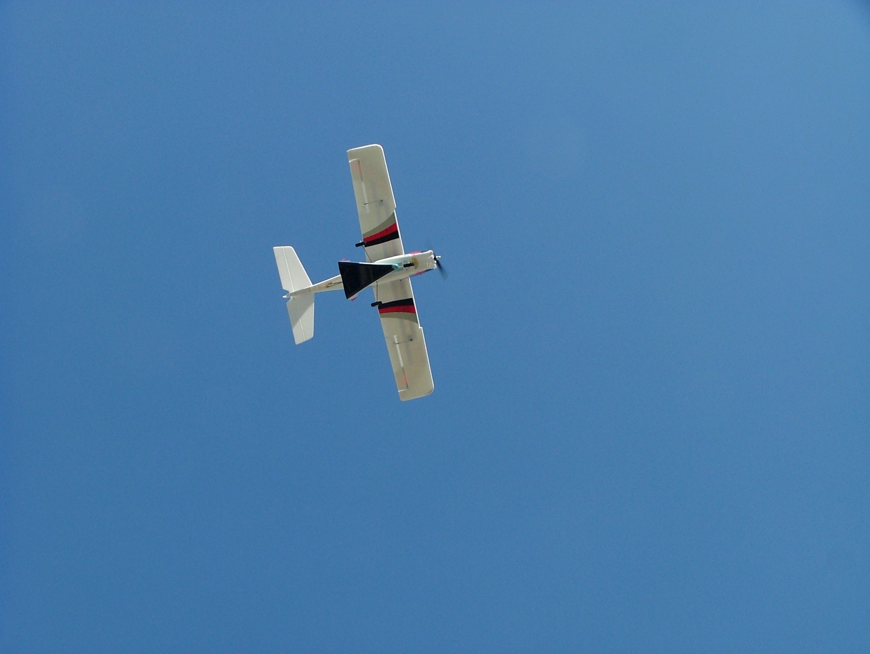

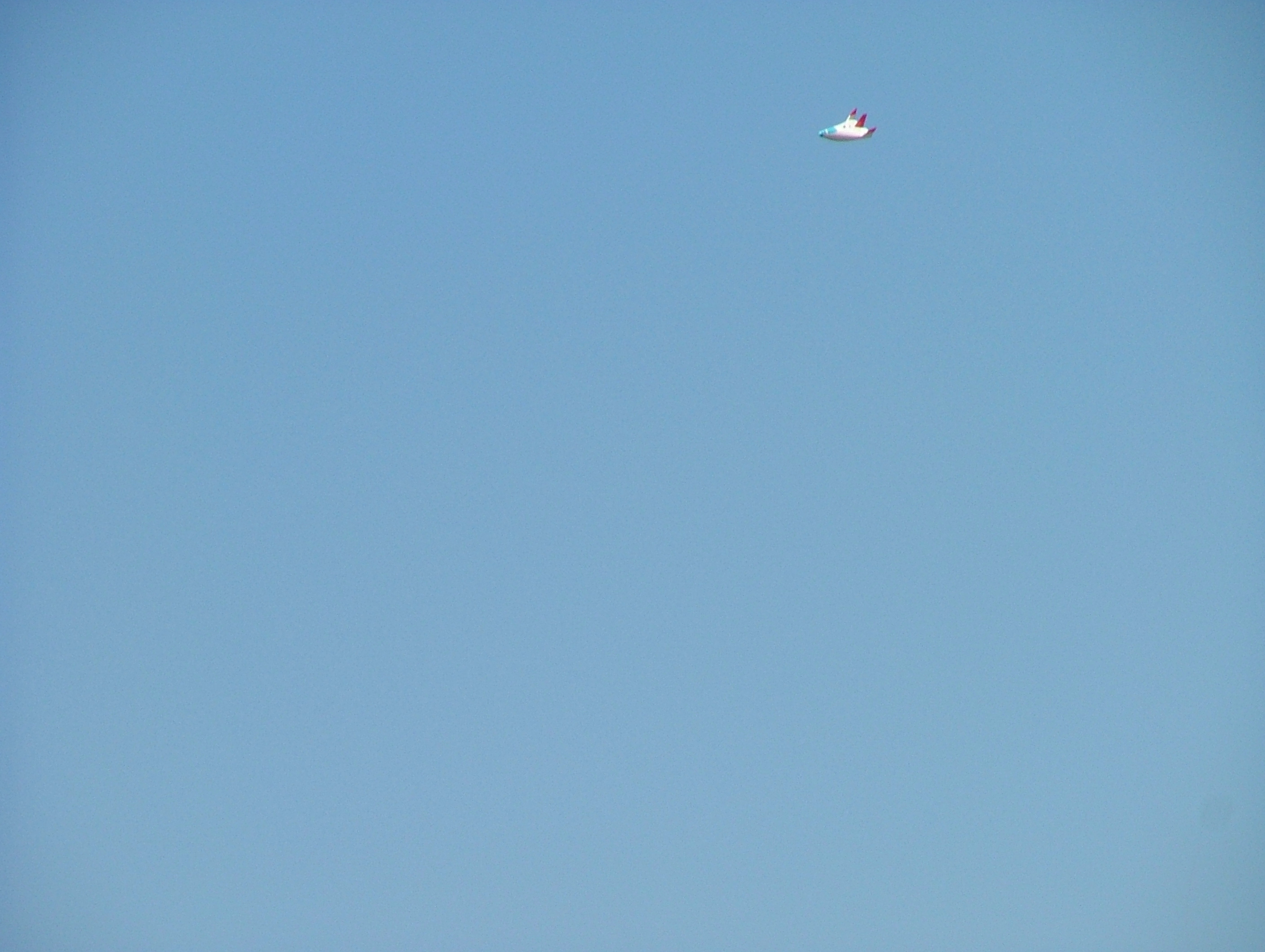

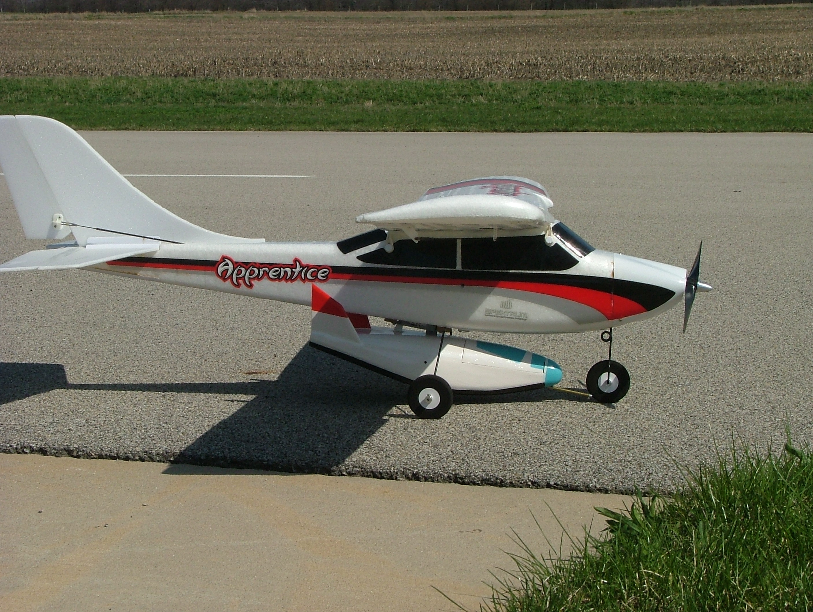

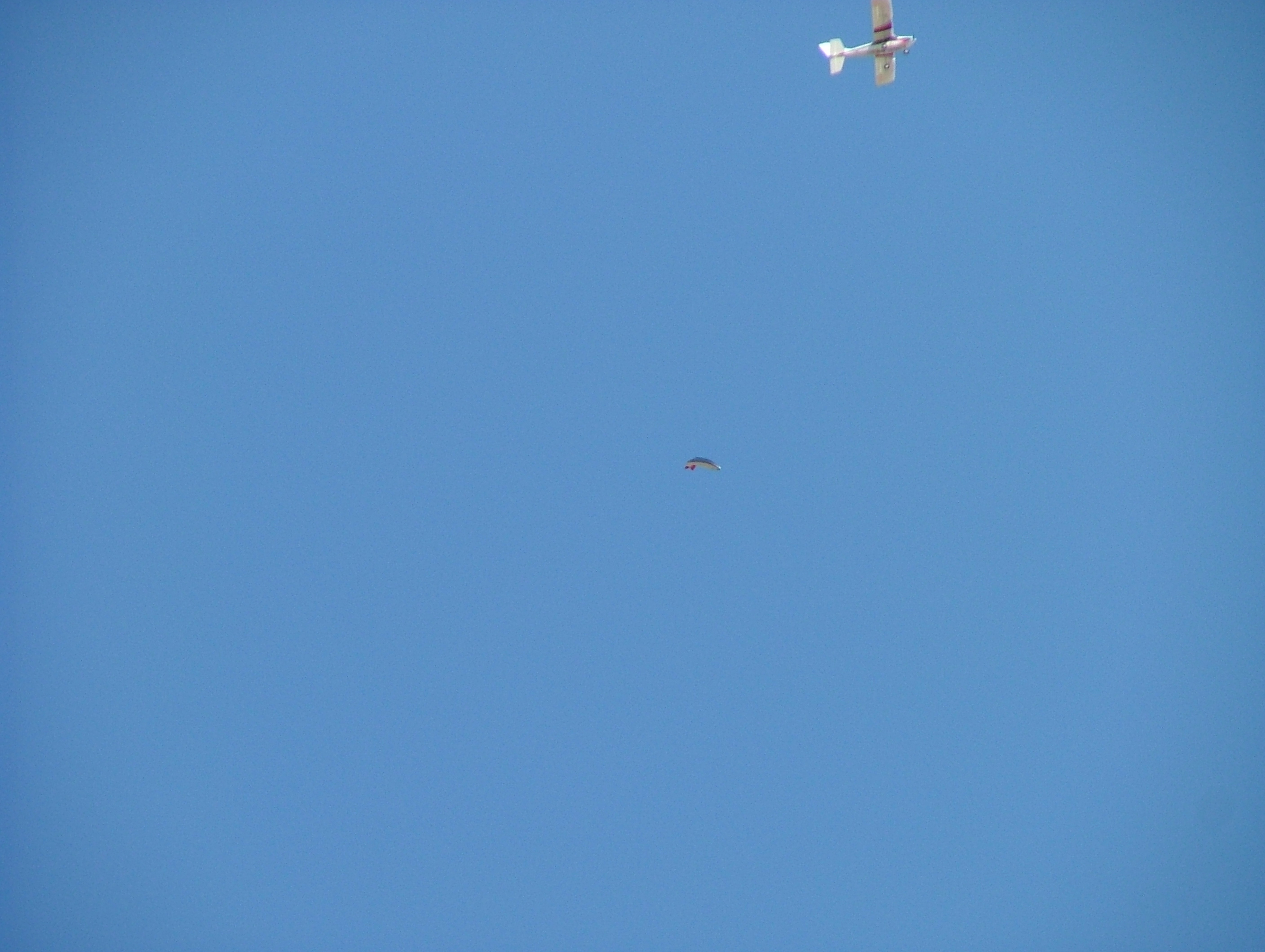

It flies!
Got 10 "flights" in this afternoon!!! My early "falling with style" comment was definitely true.
After the release, the HL-10 would roll several times and quickly assume a nose-down attitude, gaining speed. You can see this tumble in one of the photos.
If you held a good bit of up elevator, it would suddenly pop out of the dive into horizontal flight, and from there you could fly it down as long as you kept the airspeed up. If you stalled it, it would roll.
It took the first 5 flights by David to get the balance and travel sorted out. I flew it 3 times, and Ian flew it once.
These were 5 second flights from about 300', and the first 150' was burned getting airspeed. It was definitely fun, but it'll be a while before I try stuffing an Estes engine in the back!

Yes, I lofted the three view. Unfortunately when I assembled it on my my jig I let the nose fall without realizing it causing my nose to round. It is sort of a HL10 - M2F3 cross because of that error.
I guess really for me it was a proof of concept: the concept being can I loft and build something from a three view drawing.
