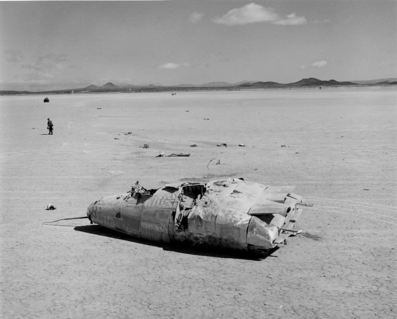

To carry on with our lifting body photos; here is a really cool photo of the M2-F2 crash. It's interesting because this is the only photo I've seen that is in the direction of the crash landing path.

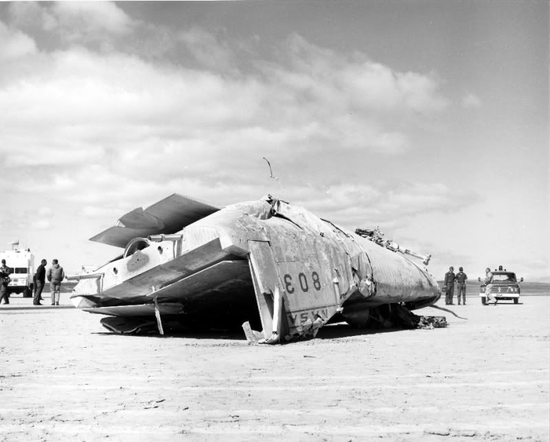

Here is another rarely seen crash photo:

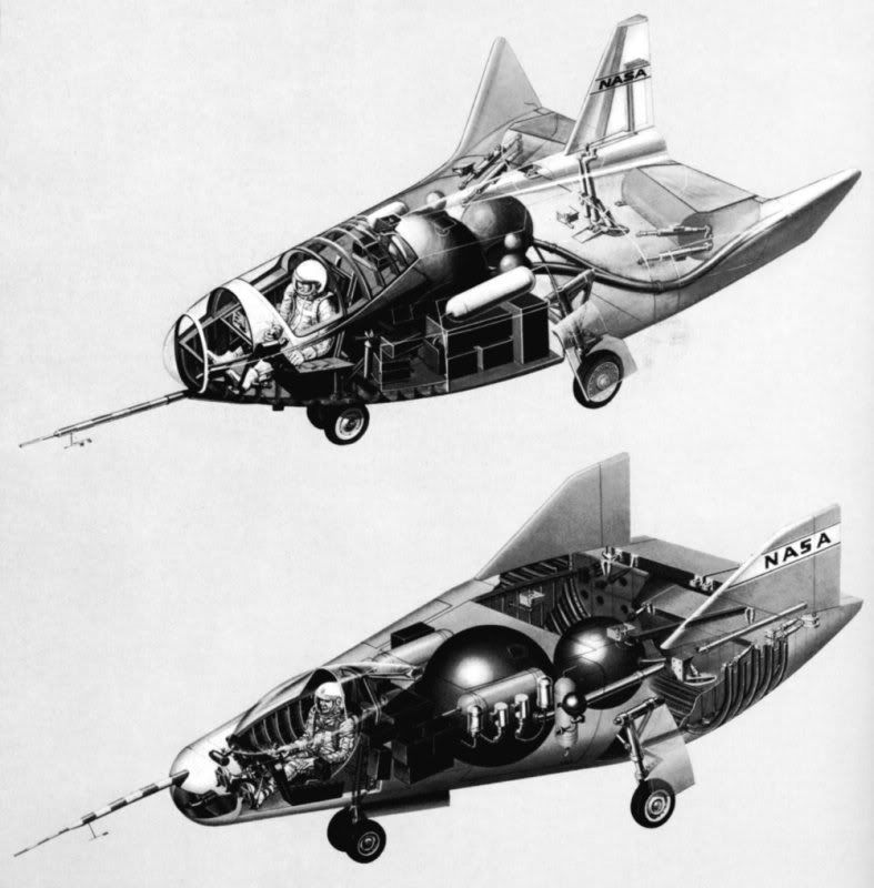

Here is some really cool vintage artwork of both the HL-10 and the M2-F2:

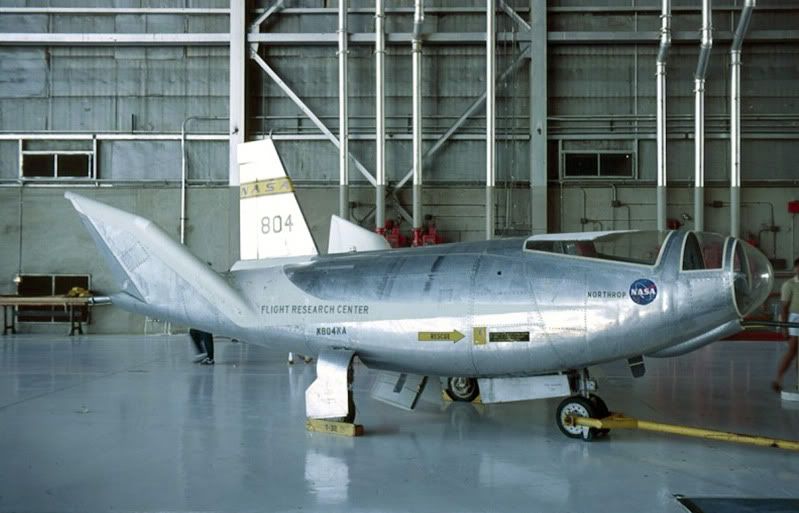

A great rare photo of the HL-10 in the hangar:

This subject is such a great shape; I love it. As you can see this thing will look different from any direction you look at it. A very interesting shape indeed.

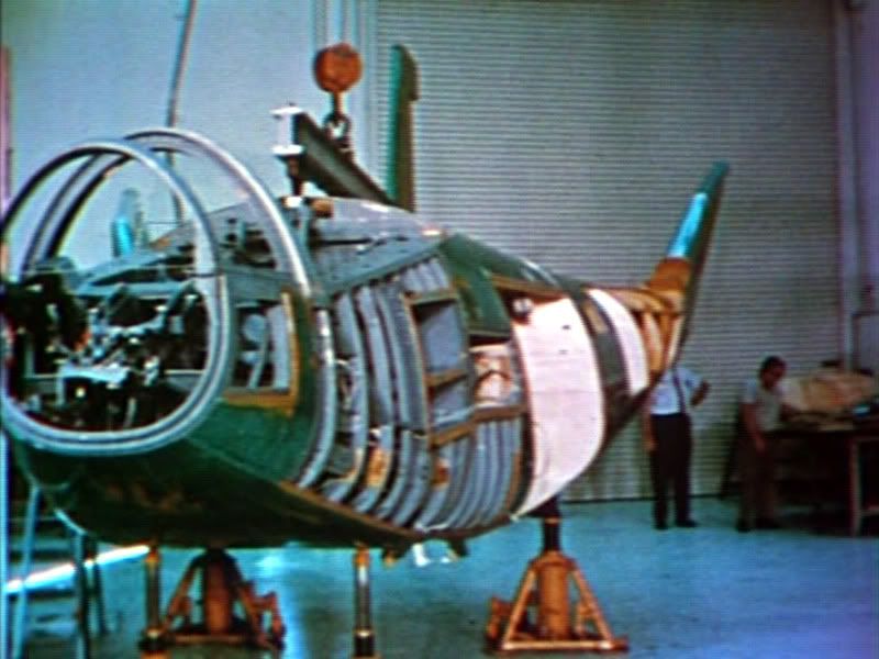

A really rare view of the HL-10 under construction:

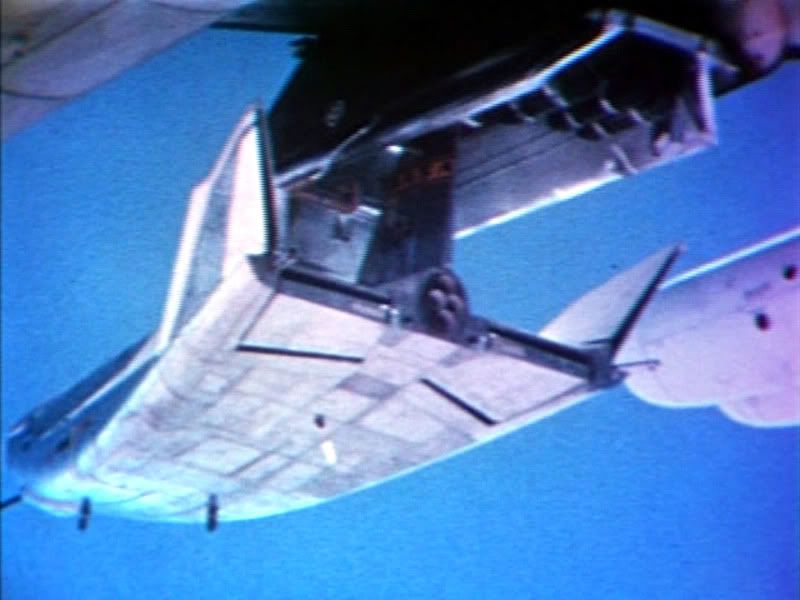

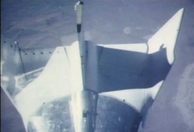

This is great footage from the second drop test (the first after the fibreglass glove was installed). Although similar to the familiar footage in the Six Million Dollar Man; this was an unpowered glide flight. Notice the yarn tufts on the tail and the camera mounted on the vertical stabilizer. The last photo is from footage taken from behind. You can clearly see the tail mounted camera photographing the yarn in order to determine the air-flow.
Yup, first flight with the little leading edge tuft added to the outboard tails (the wind tunnel models don't have that unless they modified and tested after the unexpected results from flight #1). That is also where the HL-10 got its white paintjob around the tails as well.

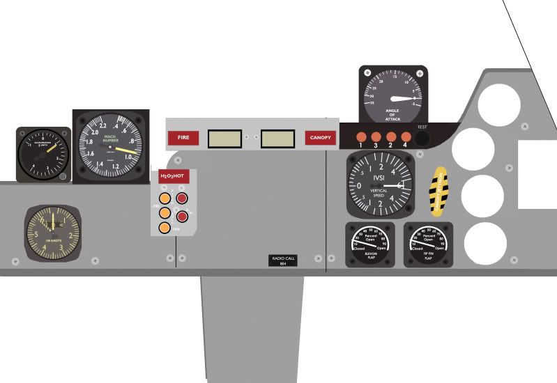

On another note working on the cockpit details for the model. It's coming along very well. I was able to find a ton of photos I took back in 1976 as reference and on most cockpit indicators I can read the dials so it should be pretty accurate. Here is the front panel so far (yes I still have a lot to do).
It's interesting because there really is very little front panel. The gages that you see on top are all just that; stuck on top of the panel. There is no backing whatsoever on them. Even the rocket engine indicator lights were added after the angle of attack gage and covers a portion of it. The cockpit instruments were definitly a work in progress and was continually changed. This version will be the XLR-11 version which included the mach meter and engine indicators. Keep in mind that this thing was really open because the pilot basically had to look over the front panel through the acrylic nose to see to land the thing. Interestingly is that the shape of the front nose created a lensing effect distorting the view such that the pilot was actually lower to the ground then he realized. Kind of scary to hit ground before you are ready!!!!! The lifting bodies gear deployed in about 2 seconds using a pressurized nitrogen system. It's a good thing! lol

Nice work on the instrument panel there.
