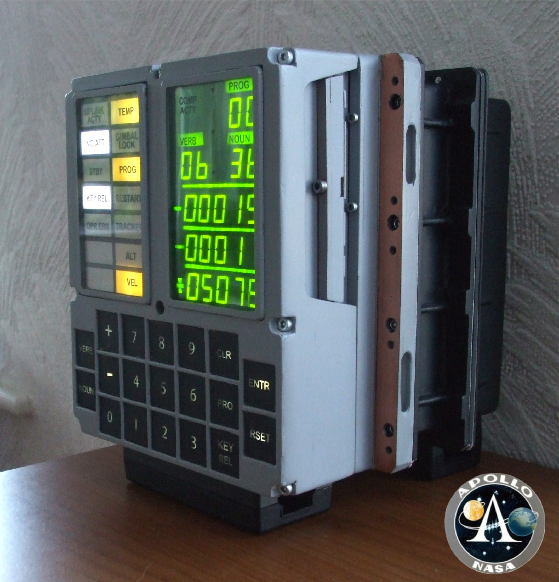

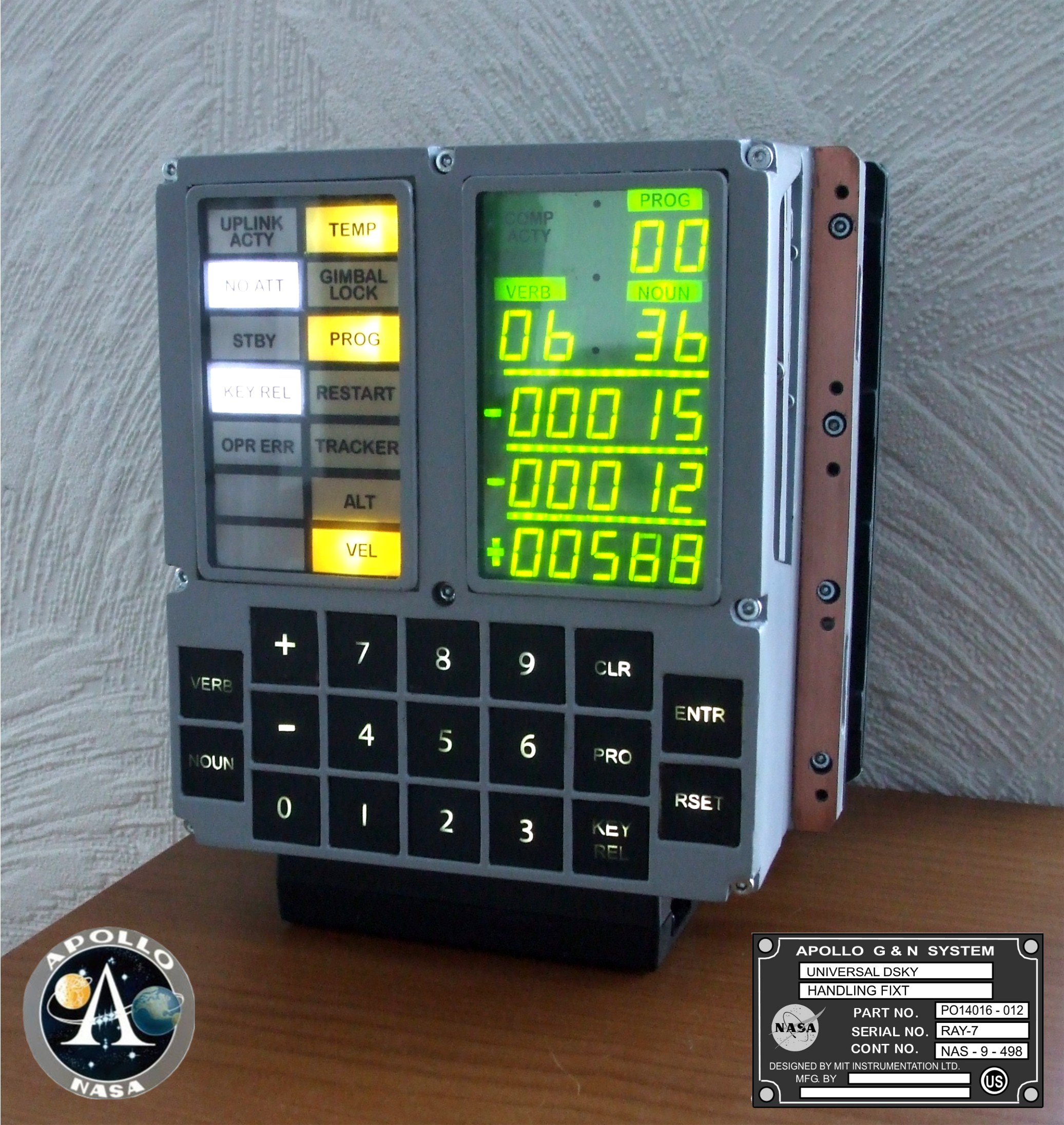

Here is a pic before the main assembly is started. the display is a paper overlay as are the button artwork. The machine shop did a good job on the frame, this is before painting and the main circuit board is installed. The DSKY was about 1 foot deep, this one will be about 1/2 inch so it can be a wall mounted clock. FYI Verb 06 noun 36 is display system time as in the previous post by tonydavid.

That is VERY impressive! I am sure it took quite a few man hours to do. The pictures are good too. Can you put up some pics of the raw display and keyboard assemblies? I am getting ready to wire my lighted keyboard up. My display is mostly wired up too and I finished my micro controller board yesterday. It looks like you used an Arduino. I am going to use a 6811 board that I made a run of 50 of. It will also work as an AGC since I can address 64k easily and do 16 bit math. Since I have an IMU, GPS, clock, and Accelerometer they can be integrated cheaply. I have to turn on the display and keyboard before I commit to the final circuit board design - I am thinking a single circuit board for the whole thing and make it a kit. Your DSKY is inspiring and would love to see and hear more about it!

Rymo the pictures are brilliant, most pictures all show the same thing from the same angle and distance, and you can't really see enough detail to gain much from them so to see close ups from the side etc is excellent, thanks for posting.
