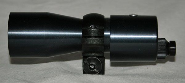

Let's discuss the 6 piece scope
It is made from 4 machined parts, a plastic or glass lens and I used a resin mesh insert for the tip
I am pretty sure my machined parts are still accurate but I need to now the following
1. Is a plastic lens which will cost about $1 ok or do we want to look into glass?
2. Is everyone ok with a resin mesh insert for the scope tip
Depending on cost.. I'd be tempted by a glass lens and a aluminium turned tip.
I'd like to look into glass if it's only a couple dollars difference... as the mesh tip... not sure what the actual prop looked like in that regard, so I'm easy either way.
Glass..... for sure.
Tip, either way for me. Metal would be great to match the finish, but either way honestly
Glass was not an option last time. I couldn't find anyone that could make the size we needed
