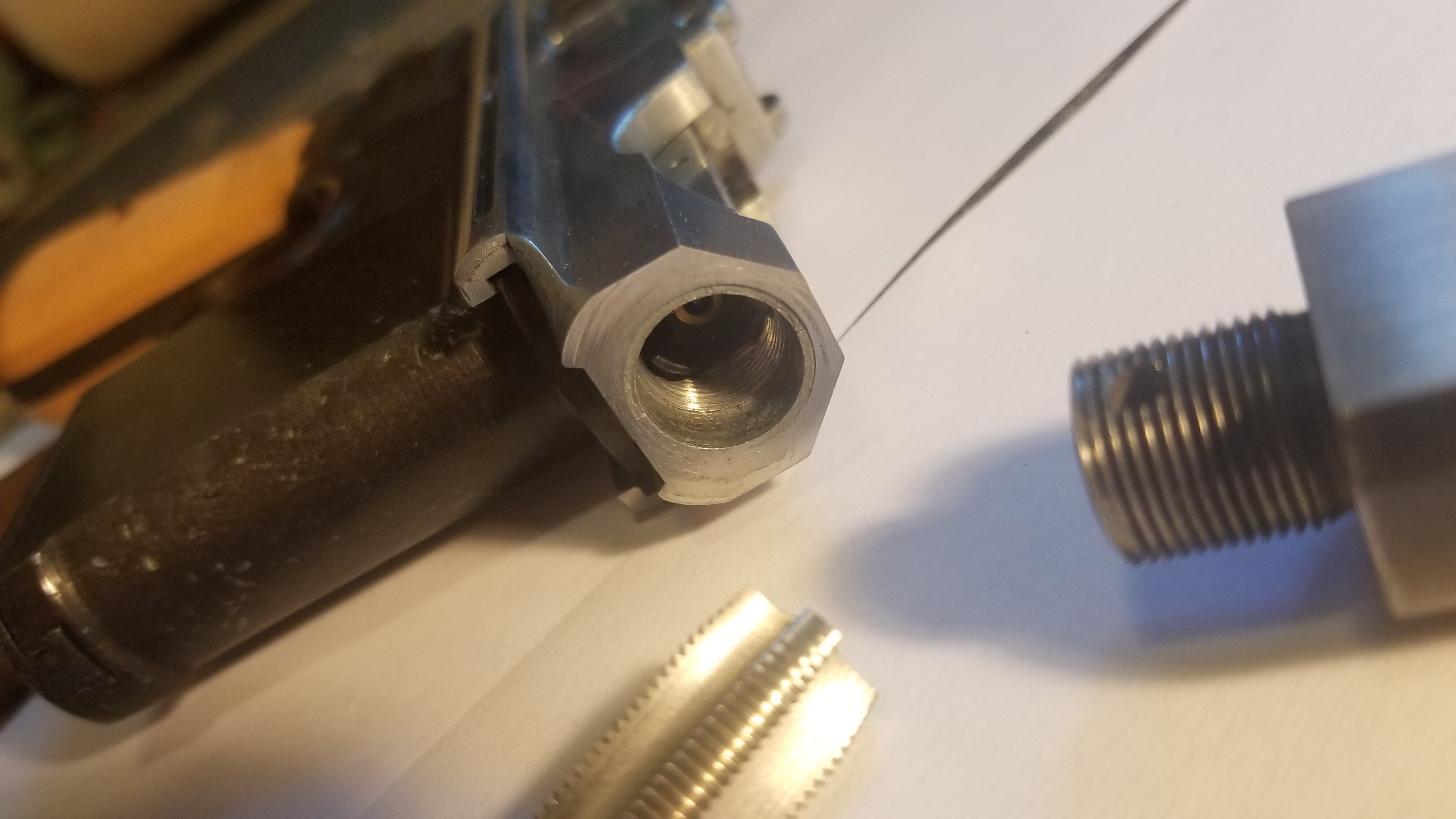

They didn’t add the rifle barrel to a 3 inch chopped Mauser barrel if that’s what you are saying.
They cut the c96 at the point you see the shroud barrel attach.
They drill and tap the receiver and then screw a 3 inch rifle barrel to the receiver.
Revolver barrels are attached to the frame the same way.
Yes, that is what I meant. So in all actuality, Todd's own replica bull barrel is of the same style as the hero prop's! Todd's is just a bit long I think (compensating for the length of the inner booster, which is fine for a replica/ease of install!), but it's otherwise in the correct style. The broken MGC I salvaged used his barrel that I got from someone awesome here, so the original presumably would have been done in a similar manner to this! (if not more professionally haha)
The only thing I am curious about is if it would be more structurally sound on a live/blank fire C96 to make the receiver portion into the male section, and have the bull barrel screw unto a barrel that has been fully threaded up to the contact joint.)
Yes.
When Carson and I designed the DEC kit we offered both the screw in version and a custom barrel shroud figuring it would be easier to fit for most people rather than drilling and tapping the receiver accurately.

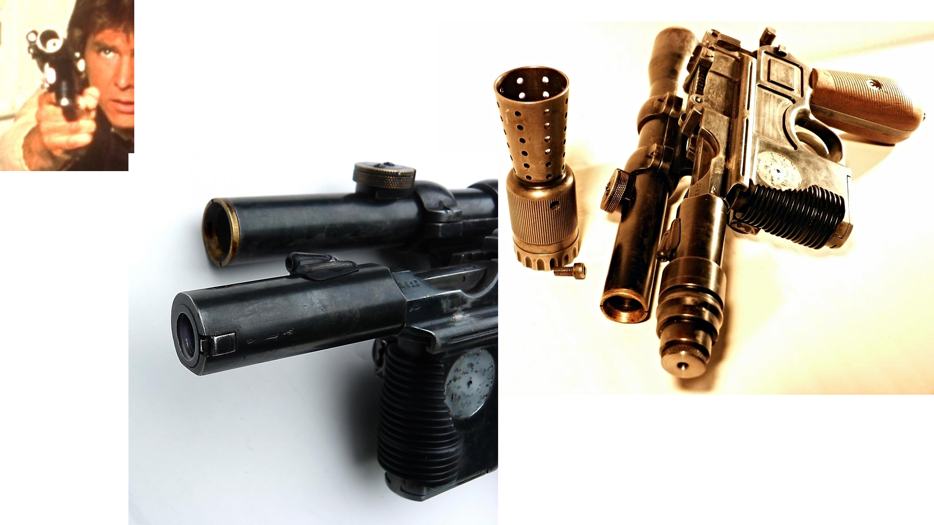

We designed the booster to "center" the FH on the barrel and locate it accurately on the bull barrel.
If you look at the HERO, the FH is always crooked and off centered. Nothing in there to center the FH.
Another reason I don't believe the PS FH is vintage and maybe not the bull barrel. The FH is centered and on straight!

I think Bapty had a booster and stuffed a restrictor in it at least for some part of the pre-production process, and that's where the Merr-Sonn Power 5 came from. The flash hider is riding a lot further out on the barrel. It'd take something about an inch long fitted on the end of the bull barrel, but longer if there weren't a booster. Also, the FH is straight on the Power 5, not crooked like on the DL-44, so something was different with how they mounted it (and a different lower frame, but I'm not talking about that part).
I haven't seen anything to indicate different lengths of bull barrel between uppers, but maybe y'all've seen something I haven't in that respect.

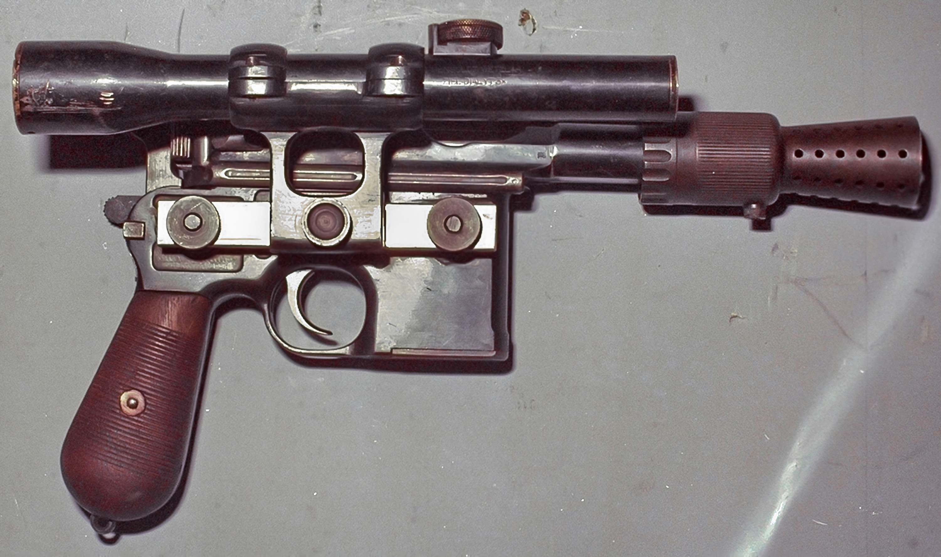

Yes, that's what I had remembered! I just have the feeling that the constrictor may have threaded into the bull barrel for the most security possible, as the threaded bolt in the flash hider wouldn't be a very secure way to keep the whole thing together.
And your pictures are always a treat! One I finish my current ANH blaster I'd love to try again on a second kit from Field Marshall, but this time go into all the little details and get it close to prop accurate... Namely a PROPERLY functional bull barrel and Carson's lump ;)

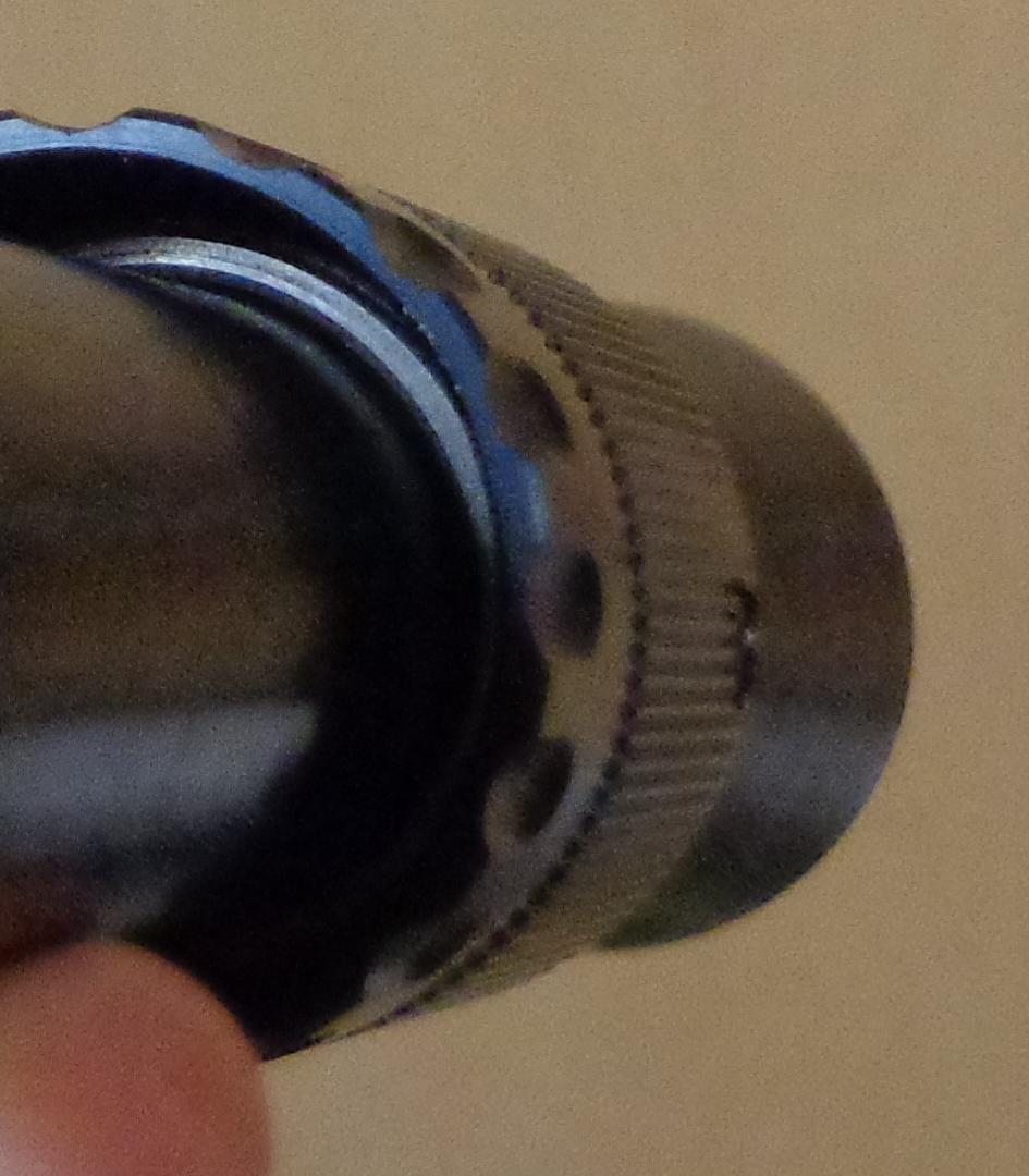

The only thread in the FH is at the rear and you can see in the PRE images it doesn't screw to anything.
The constrictor could have screwed in the barrel end like mine which makes sense if they used a NR type barrel. If not they could have tapped the outside or welded it on.
Welding would be safest since you don't want anything flying off the gun from blanks which can kill...
Yes, I meant the threaded bolt holding the flash hider to whatever constrictor they used - my words just got a bit crossed there.
And it was likely not welded since it seems to have vanished during filming, hence why the flash hider is so crooked by post production... I'm just trying to assuage how the whole thing went together in my mind is all. And from what I know, all the bull barreled C96s were created in much the same way. The same upper as Han's hero prop was threaded to accept a rifle barrel, which means a constrictor could have been made to thread into it easily enough. So they are all (seemingly) had a "NR type barrel".

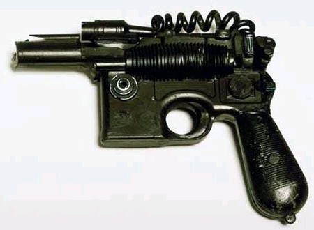

I had forgotten that the Imperial version of the blaster was cast in two parts -- body/barrel, and flash hider. I feel like they filled most of the flash hider with clay or some such, leaving a bit of the rear rim for the illusion of depth, and then moulded it that way. The upper seems to be the NR upper and the lower is the one from the Sweeney, with the scope mount lugs welded to the left side of the frame and cast with it (then cut off after casting).
The "Model 44" version seems to have been made by the simple expedient of just snapping the flash hider off, and, in some places, the resin gave before the glue did.

These are the same castings. I believe them to have been molded from the HERO before they brazed the right side scope mounts on.
Do we know for sure the MerrSonn's were molded without the FH?
What proof do we have? Are we sure the one without the FH didn't just break off at that point? It "appears" slightly longer to the break point but could be from a slight undercut. Rubber molds can pull slight undercuts.
Here the rear safety area has an undercut and the FH also seems to have a slight one too.
This was a different mold made after ANH.

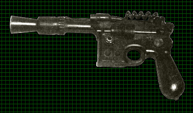

Those blasters have a fake skinny barrel tip in the flash hider too! That always threw me, I knew of the choke at the base of the ANH cone.
MerrSonn's were never my study but I think maybe the FH was glued on and filled. Looks that way from other images.
