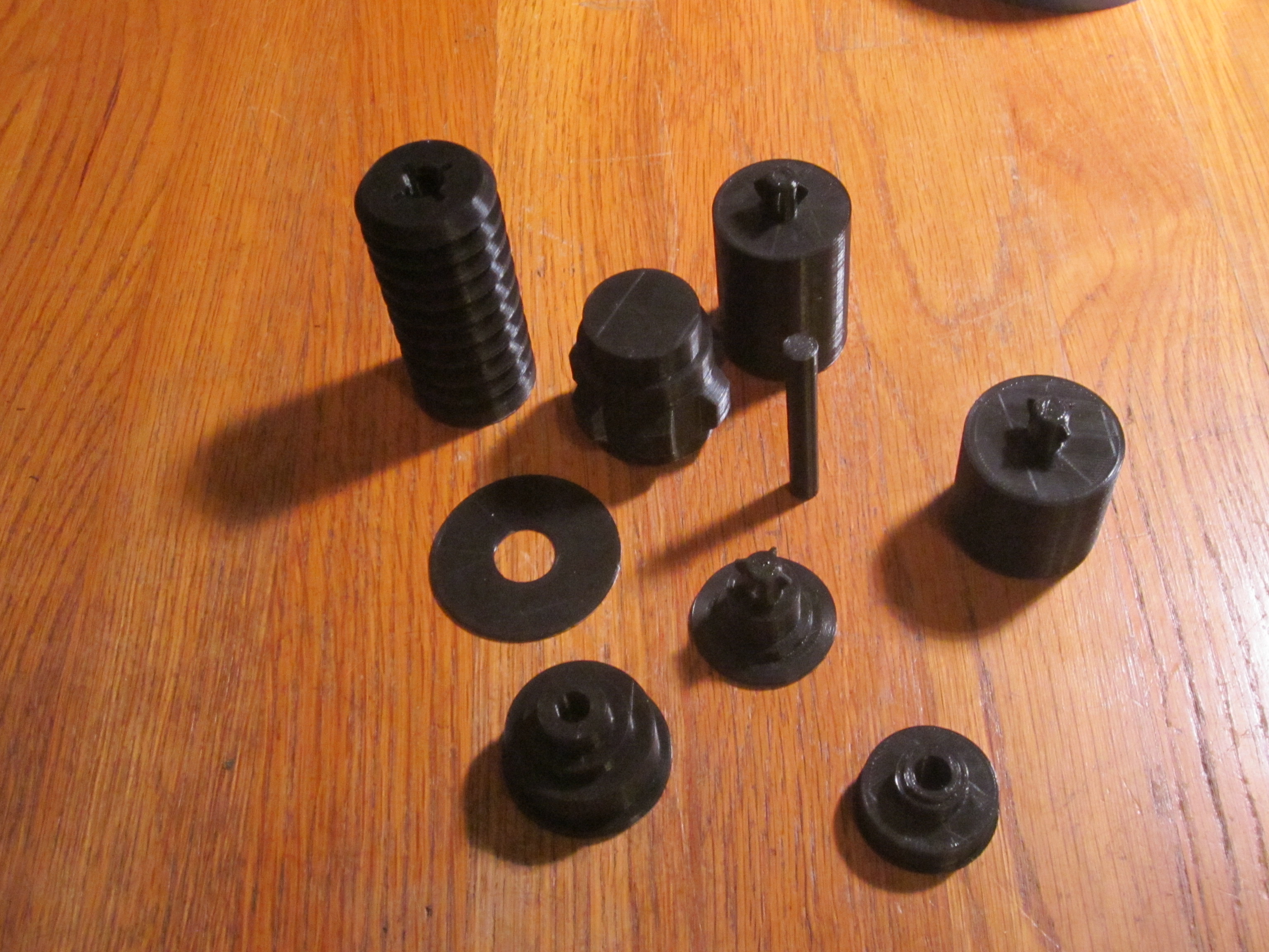

All of my parts are printed and ready to assemble! Hopefully I can get the printing video edited and uploaded this week. These parts were printed with the specs outlined above, and they turned out well.

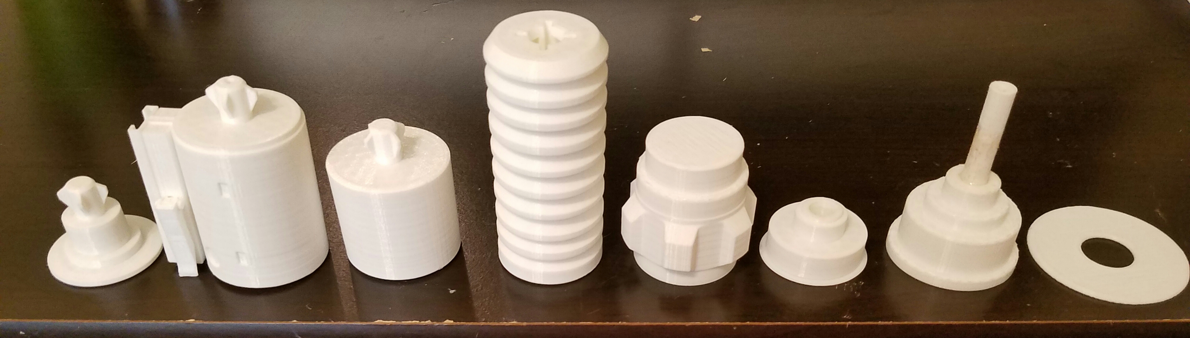

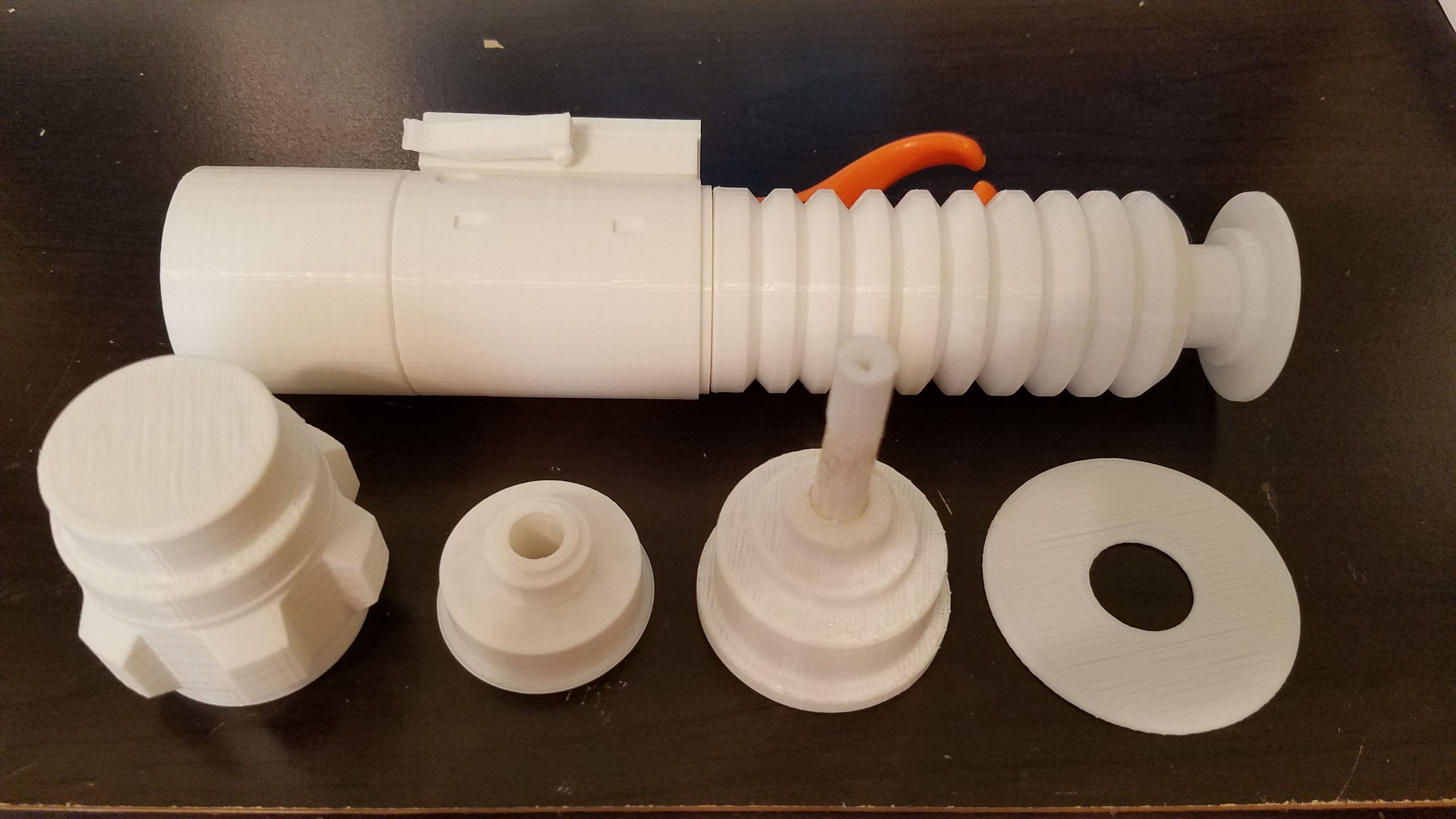

Here is my print.
Flash Forge Finder - PLA @ .15 mm
Raft: Yes
Support: Some parts
Had to reprint clamp pin in a horizontal position. Vertical print broke, was to brittle.
Had to reprint rod a little thinner, 97% but kept same length. Still fitting tightly, but nothing sanding didn't fix. It looks dirty because it got stuck with emitter top and had to pull of with pliers. Broke it too when I forced it out :facepalm . Had to glue it, since it's not visible, that won't be a problem.
Oh, and the pommel, doesn't fit into bottom section for me. This one will need heavy sanding around the fitting to properly fit. I should've printed a tad thinner to avoid the extra work :lol. But again, nothing sanding won't fix.
I recommend printing the clamp lever with the angled section flat to the bed, and adding supports for the rest of it. I printed it vertically, with the angled section towards the top, bit it came out to thin. Any slight rough touch towards the tip and it will break.
Overall, it's a beautiful design. Love the locking mechanism designed into it. It works perfectly. I wish more sabers are designed like this. I cannot thank you enough MCM for this file. I love it!!!

Those parts turned out beautifully! It's such a rush to see something that I designed on my computer made physical without the 2 of us ever having met. I'm glad that overall the experience has been positive. I, too, noticed that the rod was a little snug in my emitter but fit through the windvane parts well enough. I actually ended up using a rubber mallet to get the rod the right depth into the emitter. I was planning on sanding the rod before hand, but my eagerness got the better of me so the rod and emitter are more-or-less one piece. Interestingly enough, at one point one my drafts had the rod and emitter as one piece but the rod kept snapping off. Having the rod embedded in the emitter makes it much more secure.
I'm fine with the pressure fit of the rod, but if the demand is there, I can alter the STL files to make the interior of the emitter ever-so-slightly larger to better accommodate the rod.
That's interesting about the clamp lever, but every printer has its own idiosyncrasies. I just printed my second set of clamp greeblies (lever, pin, card) and had them all oriented vertically no problem. But this is exactly the kind of info you should be sharing! Do you know how big your nozzel is? How thick do you have the outside walls and what are your infill settings?
As far as the pommel not fitting, did you clear out all of the support material in the booster? At first, my pommel refused to go in, but then I noticed a little "lip" leftover from the support material. I was able to chisel off the lip with a flat-head eyeglass screw driver (the absolute best tool for removing support material imho) and the pommel fit perfectly. If that isn't the problem, wrapping some sandpaper around the top cylinder of the pommel and giving it a few twists ought to make things right.

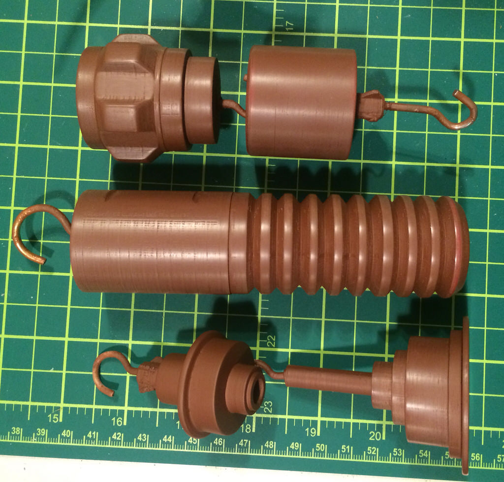

I had to set this project aside during a recent spell of rainy weather, but I'm back on it. Here's how it looked a month ago before a final round of filler primer and sanding:
And painted gloss black in preparation for a silver topcoat:
I started painting the silver last night but unfortunately waited until too late in the day, and the dropping temperature/rising humidity made the paint go on weird and haze up. So I will probably wet sand that and try it again when I get a day with warmer/dryer weather... doh.
Also, I doubled the thickness of my emitter "washer" as I felt the original model was too thin, and wanted to get the thickness closer to the V2, but doubling it was just too much. I might re-print it with the thickness increased by just 50%. I was unable to find any fender washers in the right size - not sure they exist in big box hardware stores at least (there are some close).
