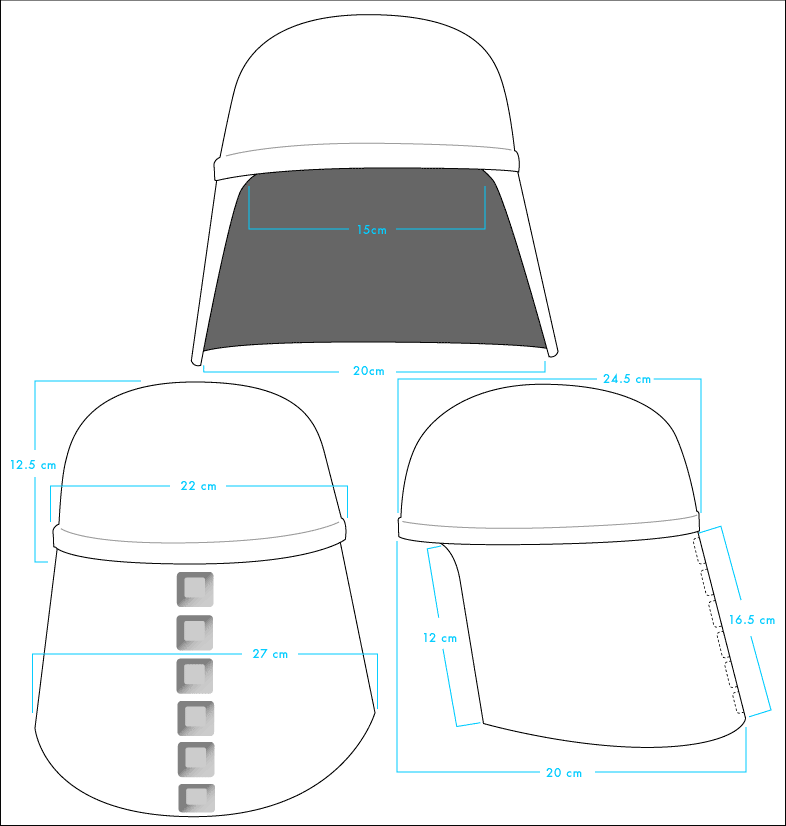

Also looks easy enough to scratch build. My plan is to use vacuformed party hats and 1/2mm styrene sheets to reach the 1 1/2 mm thickness. I'm not completely sold on the party hats as of yet. I'm also looking at plastic army helmets.
These are the dimensions of the finished cuts

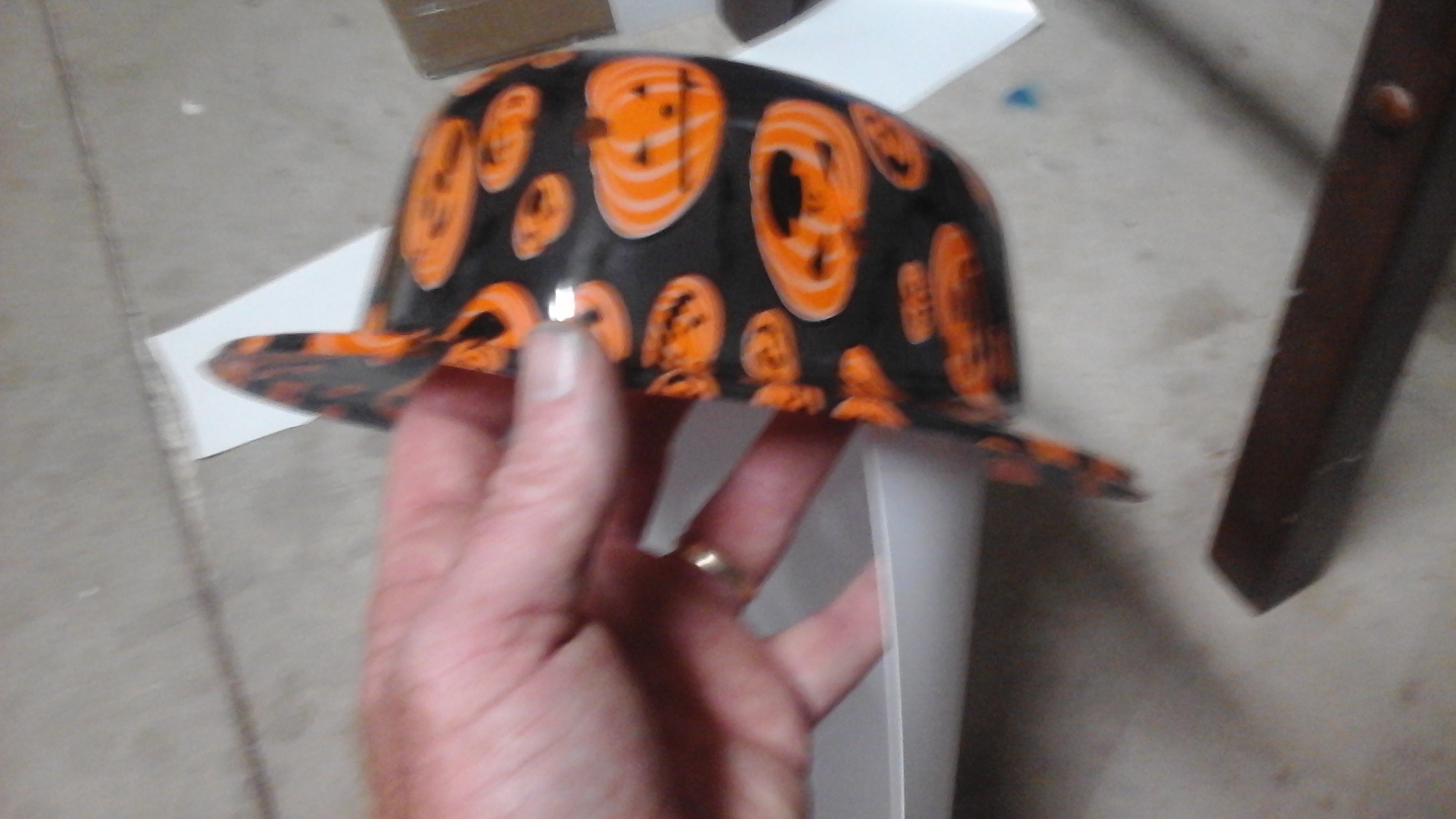

This is a very quick and crude moc up for my planned design. The idea was to use thinner hats and sheets to build up to desired thickness. I used an already cut sheet to use as an example.
You know you like my pumpkin hat, so don't hide it:lol

As far as the measurements above, those derive from studio creations website. Additionally I don't think you're going to get much confirmaton from whitearmor.net because that's the stormtrooper detachment, and they're more than likely going to refer you to the Blizzard Force. I have other reference sources to determine a close scale reference but even then those iirc are what the studuo creations measurements are based off of.
There's not been any definitive set of measurements for the helmets yet. Unlike stormtrooper armor and a few other armor variants that have had been thrown into the public from production for replication, the snowtrooper has not. There are a few private collectors who own a couple helmets and one I know of that owns either the original sculpt OR casting from the first snowtrooper helmet w/ the first version of the commander''s face- cowl. These collectors however refrain from disclosing details I feel pertinent to my research.
So the only next best thing that will be coming out is the Anovos snowtrooper helmet, whenever they get around to it. They switched back to using their 3d scan data of the exhibition suit, so in terms of accuracy it would be the closest thing we get to "production cast" for the immediate future. My biggest issue however is that exhibition suit's helmet has been significantly warped from age and mishandling, so it's not a true representation of how it looked during filming.
But again, there's no definitive set of measurements. The studio creations references you found are based off of an individual using iirc 2 laser pointers set at 1" apart, pointing it at parts of the armor and taking photos. It's not a bad idea, rather I'd take it as a loose form of reference.

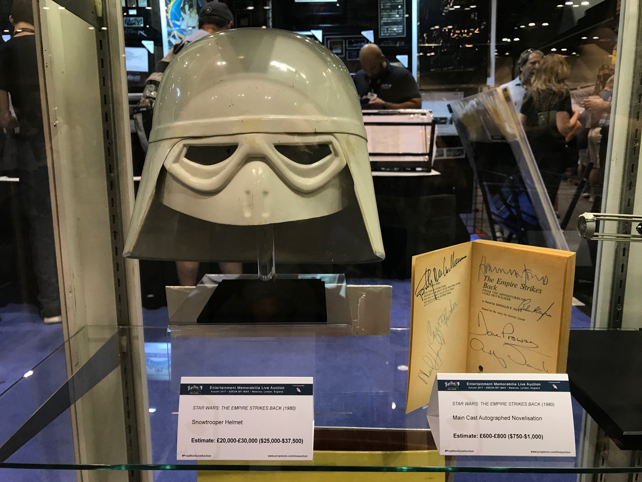

I do have more pics from different angles of that particular helmet from Celebration when I was there. My only regret was not getting a side-by side with my personal snowtrooper helmet. My armor kit is from Dan Laws. I own his version from 2009 and currently own his newest version of his helmet. I can say that roughly the helmet on display here, which would mean the other production helmets as well, are approximately close in scale to Law's newer helmet, but perhaps that Law's helmet is slightly larger than the production helmet. But like I said earlier, the Anovos one "should" be identical in terms of size when it does come out.
One other tid-bit- the helmet dome is NOT symmetrical; it has a front and a back. Some film used helmets are oriented differently. This one in particular, the front of the dome is "flat" compared to the rear, i.e., the front slope of the dome is much steeper compared to the back of the helmet.
To note, this helmet at celebration is strictly "production made," not used for filming. It's missing the cowl, obviously and the helmet-rivet cap at the top-center. They advised me that this was in possession of a prop-builder for the film. The backpack that was there had the grey panel on the bottom (cleanly) cut and made removable, so that the owner's son at the time could use it to store his toys.
I'd also suggest googling the snowtrooper helmet that was auctioned back in 2012. It's screen used and complete, great reference available. This helmet at Celebration, at least to my knowledge, is the first "unfinished" snowtrooper helmet to surface publicly.
