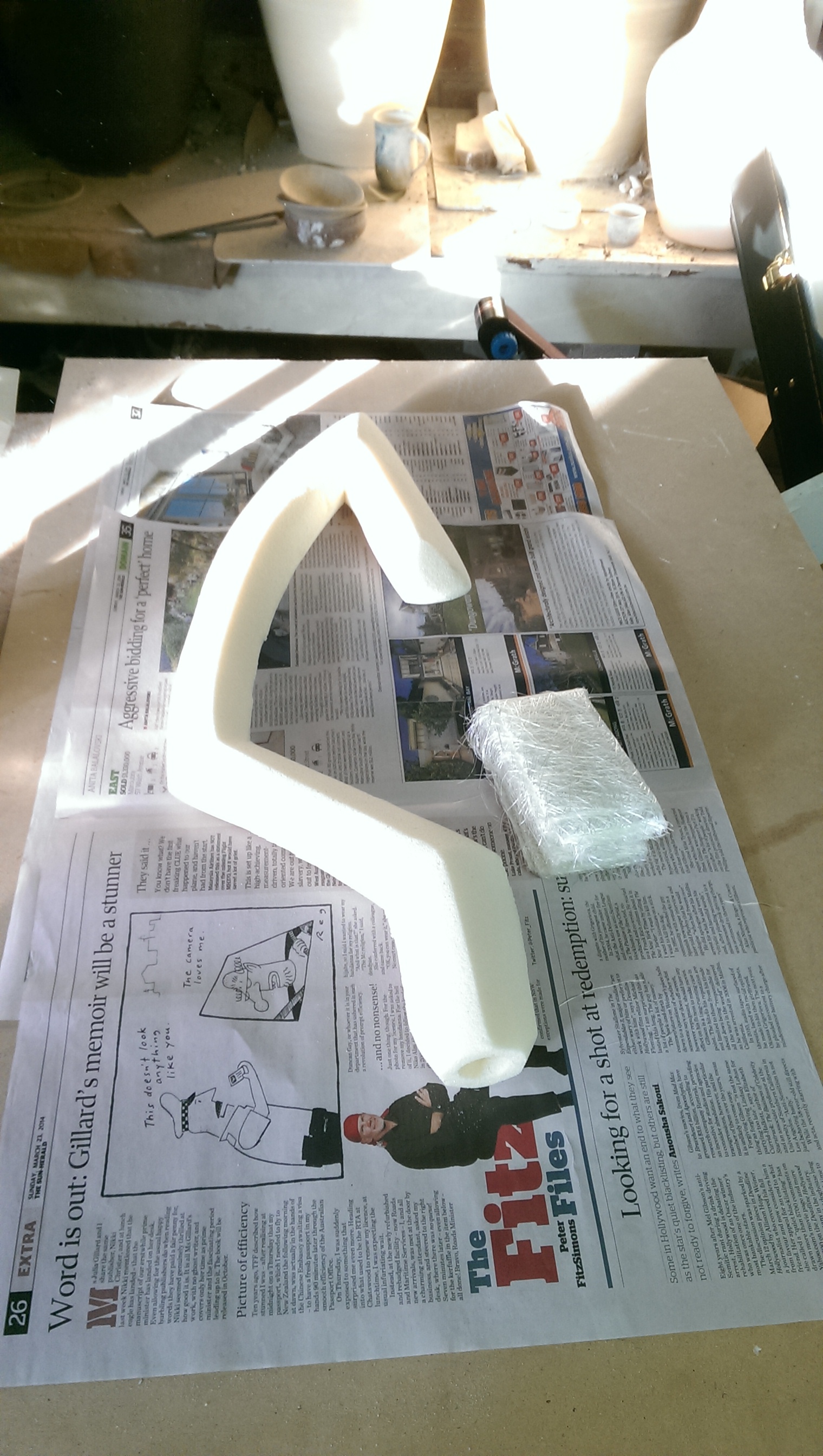

Following some rough proportion sketching on paper, a form was worked out of a urethane tooling foam for the head of the cane, to be honest the first form didn’t turn out correcty, being a little small and not having the right ‘feel’.
![IMAG0002.jpg IMAG0002.jpg](https://therpf-f28a.kxcdn.com/forums/data/attachments/143/143484-b31dca78c0113d8e7ec1e14b1a7a497c.jpg)
(this is the second attempt, which was used int the build)
I really like working with urethane foam, over either epl or xpl polystyrenes as it is easy to shape with a hacksaw blade, followed by a sanding block, not ‘clumping’ like either polystyrene type. In addition, urethane foam does not react to solvent based paints ( at least not in my experience) which is useful if any areas miss a coating, or do not need anything covering them. The one major disadvantage of urethane foam is that it is not as stiff as xpl, and absolutely needs a supporting covering. Rondo is okay in small areas with little or no loading, but for semi-functional geometry like the cane head a fibreglass layer is necessary.
