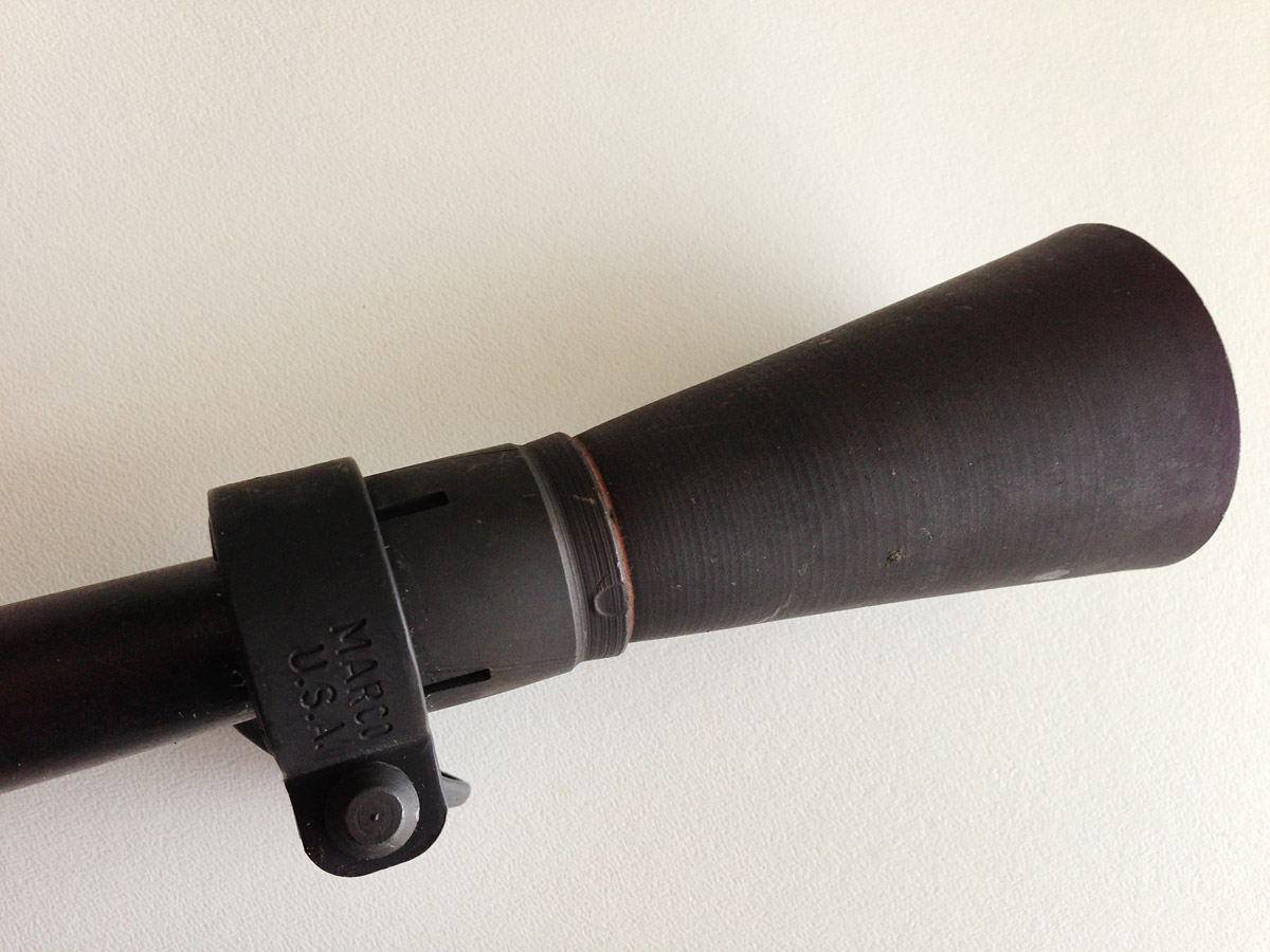

Hey Aaron, Do you think the Flash hider is even possible???
I think that obtaining a real flash hider is a viable option for most people, you can buy them online at most gun auction sites, I even got mine off ebay. As for the flash hider adaptor, one clever solution is to make them like Michael did on his here: http://www.therpf.com/f79/han-solo-anh-greedo-killer-blaster-buildup-104079/ By cutting the four slots into it, you can use the original fastening mechanism to make it interchangeable between different bases. The replica scope I would imagine would be like DEC's Hensoldt scopes from run 1 and 2; see through, with glass lenses in both ends, but with no actual adjustment mechanism on any kind of sight enhancement magnification, like in a real scope. The only part that I would like anodized/painted/colored in any way would be the grill. The rest of the parts are painted anyways, excluding the flash hider, so I imagine that we could manage that by ourselves. The weaver rings I could manage myself too.
