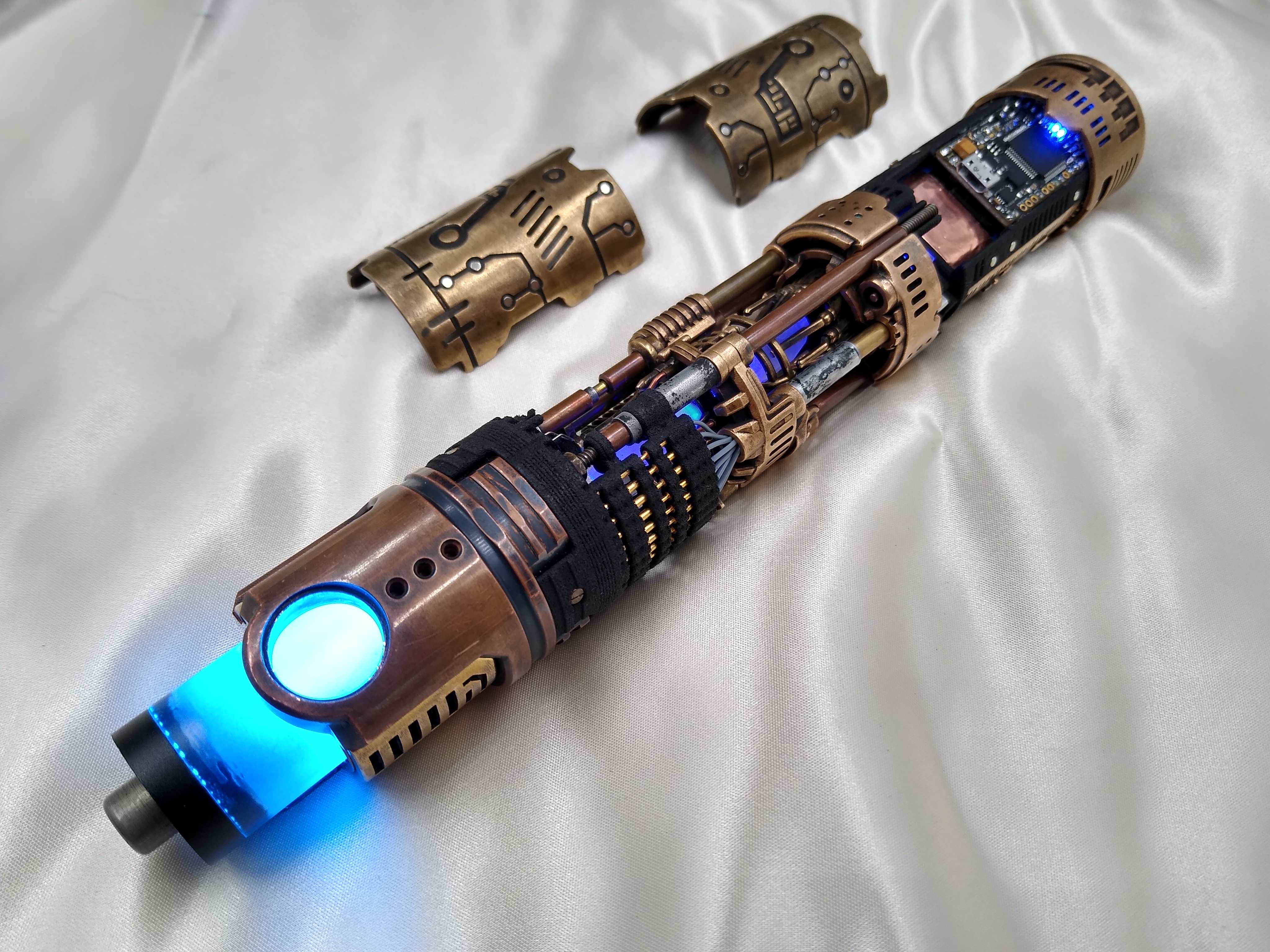

The Graflex 2.5 has an inner core (i'll post a picture of it) that functions as part of the bladeholder and the threading for the bottom to screw onto. Whereas a replica like Roman's ones, replicates the vintage locking system without the screws and uses standard bladeholders. This causes the chassis you've seen in the 2.5 to have a design that only fits that internal shape.
The way bladeholders are designed for replicas like Roman's Graflex, don't use that internal section, so a chassis is attached directly to the bottom of the holder itself. You'd need a chassis like this Graflex Knight Chassis - Crystal by Rick_D_Ryo on Shapeways

The twist j- lock style of the Roman props Graflex, replicates a vintage and is unchanged when the relevant chassis is installed into it.
The chassis in the link I posted are desinged to be directly mounted to the bottom of a bladeholder.
In the image in this post, the blade plug is still seated in the bottom half of a bladeholder, and the chassis is then attached to that part
