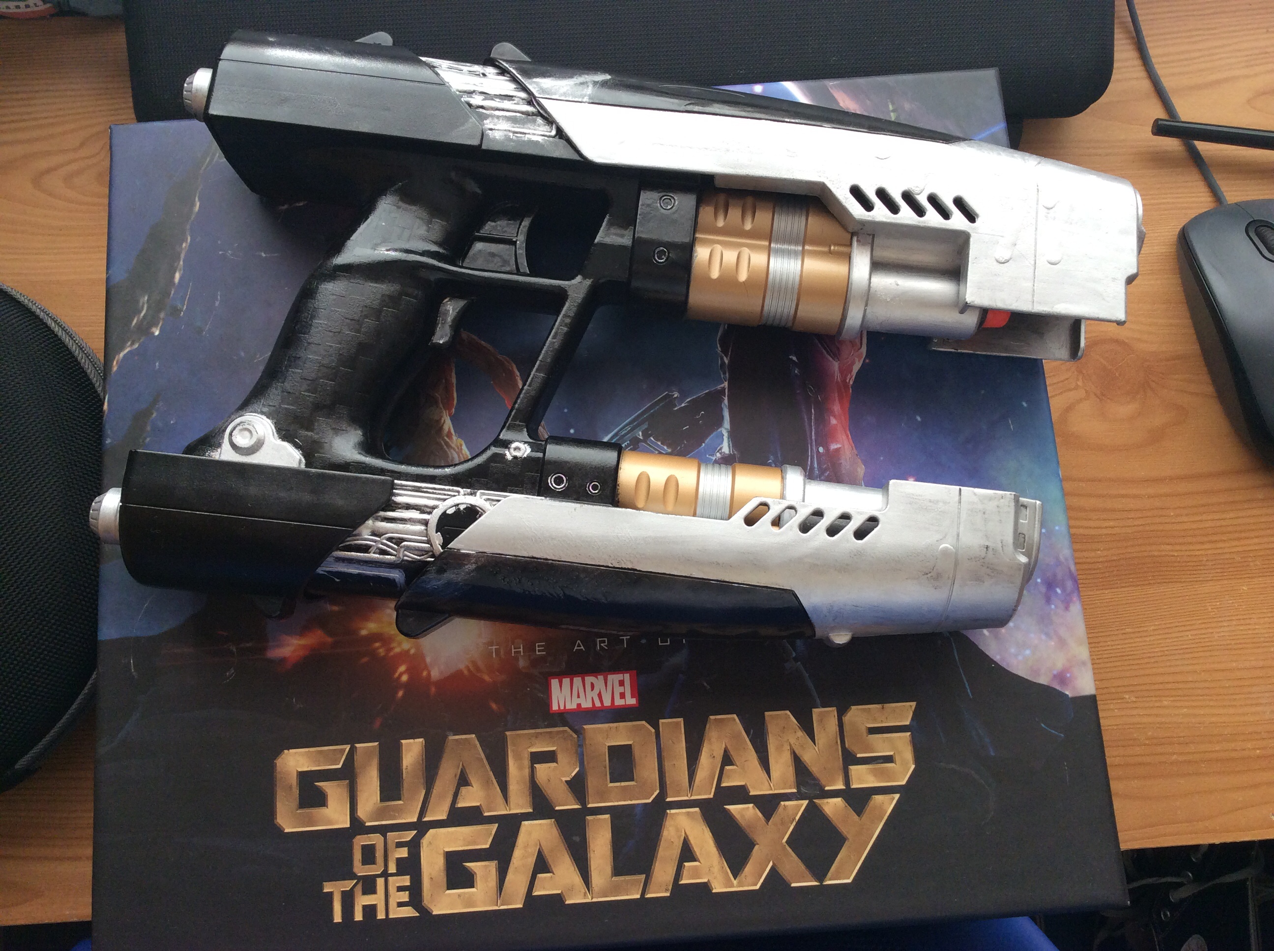

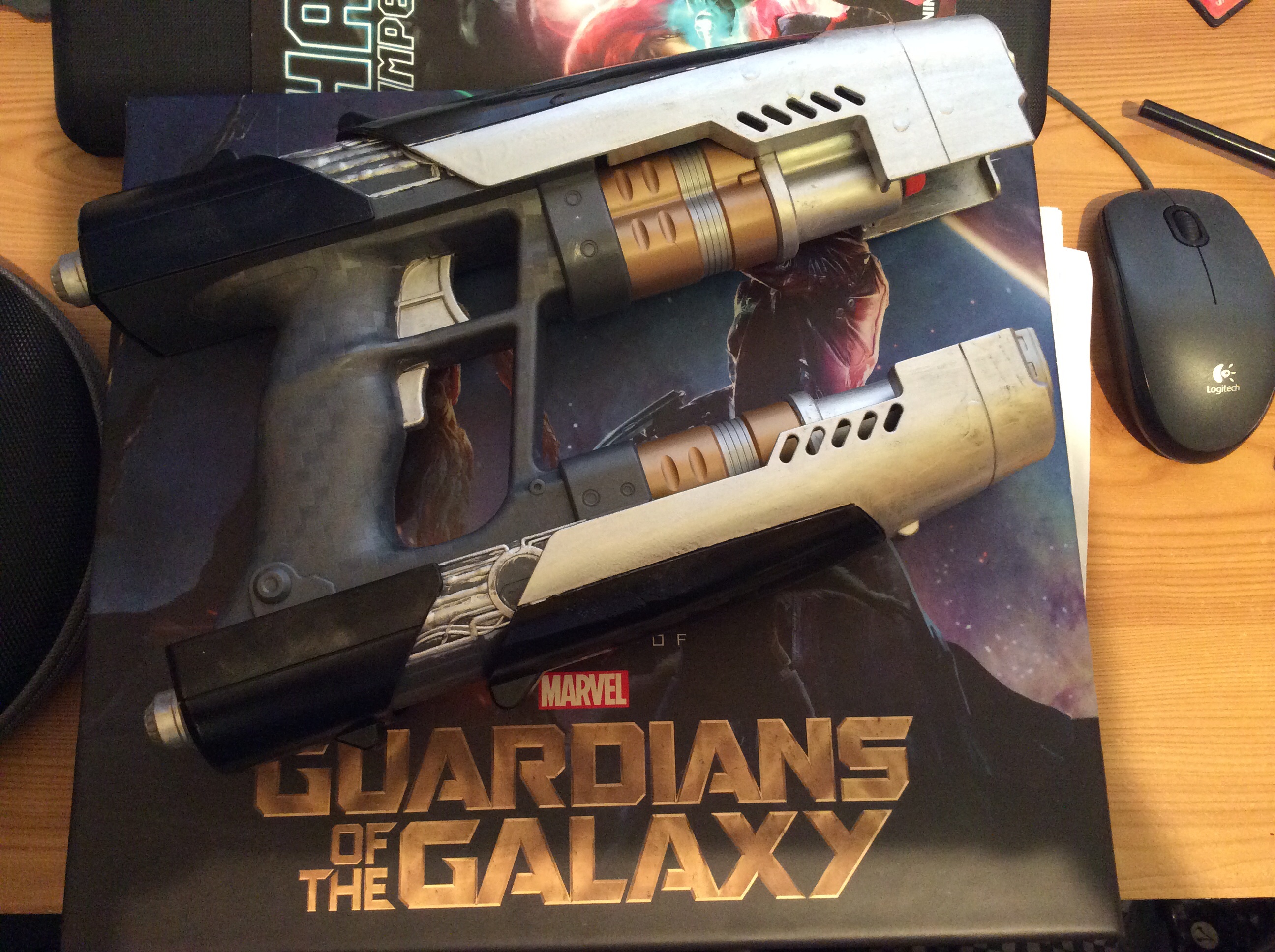

Hey guys. I've been following this thread for a while and after the gun arrived in the post (finally!) I started painting. This is the first toy/gun/prop I have ever painted (as you can probably tell from my amazing painting skils) but I'm quite glad with how it came out! What do you guys think?
EDIT: Made some changes this afternoon. Spray-painted the handle, trigger, top and bottom barrels black. Now I'm really happy with it!

Re: GOTG: My own Star-Lord Build
johncott That looks amazing!

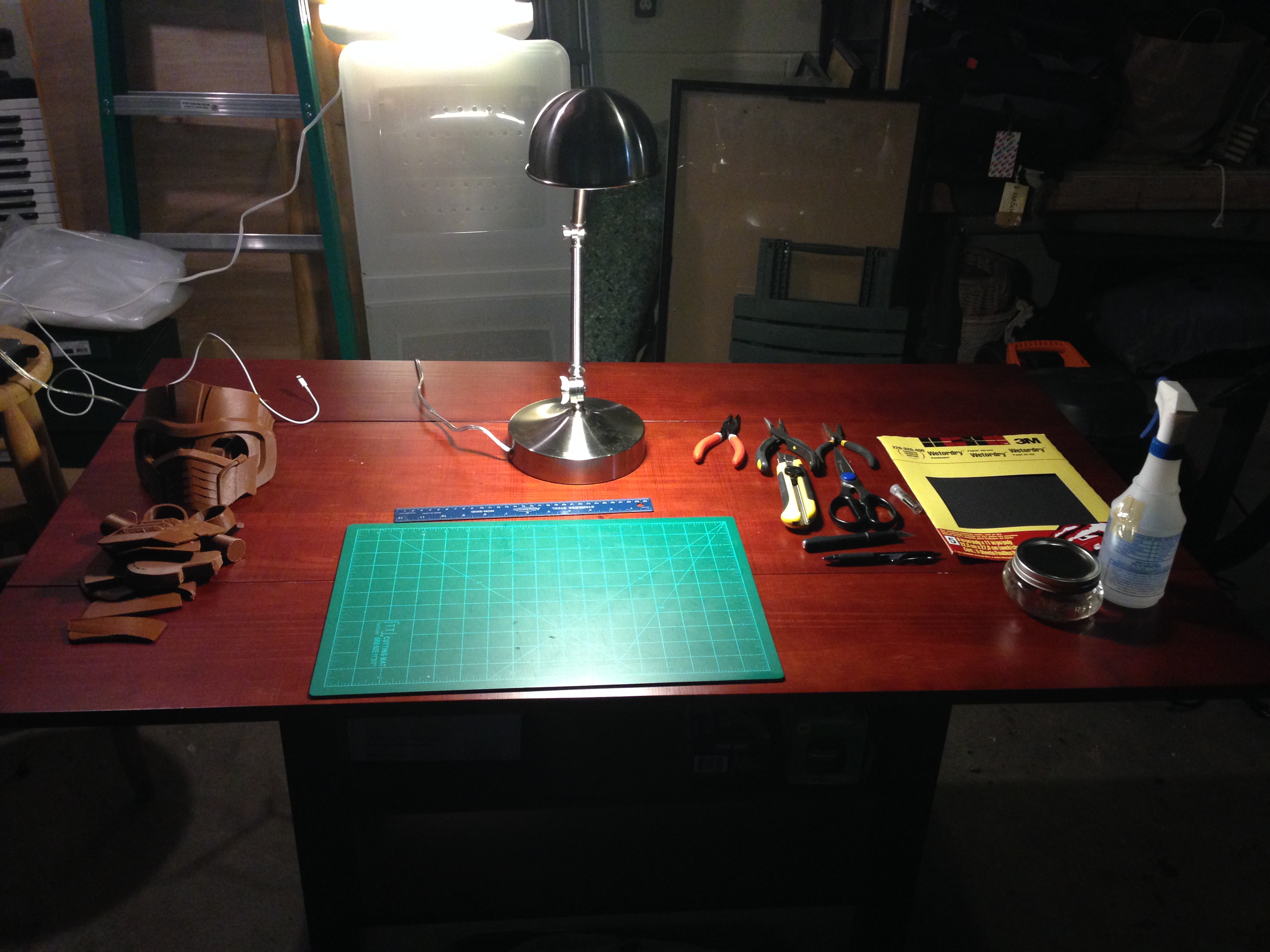

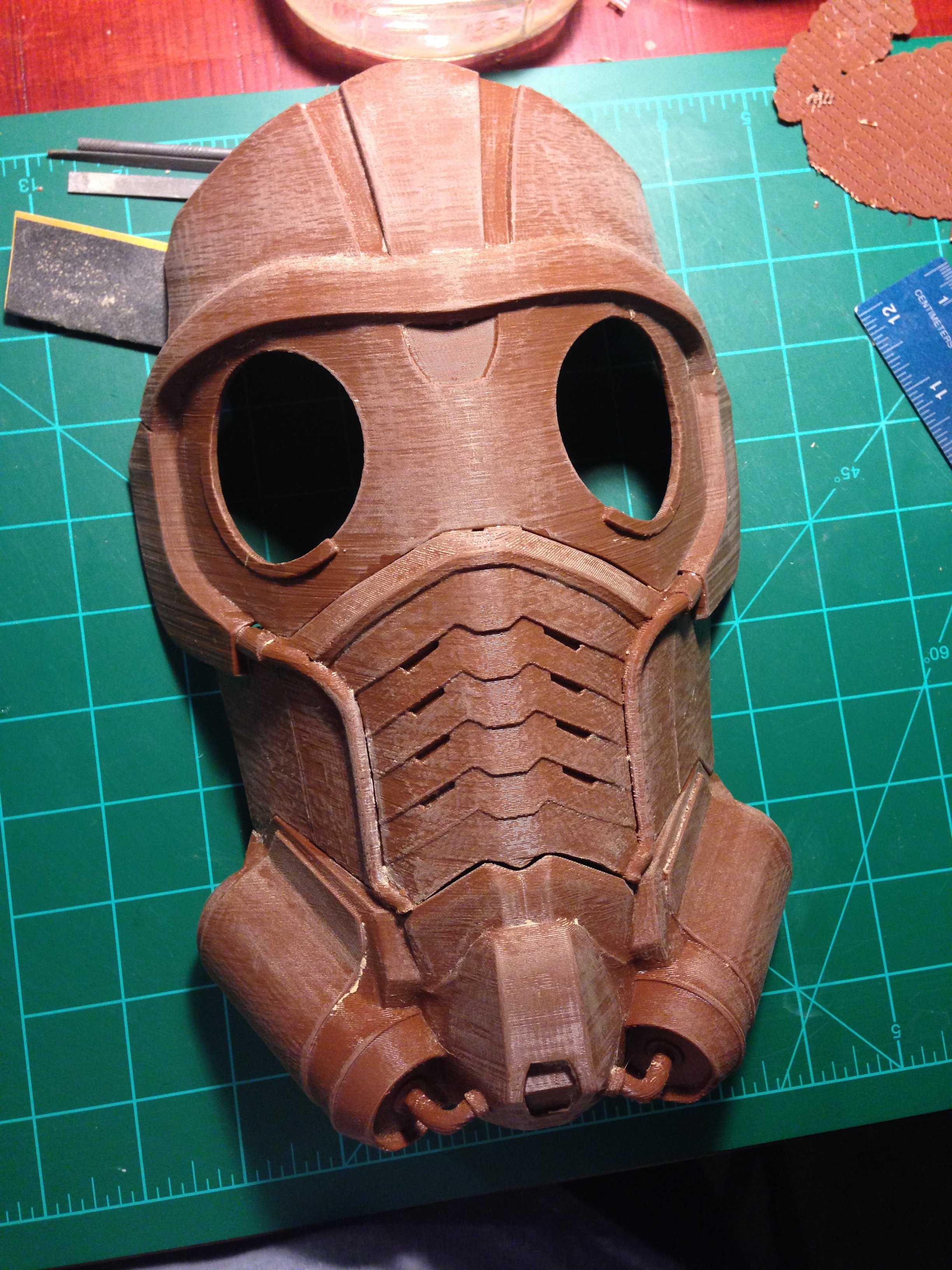

Speaking of 3D prints, I spent all day yesterday on my Star Lord mask and made some good progress. DragonCon starts this friday, so i'm officially on a clock to get it assembled and painted by the end of this week. Yesterday i spent my day sanding parts and assembling them.
Here's the workspace i set up in my garage with what i needed: knifes, acetone, masking tape, wet-sandpaper, jars for water and acetone, 3d parts, and extra 3d printed plastic scraps.
Here's the front of the mask assembled. I wet-sanded everything lightly to smooth some of the build lines out, i will be spraying with filler-primer to get the surfaces even smoother before i spray paint.

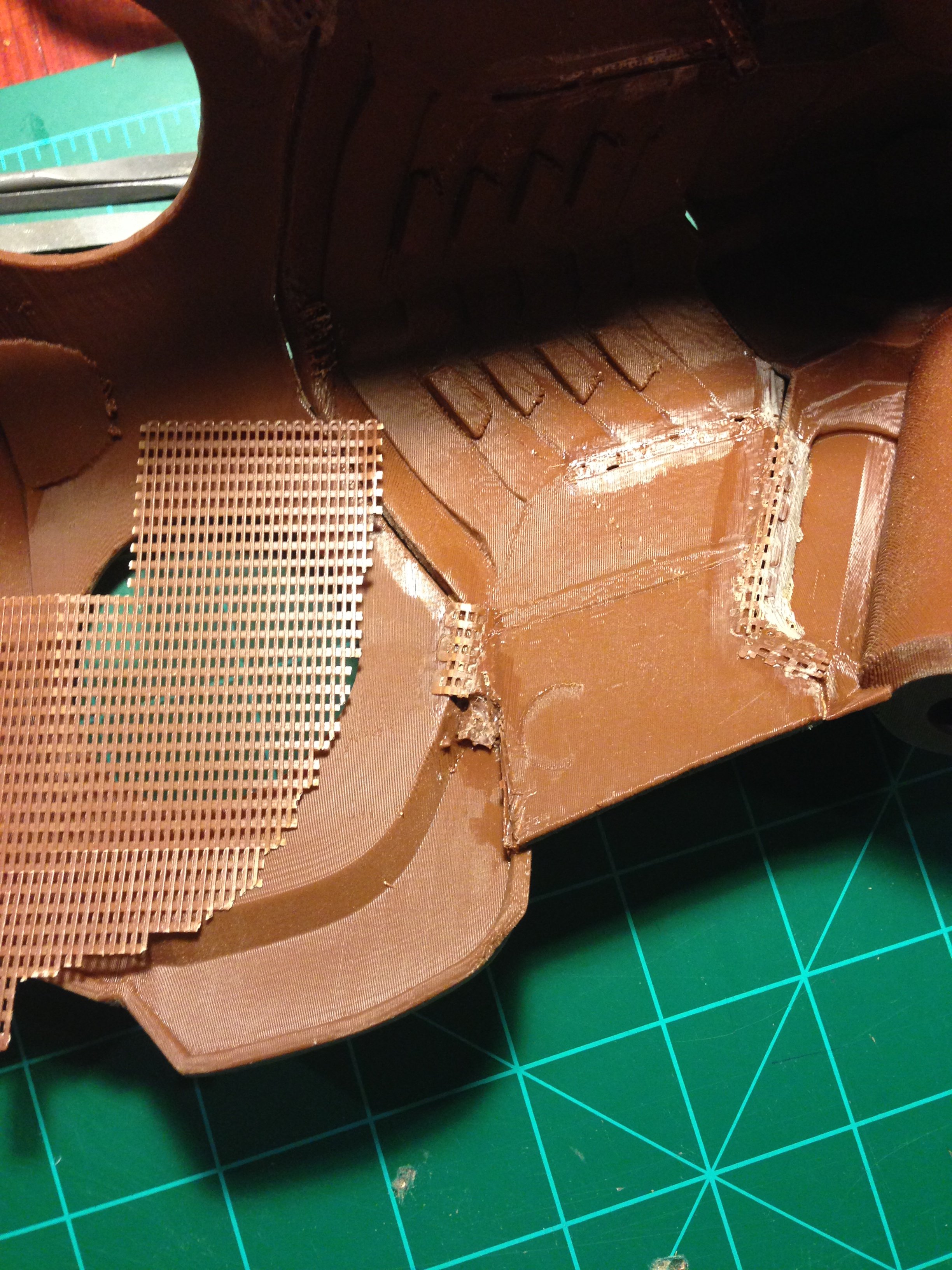

Here's the interior of my mask. I wanted to show this to show how my doing my seams on the inside. My 3D printer threw in a bag of scraps for me to work with, and that included some flat grid-like mesh that came from the printer bed. For me, this worked great as seam-stitching material. After i used the acetone on the seam edges to bond the pieces together, i would cut a piece of the mesh to fit the length of the seam i wanted to cover. I would dab a little bit of acetone on the mask around the seam, then drop the plastic mesh onto it. After a few seconds the mesh would start to melt into the mask, and i would brush a little bit more acetone on top of the mesh, letting it seep into the holes of the grid. The mesh melts even more, and i'm left with a nice bond over the gap, sort of like butterfly bandages over a big cut. I did this along all the big seams, and i'm hoping that it will help strengthen the structure overall.
Here you can see the small seam i did with the mesh, next to a big chunk of the mesh material i'm using. I did this along the seams between the goggles and mouth, and along the seams on the back section of the helmet. Tonight I will finish sanding the sides and bond them together. I will also use some filler to cover the small gaps along the seams, and start priming everything for paint.
